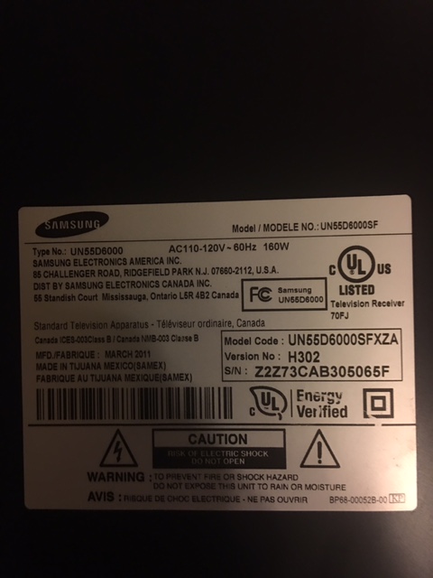

    Samsung LED UN55D6000SF Version # H302
    Good evening guys, I've been reading a few threads regarding this particular Samsung model that does not turn on but it's pretty exhausting being that I am brand new to all this. I like learning DIY things but this one seems like it's out of my reach.
    My TV has been sitting around for a few months after it turned off and all I have now is a blinking red standby light. When I try using the power button on the remote nothing happens. If I press any other button the standby light reacts to it but nothing happens. As it sits there plugged in I can hear a faint clicking sound coming from the area of the PS board, very faint sound.
    When I detached the rear cover I looked for any visible defects on the capacitors, which I hope I was looking at the right ones, but there were no visible issues (bulging or leaking). Since I read about testing the voltage and current on certain things I went out and bought a multimeter. However, I am reluctant to use it because I might make things worse.
    I would like to try and figure it out myself (with your help of course) before I hand it over to a technician. i have always been a fan of these television brands but after reading these threads, I might have to make a smarter choice next time.
    If anyone can help with any ideas to isolate the issue, please let me know. I've always been interested in taking classes on how these circuit boards work but. I have attached a few photos of the TCON, Main, and power Supply boards.
    thanks much!

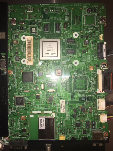

    Disconnect the cables between the main board and the power supply-LED driver board then plug the TV into the AC outlet, the backlights should come on and stay on as long as the AC is applied to the TV. Try it.
      I disconnected the main board from the power supply. Plugged the tv into the outlet and no backlight. I also noticed that the red standby light is no longer on.

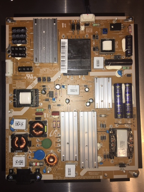

          You not going to see any red led standby because we do not have the main board hook up, the test you have done is to find out if the power supply-LED backlights driver are OK or not, the backlights should come on and stay on when the main board is not connected to the power supply board if the power supply and the backlights are OK.
          What is the power supply board P/N? BN44-?????

              bn44-00424a

                  You are going to need to do some Voltage testing.

                      The A5V? How about all other Voltage (CNM803) when the cable to the main board is not connected?
                        Re: Samsung LED UN55D6000SF Version # H302
                        btw, this board is also know for having bad soldering works on those transformer pin and the device that are attached to the hestsinks. You can see those rivet through holes where the transformer legs are soldered to which commonly failed.

                            Sorry about the delay:
                            The way I understood testing these pins from the CNM803 is testing the odd pins with both the TV connected to the AC outlet and the main board connected to the PS. Since the odd number pins are exposed I figure I should test them with the main board connected. Since the even numbered pins are not exposed and can obviously only be tested with the main board disconnected, I did so and the following are the readings that I got.
                            N.C. =0 N.C. =0
                            EPWM =Fluctuates B13V =0-2.3
                            N.C. =0 B13V =Fluctuates
                            BLU_ON =Fluctuates Vamp =Fluctuates
                            GND =0 Vamp =Fluctuates
                            GND =0 GND =0-2.3
                            A5V =5.40 B5V =Fluctuates
                            PS-ON =.9-2.3 B5V =Fluctuates
                            Not sure if this makes any sense but I will continue reading the thread you sent me. Thanks again!
                              So the A5V which is the Standby is steady, but the B5V and B13V which are SWITHCED power supplies that are turned on when the PS-ON is present, but your PS-ON which is the command signal from the main board is fluctuating (it is not normal) so that is why the B5V and the B13V are fluctuating. You will have to test those Voltages without the main board connected. You can disconnect the connector on the main board side and leave the connector in place on the power supply board side and probe the even pins from the back side of the connector.

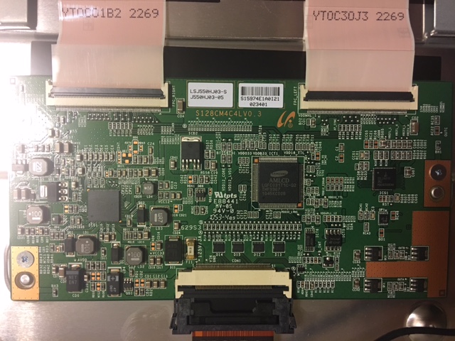

                              You can also try having the T-CON board disconnected but all other board connected to see what happen.
                              https://www.badcaps.net/forum/showth...ight=UN55D6000
                              Look at post 6 of the link also.
                              BTW, you need to check and report the DCV of ps-on, blu-on, and the dcv between the two legs of the main filter cap when the main board is not connected to the power supply board.
