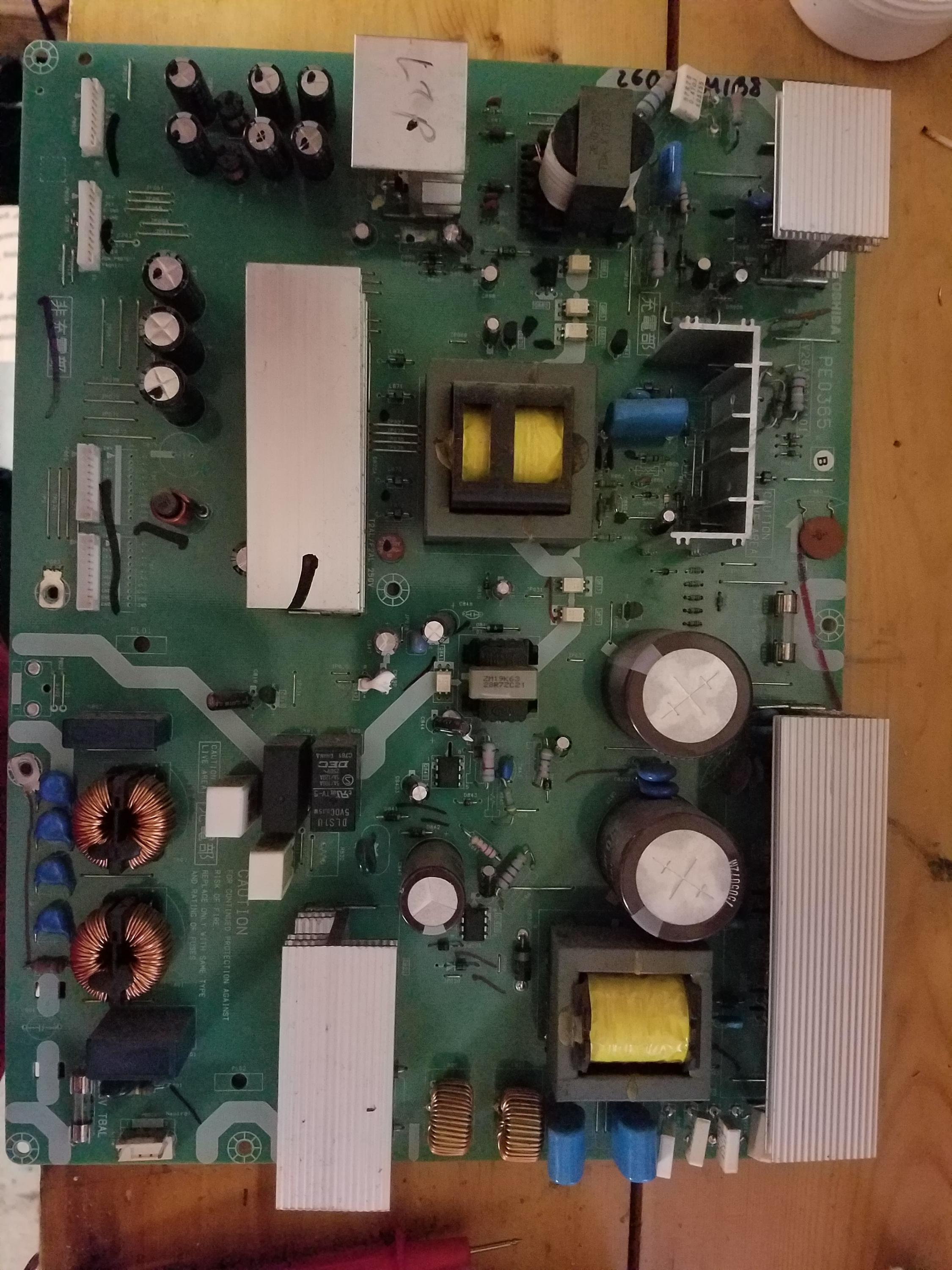

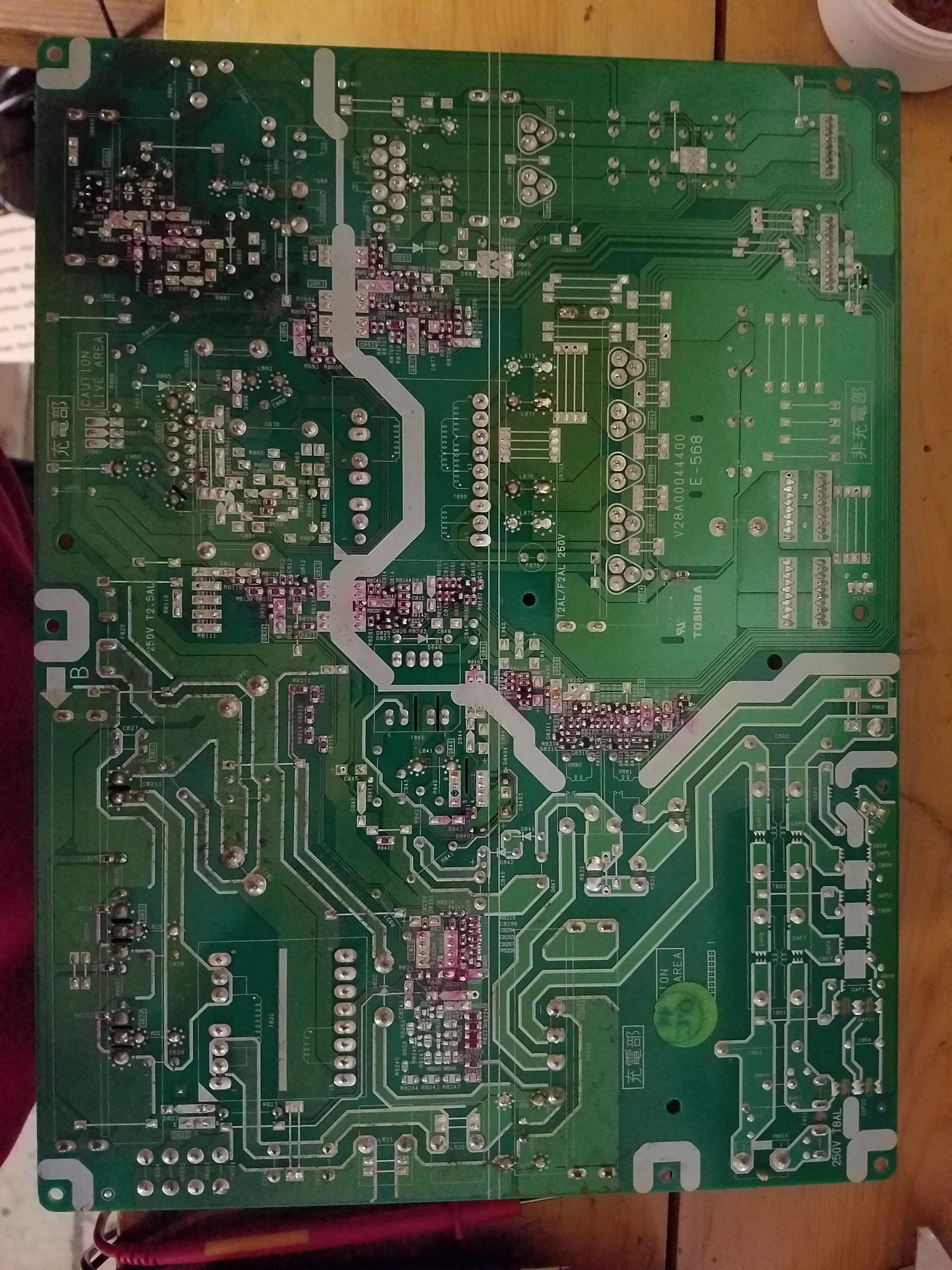

    Toshiba 52hl167 not turning on 3 blink
    I followed the chart posted "Toshiba Regza 52HL167 LCD TV flashing amber LED repeatedly" at the p809a pin I only have 3.5 volts instead of the 5v suggested. This is indicating a main power supply.
    I tried to follow the circuit and could not find a short or bad part.
    Any suggestions or advice is appreciated.

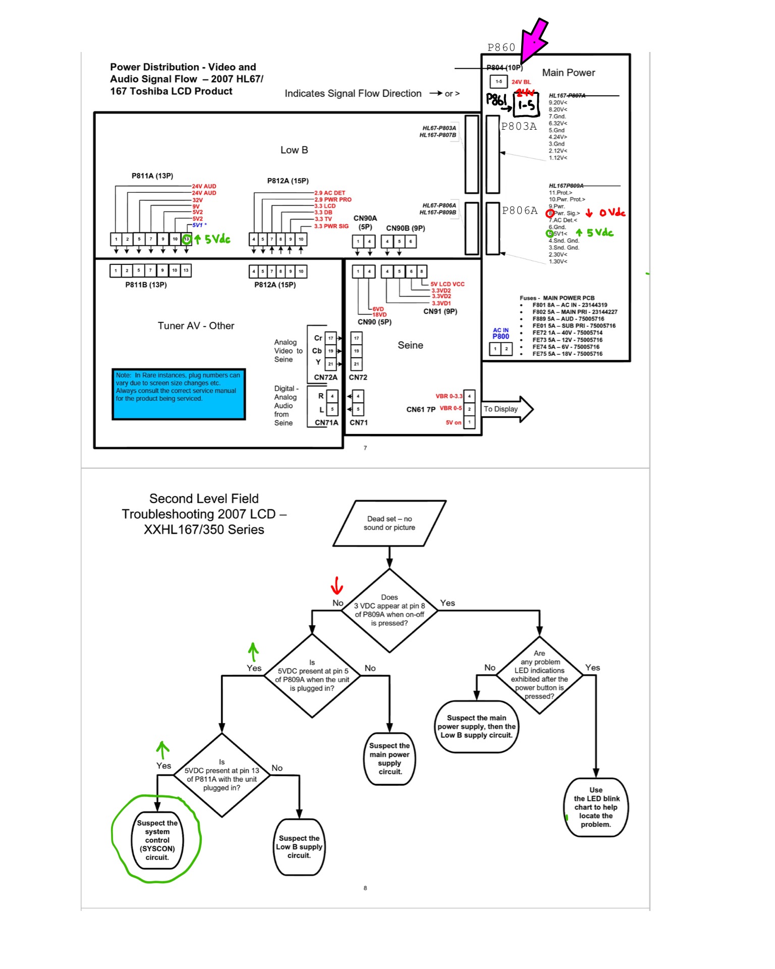

    "I followed the chart posted "Toshiba Regza 52HL167 LCD TV flashing amber LED repeatedly" at the p809a pin I only have 3.5 volts instead of the 5v suggested. This is indicating a main power supply. "
    Can you give us more details? What chart posted are you referring to?

      Strega315 started a post "Toshiba Regza 52HL167 LCD TV flashing amber LED repeatedly"
      in his post he showed a flow chart. (attached)

        Re: Toshiba 52hl167 not turning on 3 blink
        "at the p809a pin I only have 3.5 volts"
        I must be blinded since I do not see anything for P809A PIN 1.
        The flow chart is showing P809A PIN 5 AND PIN 8.
        I do not see any P809A in the block diagram either.
          Main power is board A, Secondary power or low power is board B. Next to the P806A is a chart. On top of the chart is is labeled p809A. I and did intend pin 5. I do not have any power at pin 8.
          Sorry for any confusion.
            OK, let me get this correctly, pin 5 (5V1) you only getting 3.5V.
            Pin 8 (PWR SIG, it looks to be the same as PS-ON but I will need to verify form the service manual) is 0V.
            Correct.
            I need to find out what the pin 9 PWR pin is and also the pin 10 PWR PROT.
            • johns1mj
              • May 2015
              • 242
              Could not diagnose the board. Replaced with used board. TV is working. Thank you everyone for your assistance.
