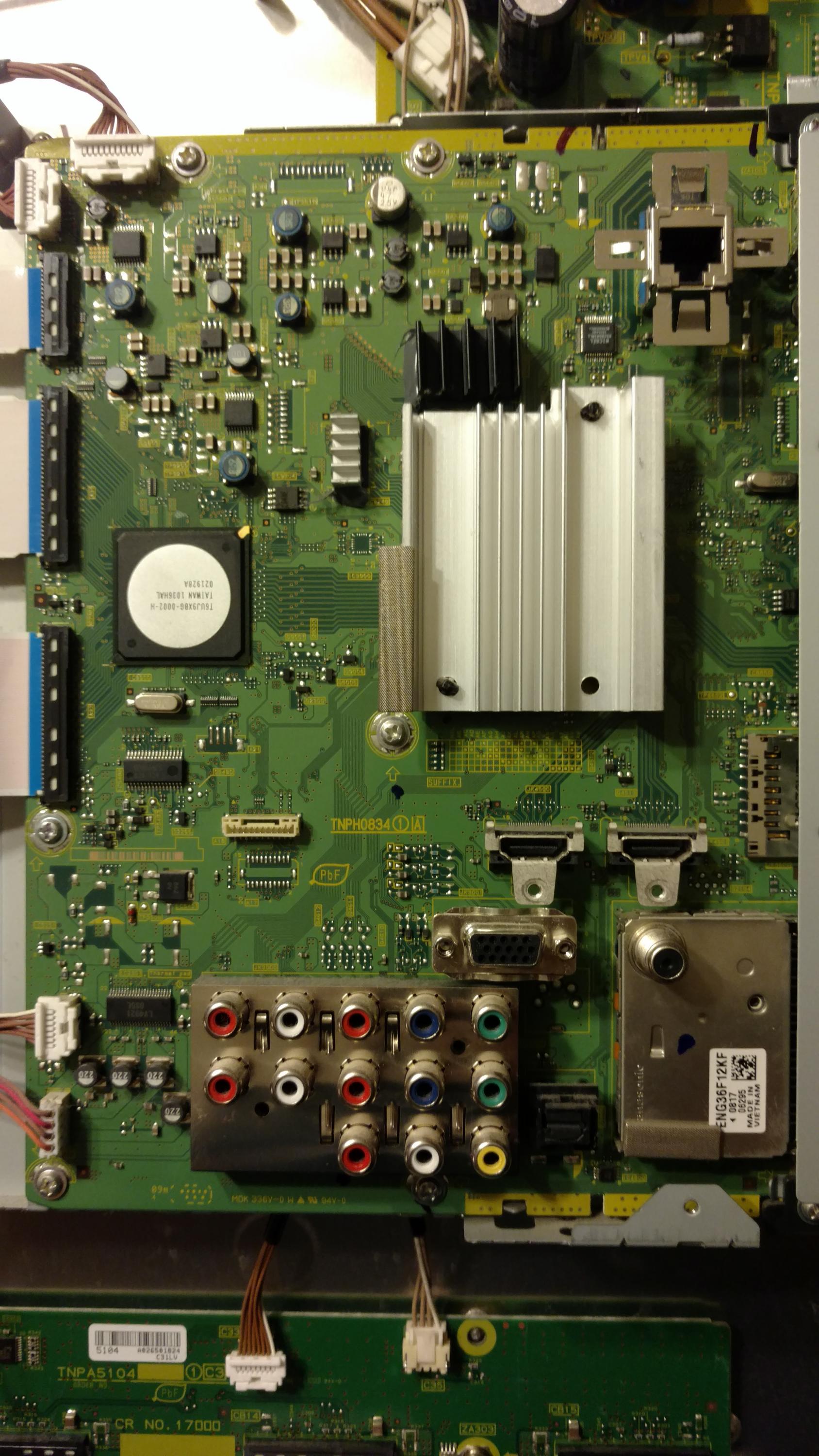

    well hurricane matthew hit me last week and power surges were abundant. killed my surge protector and my TV. The tv is a few years old but worked great until this. When I powered it up the remote wouldn't work and I had to manually push the button on the side. I can hear clicking in the back as if its coming on but the screen is unresponsive. and after the 3 min it just shuts off from no use.
    what info do I need to give you guys and what should I look for in order to fix this?
    thanks in advance!

    I would suggest on all that A-board. If you can't find one PTS ELECTRONICS refurb.
    Need to match the correct revision board as each size has a different version

              finally got time to remove the panel and get some info, it uses this board
              http://www.ptselectronicsinc.com/txn-a1lguus/
              thanks for pointing me in the right direction!

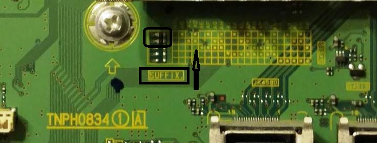

                what size TV is it again?
                can you post an image of your board including any stickers on it?
                you're referencing a 42" board there

                  Re: Panasonic TC-P54G25 13 blinks
                  Originally posted by tw2005
                  What size tv is it again?
                  Can you post an image of your board including any stickers on it?
                  You're referencing a 42" board there
                  55"
                  [ATTACH]143171[/ATTACH]
                    Originally posted by mattsc
                    55"
                    So back to what I originally said, it's this, Rev AD
                    TXN/A1LUUUS
                    TNPH0834AD
                    http://www.ptselectronicsinc.com/txn...-a-tnph0834ad/
                    not the version you posted a link to.

                      just an update, got my board back after sending it to PTS electronics and it works great, watching it now. quick turnaround and works as intended. i do wish they would have said what was wrong with it lol.
                      • tw2005
                        • Oct 2011
                        • 6457
                        yeah, well, if they did that you'd be squealing about it and we'd all know how to fix it.
                        Can't blame them for withholding corporate knowledge
                        So $95 was it?
