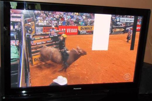

Panasonic TH-58PZ700U White Section upper right - bad panel?
  • travelin5familyman
    • Sep 2016
    • 4
    Greetings all -
    My first non-intro post!
    From what I found on other posts, this is most likely a bad panel? Would you all agree? Seems a bit too specific a region. This isn't my TV, just trying to triage one before I spend any more time on it!
    Thanks for the tips gents!
  • ReeceyBurger123
    Never Give Up !
    • May 2014
    • 7325
    • Britain
    Re: Panasonic TH-58PZ700U White Section upper right - bad panel?
    Possibly bad connections could be fixable.
    • HenryJ
      • Oct 2006
      • 54
      Black band is on right = panel.
        • Sep 2016
        • 4
        Thanks for the input guys, sounds like this repair is not possible.
        • ReeceyBurger123
          Never Give Up !
          • May 2014
          • 7325
          • Britain
          It might just be the connections Ive had that loads of time of Panasonic's as they are removable. I would say reseat the connections first before tossing it.
