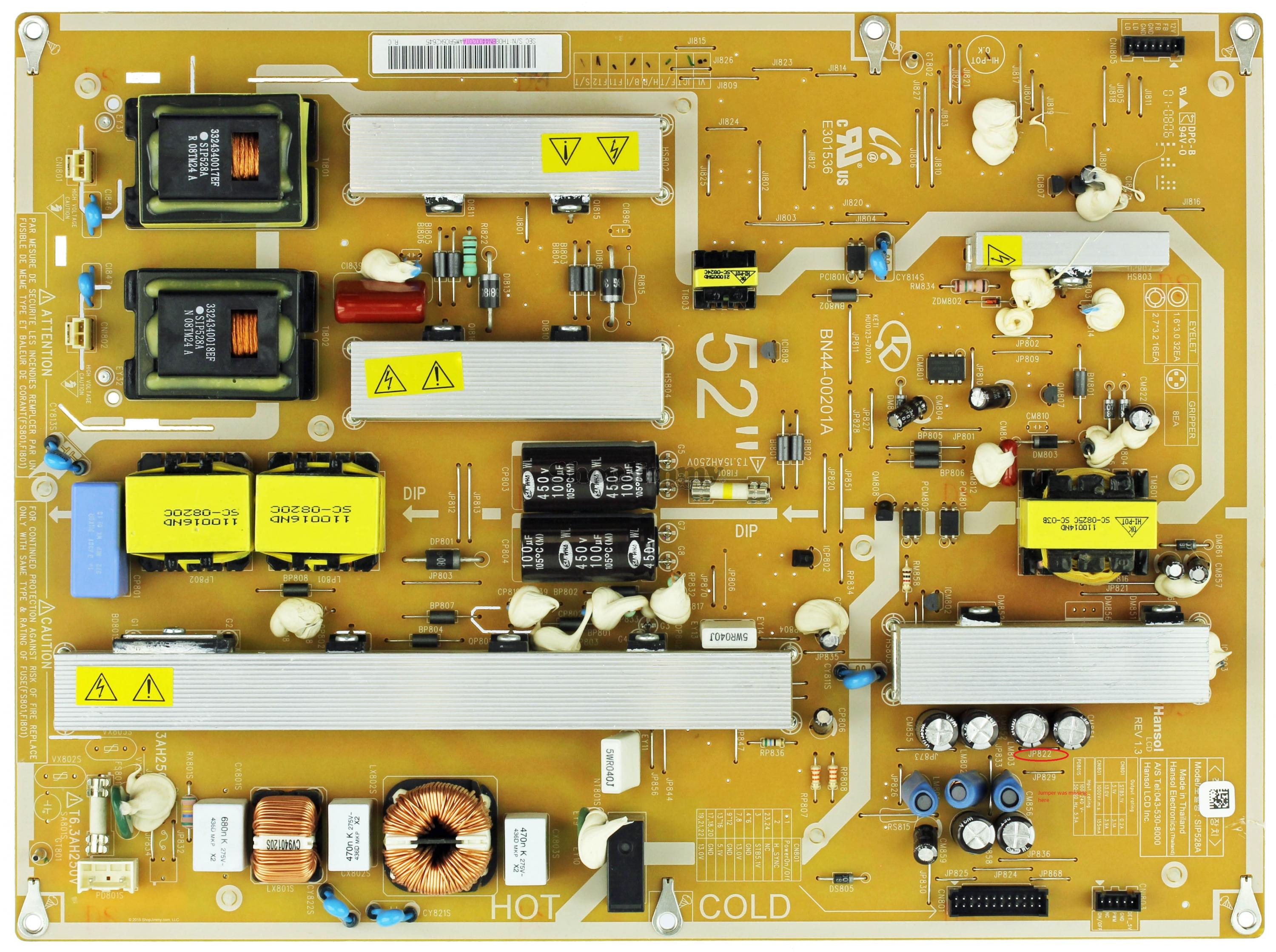

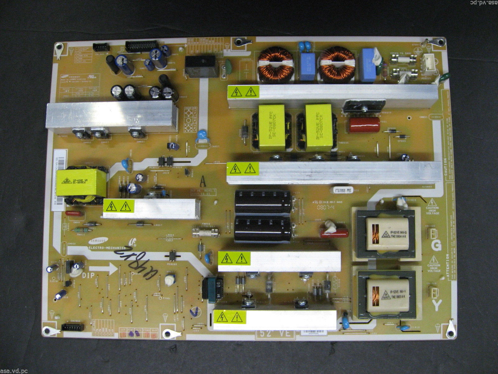

    ln52a750r1fxza came with BN44-00201A I am looking at the BN44-00202A they look nearly the same?

      Re: Samsung Power Boards ln52a750r1fxza
      If the pinouts of the power supply board connectors are identical and they both appear to be for 52" sets then hopefully it will work. Cannot read the legends on the first photo so can't be 100% certain.
          If I'm not mistaken, that BN44-00202A is typically found in 46" models. The 52" models usually come with 00200A and 00201A. I may be wrong and it might work but I'm just thinking that's the case from memory.
            201A is for 52", 202A for the 46" so it may not enough high Voltage to drive longer lamps in the 52" screen properly and may also has less power handling.
