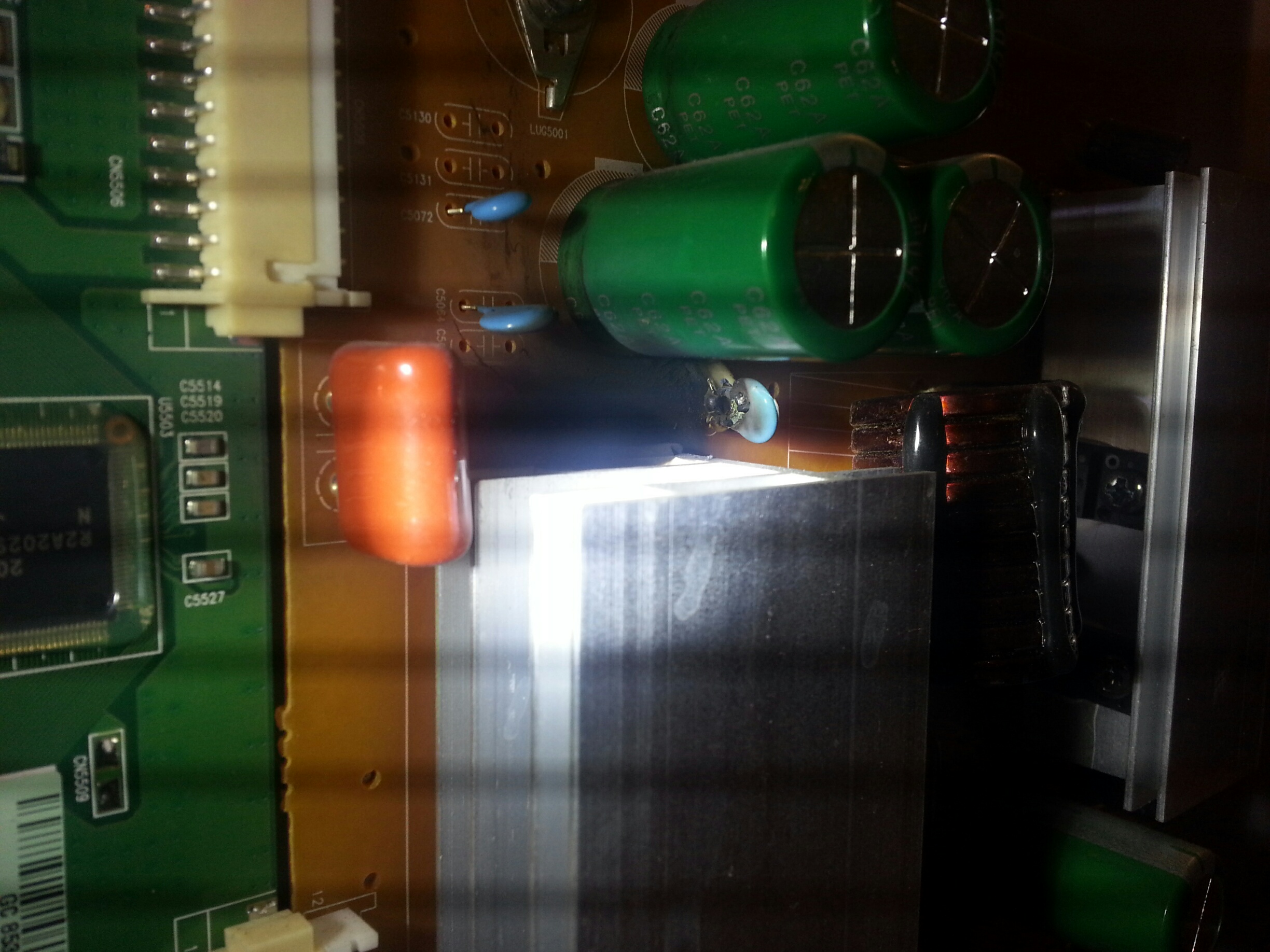

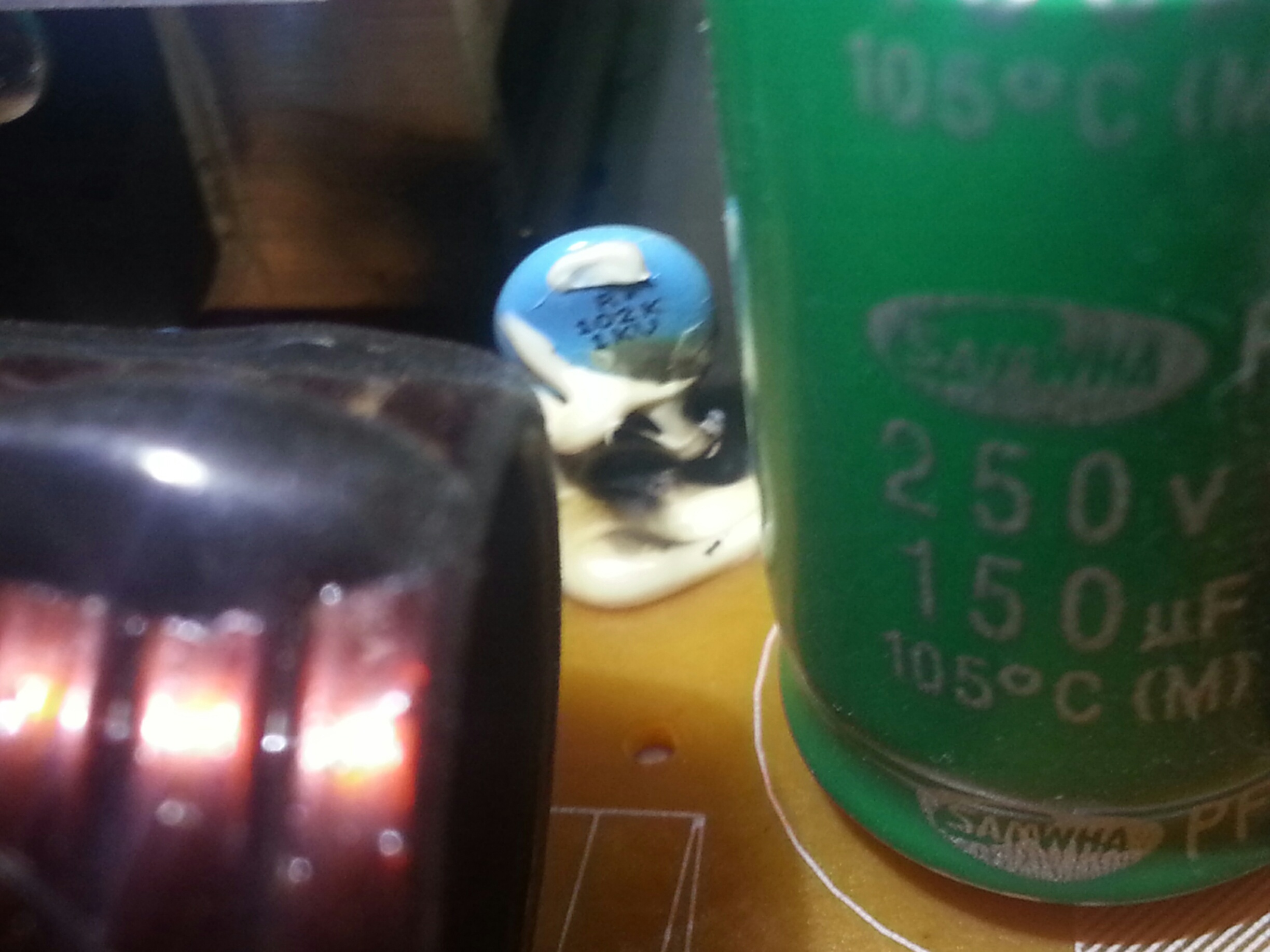

    So, The TV in question is the 450 series samsung from 2012 or so. The sound works fine but there is no video at all. I have a green blinking light on the logic board which I *think* means the main board is ok. X/Y main on the left side has a blown little blue thing which I think is a small capacitor--see pic below. When I measure Vs to ground at the logic board, I get ~3v--I am not sure where else to measure Vs as I don't see an obvious spot that is marked.
    So, the question is that with an obvious blown blue thingy, would it be prudent to just replace the blue thingy, or might that be a symptom of a different issue and not the actual cause? I'd like to avoid soldering in a new capacitor (if that is what it is) and having it blow again due to an underlying issue.

      Disc ceramic cap gone short would have killed a load of IGBT's on that board I guess--You'll need to check 'em with ohmmeter/DVM...
          I replaced the cap--no change in symptoms. I'll search around to see how to test the the IGBTs. Of note, I found a couple spots to check Vs--pin 8 at the top of the X/Y main has ~16 volts, pin 7 has ~14. Not sure if that means anything, but I read somewhere that the Vs up there should be in the 200v neighborhood.
          Thanks for the help!
          Dan

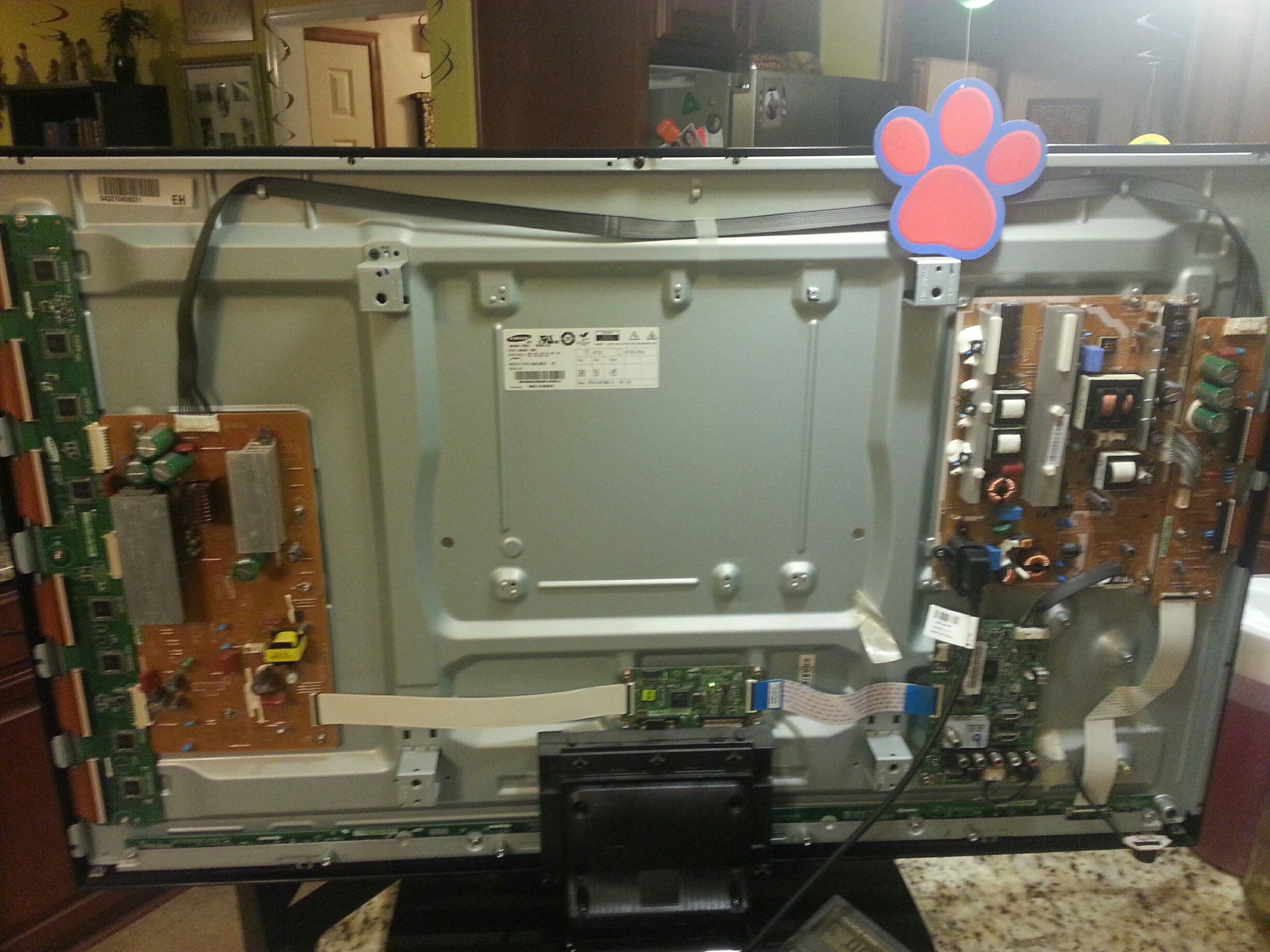

            That said, will replacing the Y and X main address any issues that would have caused this? Also, I *think* this display has a combined X/Y board--left side hooked to the buffer. If this is not the case, which one is the Y?

              Vs shuts down if it detects an issue like a short circuit so thats probably why.

                Ok, so I have another X/Y board on the way--anything I can/should check before installing the new board to ensure I don't fry it?

                  Just to close the loop on this, the new board came in and the display is working perfectly. I still don't know what the actual cause was or what was wrong with the old board though. Thanks for the help!
