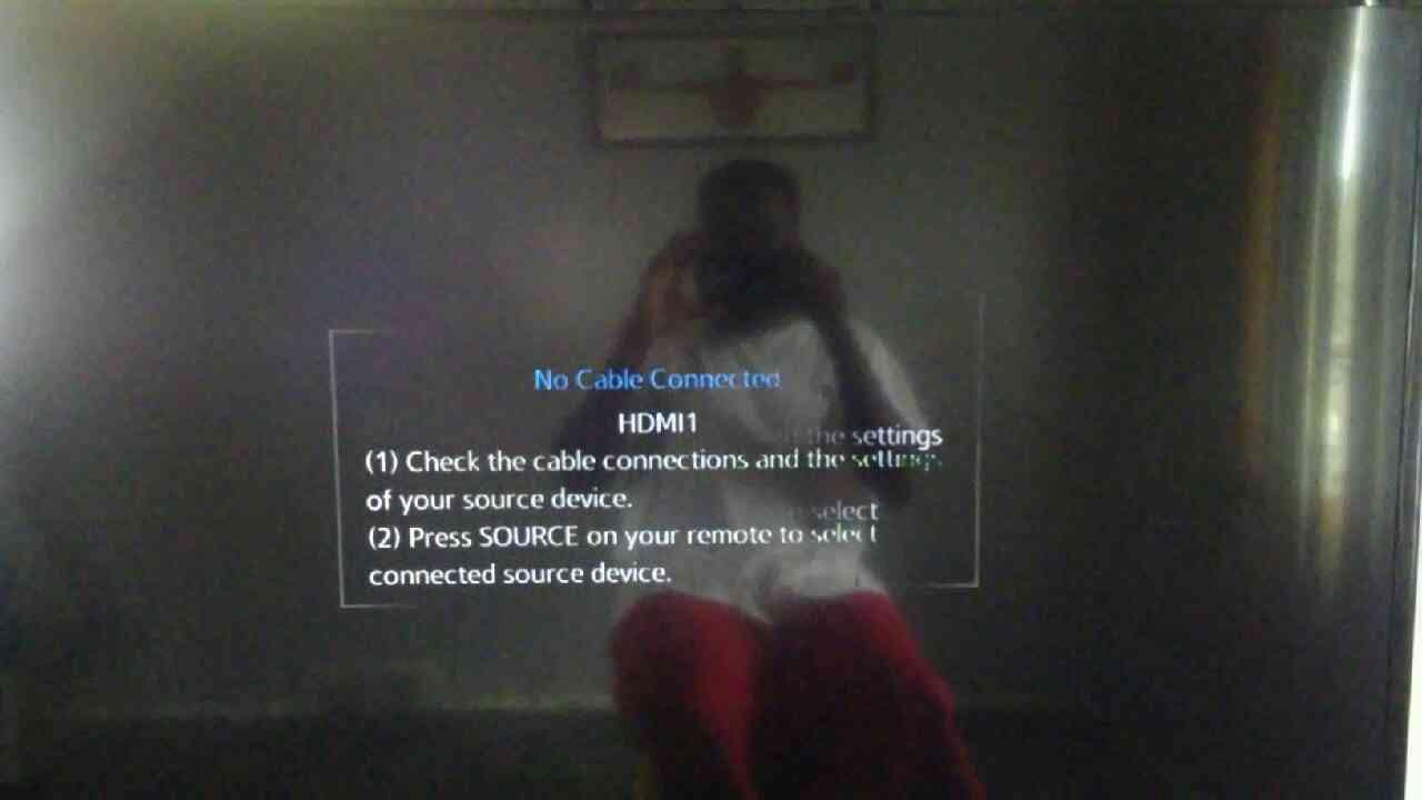

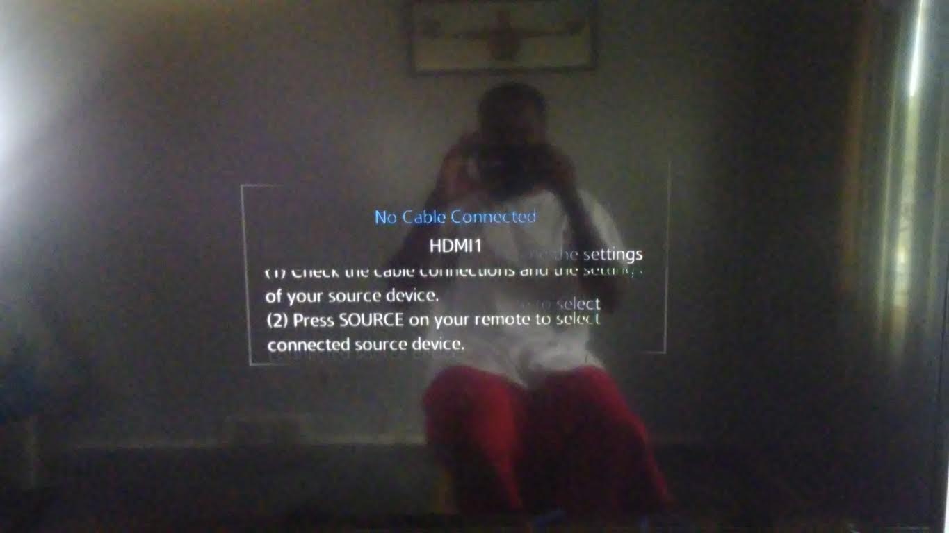

    Samsung UN50J5200AFXZA ghost images
    In the picture, you can see the words have ghost images on top. Really noticeable over the words settings. Any ideas?
  • CapLeaker
    Leaking Member
    • Dec 2014
    • 8327
    Re: Samsung UN50J5200AFXZA ghost images
    Reseat the lvds and the ribbon cables from the tcon to the LCD. Check the tab bonds.
    • ozzy214
      • Nov 2013
      • 319
      • usa
      Bad panel it looks like.
      • dick_barton
        • Aug 2015
        • 6643
        • Wales
        Check your panel tabs
        https://www.youtube.com/watch?v=zqcdTNoOoN0
