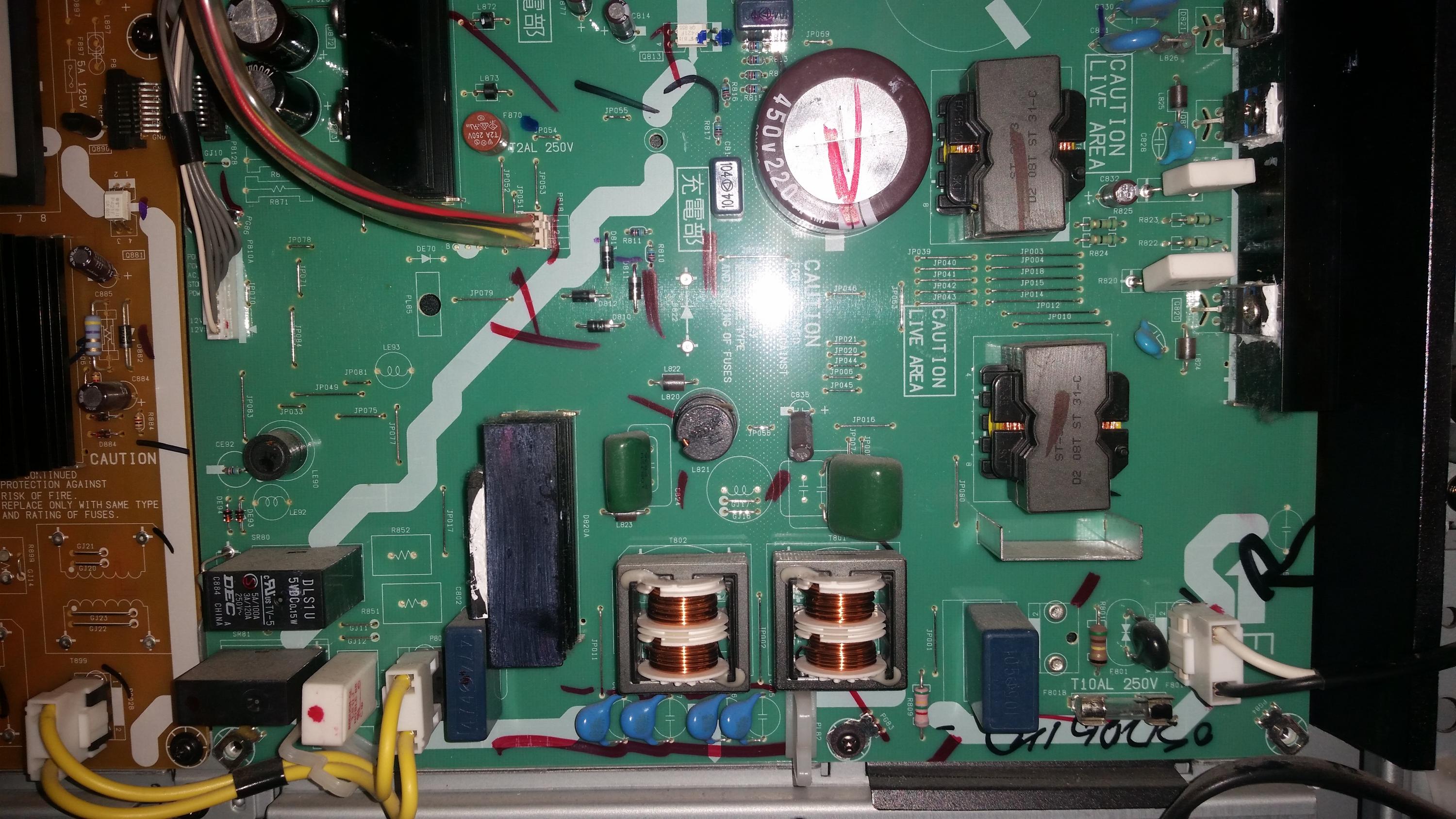

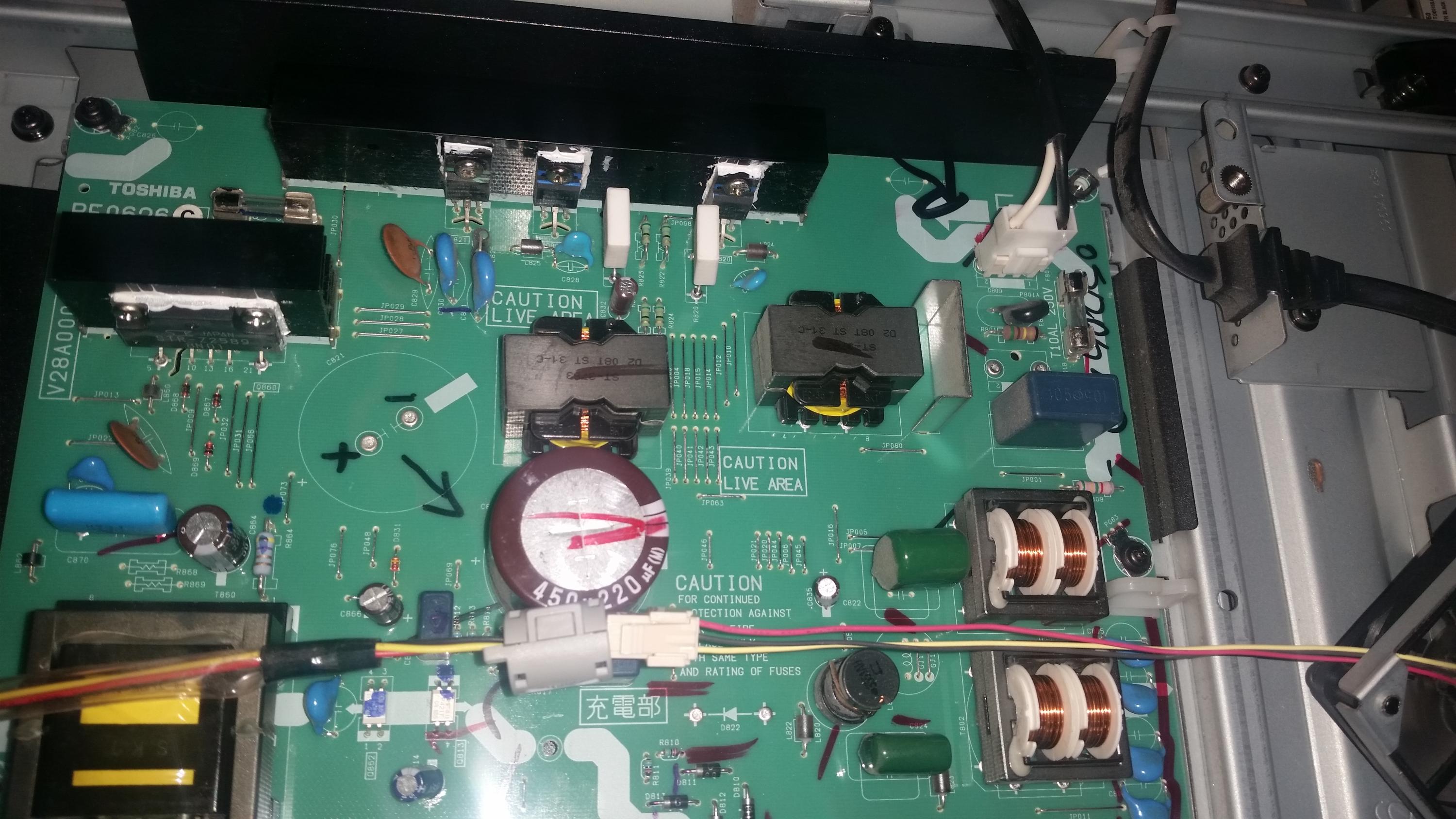

    I have no 24v on inverter on the power supply...it just reads 3.19v on the 24v out to inverter.
    The t-con it's cold not showing picture even if I point a flash light to see if there image none....

      On the inverter connection on each pin I should have 24v and am reading 3.19v on the 4pins....and at the bottom of the green power supply theres o connection of =>
      Pow_prt...3.2v
      Pow_sig....2.63v
      Ac_DEt.......9.8v
      Stop fan....22.5v
      Pow_lcd.....3.27v
      Gnd...0v
      Gnd...0v
      12vlcd...3.19v
      12vlcd....3.19v

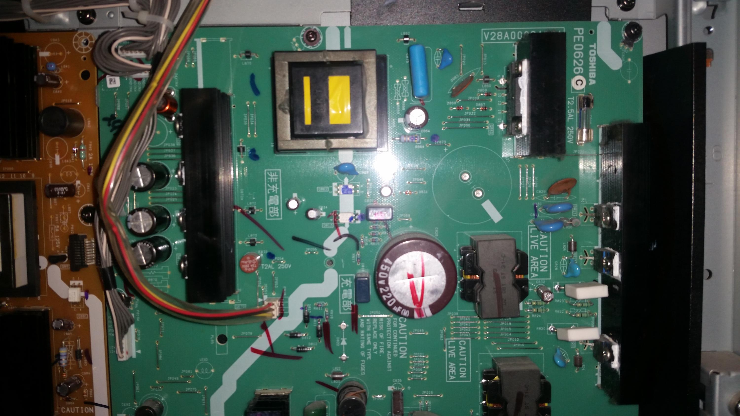

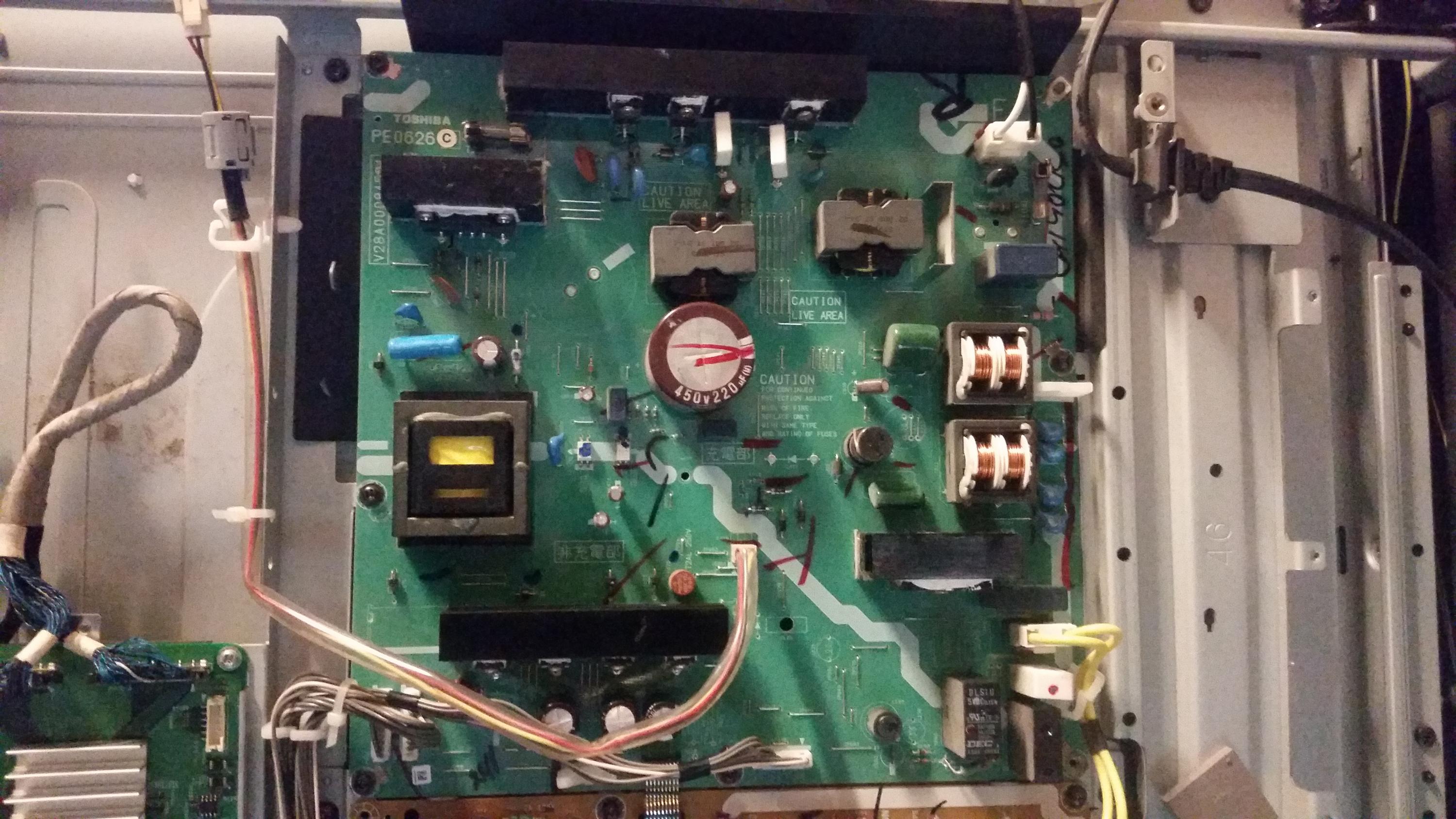

        How much DC V is on the main filter capacitor on the primary side of the PSU when the TV is turned on? Careful, there can be close to 400V on that thing!
        Post some high resolution, straight shot pictures of the top and of the bottom of the PSU. So we can see details. Those you posted are not that good.

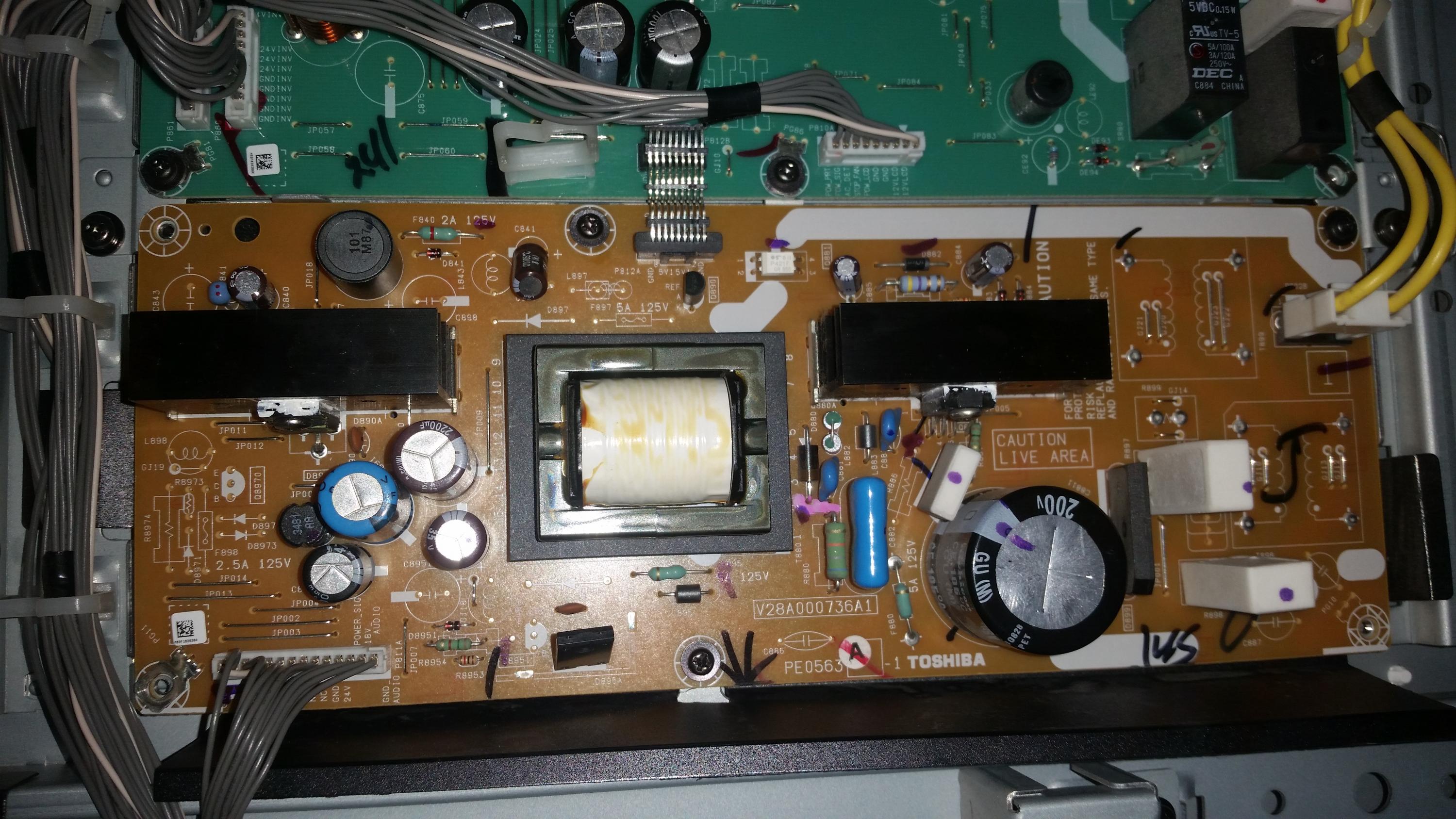

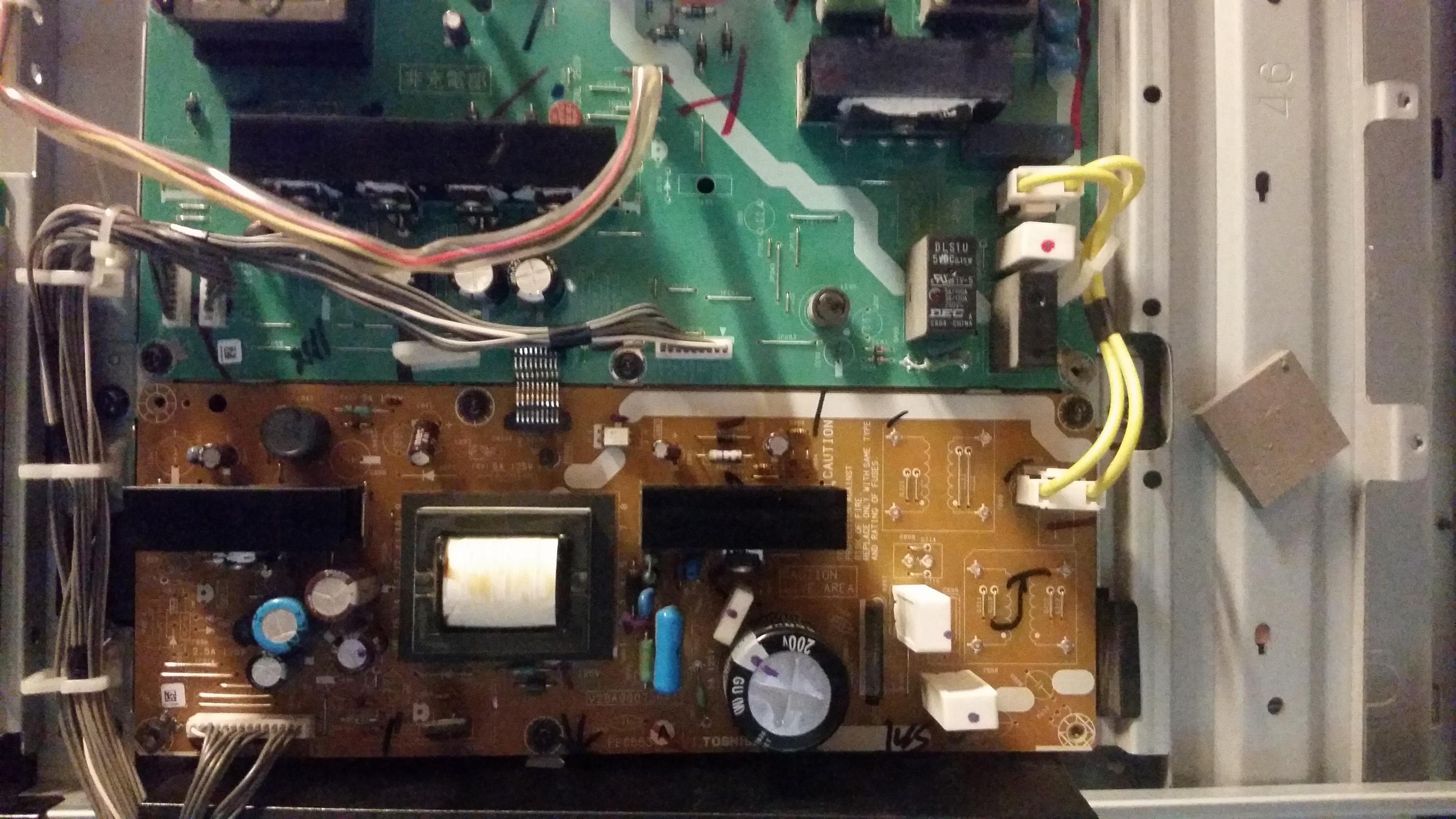

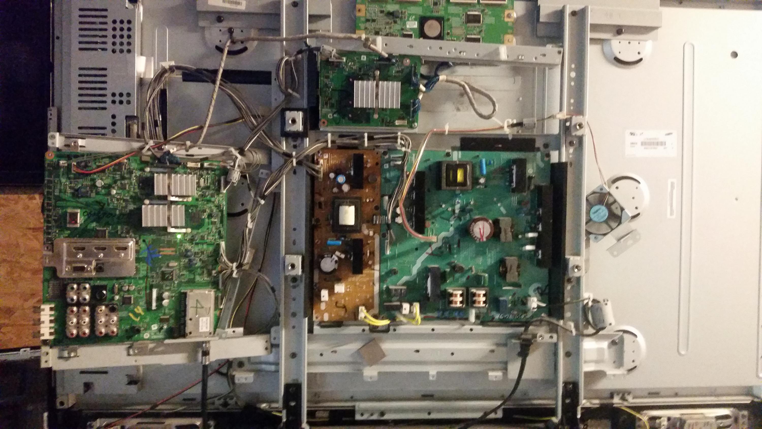

            You have two power supply boards, the small brown board one and the large green board one.
            Do you hear the relays on the large power supply board kick on?

              How much DC V do you get on that big brown 450V capacitor with the TV on?

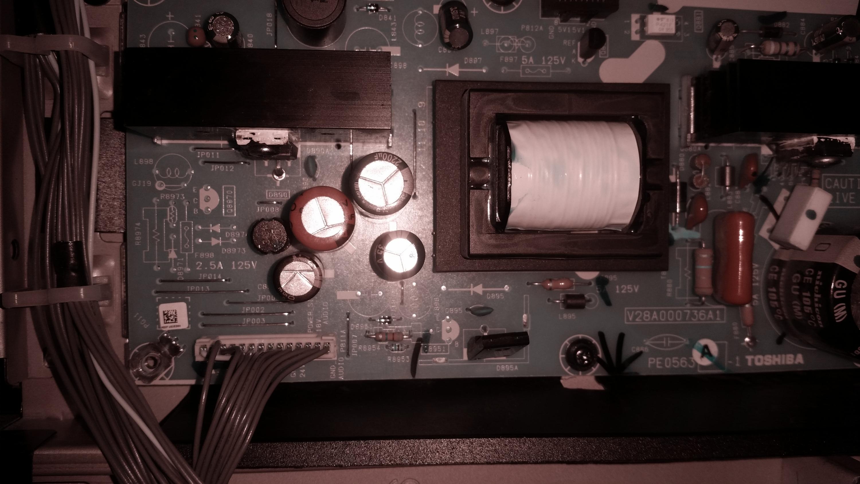

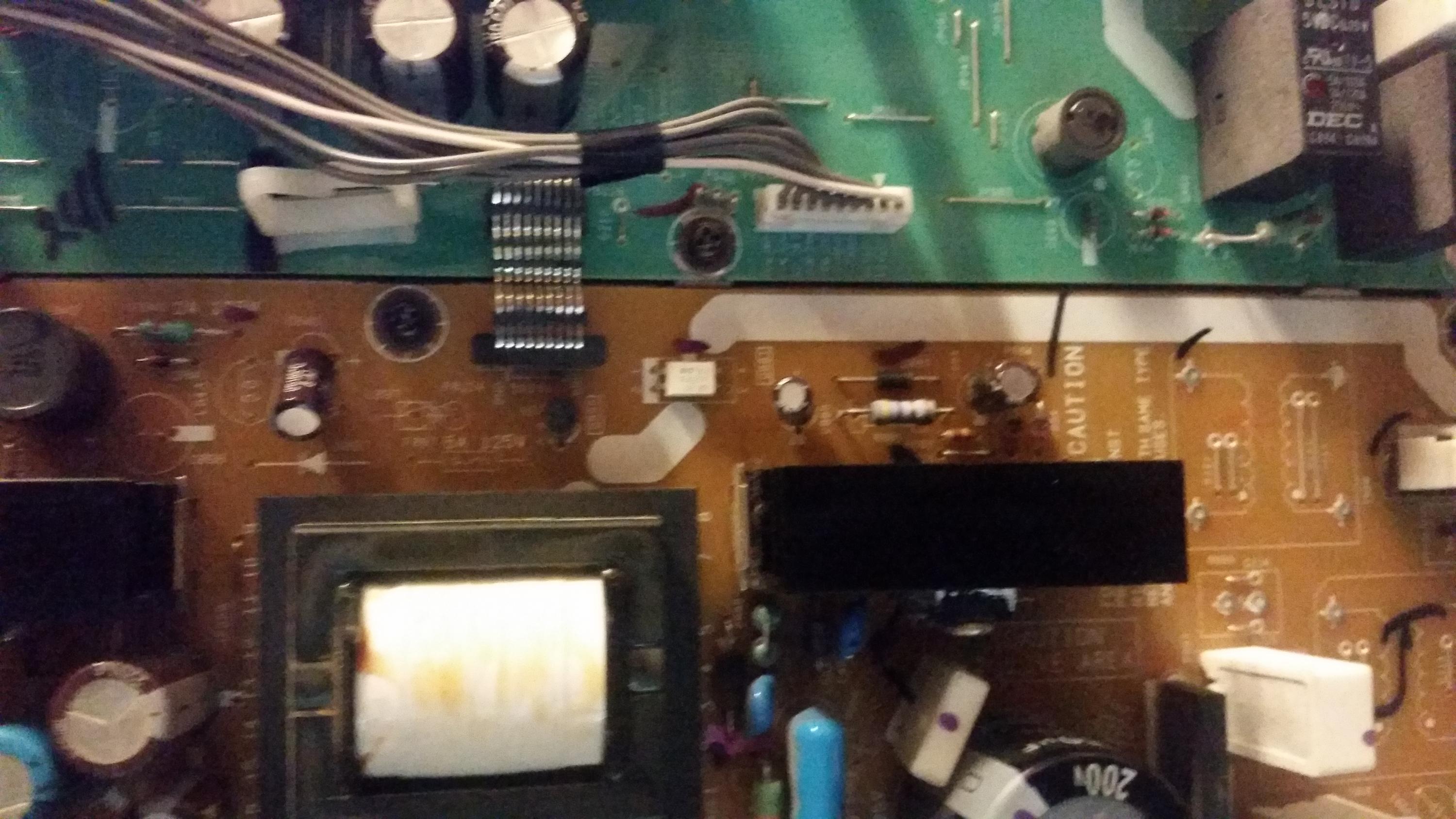

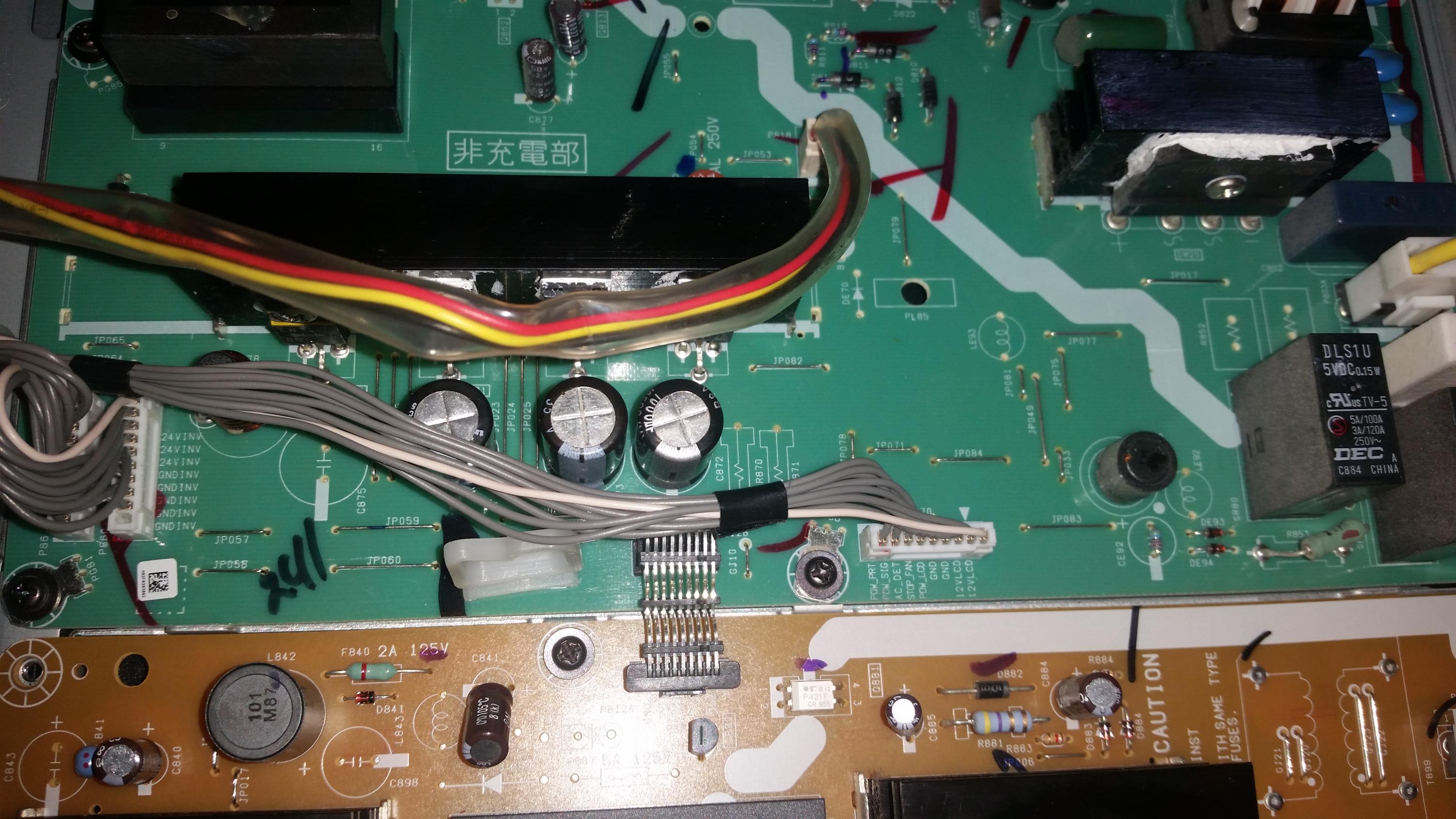

                                Found the problem 2 caps were bulge from the battom on the sub main power board it's the second power supply that feeds the main board.....
                                • hmendez86
                                  • Jun 2015
                                  • 344
                                  • united states
                                  Re: Toshiba 46XV545U no picture no backligth
                                  On the side of the blue cap they were 2 caps bulge from the battom....the white resistor it was bit low of( 1.8 resistance to 0.5ohms did change both things and now it works fine...
