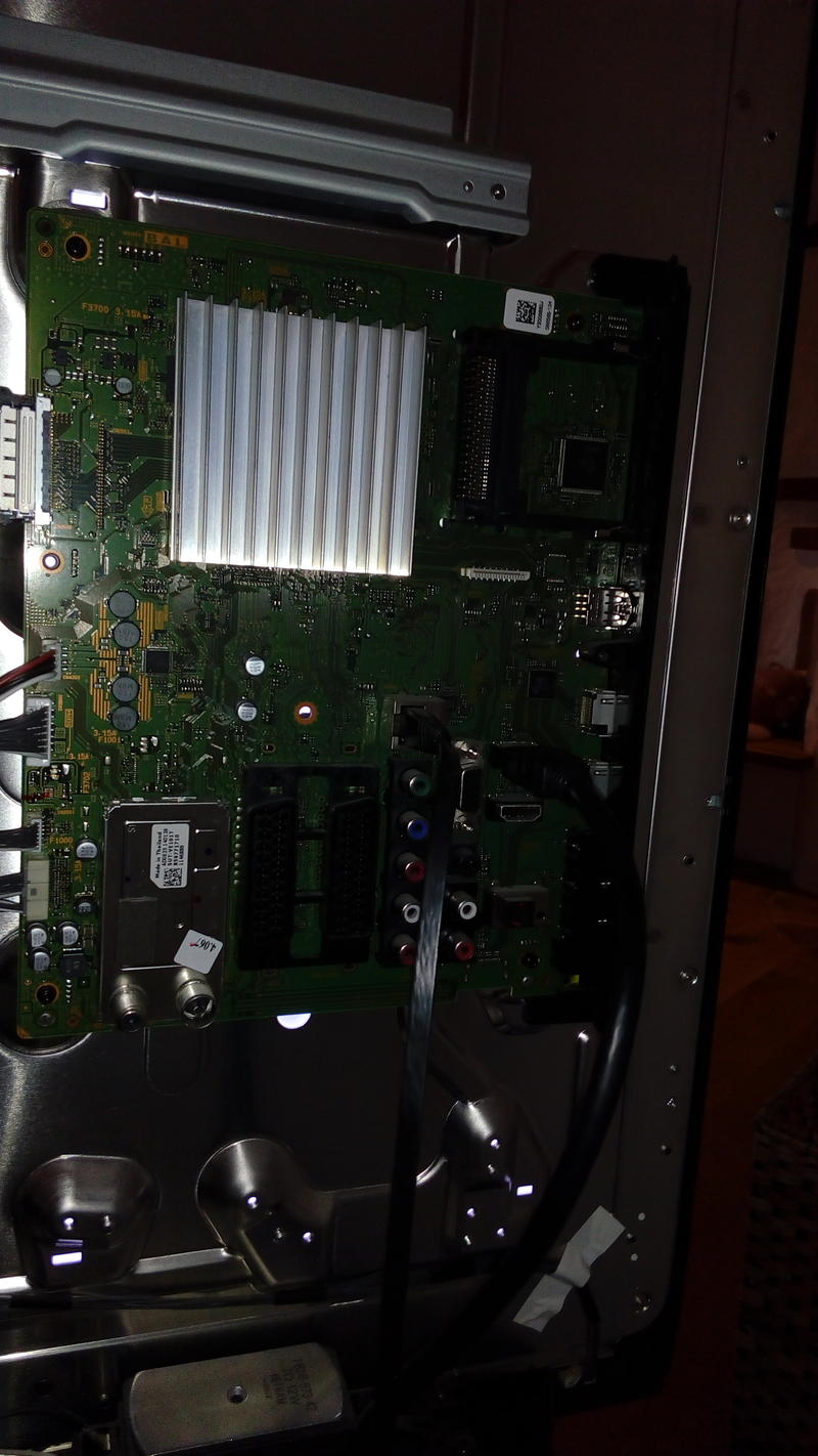

    Hi folks,
    i have an SONY KDL-46EX706 wich flashes intermittently, which means that the picture gets white for only a couple of ms and i can see the picture flashing/flickering.
    the failure cant be reproduced it just comes and goes
    Not matter what source
    No matter how log the TV is running
    Software is up to date
    kock test is negative, also coolant spray
    BAL TCON Panel??? any ideas??

    Re: Sony kdl-46ex706
    Posting pictures of the back of your tv showing the boards with clear pictures may help you more with fixing your problem
      hope this helps, more clear pics when i am @home
        well the tv flickers more and more often now, but when the tv internal menu is opended over the home button the tv does not flicker.....
        any ideas?

                  posting photo from service manual make no sense to check the reality of the sets condition, you need to take the cover back out. reseat all cable after cleaning them.. if didn't help, remove some load for the TV, while its on and display Chanel plug it off from wall sockt only,, remove the IR section socket connector then plug it again to wall socket and check.
                          cleaning the connectors and reseating them did not solve the problem
                              nope Voltages are ok, got a PSU and have changed the PSU for testing purposes, same behavior.
                              also i saw that the OSD of the TV is not effected by the flickering....
                                  have changed the 2pcs 16V 100µf on the bal board now as their ESR was a bit to high, seems to work at the moment...
                                  i guess i will change all the caps on the bal board later...
                                    well back again....
                                    not it has turned into a green screen, sinco today it started up with a total green screen, after pressing "home" button, picture was ok again.
                                    but depending on the image contend it gets green again....
                                    i guess it is the BAL board, dont ya?
                                      anyone can tell me which source driver ic's this board uses:
                                      Bal Board: A1763467B
                                      ill give it a try changing them if possible.... as a new board costs around 300USD..
                                        To bring this to an end, tv is working again, changing the BAL Board was the solution.
                                        BAL Board (Service) A1763467B
