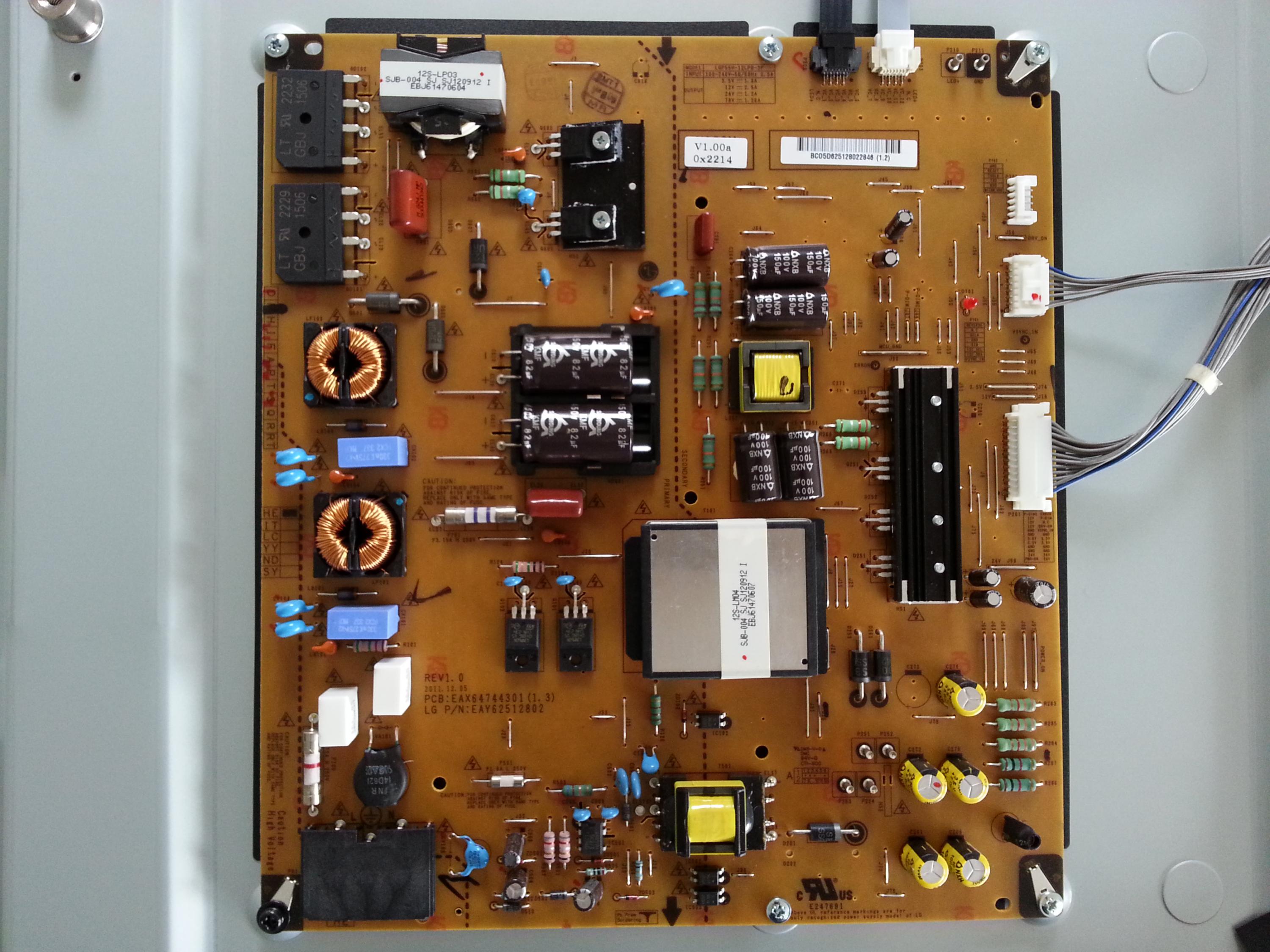

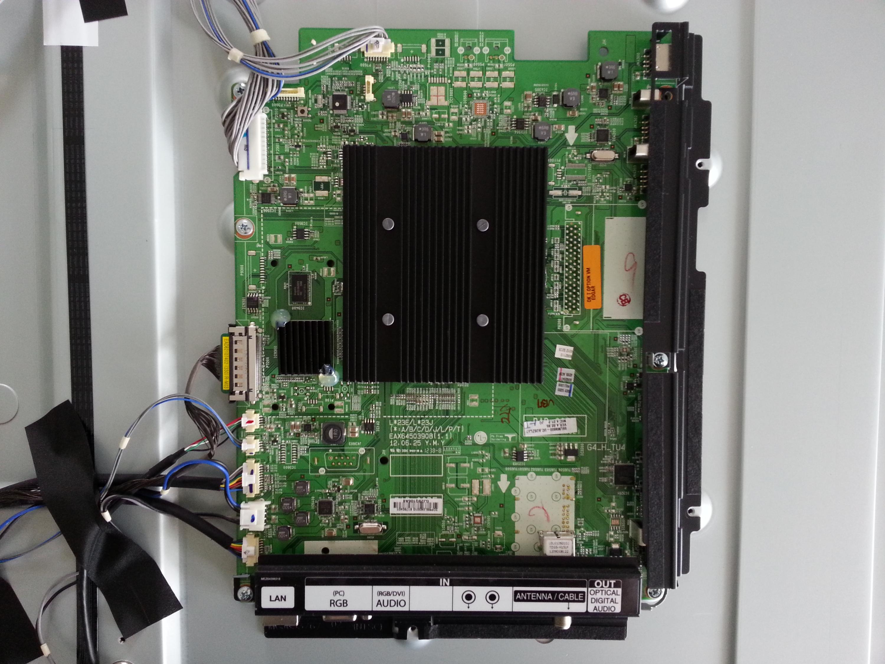

    I'm looking at this 55" LG LCD and it doesn't want to power up after a lightning storm. Pressing the power button makes the red light in the corner blink on and off and the LG emblem to fade on and off indefinitely until the power button is pressed again. siliconfish of the SiliconFish blog had a similar problem with a slightly older version of that set and found the issue to actually be the mainboard instead of the power supply. What would be the best way to confirm what the real culprit is?

    I think it would be best to take the voltage readings at the connector outputs and see what voltages you do/don't have.

      With the back cover off, I can hear what sounds like a faint rapid-clicking or rattling sound from the mainboard. This is important because some of the voltages fluctuate in sync to this noise, which goes for 4-6 seconds and then pauses for 1-2 seconds before happening again. This'll go on for several tries until it gives up and goes back into standby mode. The measurements are as follows:

        Can you run the power supply disconnected from the mainboard to see if it powers up the backlights and if the voltages come up and remain steady
        If it doesn't power up can you, with the mainboard still disconnected, jump a 1K between PWR_On to the standby voltage 3.5V? and check the voltages are stable.
          No dice, nothing with the mainboard disconnected.
          I would, but I haven't got a resistor handy. Can I improvise?

            Get one off a duff circuit board if you have any laying around.

              Just to follow up, my troubleshooting eventually led to diagnosing a bad mainboard. Upon finding a replacement mainboard (very expensive in this model) and installing it, the set is working again (albeit without any of its previously-stored settings).
