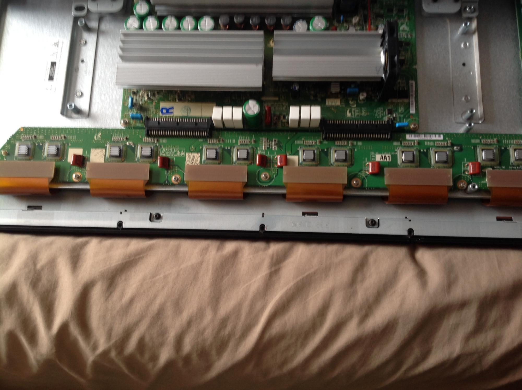

                                        Re: Samsung HPT5054, HUGE PAIN IN THE ASS
                                        Heres an image of one I did last night, added fan to the heatsink with the commonly failing fets which you should test.
