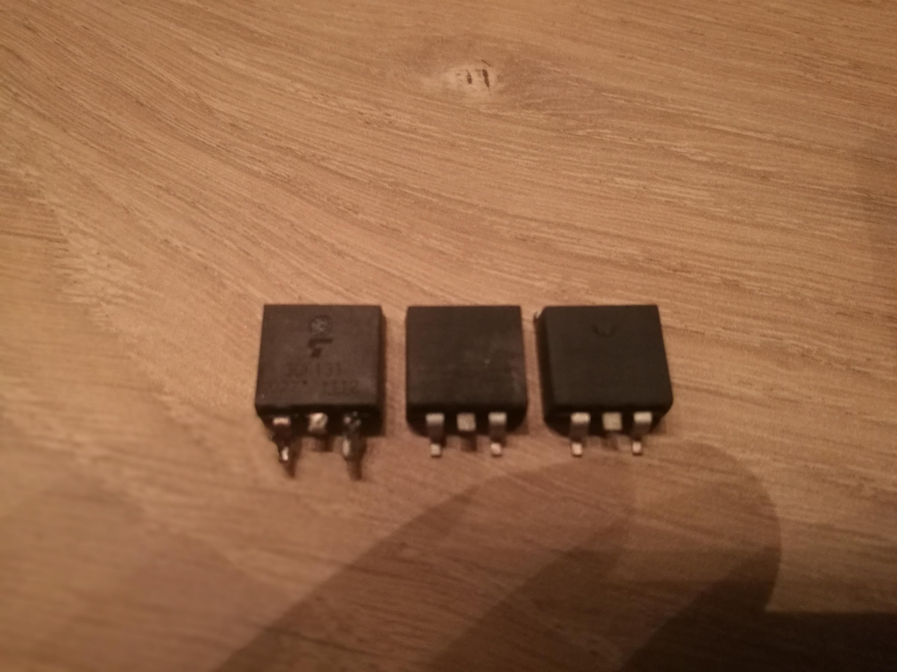

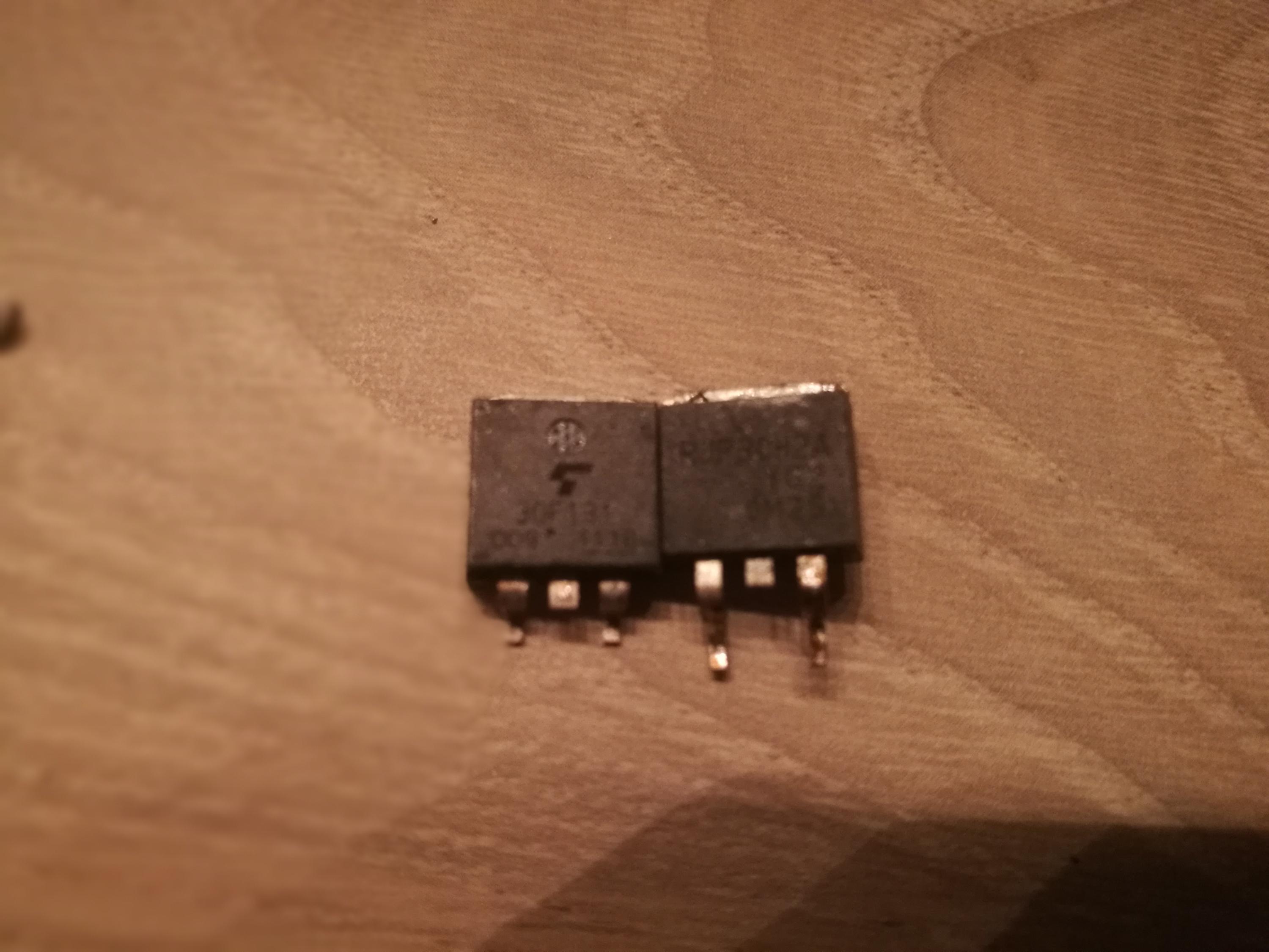

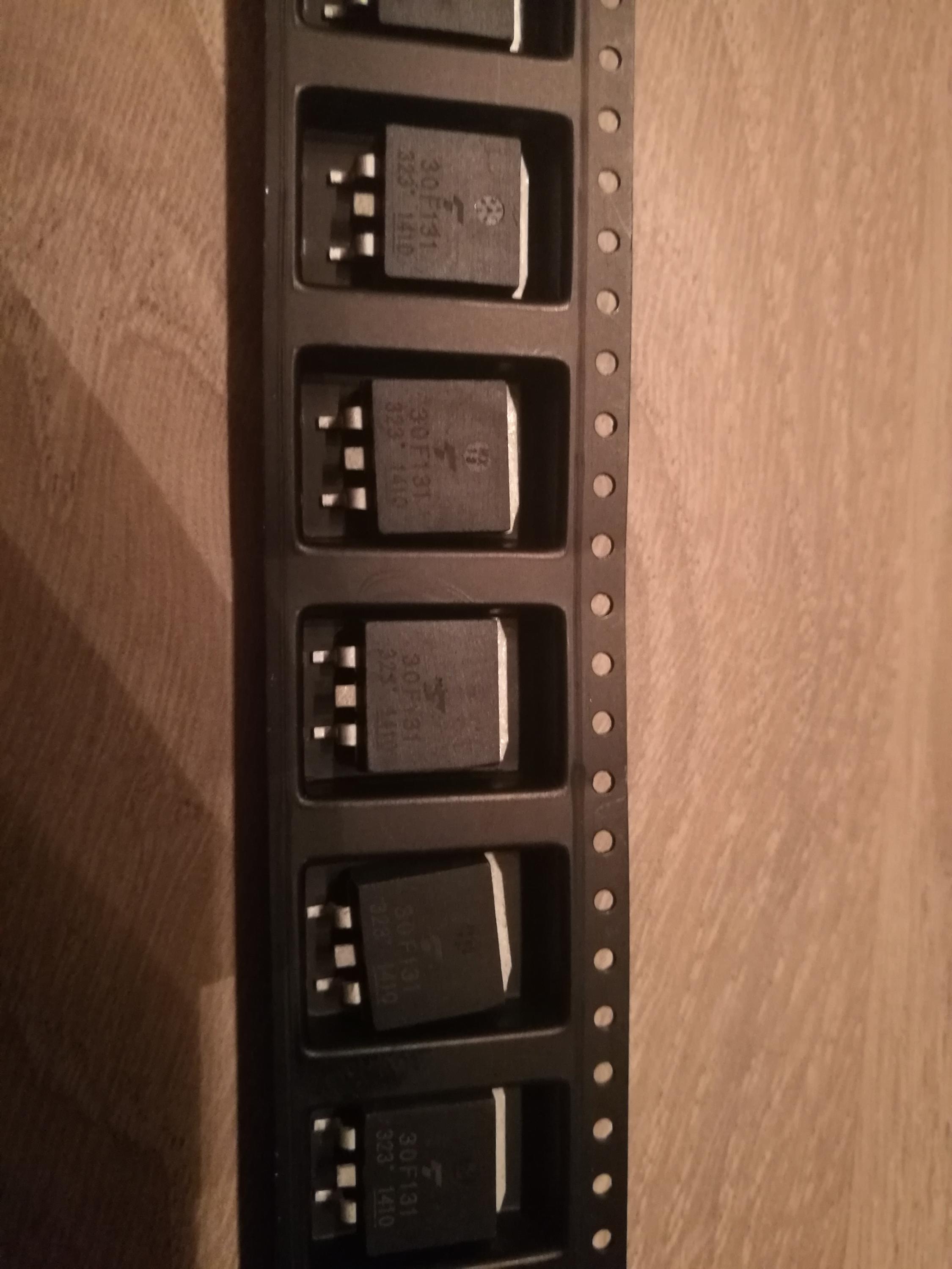

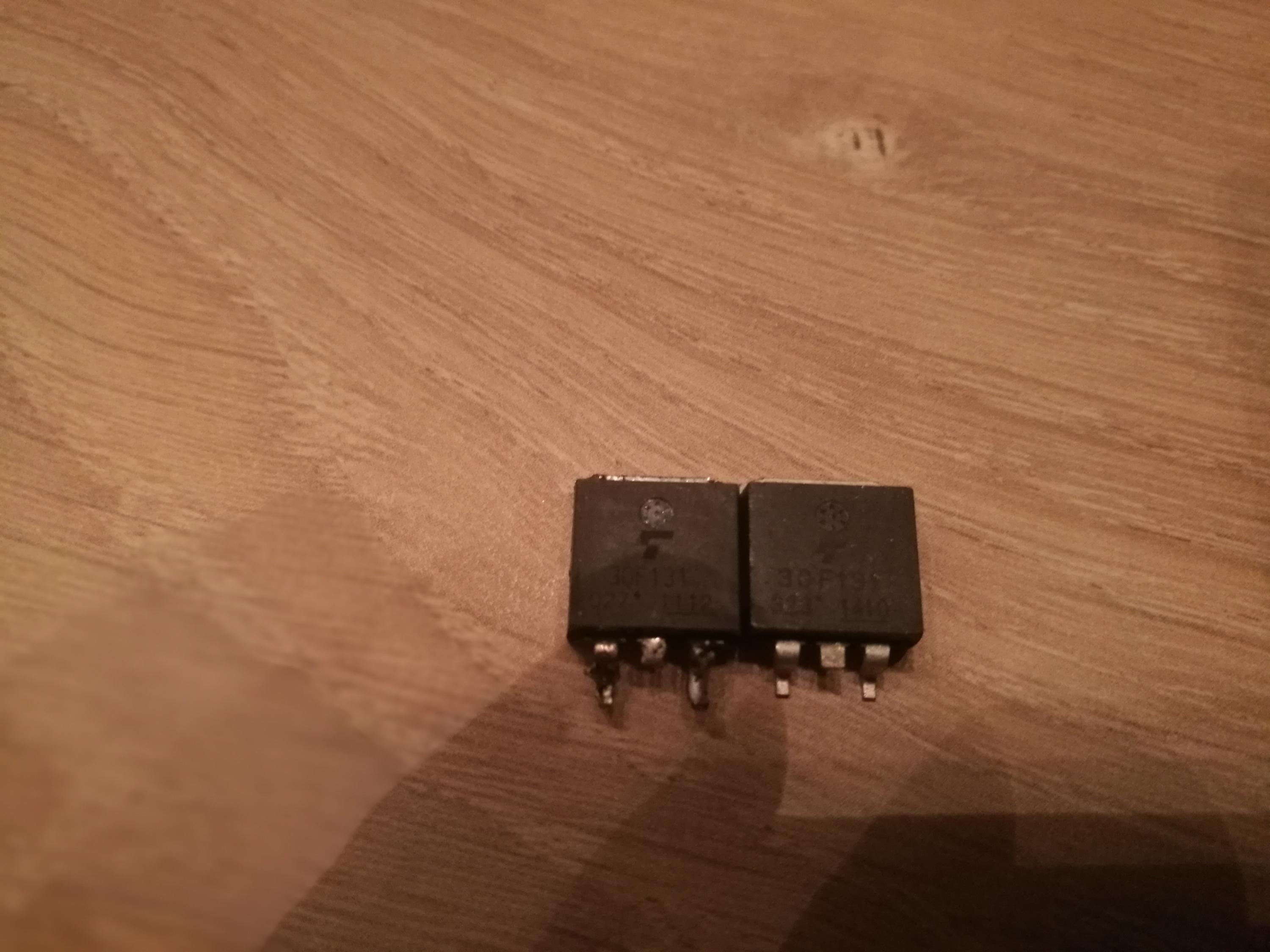

                                    Ok i already ordered those but also from Ebay so im wondering if they are the real deal! Damn , if i knew this before then it would have saved me so much money and boards. I was really doubting myself but the fake parts got me off track. Even after replacing all igbts , diodes and the ic's the boards kept popping. ( Even small fire!!!! ).
                                    Anyways i found out how to spot the FAKE igbts and took some pictures. The key in this situation is ISOPROPANOL!
                                    In all pictures i used the original 30F131 on the left and the fakes on the right. On 1 picture you can see both igbts with and after cleaning it with alcohol. As you can see the original igbt has the same logo and circle and the other ones are almost gone.
                                    The original igbt has a small circle stamped into the igbt and has a big F close to the circle.
                                    The fake igbt has a circle but its not stamped into the igbt and has a smaller F.
                                    Also take a look at the package and see the differences in logos. All have the same numbers on the bottom.
                                    The fake? RJP30H2A has MUCH longer legs then the original Panasonic 30F131 and also blow if i replace them for the 30F131.
                                    Man , it feels like throwing money into the garbage bin and i just ordered 50 of those RJP30H2A because i thought that was the solution for the fake 30F131
                                    Hope this helps for someone else!!
