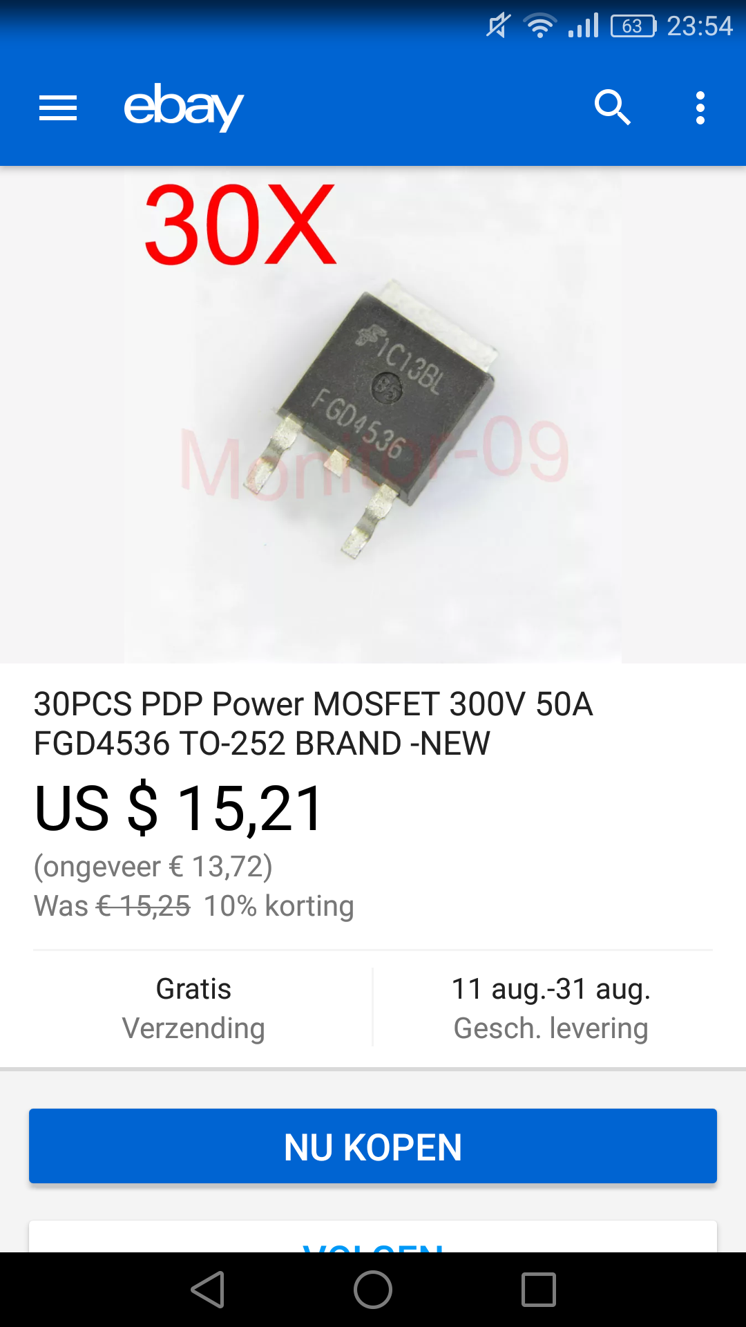

              As i dont have a creditcard i cant buy parts from mouser. Looking for a different source and found this on Ebay.
              Reliable or stay away from this? Seller is Monitor-09

                The FGD4536TM came in the mail today. Ordered them from mouser and i rebuild the board with the parts. Had to replace almost every diode/igbt on the board. Even the RJP63G4 was short.
                Tv is now up and running! Thx TW2005/Flocko for the part name
