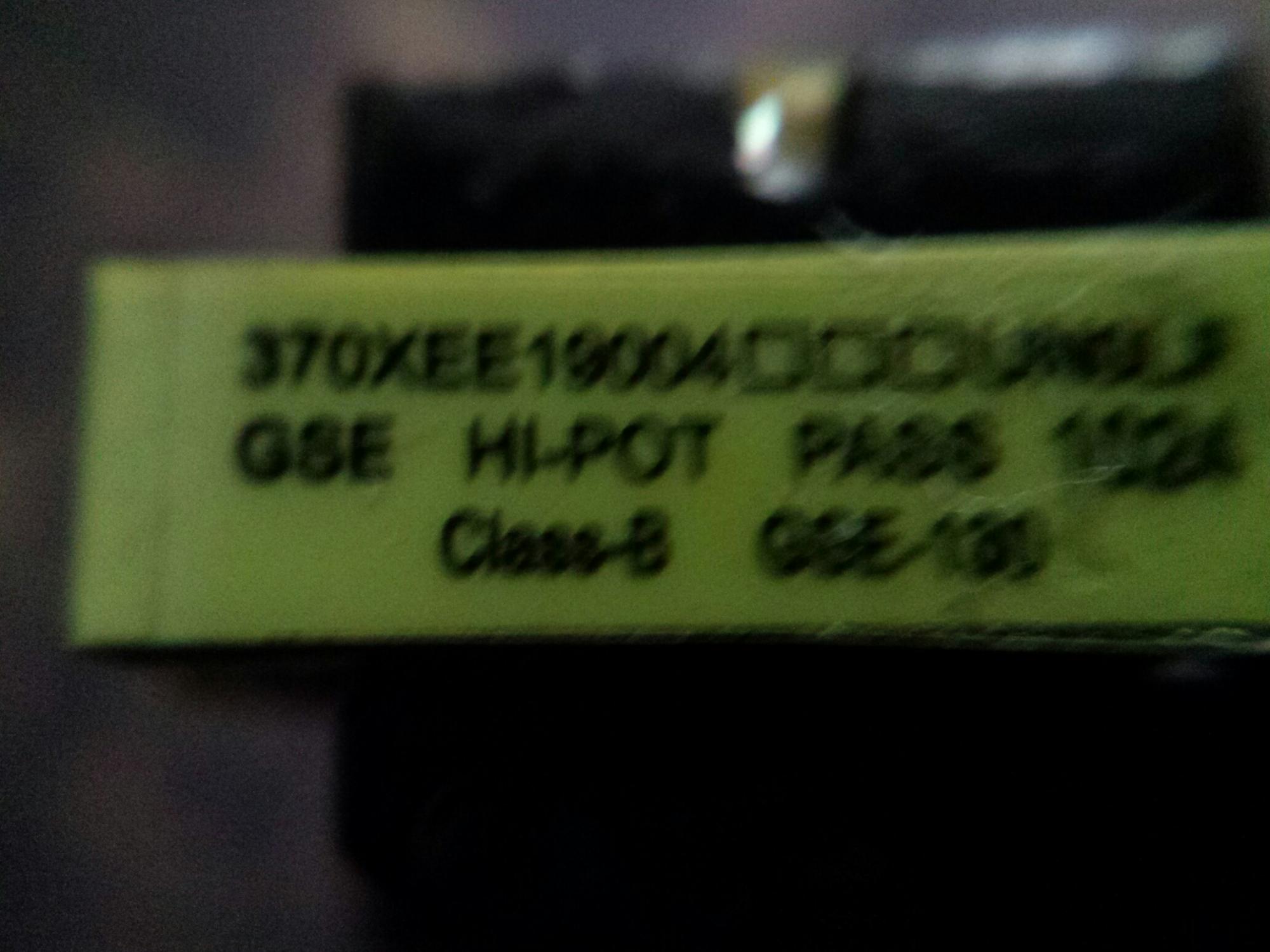

Can anyone id this transformer and where it can be located for sale? The model is 370XEE19004 and found in a Toshiba 26C100U. Thanks.

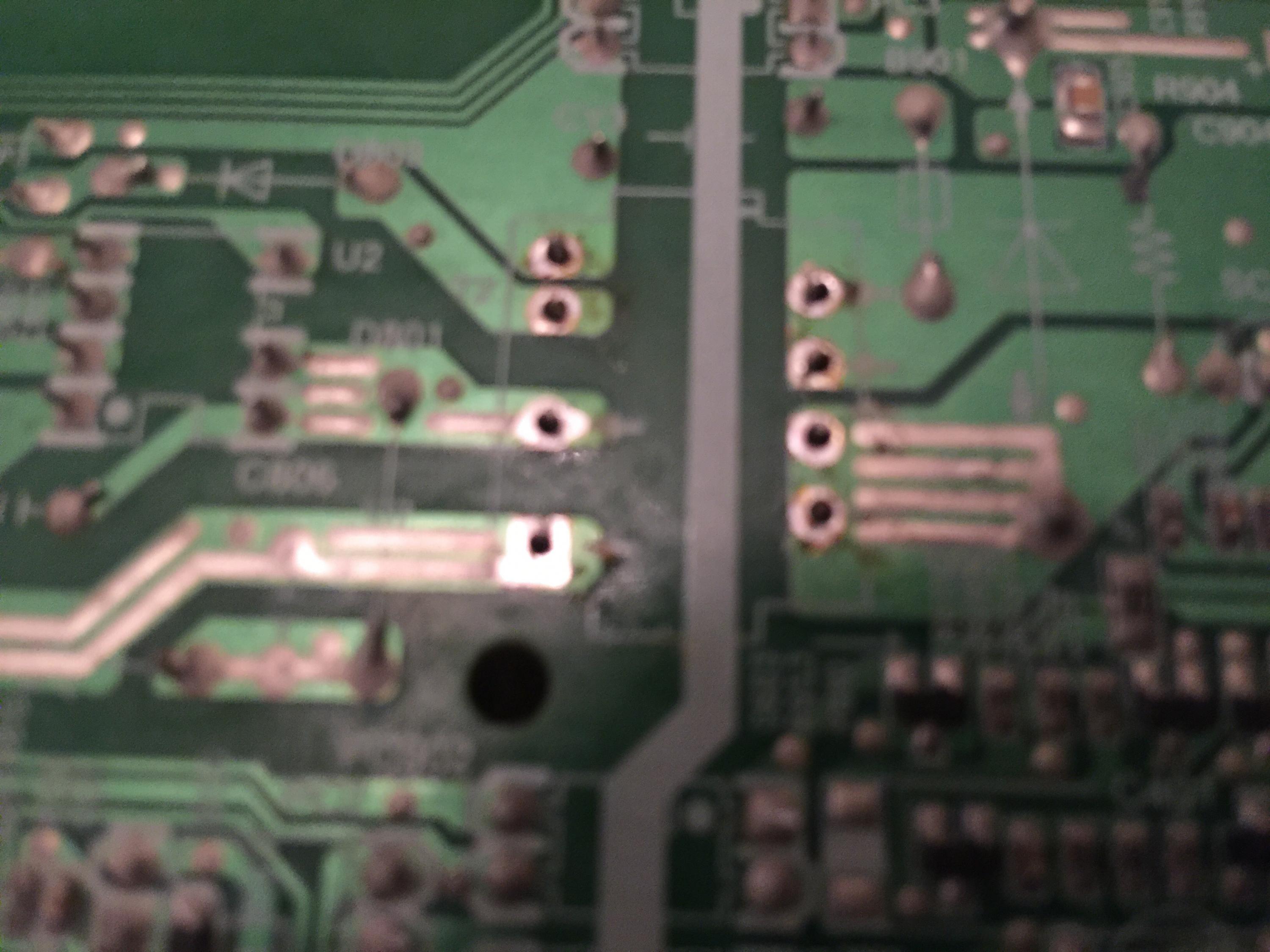

How about the pictures of the bottom side of the board showing the pins you measure the resistance? There are at least 3 windings on that transformer.

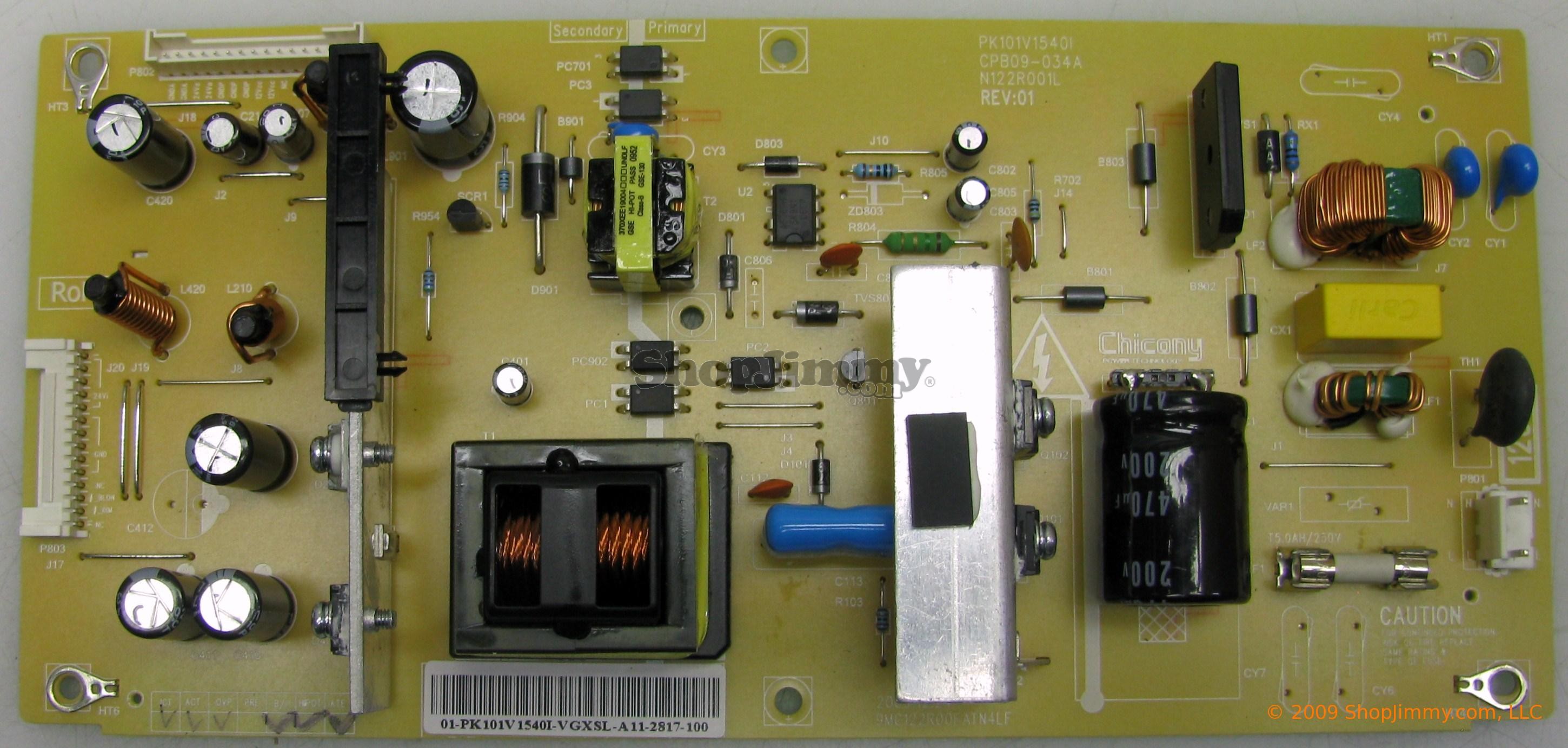

Toshiba PK101V1540I
http://www.shopjimmy.com/toshiba-pk1...upply-unit.htm
Pictures provided by shopjimmy.Attached Filesif you find these attachements useful please consider making a small donation to the site

Will do my best to get some pictures up asap. There are no pinouts on this particular board. What i do know is that pin 4 on the other board provides drain and startup current for the A6069H pwm ic. Pins 4 and 6 are together reading 2 ohms. The suspected bad transformer reading is high resistance on the same 2 pins. Same ic on both boards. Also tested with a blue ring tester- bad Q. Thanks Bud.Comment
Re: Transformer ID
DCR Reading 2 Ohms are normal for this kind of transformer, what I an interesting are the pins that you said it has high resistance.
I can look at the bottom side of the board to figure out the pinout of the transformer.Never stop learning
http://www.badcaps.net/forum/showthread.php?t=24809Comment
Re: Transformer ID

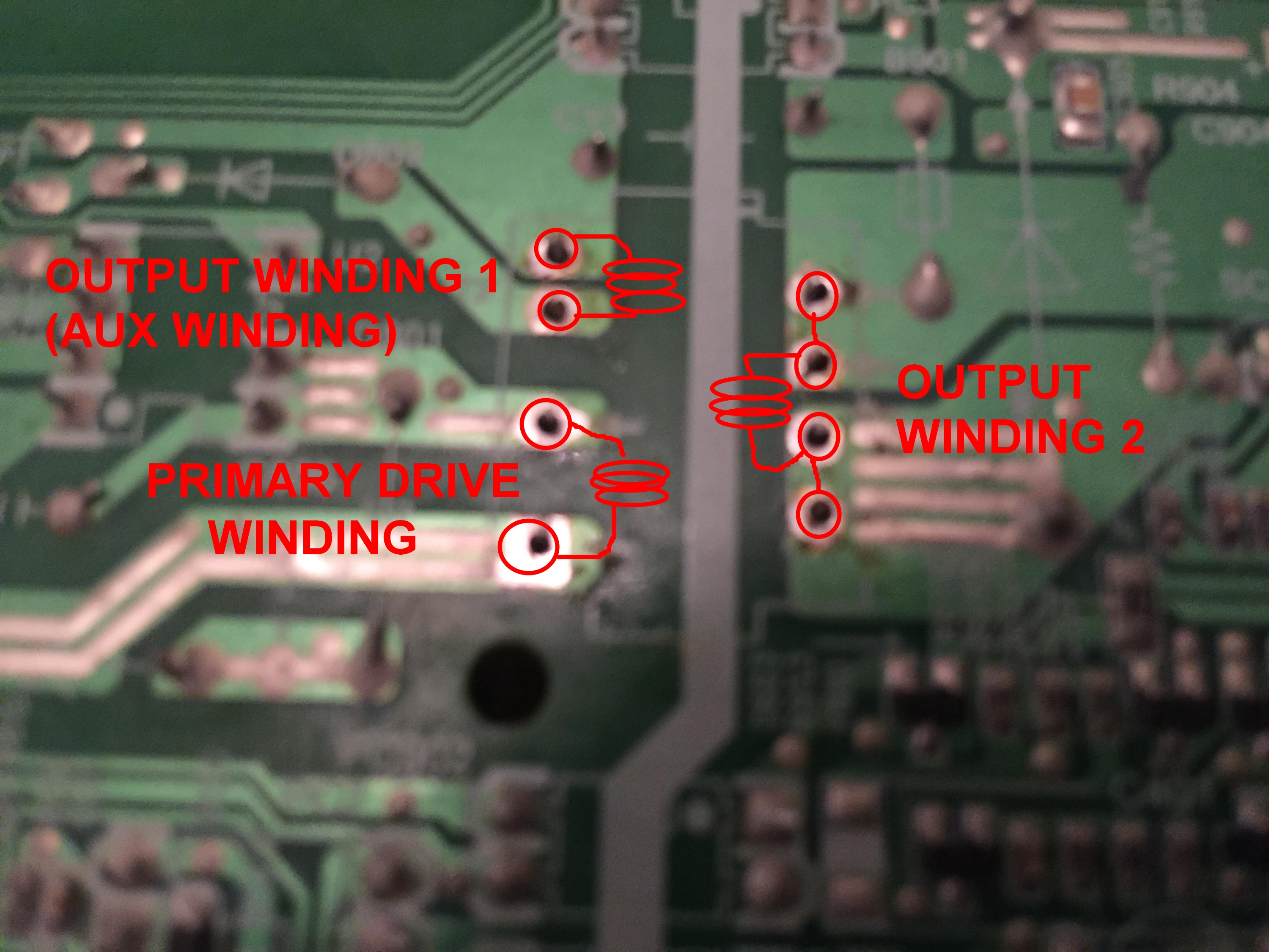

So it has 3 windings.
which one showing high resistance?Attached Filesif you find these attachements useful please consider making a small donation to the site
Re: Transformer ID
So the transformer is fine base on my pinout, right? I doubt that you have bad transformer. You better check the rectifier diodes on the secondary side, check the low resistance on the output filter caps to see if the loads have really low resistance, check the DCV of the SMPS IC, start up/running cap, etc.Never stop learning

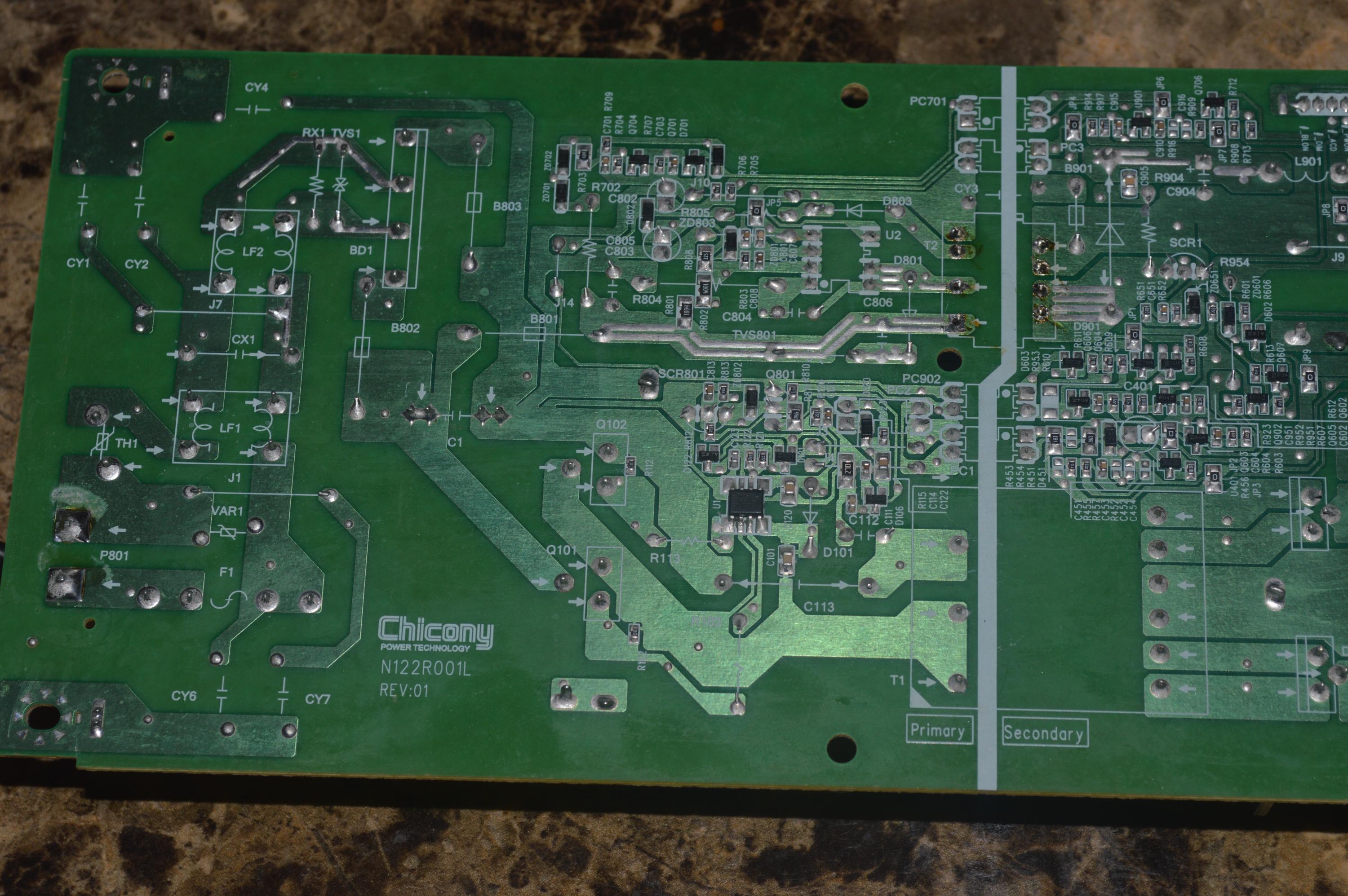

I will need good clear pictures of the bottom side of the board this time to trace out the connection between the D pins (pin 7, 8) to the + leg of the main filter cap to see if there is a fusible resistor in place or not.
Also check the resistor R702, 804, 805 to see if any of then show >10 Ohms.Attached Filesif you find these attachements useful please consider making a small donation to the site
Re: Transformer ID
OK, so there is no fusible resistor between the + leg of the main filter cap and the leg of the primary drive transformer winding.
So did you solder all the transformer legs back in place and find out if you will get the 160VDC on the drain pins (7, 8) of the SMPS IC?
If the primary drive winding as I show in the pictures has very high resistance then it is bad which will explain why you do not have 160V on the drain pins (7, 8).
BTW, if the winding is bad, you may be able to look real close at the pin to see if the magnet wires are still connected to the pins.Last edited by budm; 07-15-2016, 10:32 PM.Never stop learning
