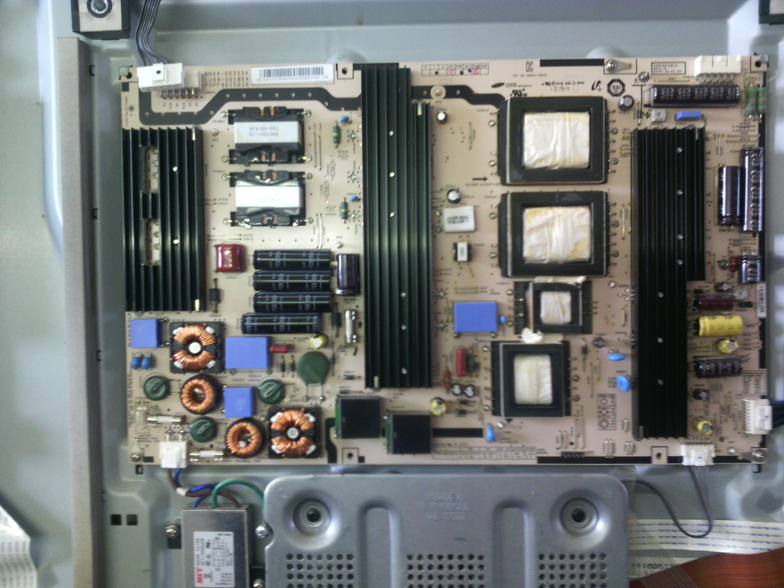

    This set has standby and sound but at switch on the Va Vs immediately shut down from their respective voltages. Low voltages remain on. Same happens with y and z connectors removed. Looks like protection comes in straight away
    Tested all diodes and fuses nothing obvious seen on the board BN44-00333A or LJ44-00185A. The screen is blotchy on outside due to using water to clean it according to owner ???!!!! Will put up pic of board later but anyone have comment on this meanwhile?
    Re: Samsung PS50C7000YFXXY powerboard

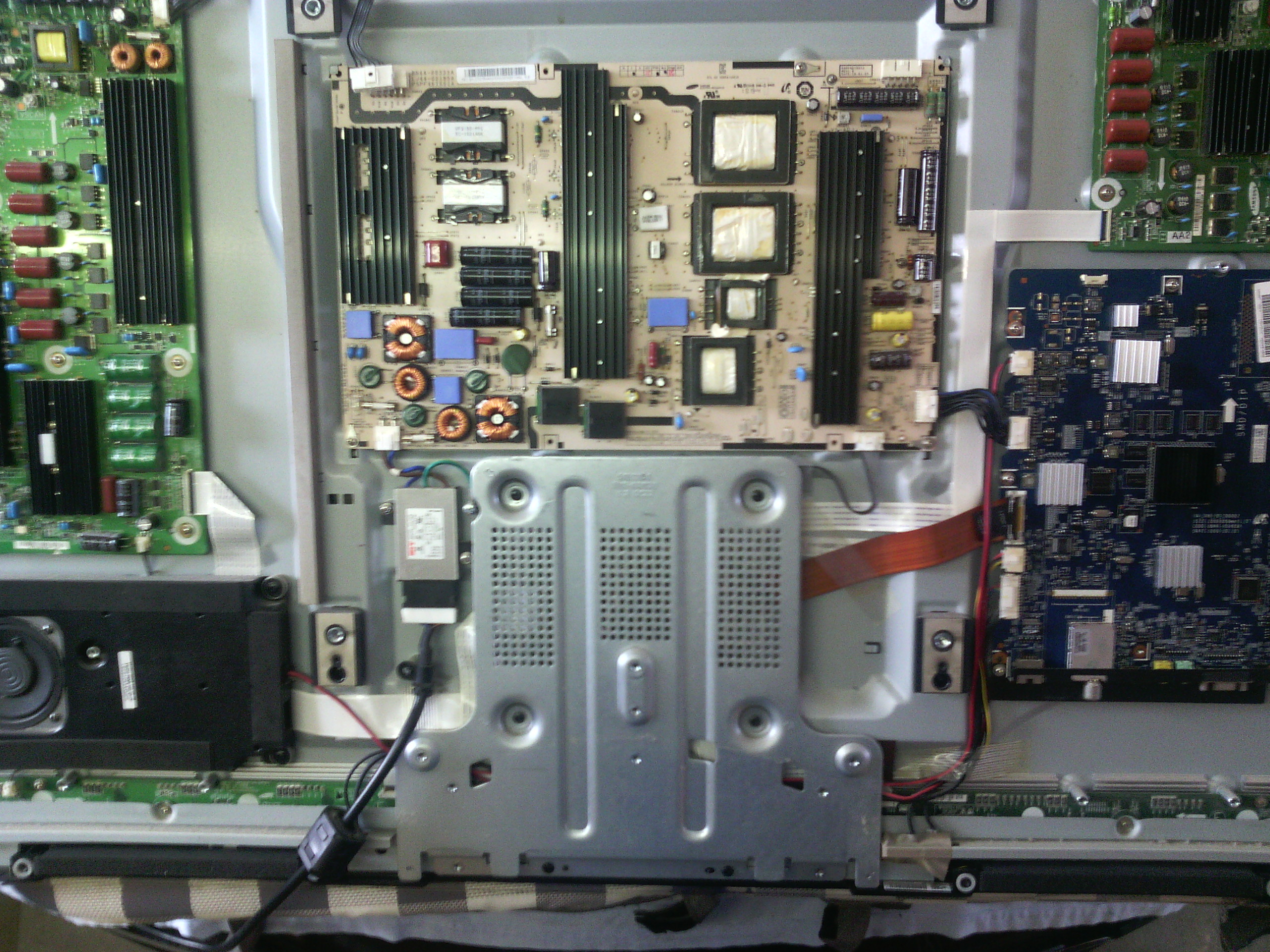

    Have had the board out and checked as much as I can but problem remains. Seems to me that as Vs Va come up then the feed circuit is ok but as the 2 x 180uf caps immediately discharge its either them or perhaps det circuit problem. Dont have 180uf would it be ok to test with 150uf or 220uf ? Pics herewith
      This set looks to be about 5yrs old in manufacture owner said it was a bit over 3yrs since they bought it new. In another recent thread a post says that recent Samsung plasma sets have the Vs Va shut down if the respective boards y and z (x) are not connected. If this is so for this set then my conclusions re power board problem are shot. Any comment or info appreciated thanks.

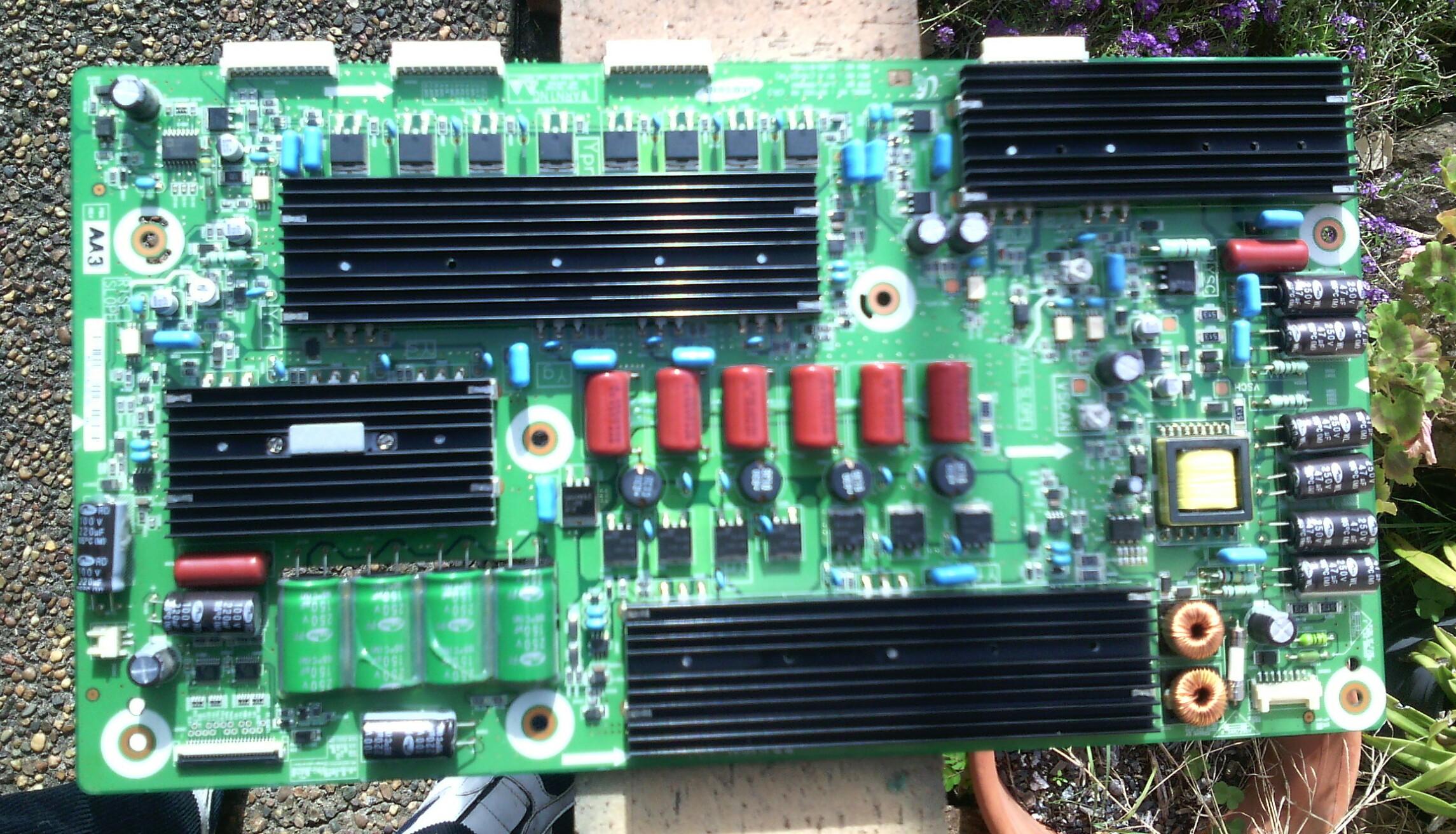

        Well getting nowhere with powerboard so removed heavy metalcover from over logic board.Noted green light flash sequence of about 5 sec on then 2 off which didnt seem right. Disconnected power feed and ribbon cable to logic - now green light flashing about every second which is normal. Seems the problem is with Y side main and or buffer - opt for the main.Cant find any obvious problem and no idea on tests other than fuses and resistors which all ok. Caps look ok too. Pic herewith for any comment.

                Am waiting on y-sus from UK. Meanwhile my research has found that blink 5sec on 2 off does indicate problem with that board and normal logic board blink is one per second. Codes changed 2010. Should have researched fully earlier and not jump to conclusions based on previous results with similar faults.

                  I would think the fault is likely to be with the sustains or buffers, and 5 on 2 off is typical of what happens when in protection.
                    Final update (I hope) as the set is up and running again. But at first the new y sus didn't seem to work as the vs va turned straight off again so I removed it and the buffer board which I was checking for faults when I noticed a slight moisture coating which seemed a bit oily on top rear of that board. Decided to look at the rubbery sticky pad on chassis which the board rests on and sure enough pressing it showed up a small amount of oily wet discharge - gave all a good clean then reassembled and voila all good. The set has been in my garage for at least 5 weeks and all in dry area so these tacky strips may be the source of various shorts!!
