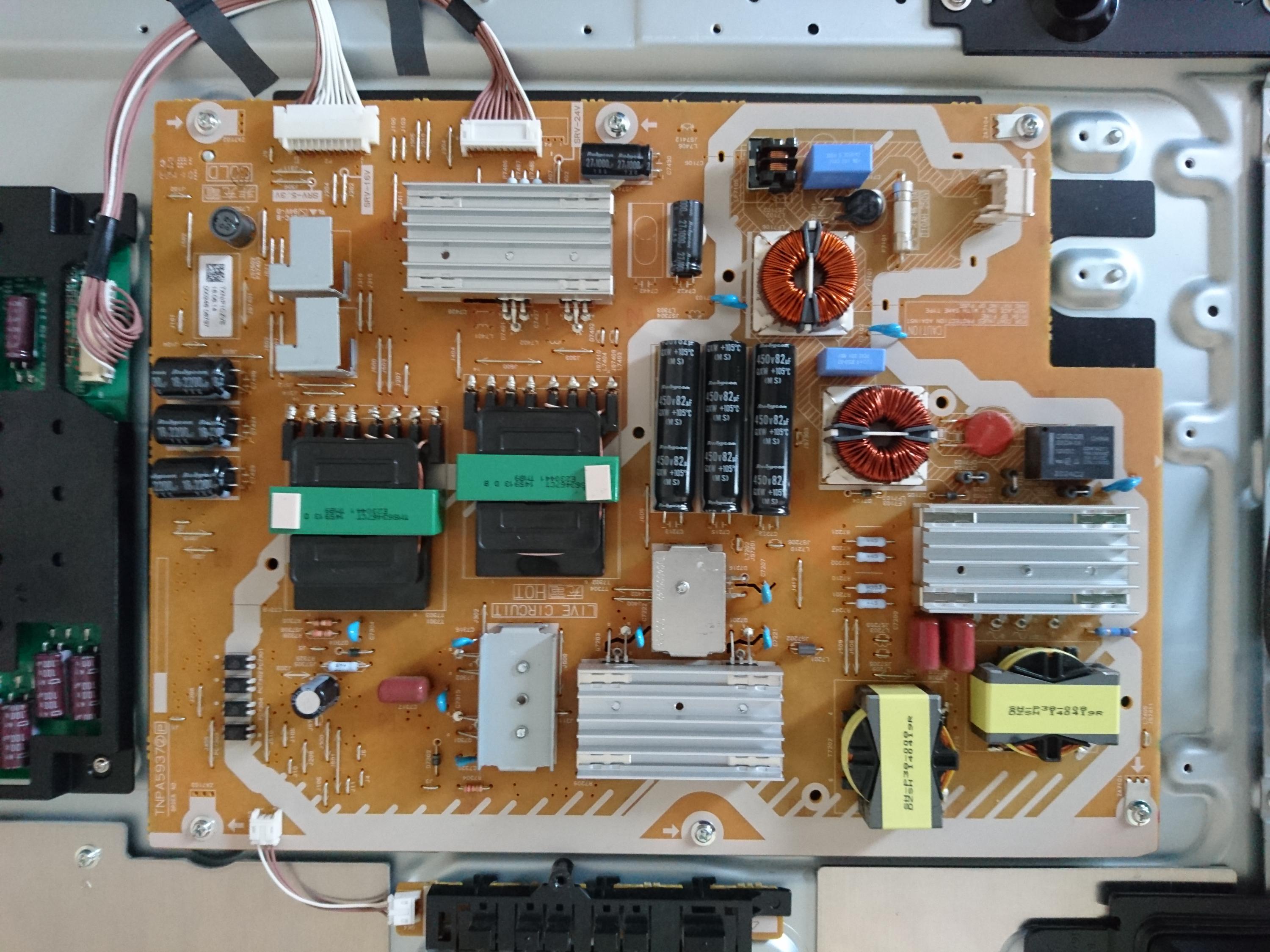

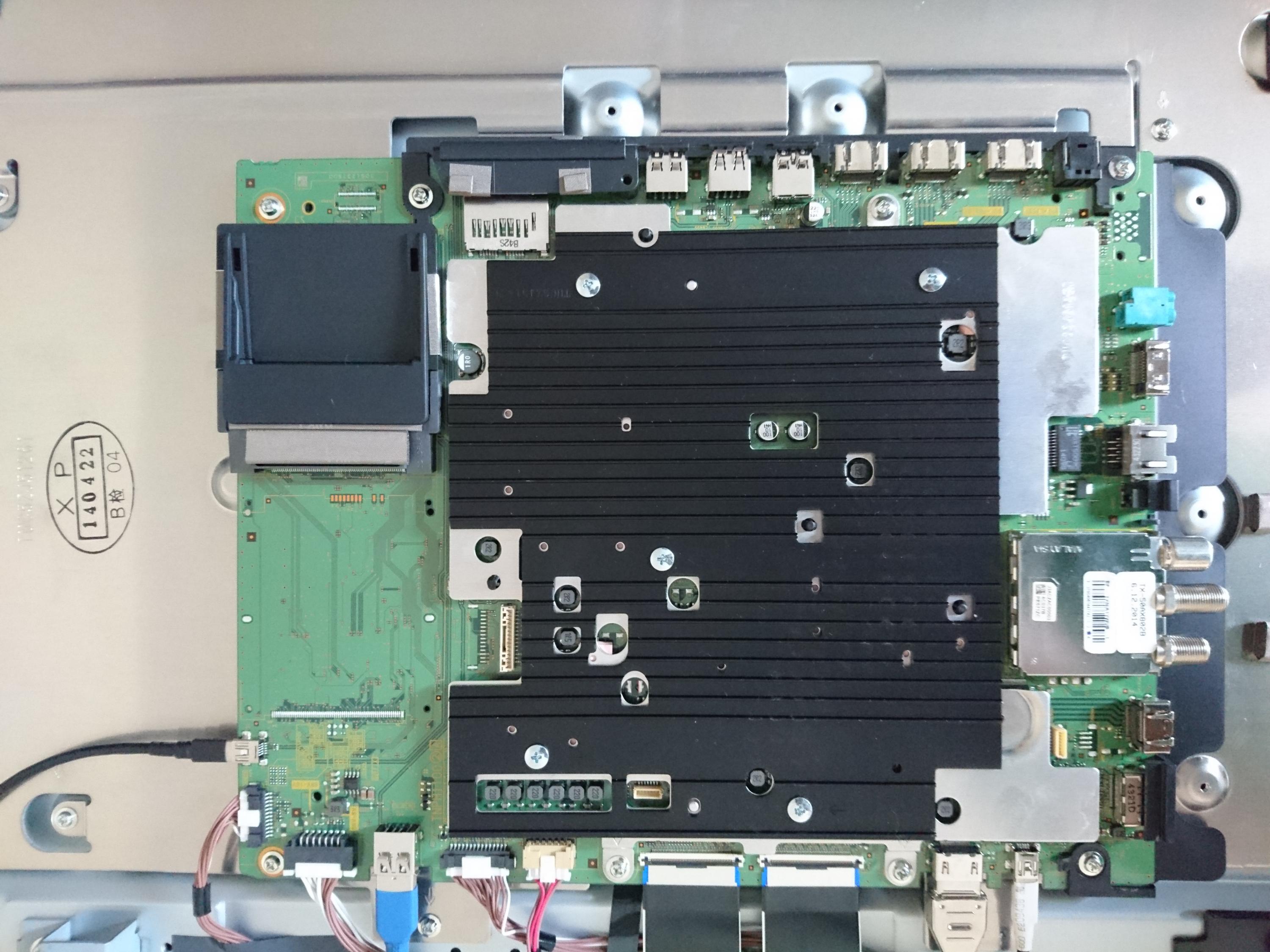

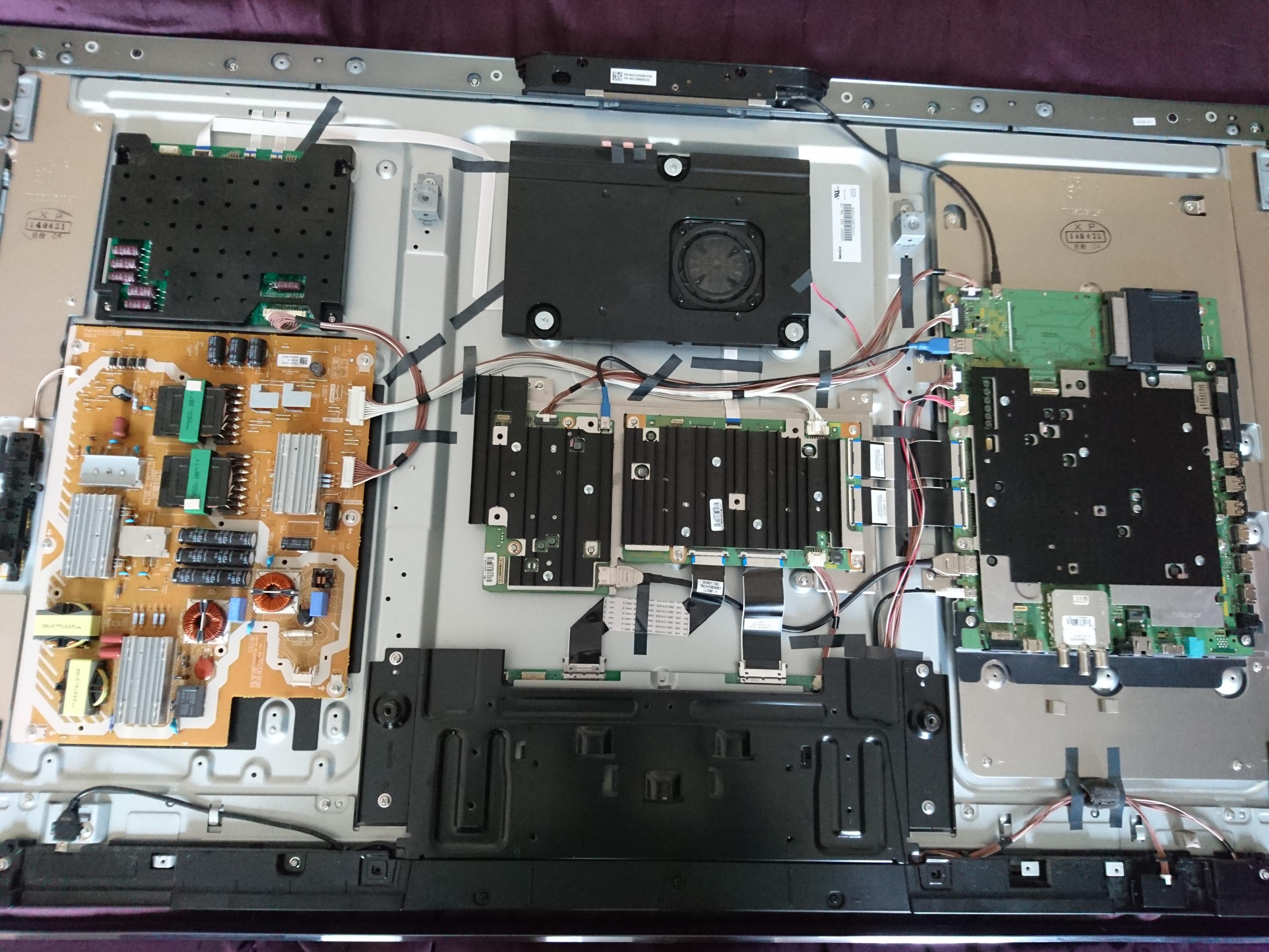

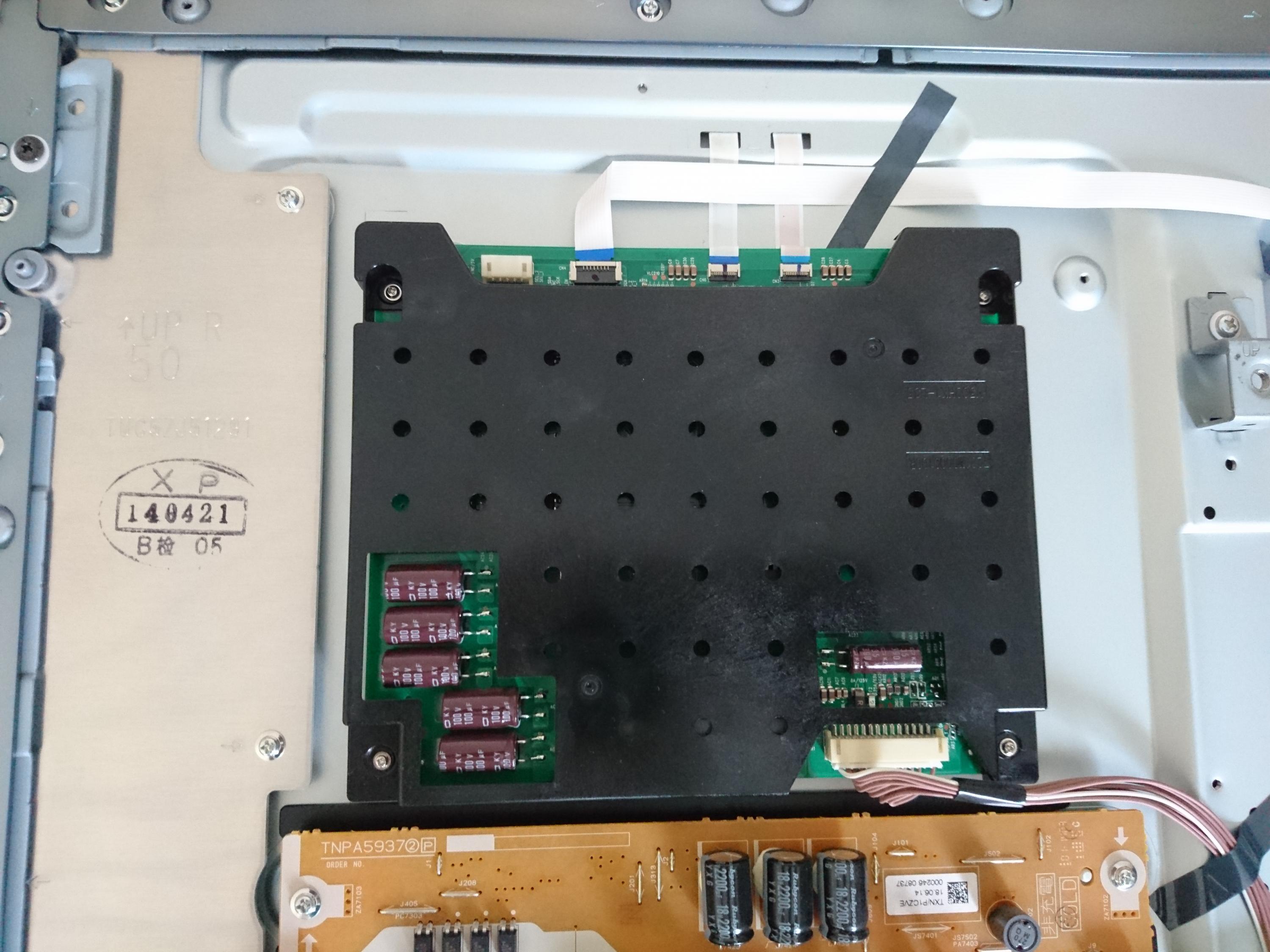

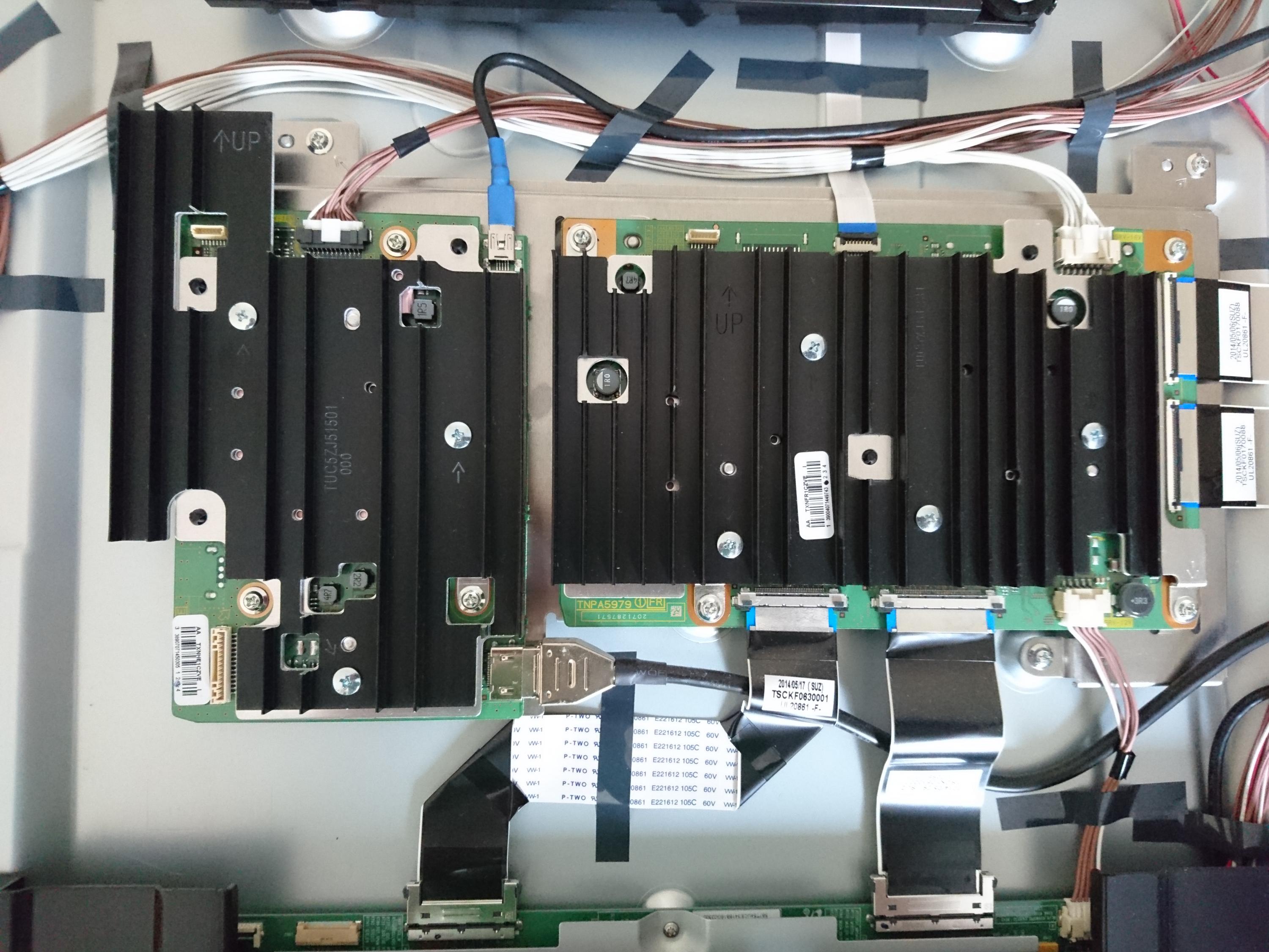

    Hello, maybe someone can help me, my Panasonic 50AX802B doesn't turn on from first time. When I turn it on I hear click, LED becomes green (blinks) and Panasonic logo shows on the screen, but few seconds later I hear a click and TV turns off. LED becomes red and blinks 5 times. Sometime it turns on from second time, sometimes I need to turn it on and off for 5-10 times, but it works finally.Can someone sugests what can be wrong with it? I have checked some previous topics, but I noticed that problems similar to this occurs on plasma TV. Is the codes for red LED are the same for LED TV? Thank You

    Sorry guys, the red LED blinks 6 times, not 5. I am attaching some photos of my TV. Really hope that someone can help me.
