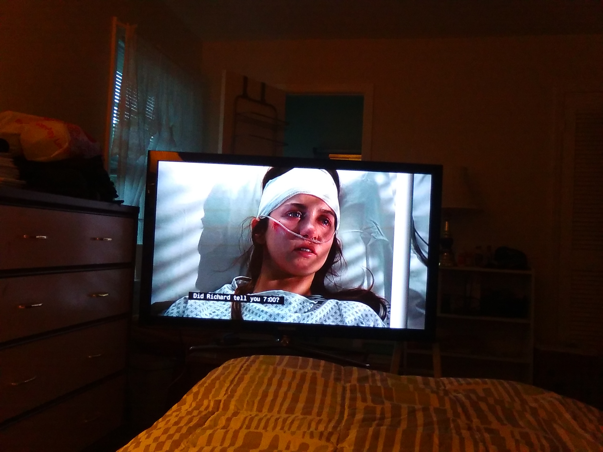

    I am working on a 50" Samsung Plasma TV about 5 years old. It has a bar that is prominent when you first turn on the TV that eventually fades and may disappear after some time. It is a vertical bar always in the same spot. Otherwise the TV operates as it should with all functionality. I have attached an image of the problem.
    I have worked on many things but this is my first plasma TV. I am in the process of removing the Y buffer which is easy to access and sits vertical on the left side of the TV board. That is the easiest buffer to remove. Parts list shows a X buffer but its buried at the bottom along the support strip for the stand, etc. Looks to be a bit of a chore to remove. I cleaned the TV from dust, etc. and checks for visual problems and none found so far. No obvious blown ICs, burn marks, etc. I am going to check resistance on as many of the boards I can access. The X board, if it has one, is buried deep.
    Thoughts?

    It looks like a bad tab on the panel. I have seen many with black lines. This is the first white line I have seen. Maybe tom66 will chime in.

      COF Chip on tab--Part of panel, Unrepairable.

        +1 you can handle it with easy light push on tap to keep it stable no line there.
          RUBBISH!
          Its the COF on the tab. Its Stuffed and no amount of shoving pressing or other pressure is gonna cure it!
          Its a cruddy C Series Samsung PLASMA set--NOT LCD!!

            Thanks guys.
            Well that is the worst of it when it turns on. After a couple of minutes it will dissolve and then disappear. Most problems that I have found due to bad ICs and broken bits the problem is steady.
            Here are a couple of pics in better condition.
