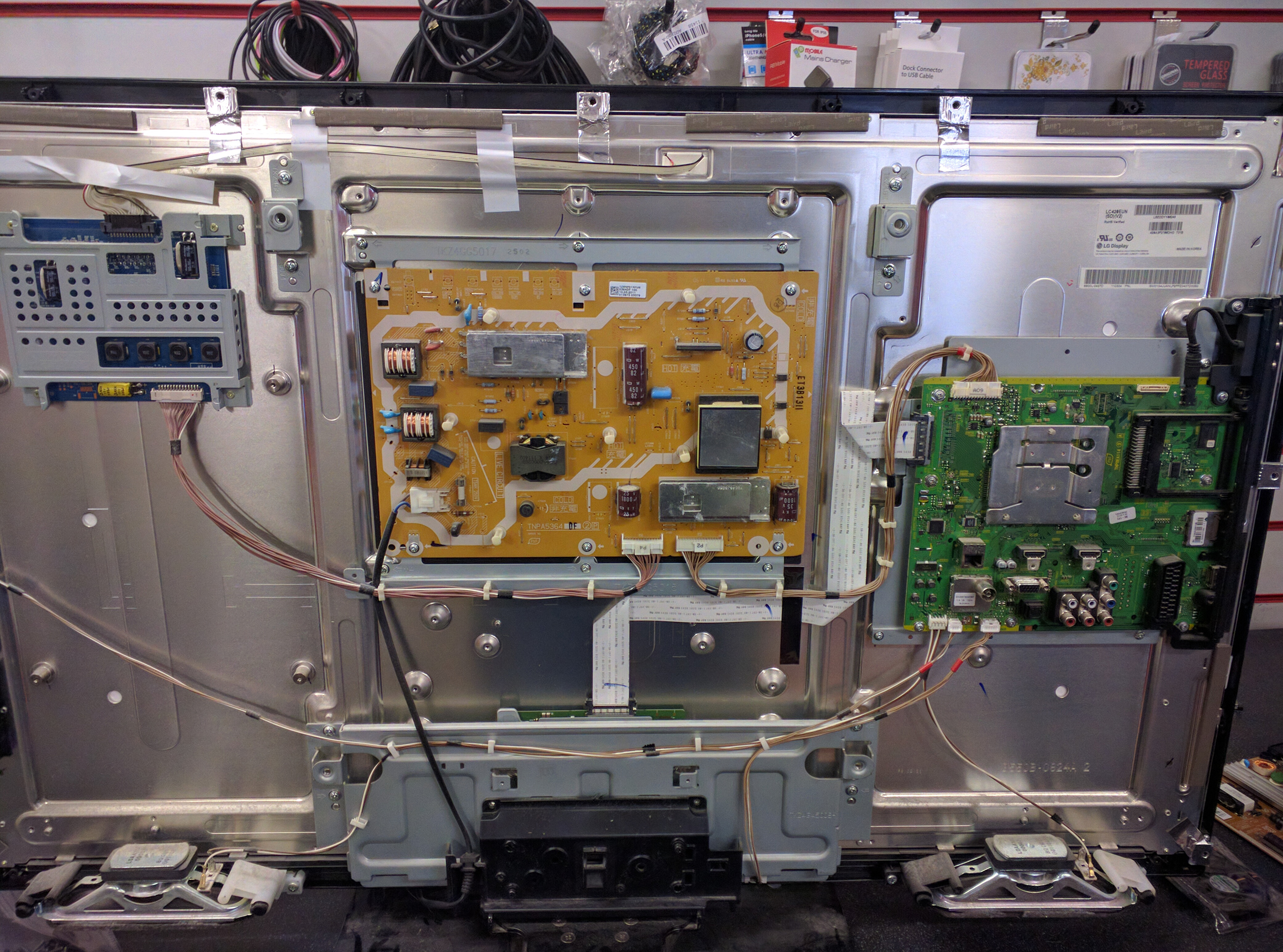

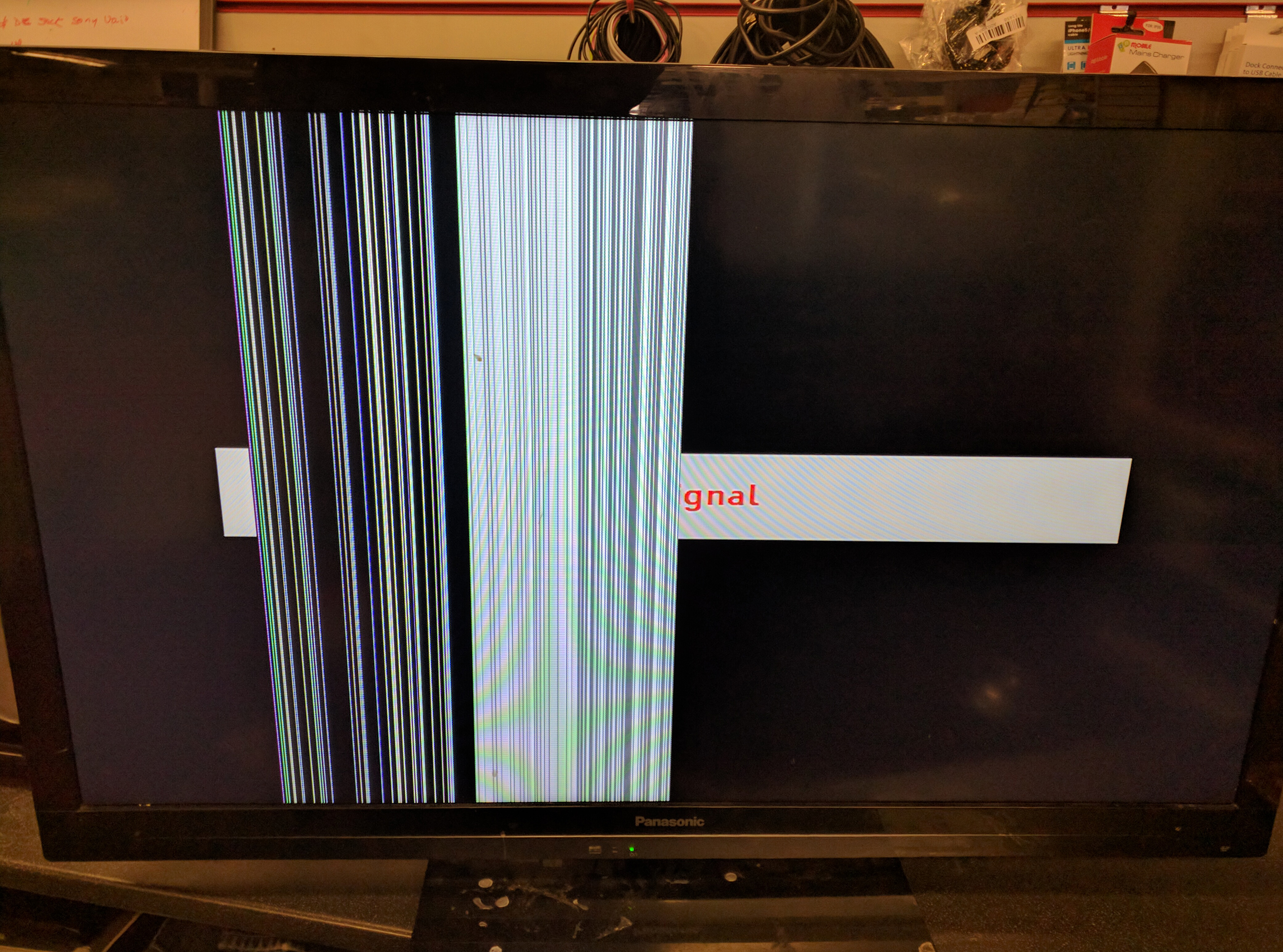

    Basically when a customer's tv has many lines on the screen it's a right off? I it fixable?
    See attached images.

    Yet another dead crappy LG panel I'm afraid...
    Probably tabs or the COF...
