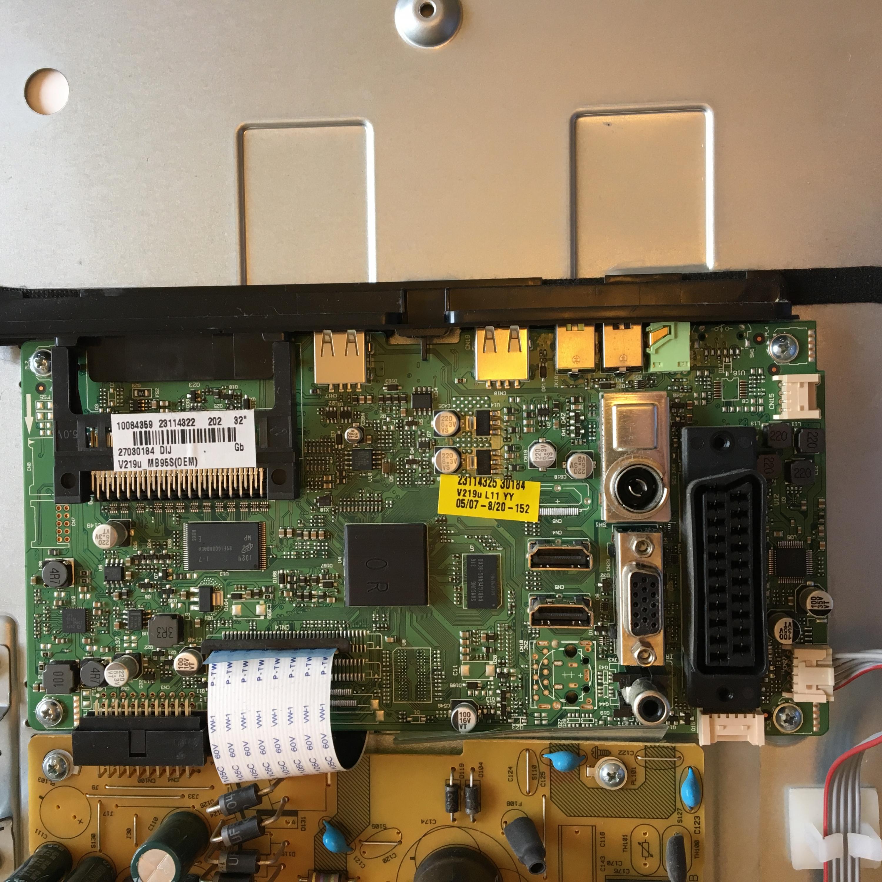

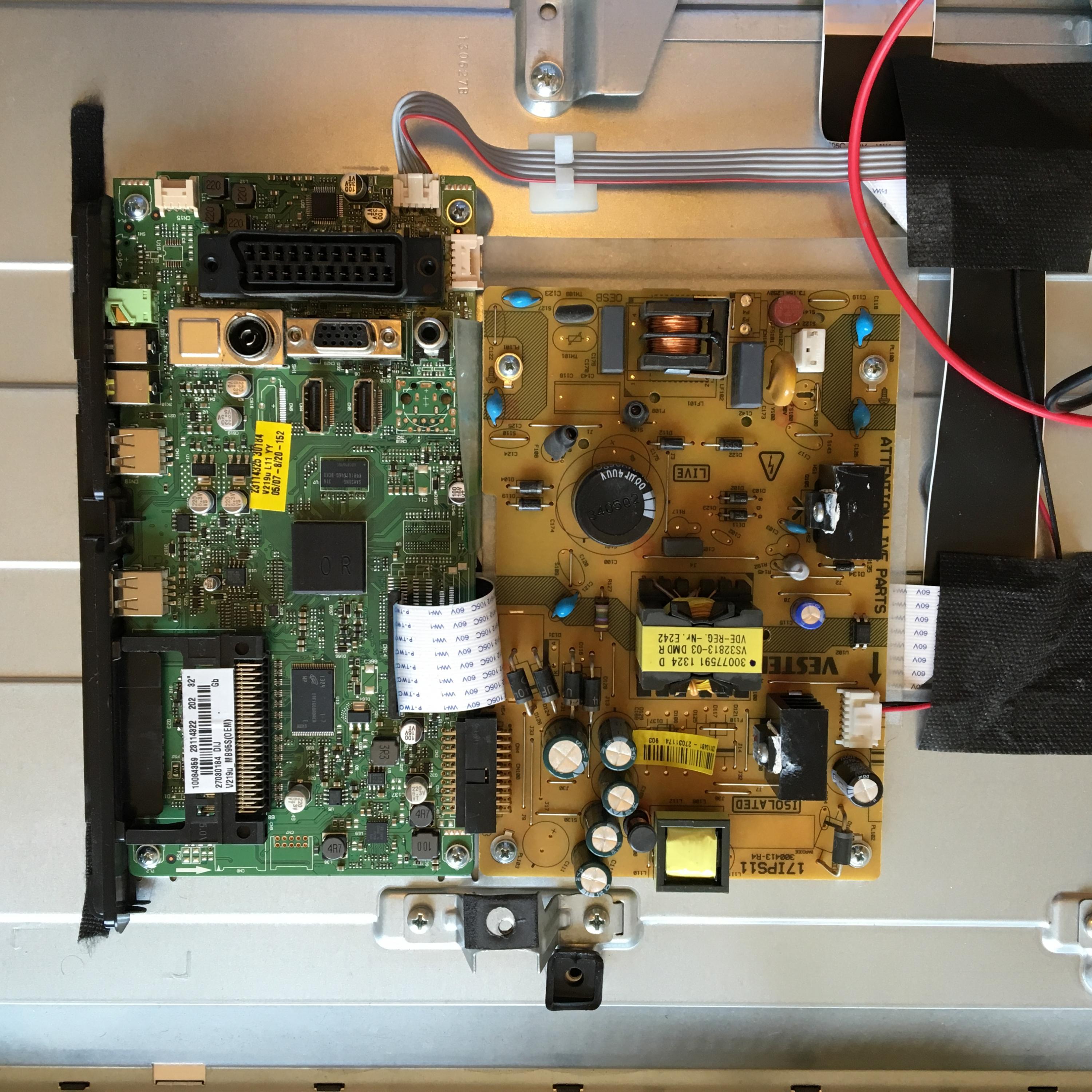

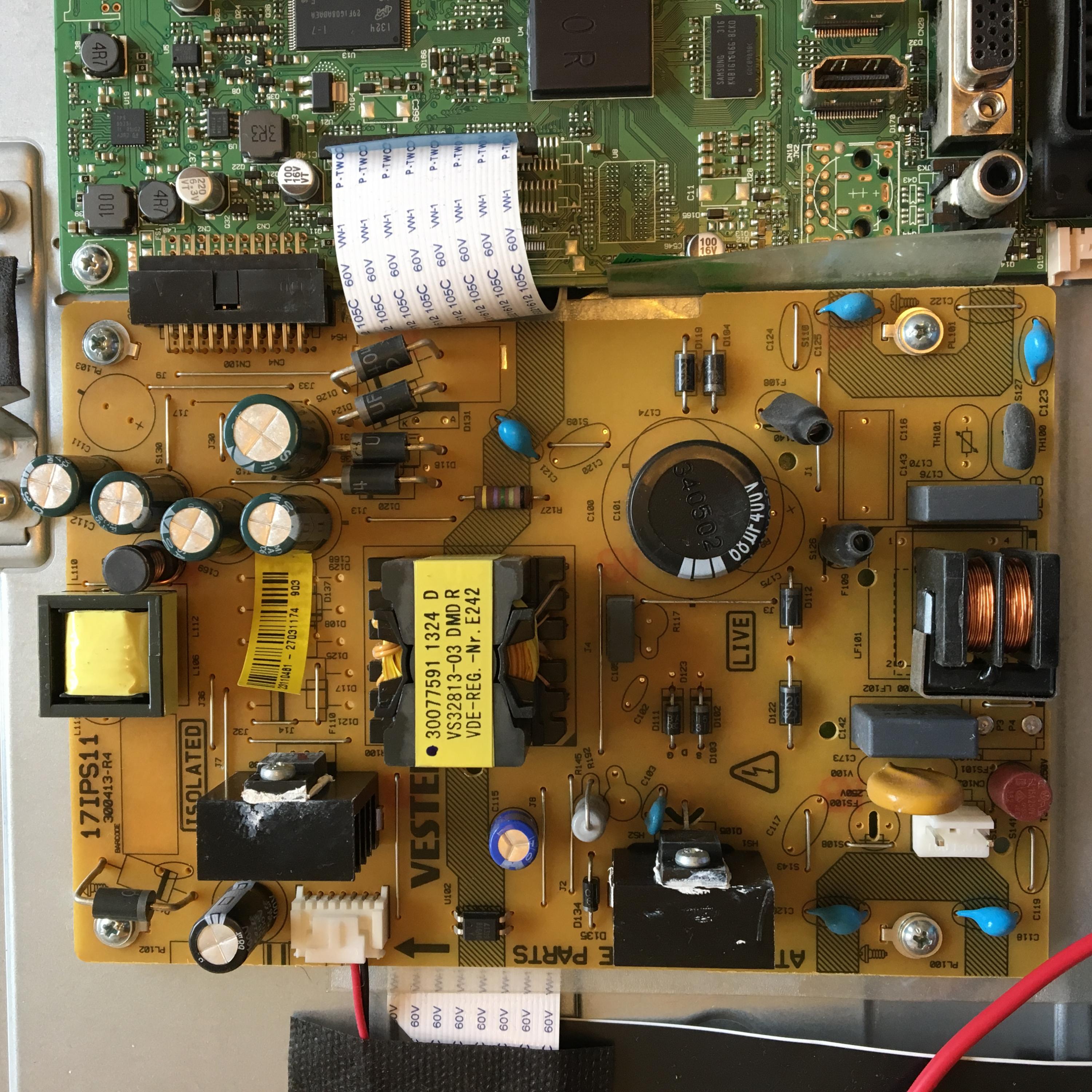

    Toshiba 32w1333DB dead no standby vestel again
    Hi, again looking for some help with a TV
    Toshiba 32W1333DB which has
    17IPS11 powerboard and MB95S mainboard
    when i got this tv it had a flashing red green standby light but NO power up.
    Since I removed the back cover of the tv I have lost all light from the standby led, however there are several voltages present on this power board
    have found 12v and 24v present at output pins
    any ideas where to start
    will put pics on asap

    Re: Toshiba 32w1333DB dead no standby vestel again
    17MB95 shit again ! Theres a SMD mosfet that should be changed or frozen to get the set working. I will link the repair kit on ebay for it. These boards are Vestels worst !
      Check out this repair kit, also if you buy it please can you tell us the part number of the mosfet and circuit number it should fix it from what I read. The seller is not giving out, I already asked him so can you extort it for us and help us lol Here is the link:

      • london-freddie
        • May 2015
        • 472
        pics
