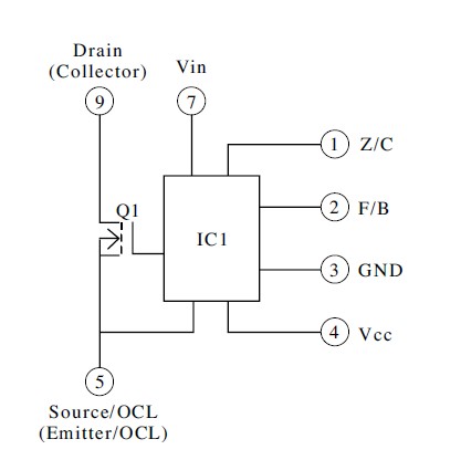

        I took dicks suggestion. When I measure the resistance now that budm asked for, it starts at about 4Mohm and then drops. Do I have to wait till meter stops?
          Re: Vizio VP422 won't turn on.
          That's good. That isolates on side of the circuit as being OK. Now measure the resistance between U8301 where budm has circled in red, to Point B

              Basically it's to measure the resistance of the circuit with the jumpers removed.
              1st reading between Point B and one side of the jumper
              2nd reading between Point B and the other side of the jumper
                If the MOSFETs are not shown as shorts then remove IC U8301, easier way will be removing the two jumpers wires for the GND return of the IC.
                I measured according to this picture. Meter stopped at 280kohms.

                    If after removing the links you no longer have 0.5 ohm as in the test carried out in Post74 then U8301 is short circuit and will need to be replaced.
                      So I should be able to replace U8301 and that will solve the psu problem?
                      The numbers on that are 80183 then under that MR4030.
                        Hopefully it should bring back your supplies. It would be worth your while checking the components around it.

                            Glad to hear that you are able to narrow it down to that SMPS IC by removing those to GND return jumpers, now you have some idea how we go about isolating the circuit to locate the shorts.

                              I didn't remove the jumpers budm. I cut the trace on the bottom of the board.
                              Much easier, I can lay some solder on it or jump it with a wire.
                              My question now is, is that component the only shorted one.
                              I know what we did but not really how that tells you guys what is shorted.

                                        Budm traced the circuit out for you.
                                        From the large capacitors which holds the rectified AC (now as DC) coming in from the mains supply, he traced it to the fuse and from the fuse to a transformer winding.
                                        The other end of the transformer winding is connected to the IC.
                                        By lifting the ground from the IC any short circuit in the IC to ground was now broken.
                                        You no longer measure 0.5 ohms so the IC must have been shorted to ground.
                                        The IC if you look at the data sheet has an internal Mosfet and it is this which has probably gone short circuit. The 0.5 Ohms measured is probably the transformer winding resistance through the shorted Mosfet (IC) to ground.
