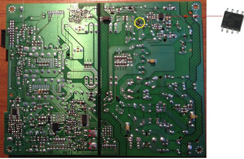

      this looks like the ic check on your board that it uses this ic it may not be faulty yet tests should prove either way

            Here's my board
            ic probably on the underside?
            how do I test this? (also what does an led mosfet look like?)

              i hope so too the trouble is when we zoom into your pictures we cant see the part numbers etc on the ic s etc so it makes it hard to see what particular ic s etc are fitted on your psu can you try re uploading them maybe try this , click on go advanced then theirs a paper clip icon click on that and add your pictures that way.

                the information of the ic is very small so it may be a problem but the one above has 6300A MYC on it (I can only just make it out). but still haven't found the problem so how do I test this (do I need it plugged in?)

                    If you have no DC at the output then I would consider replacing the FAN6300A

                      Thanks dick-barton you have more experience than i have in repairs, i did advise to replace that ic and added a link, but he could not find it on his board? hence i asked for better pictures so we could point out the ic.
