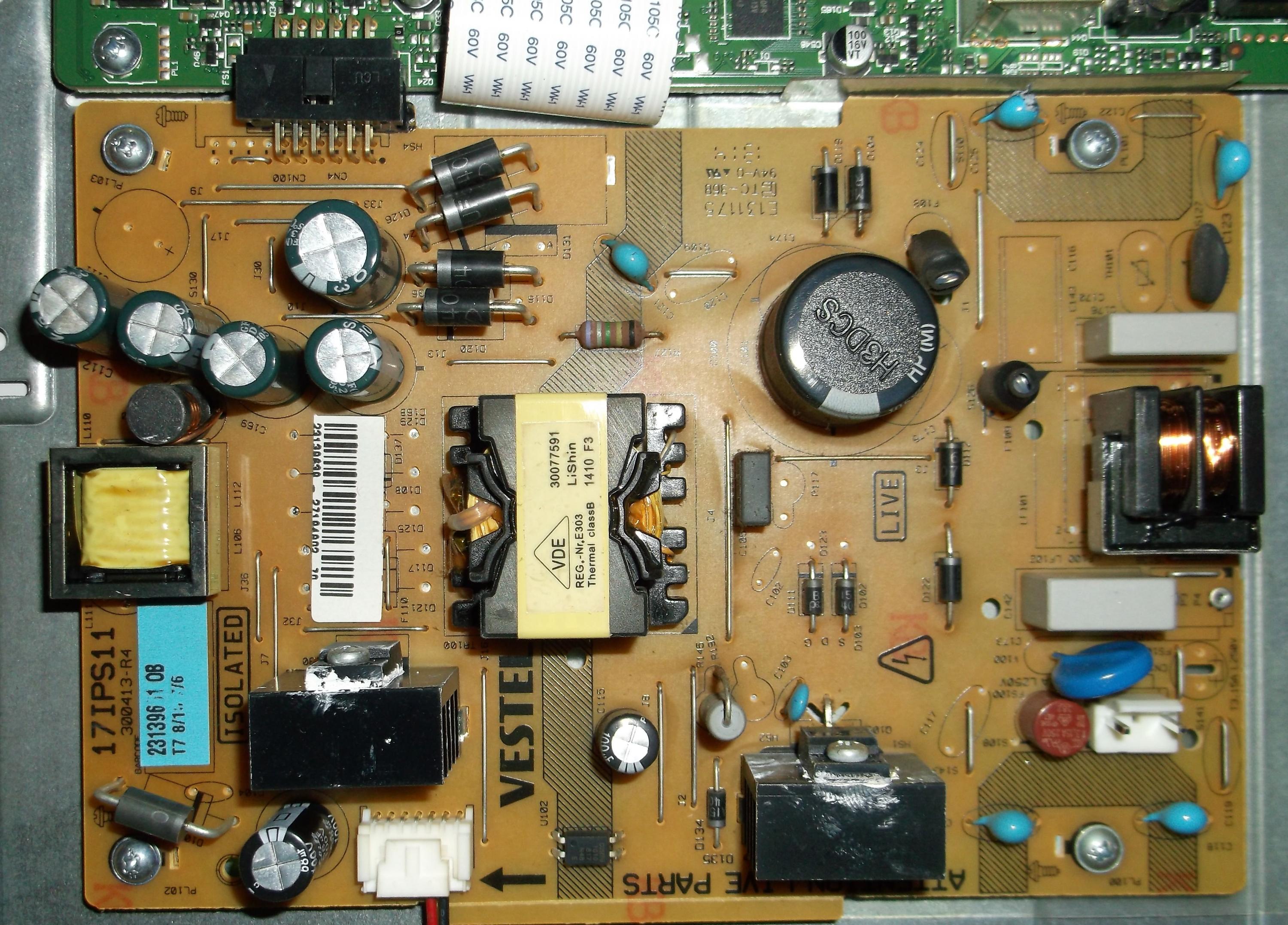

    Hi, folks i have a problem with this TV it has no power or standby led on
    PSU - 17IPS11-R4
    MB - 17MB82-2
    I've done some measurements:
    D107 - OK - 0.230R - 28V
    D120 - OK - 0.560R - 28V
    D136 - OK - 0.560R - 28V
    D124 - OK - 0.560R - 28V
    D126 - OK - 0.560R - 28V
    The 4 D120-D126 are connected parallel
    The main cap C101 - 68uF/400v shows 330V DC
    Q105 - FDPF7N60NZ - OK
    D130 - MBR10150FCT - OK
    C113 - 100uF/100V - 28V (Someone before me had replaced it)

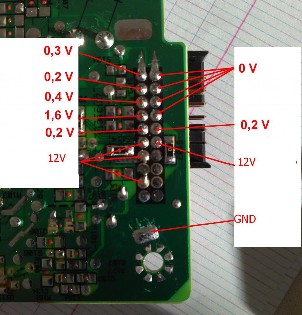

    I've measured the voltage from CN100 and attached it but where the +5VSTBY must be there are 0.21V
    I appreciate your help, best regards

    Re: Crown LED 32185 no power no standby
    Your Psu is ok, these literally only have a 12v and 24v output (24v goes straight to Led driver) they use Dc-Dc converters on the motherboards for the 5vstby and other rails on these.

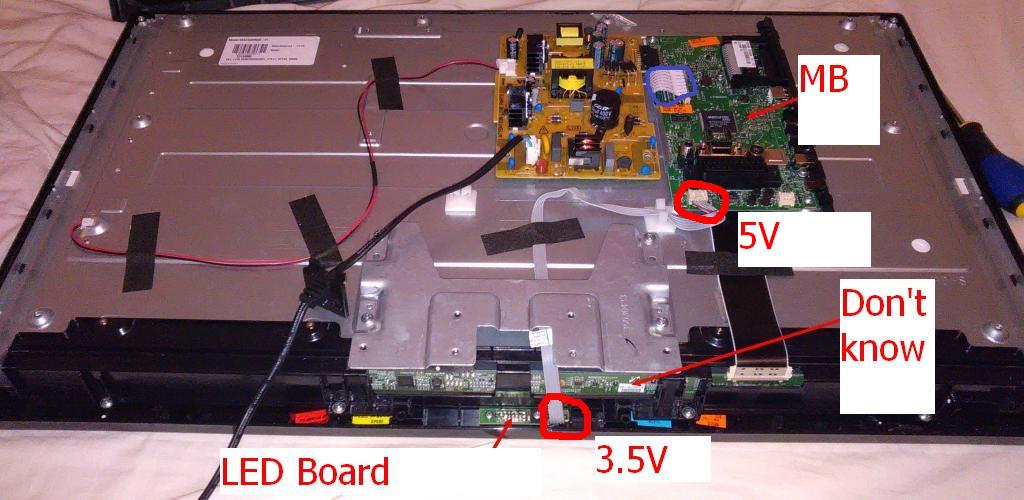

      Your motherboard likely has corrupt firmware which is not turning on the standby Led, have you checked to see if the Ir sensor has its 3.3v and 5v on it ? Thats one way to check if the motherboard is at fault. If it does your motherboard is bad.
      • ragis
        • Mar 2013
        • 51
        • Bulgaria
        Thanks for the reply, now i checked CN18 on the MB and it has 5V on the pins, then checked the LED and it has 3.3-3.5V.
        So i think it gets his voltage, now what can i do or the MB is dead ?
        Checked the LED and IR pcb - they both get 5V and the LED is ok it's not burned.But it can't just turn on or show standby maybe it's the MB what can i do to fix it or just have to replace it ?
        Thank you again, best regards

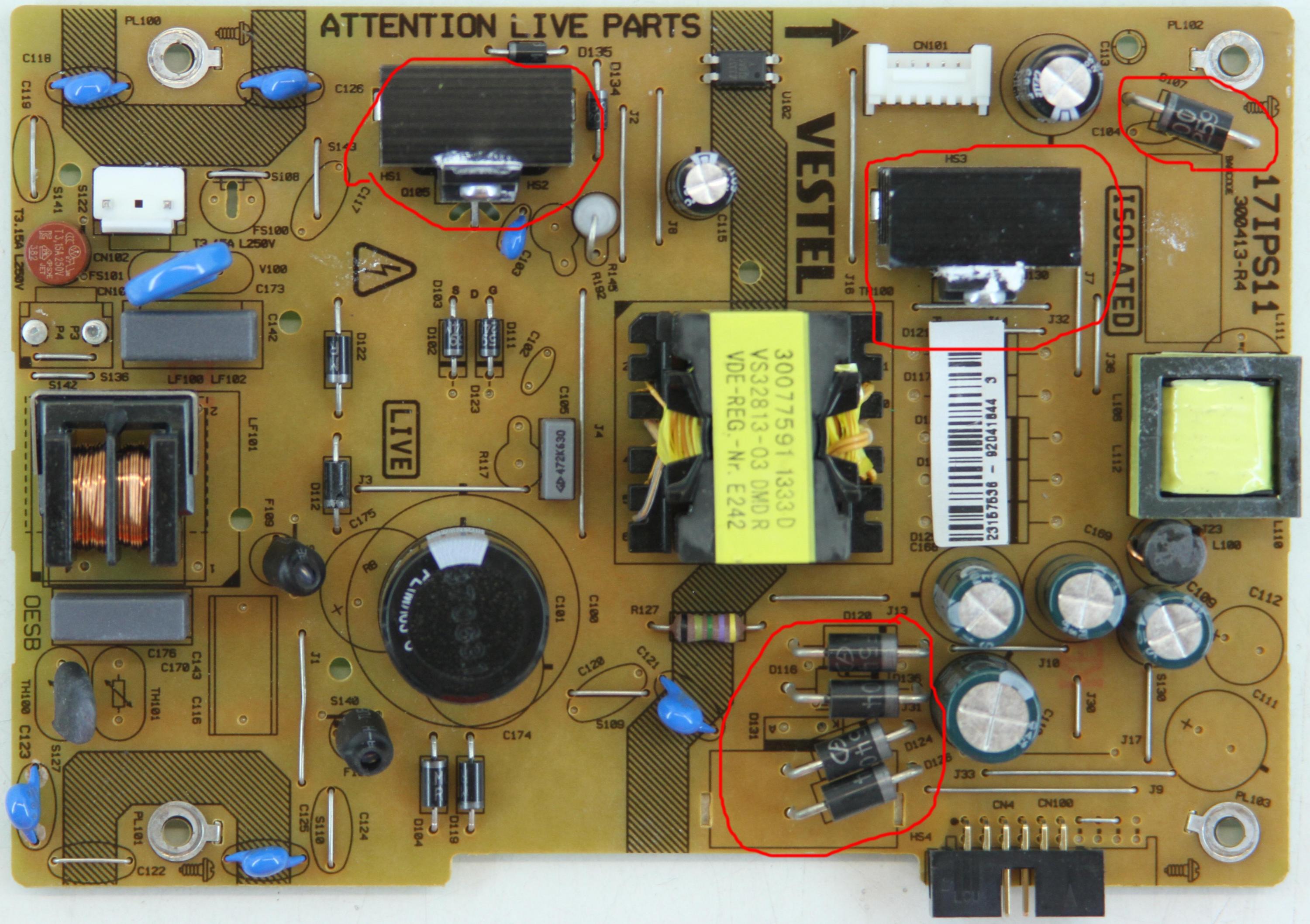

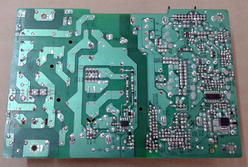

                              Ok, thanks mate for the help i've found similar board from:
                              Panel:VES315WNDS-01
                              MB: 17MB95M
                              PSU: 17IPS11 (300413-R4) which is like mine but has +cap C112 but i can add it to my PSU

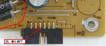

                              One think i'm concerned about the backlight one friend told me to test it with the multimeter in diode mode on the 5th pin of the CN14 but the backlight didn't start... Do you have any idea or i have to tear down the panel i think if the backlight is off i can trow this damn TV in the junkyard
                              I've attached the similar mb and psu and the test for the backlight
                              Thanks again, i really appreciate your help sir
