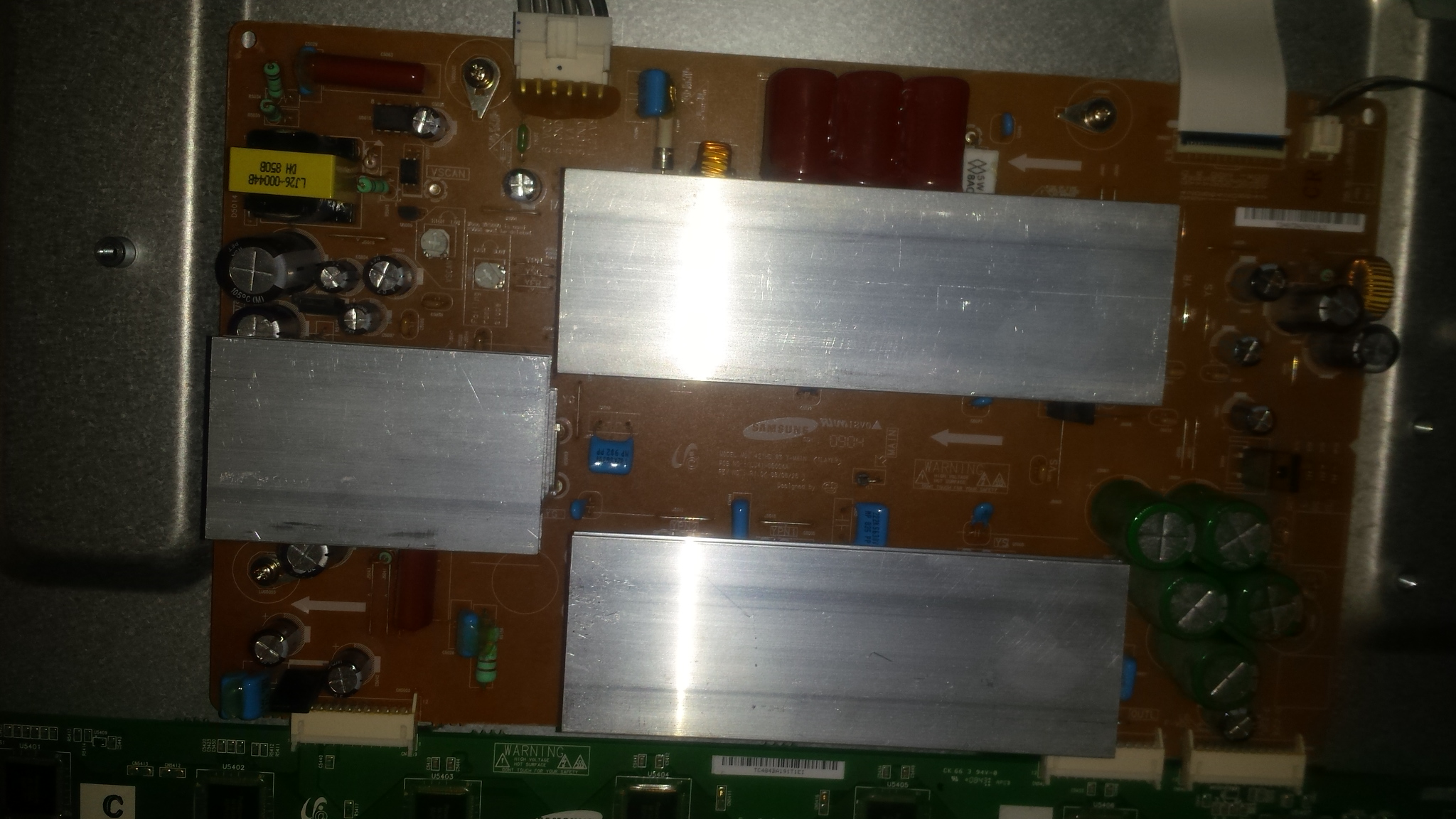

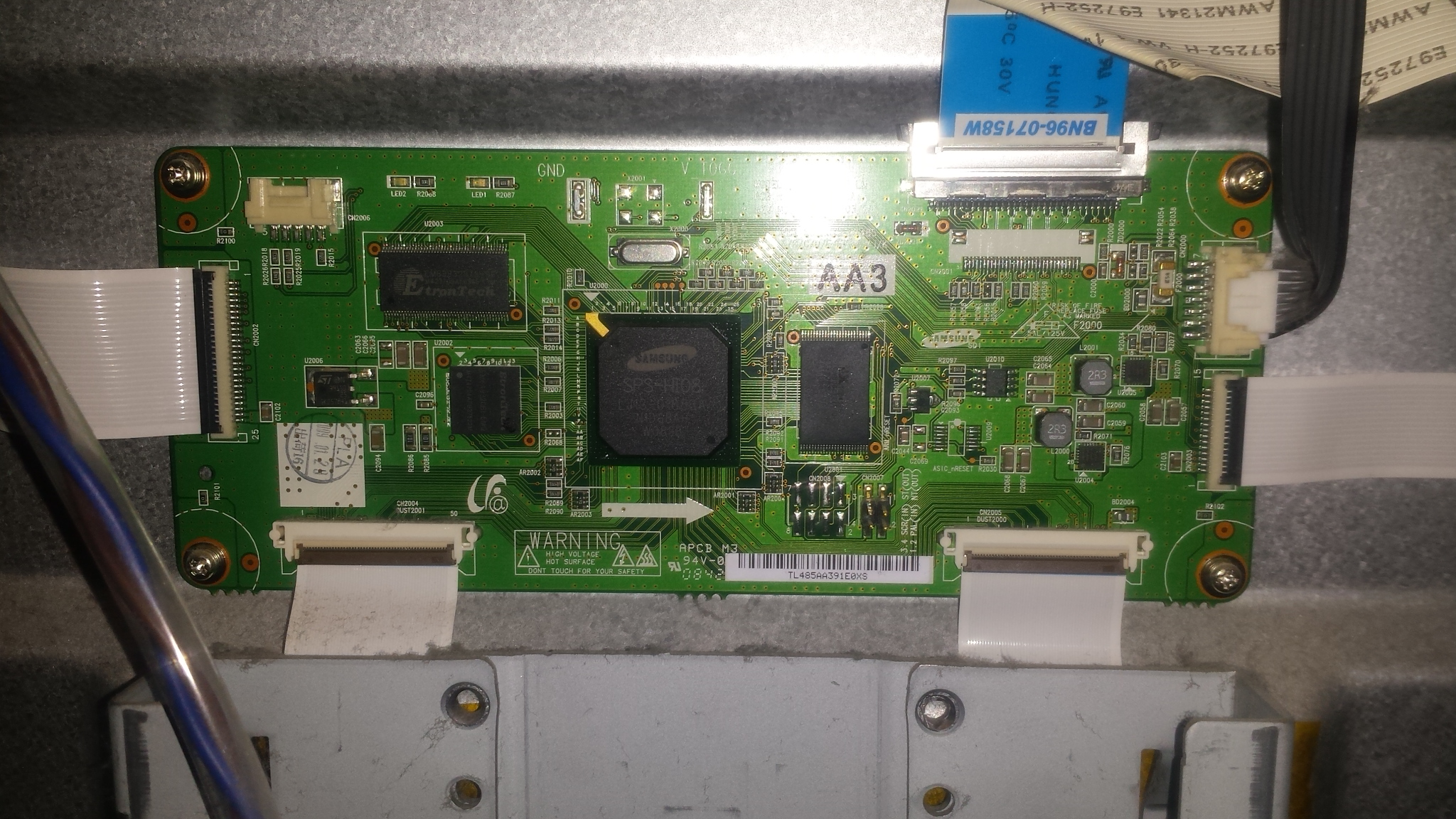

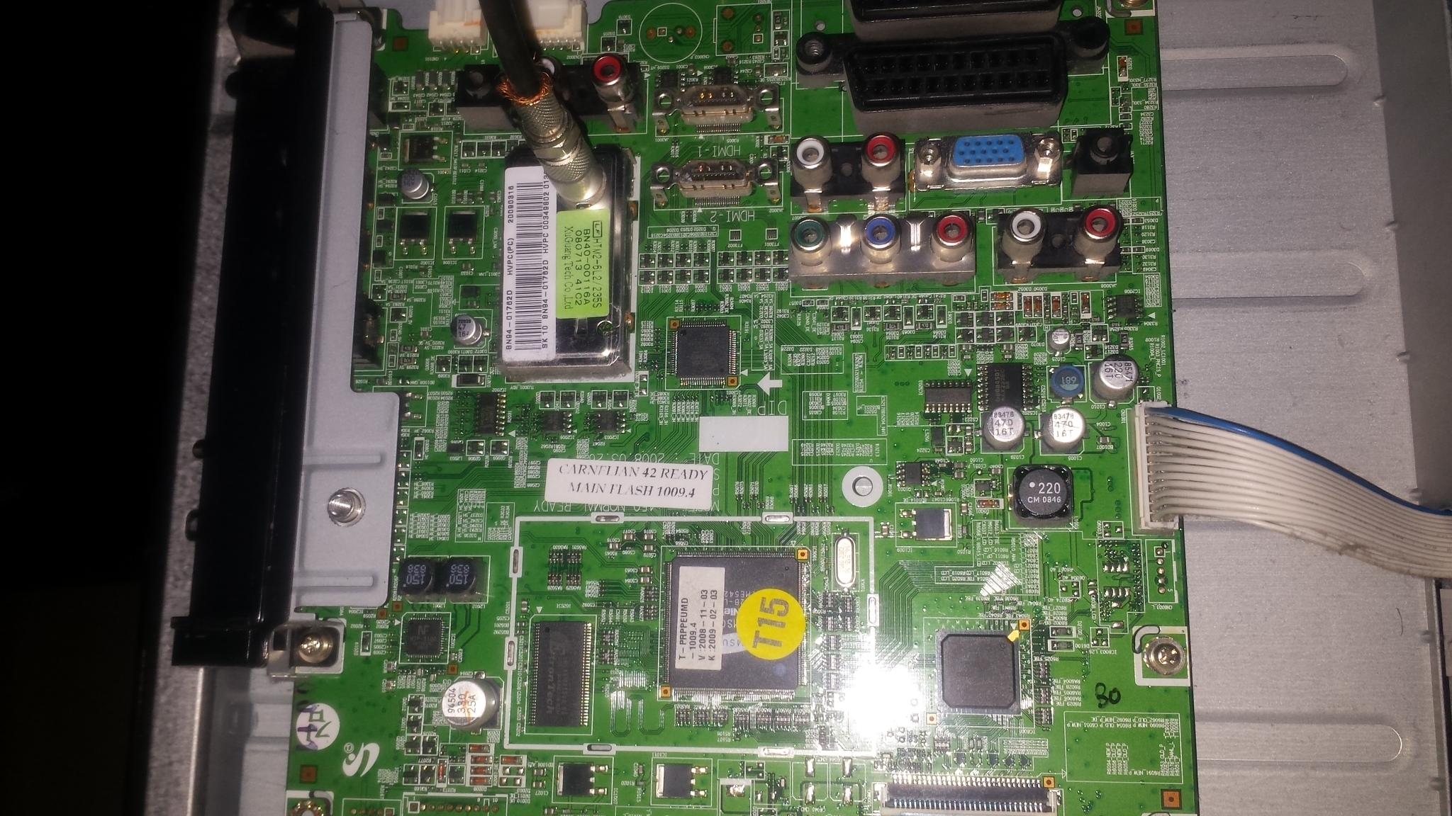

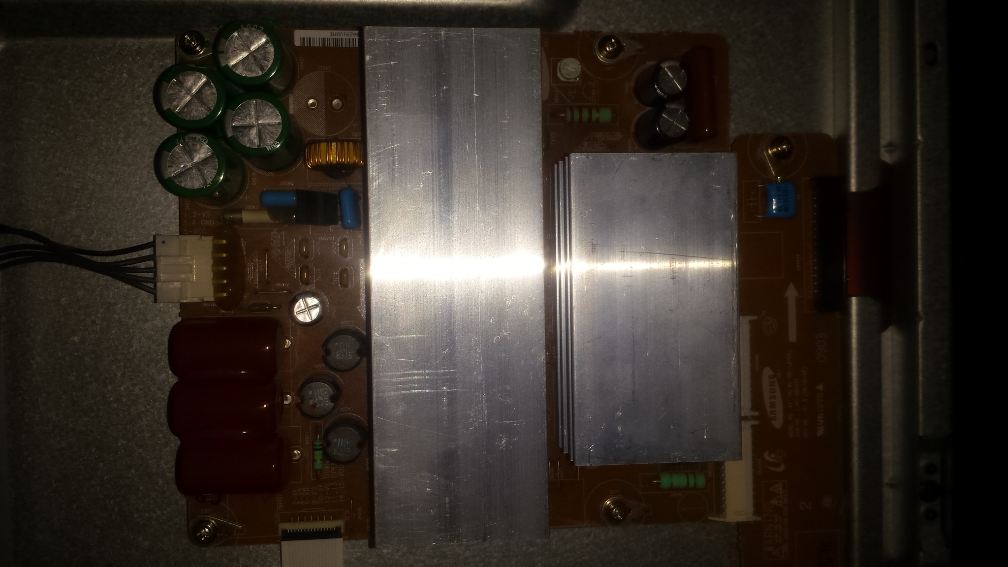

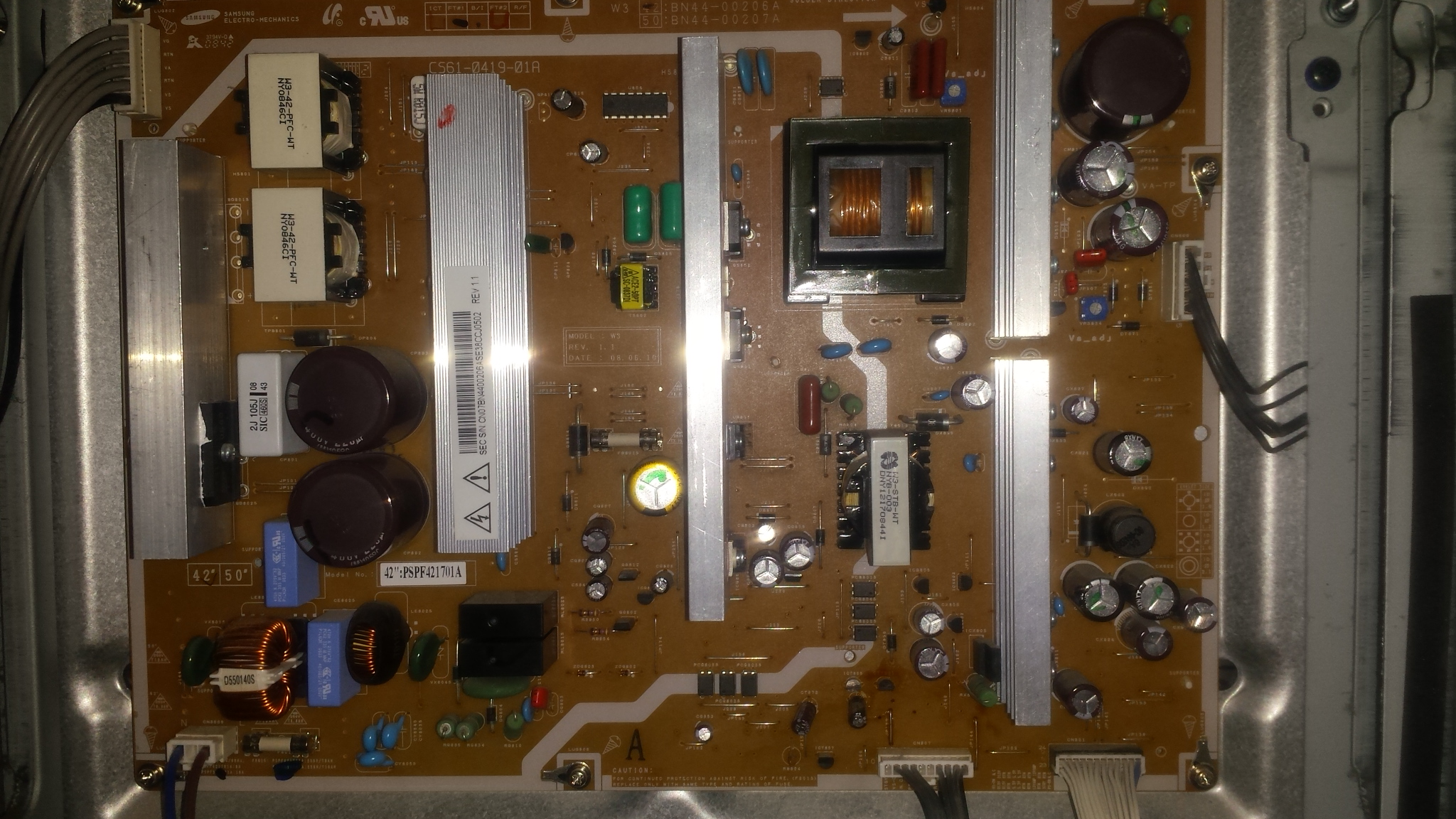

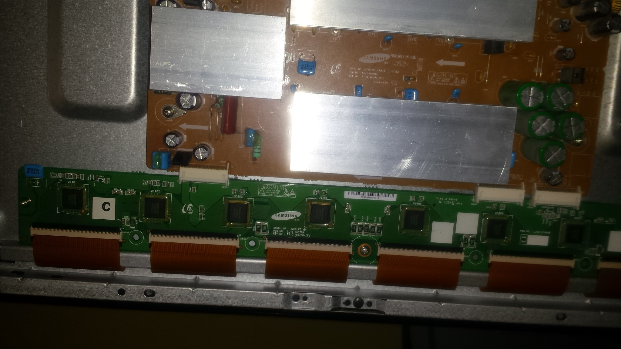

    hi my plasma tv started this morning and then after a few second it shuts down by itself and again start and so on it has no blown caps no cold soldering removed every board from the tv none has burn marks or any other marks.
    I plugged off the ribbons from x,y boards did the pin test same thing shuts down by itself.
    My psu is BN44-00206A w3.

    Can you supply pictures of the circuit boards. Have you taken any voltage measurement?

      I did no measurements cuz i don't know where to begin with an i did some photos and a videoclip

        Photos!!!

            So today i took the tv to a guy in my city ho does have a tv repair service and the fault was in the memory of the av board .
            For thous who have problems like mine consider replacing the av board cheers
