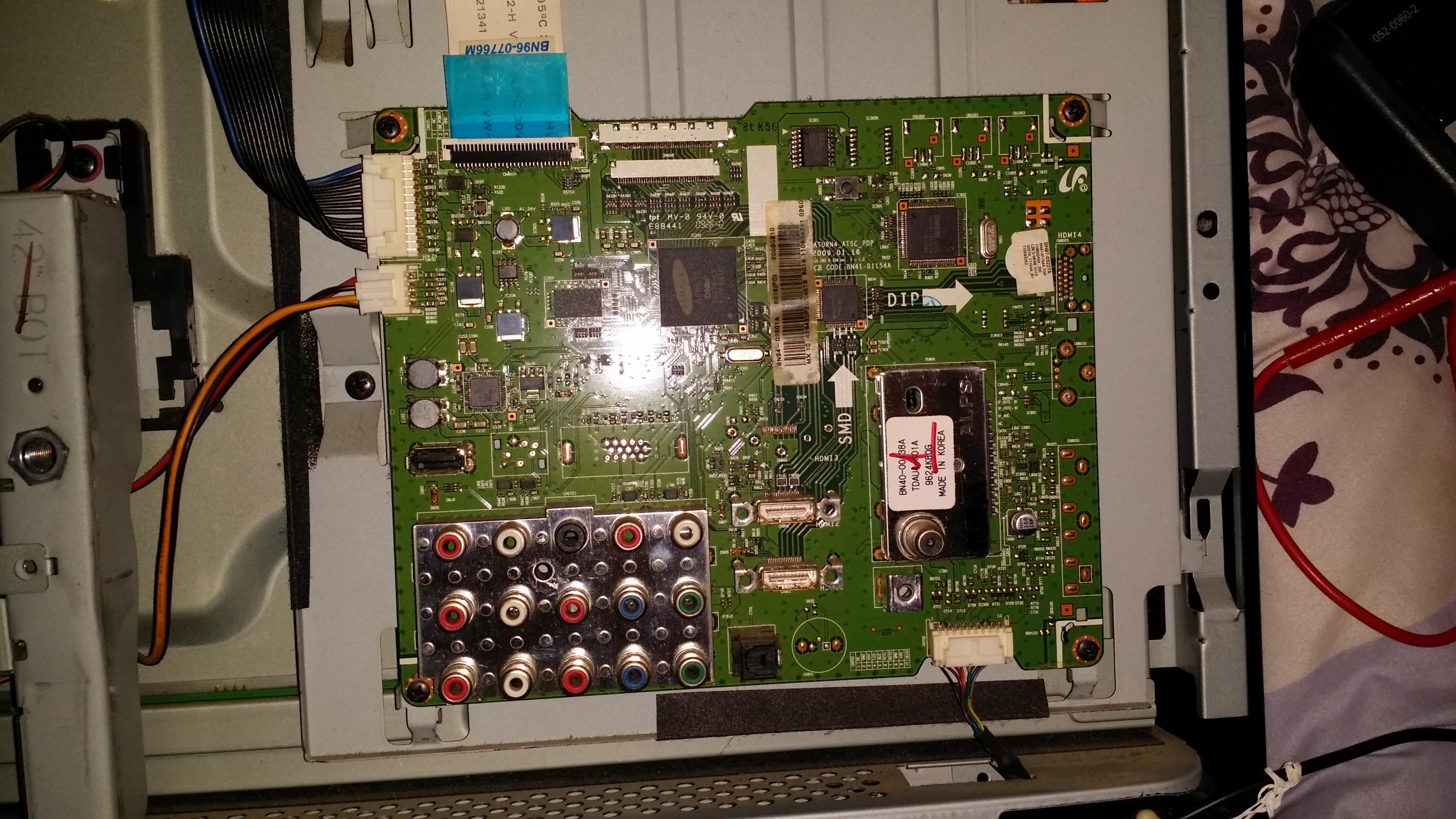

I am having an issue with my Samsung Plasma TV (42in). I went to turn it on yesterday and out of the blue there is no picture. Please see the bullet points/pictures below:

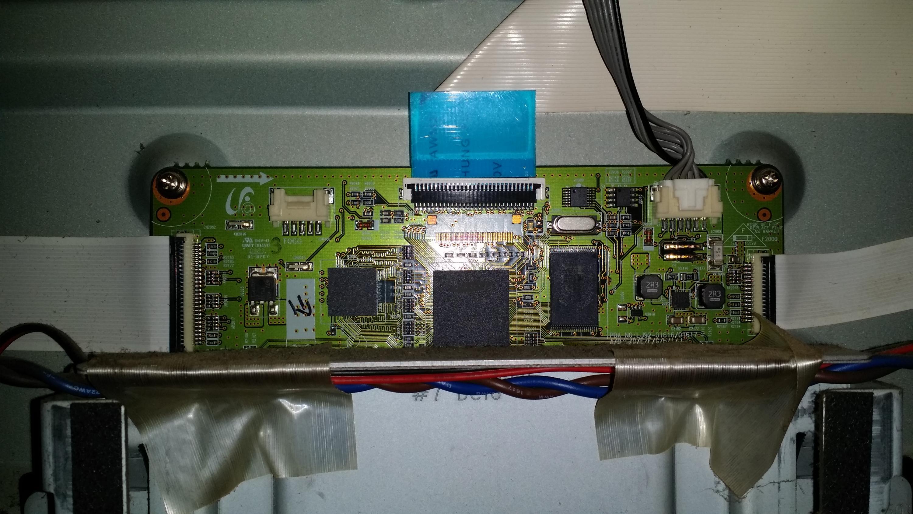

I included pictures below so you can get a good idea of what I'm working with. Please check the image of the main board with jumper/lvds disconnected to let me know if I have it set properly for testing. The jumper might look like it's off to one side in the pic, but its shorting pins 3 & 4:
Please let me know what you think. I do not have a scope or anything. But I am mechanically inclined, have a multi-meter and can solder haha. I'm willing to try just about anything to get this thing back online. Thanks in advance for any help!!

- Attempted putting TV into Test Mode by using a hard drive jumper on pins 3/4 and disconnecting the LVDS cable (see picture to see if I unplugged the right cable) This displayed no changed on the screen (Note: Menu button does not change brightness in test mode, screen still glowing)

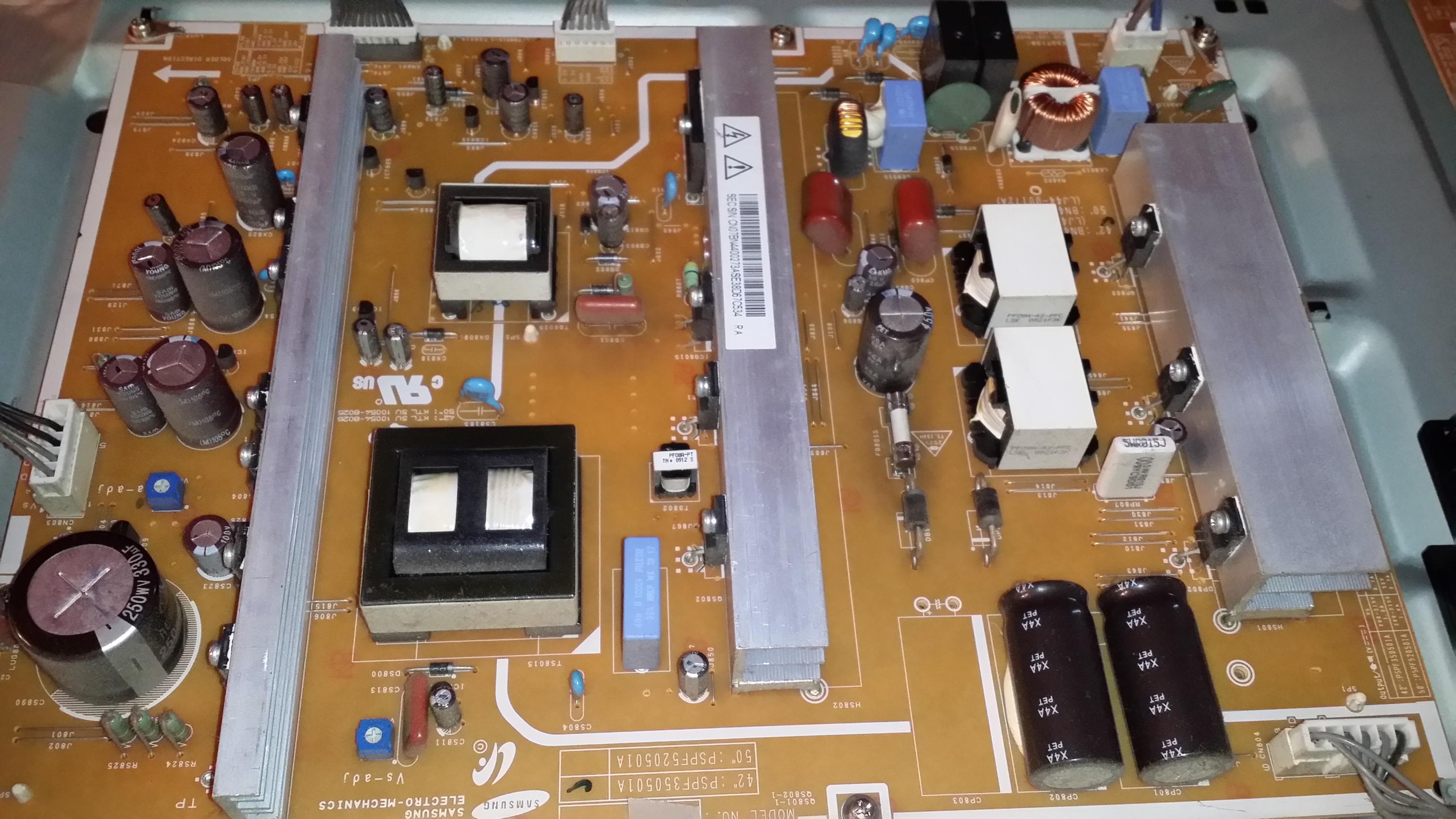

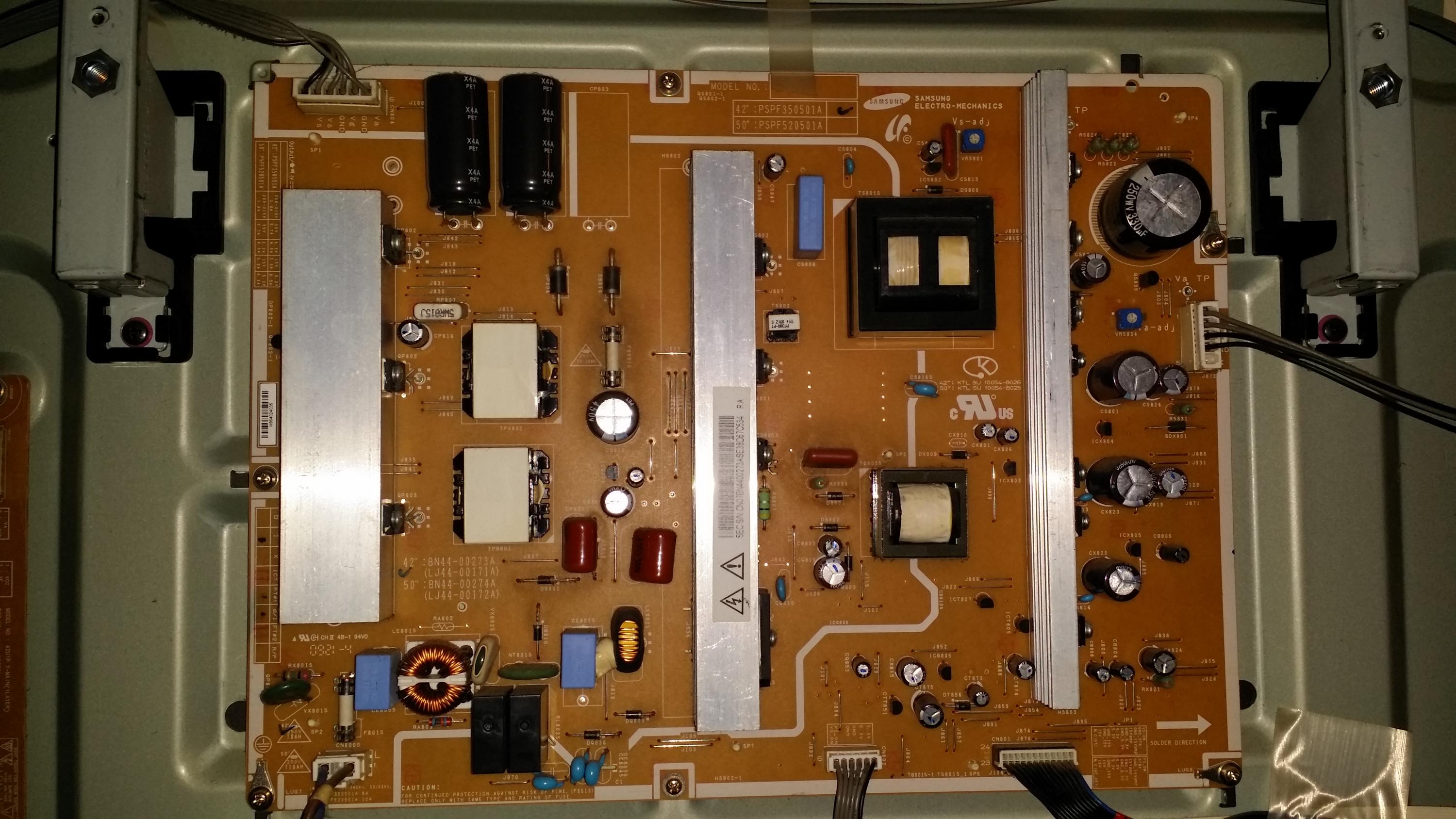

- Tested both ceramic fuses on the power supply with DVM, both tested good. Tested soldered fuse on mainboard, this tested good as well.
