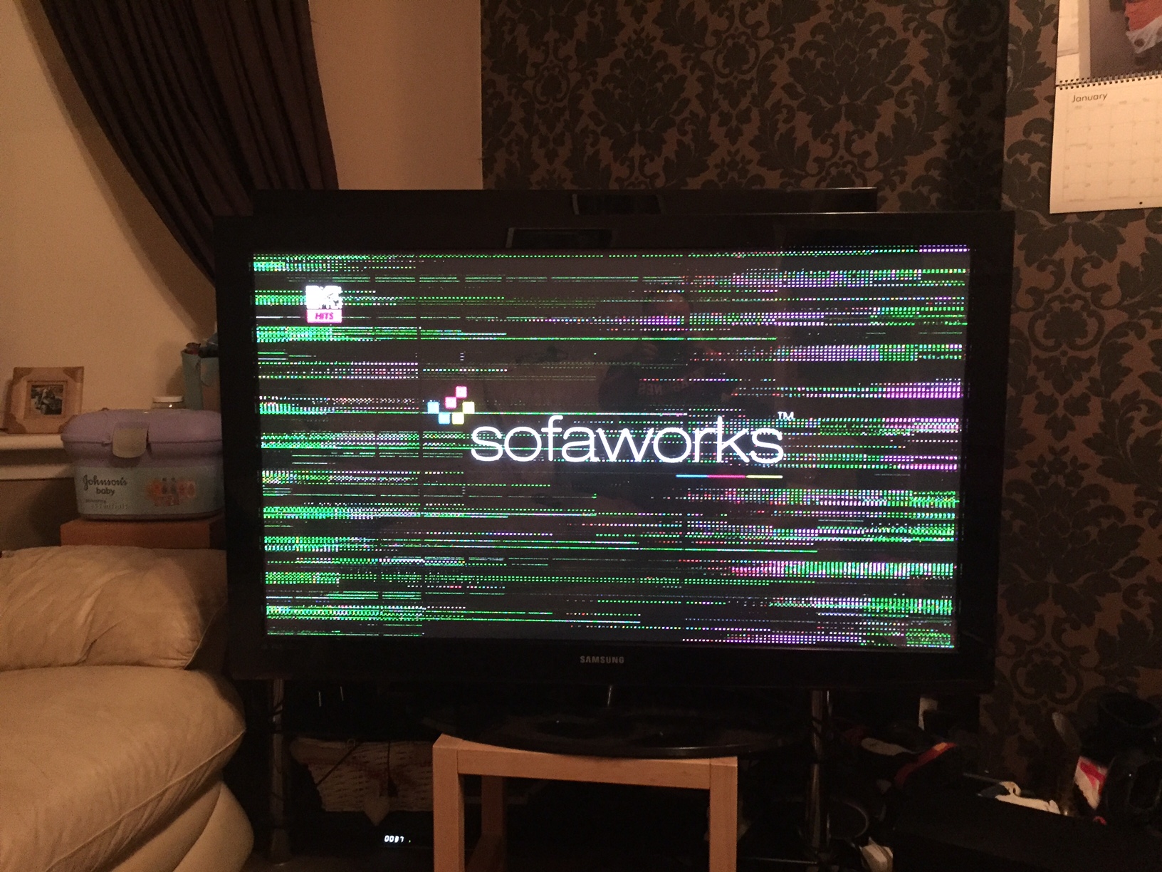

    Samsung PS50B430P2W strange fault
    Looking for help, I have a Samsung 50" ps50b430p2w Plasma that has just developed the fault as seen in picture, its like this for a short time then cuts out.

    Re: Samsung PS50B430P2W strange fault
    Thinking this is the Y- Buffer at fault, anyone any ideas of how to check this? If i were to do a board swap out am i best replacing both YSUS and YBuffer with replacements or can I just replace one?
    Any advice/help would be greatly appreciated.
      Not a Ybuffer fault IMO, if the buffer was at fault normally on Samsungs you wont get any image. Looks to me like the control board has failed. Check in google how to run Samsung Plasma test patterns and run them this will give you a better idea on what is causing this.
        Nah---
        Bordeaux-Plus Mainboard Caps strike again, I think
        Prolly has crackling sound as well...
        Reecey is right--Defo--NOT Buffers Or either SUS board. There is a vague possibility of Control-Board fault caused by the low-voltage caps on the PSU. They fail--and corrupt the firmware on Control-Board, just like the 42/50Q97 on which this set is based/similar.

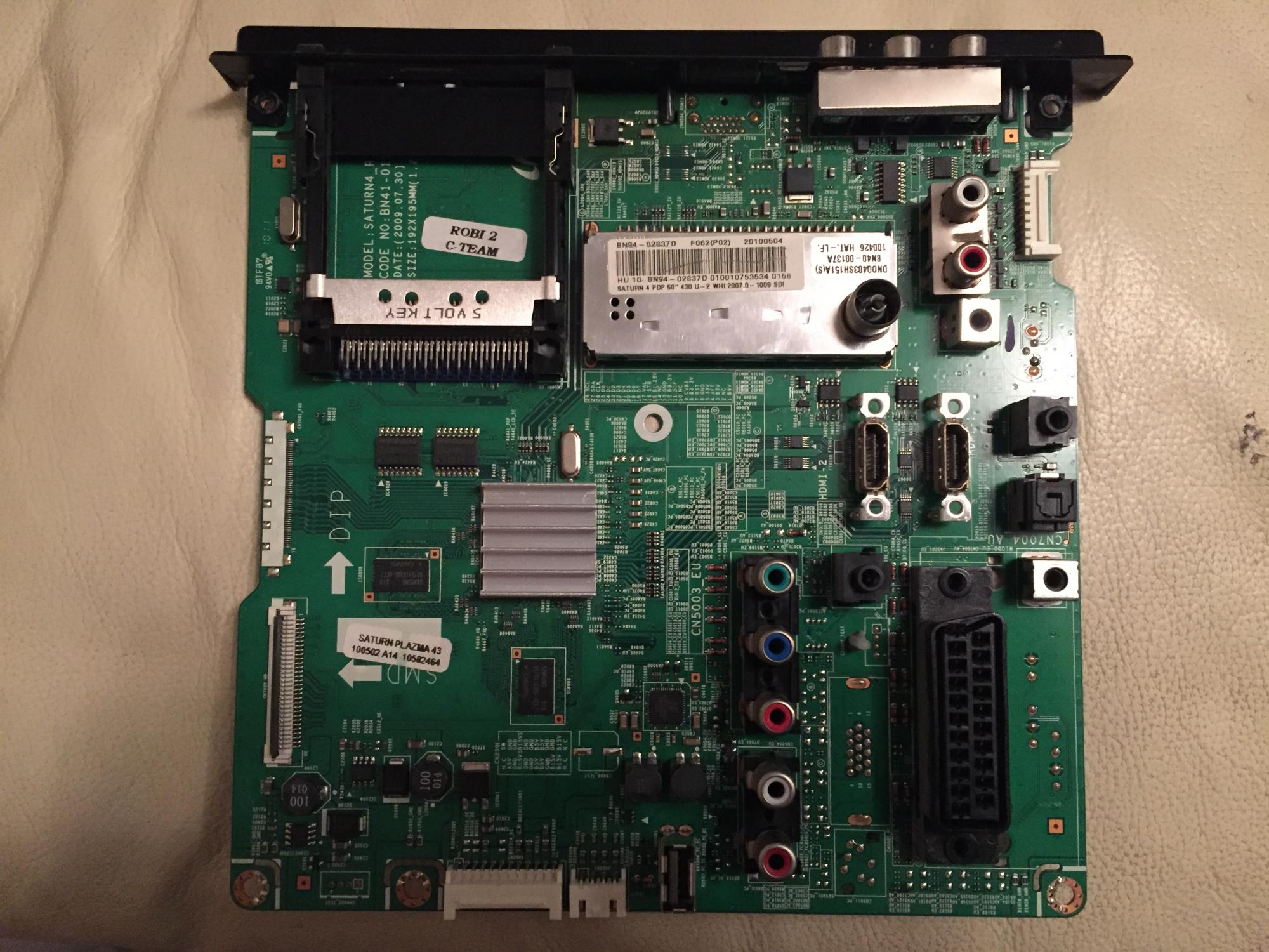

                          Thanks AlastairE, here are a couple of pics I can't locate the 1000uF caps.
                            ** Update **
                            Went over all voltages Va, Vs etc and made sure they were matching the sticker on the internal rear of panel. TV shows no picture although it glows and changes when the source video changes but no picture on screen just black/grey the sound is perfectly clear with no crackling. Also I tried adjusting the VR-FR to clear up the sparkling issue i have, (worked on a previous set i had)
                            I can replace any caps on the mainboard not a problem if someone could point to the correct ones if it is these (cheaper option) or I could buy a second hand mainboard and do a swap out (dearer option). Really want to be 100% these are causing the problem.
                            Tried the hairdryer method no difference.
                            TIA for all input.
                            Stephen

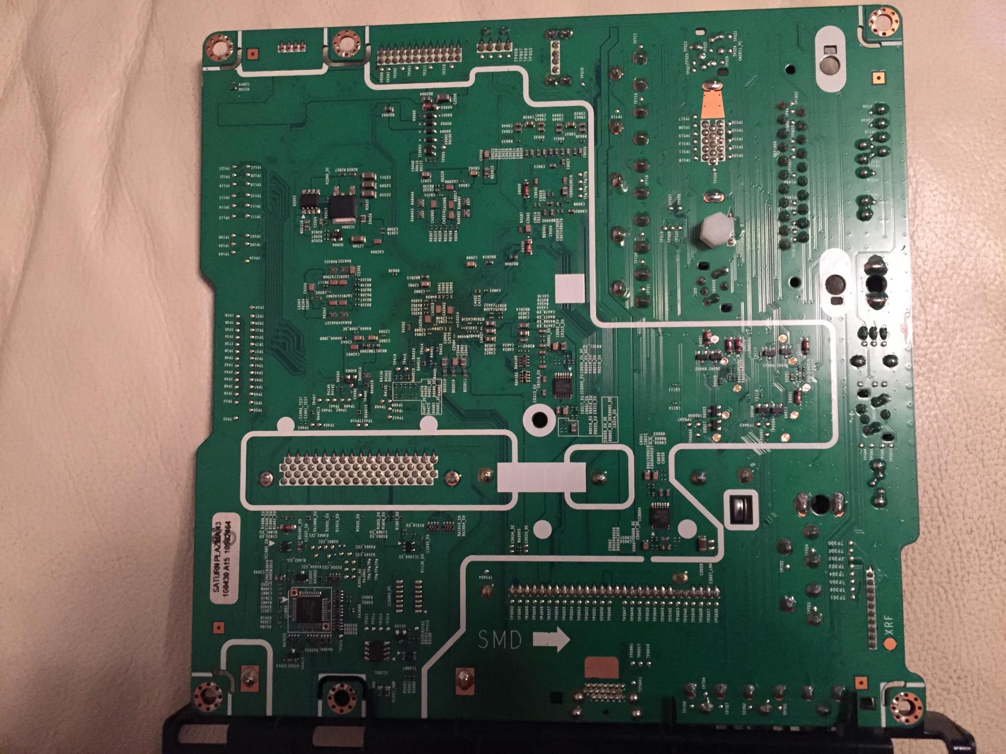

                              I personally think chage the Mobo, try reflowing it or can you get us an image of the underside please ?
                                maybe alastair was refering to this but your board only has the tuner that you could could call tin work covers so im not sure if this board suffers the issues in this thread
                                https://www.badcaps.net/forum/showthread.php?t=43268
                                  Or what im thinking is the tantalum capacitor for the 3.3v reg is failing it causes weird glitches like this, but need to see if his board uses it.
                                    Originally posted by ReeceyBurger123
                                    Or what im thinking is the tantalum capacitor for the 2.8v reg is failing it causes weird glitches like this, but need to see if his board uses it.
                                    That does make sence if the board uses it some good clear pictures of the underside of the board like you have said will help these Bordeaux boards do seem to be trouble some.
                                      Here a pic of underside hope it's clear enough.
                                      Thanks everyone.
                                      (The rant cap referred to above for the reg, I take it this is on the main board.?
