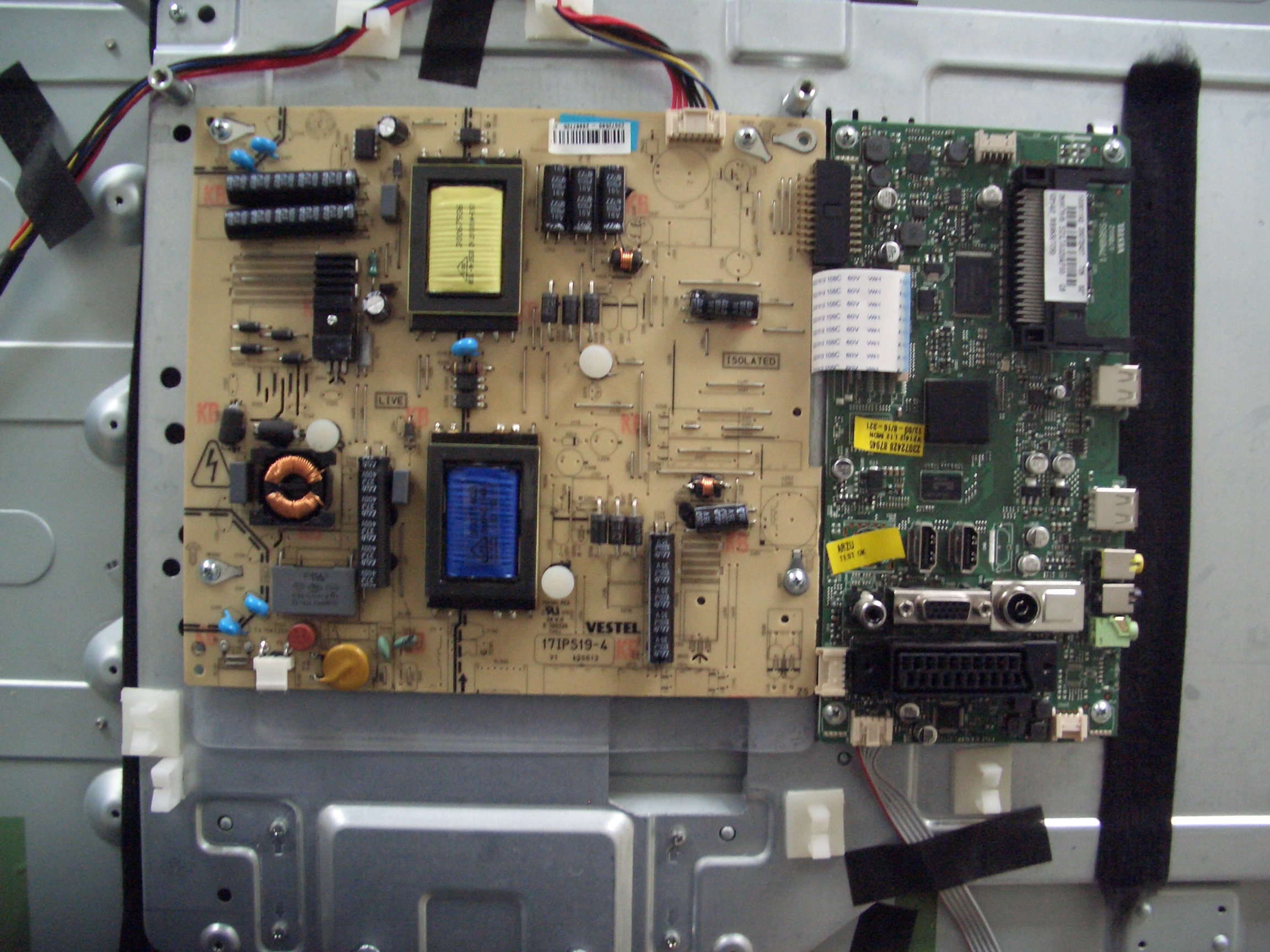

    Examined the power board - It looks 'as new'. Capacitors in good condition.
    The set is less than three years old.
    Checked with a meter all the Diodes and Mosfet - OK.

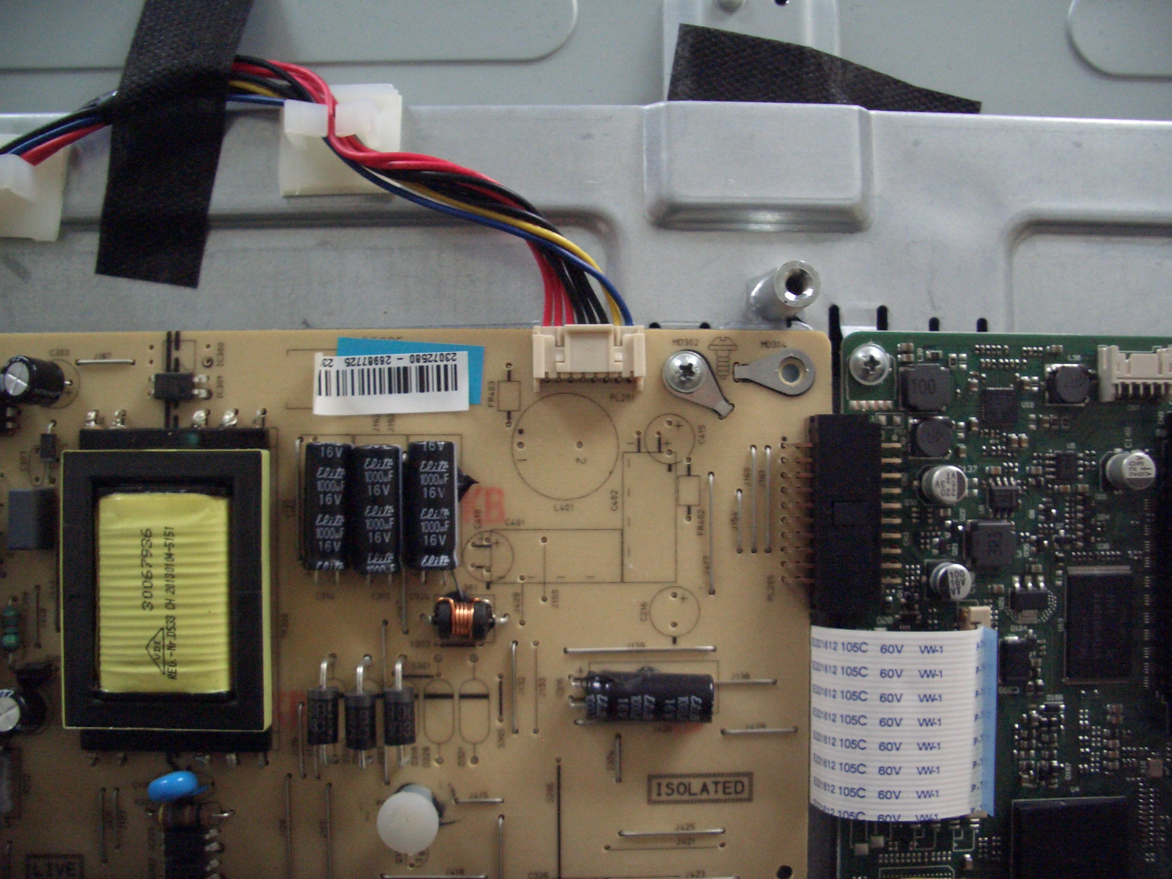

    When powered on (green LED) - I get the following voltages from PL201.
    24V - is OK. (Red wires)
    BL ON/OFF - 3.2V (Blue wire)
    DIM_PWM_ANALOG - 2.0V (Yellow Wire)
    I also did a 'reset' on the TV by holding in the sets power button for 15 seconds, and then holding the button in while powering up the set - It did nothing.
    I believe this is a cheap standard crappy Vestel set, but I've included some photos.

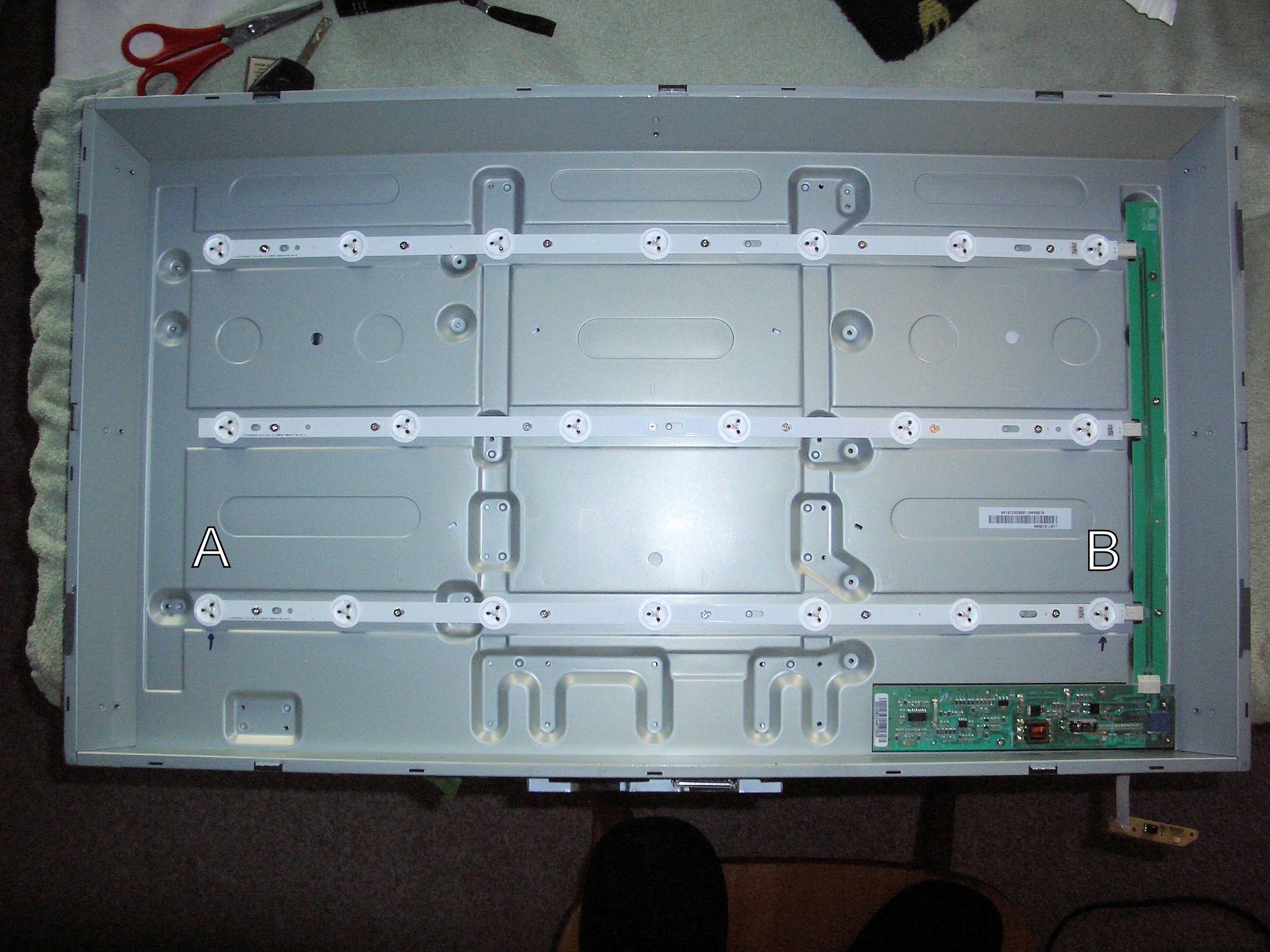

        I watched the entire video through and then started to strip the panel.

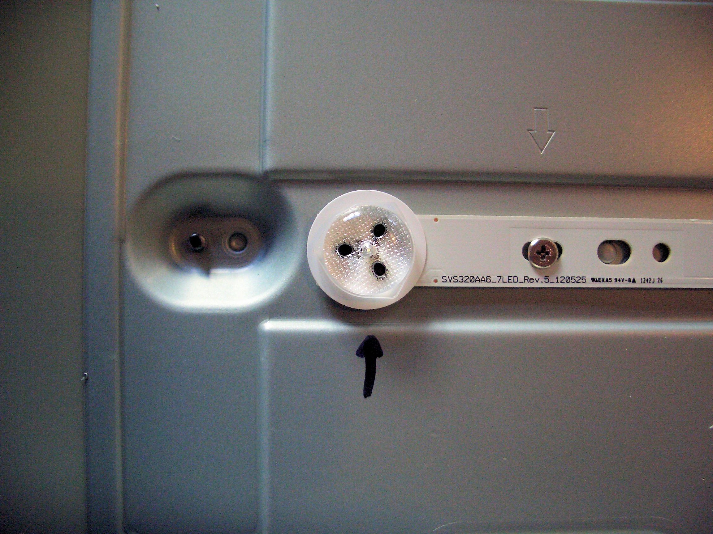

        Ok - All done, and found the issue (see photos).
        Two bad LEDs. The LED at 'A' in the photo is short-circuit.
        The LED at 'B' in the photo is open-circuit.
        What do you suggest? I don't have a heat-gun, flux or cleaner for a proper clean repair. Would an option be to cut-out those two LEDs from the strip and 'botch' repair the two bad ones with replacements and solder-wire them to the strip or connectors? Typically the two LEDs are at the ends, so 'extra botching' would have to happen.
        Thanks again
        Chris

          Re: Toshiba 32D1333B Vestel 17IPS19-4 No Picture No Backlight
          Awesome glad to help You can try this method buddy:
          https://www.badcaps.net/forum/showth...t=Led+stacking
            You can buy smashed Led Tv's and Led Tv strips off of ebay for quite cheap and do this repair. I also strongly suggest that you do the other repairs that I shown in the video, replacing the Psu diodes and modding a wire across the Led strips however leave the firmware on that board unless you have the exact copy of it but still factory rest the Tv when its fixed
