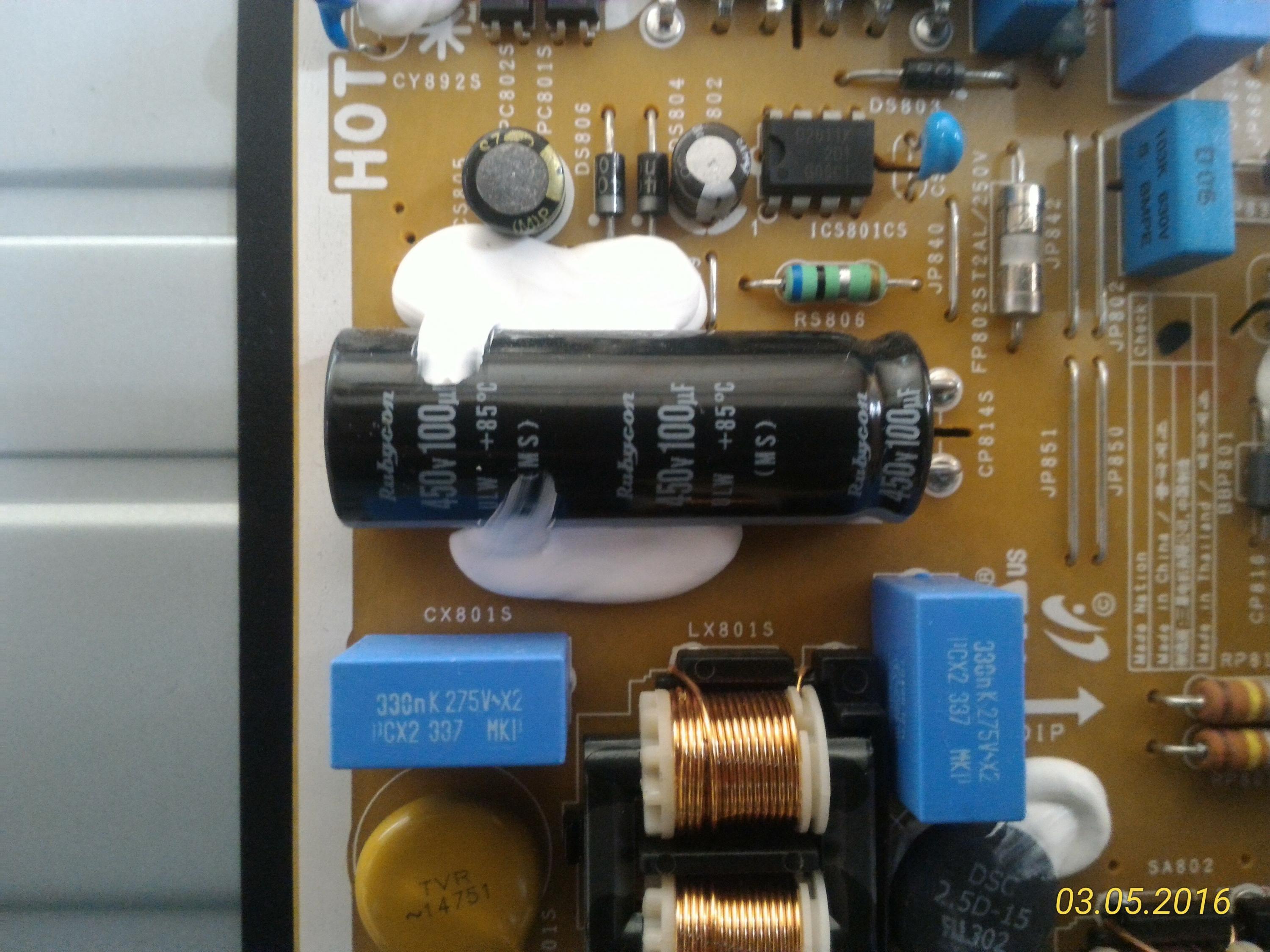

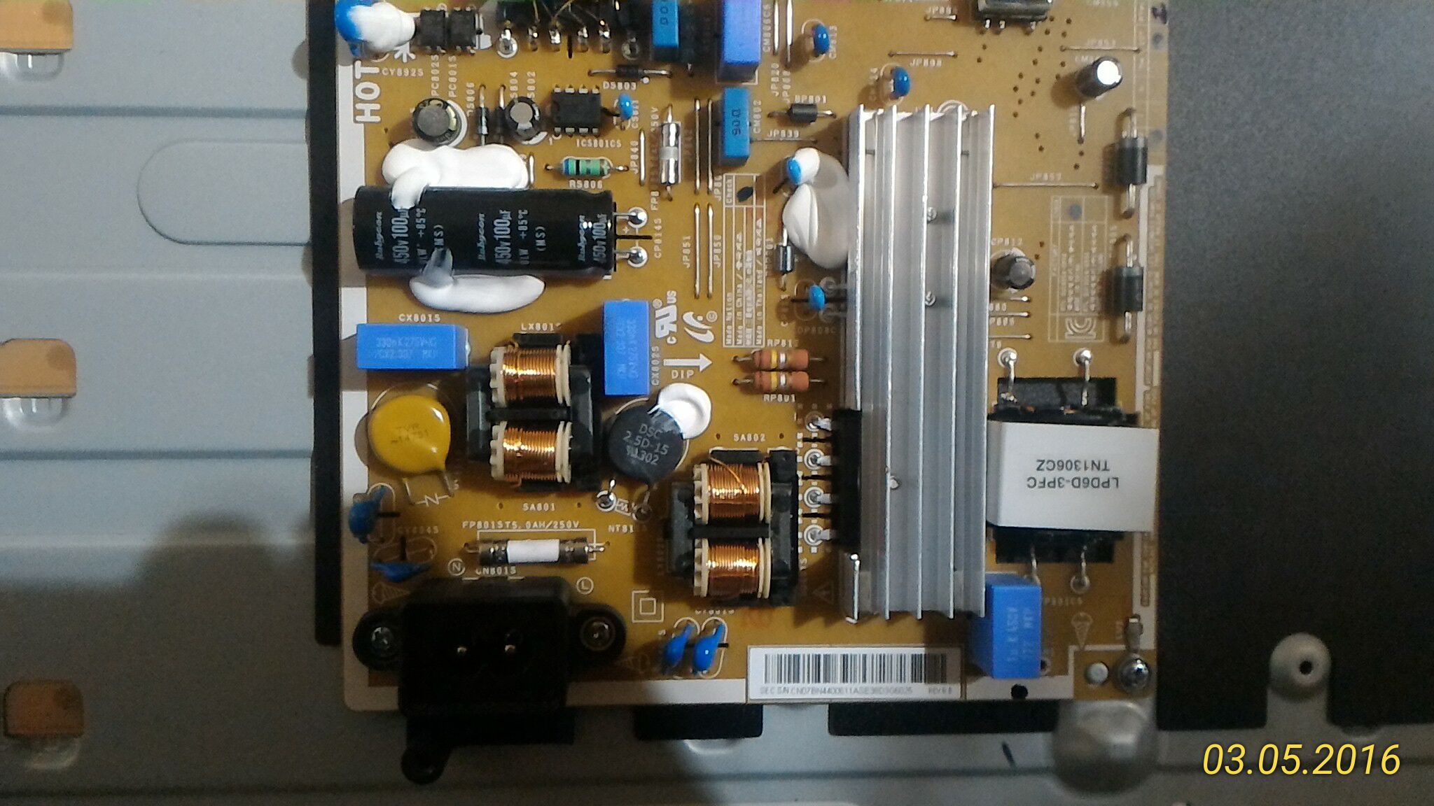

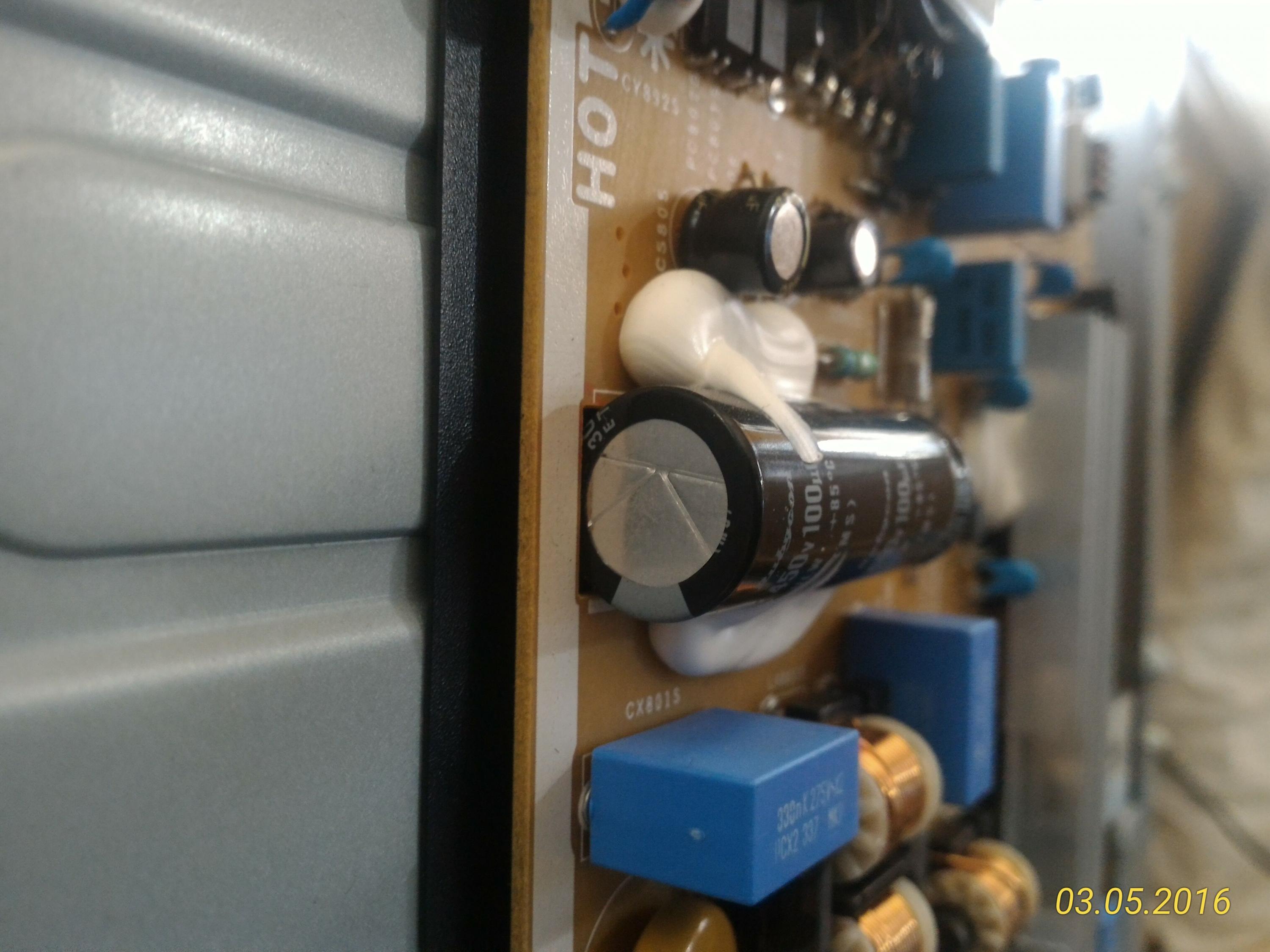

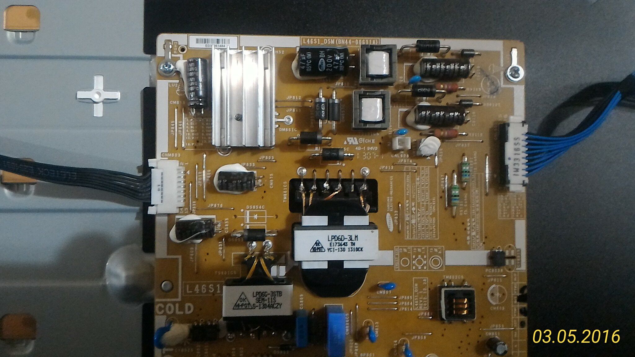

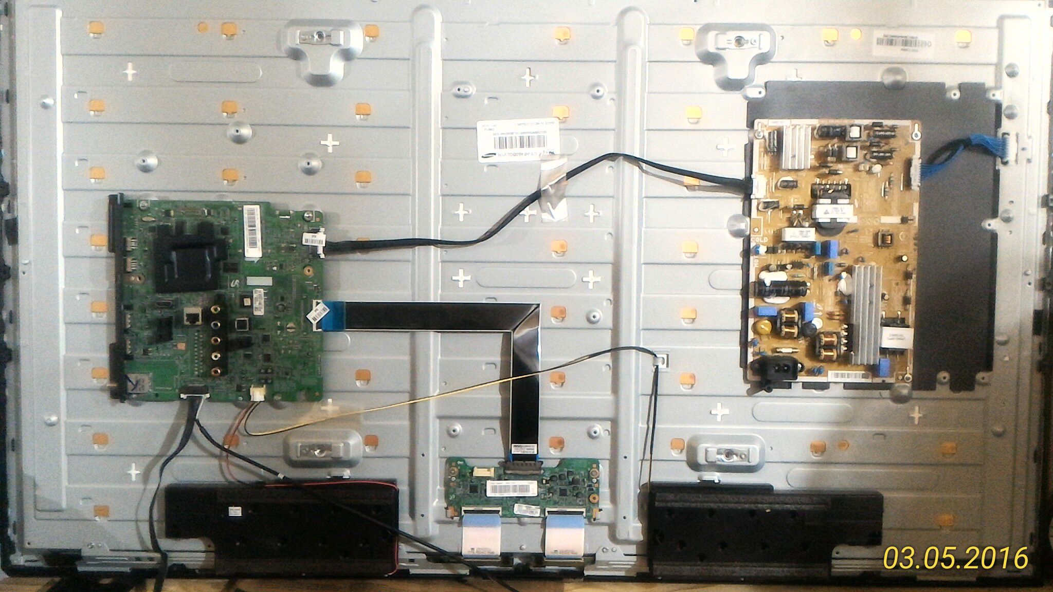

    Hi evryone
    Found this beauty behing best buy next to the dumpster when i saw the thin and light it is though can fix it! was made in 2013 so im sure the most usage life on the tv is no more then year and half. When i plug in the tv surprise works i mean all but i hear a electric sound comimg from behing remove the back lid i figure out is coming from power supply the hot side also when the screen brightness is higher the sounds turn louder search in the forum someone had the same issue with a sharp but the tv shut off after couple seconds and was a bad fuse in a inverter board. I gonna include few pictures of the tv parts and also took few videos but not sure can upload it here? can uploaded to you tube and post the link? so you guys can help me, i will apreciatte all your helps and new in this but always like fix electronics and hope i can learn

    It looks like the capacitor next to the heat sink(the longer one) is bulged. It could be an optical illusion, but look closely to see if the top of that cap is bulged out.(or any of the other caps)

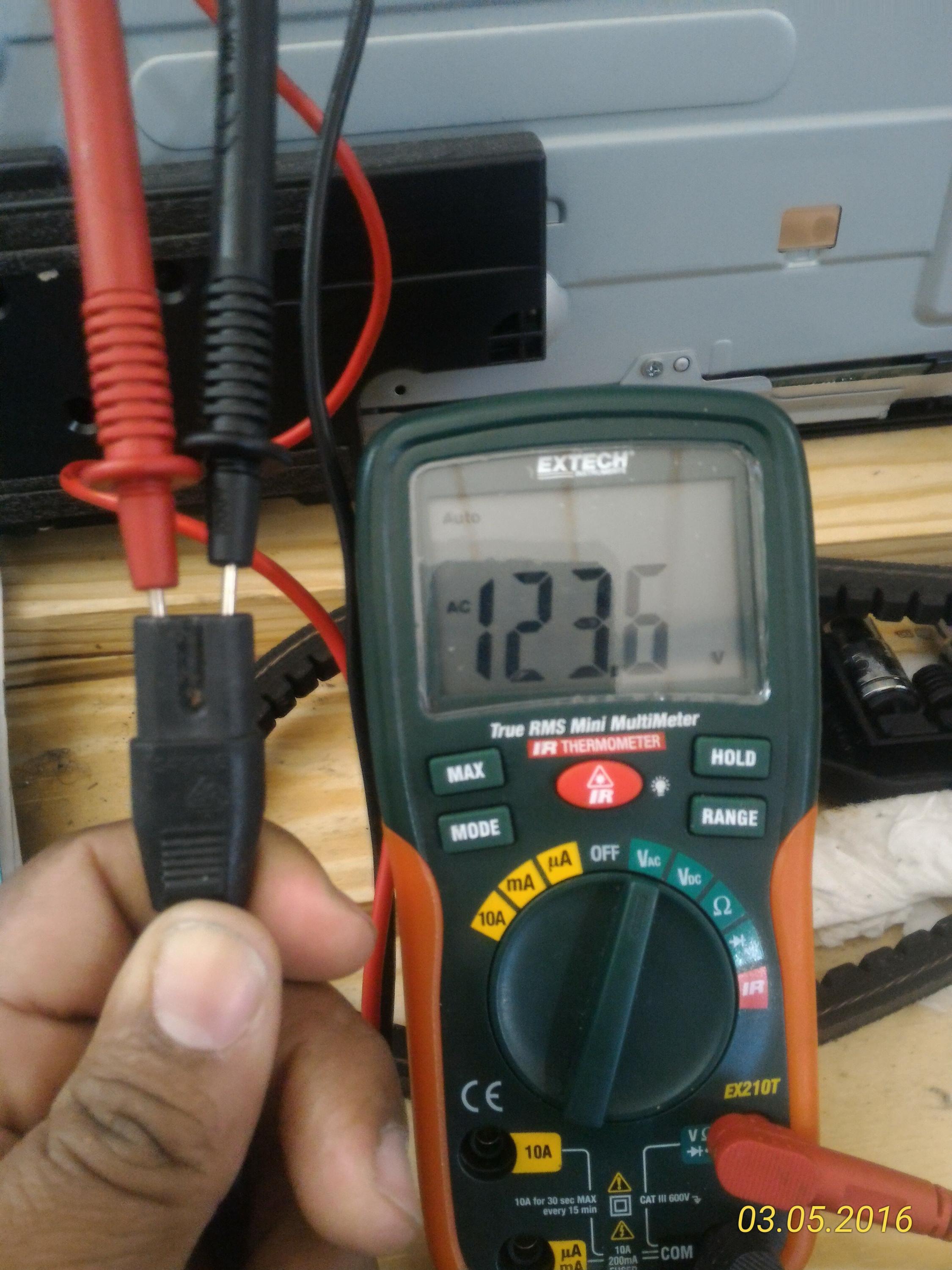

    Also, do you have a multimeter? If yes, check the voltages on the power connector.

      you have overload, so do check of the load by....plug out speaker and check if the noise still, also plug out back light and check noise,

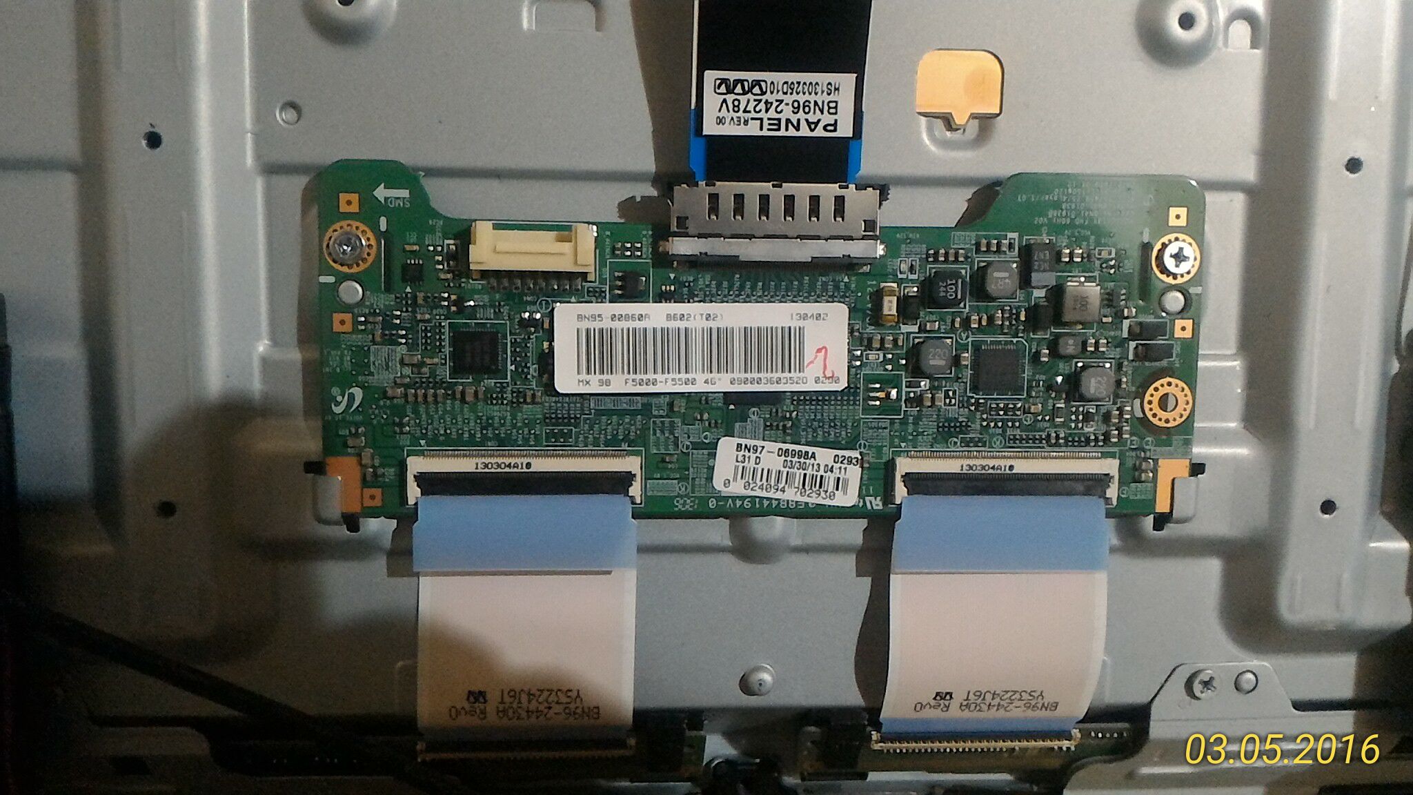

      next remove LVDS from main board to T-CON and check.. the stage noise disappear the parts make over load.

        [QUOTE=martyparish;636904]It looks like the capacitor next to the heat sink(the longer one) is bulged. It could be an optical illusion, but look closely to see if the top of that cap is bulged out.(or any of the other caps)
        Also, do you have a multimeter? If yes, check the voltages on the power connector.[/QUOTE
        I check all caps and look ok check the one you told me and look fine voltage from electric cord is 123v
          Plug out speaker and sounds still, plug out backligh conector from power supply and when power on start bit loud then is hard to hear need get close and sometimes get louder and then is not loud but still present.
          Disconnect the lvds cable from t con and same symptoms
          Turn off the tv then unplug a cable between the power supply and the main logic board and automatically the screen turn on too bright and the sounds is loud,so higher is the brightness in the screen louder is the overload sound

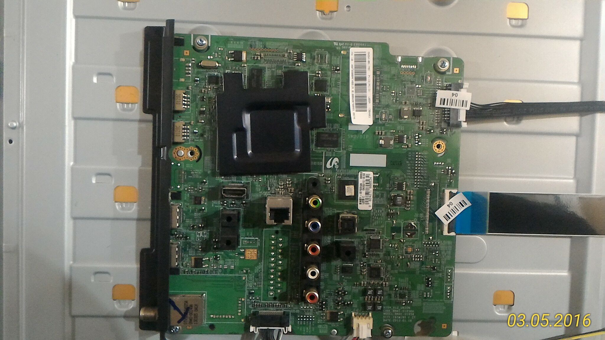

                    my guess is main board is causing the over load or power supply had a issue

                      Re: Samsung UN46F5500 electric/overload sound comingbfrom power supply
                      someone can help me to check if the power supply is fine
                      • Diah
                        • Feb 2013
                        • 6614

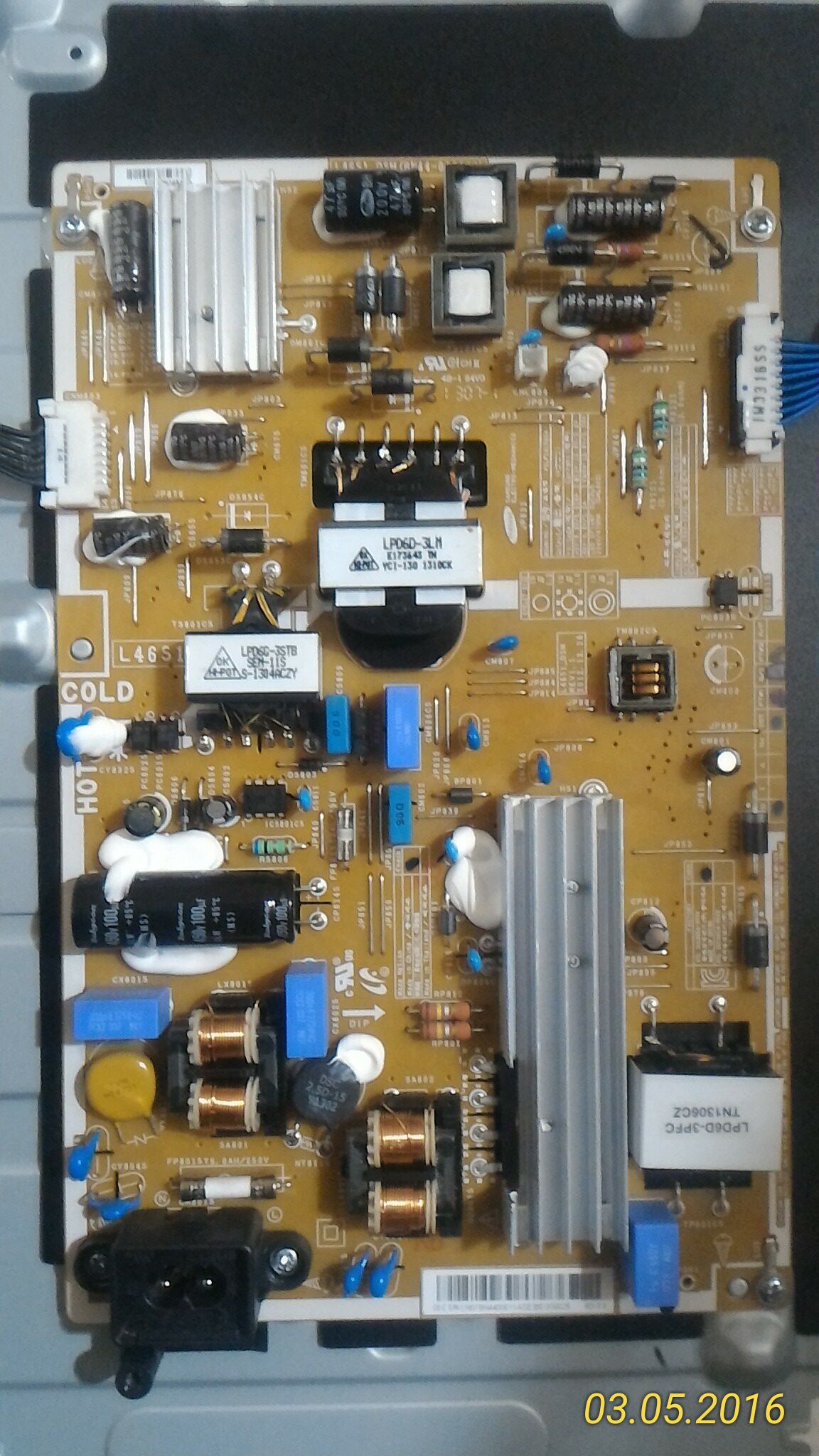

                        Noise at big cap 47uf 450 V are overload outside the PSY 100%
                        follow the 13 Volts, and try to disconnect it from sound amplifier and to LNB section it should one hat short. all these on main board

                          Ok i will check later i have to work soon, so your guess is the main board is faulty?
