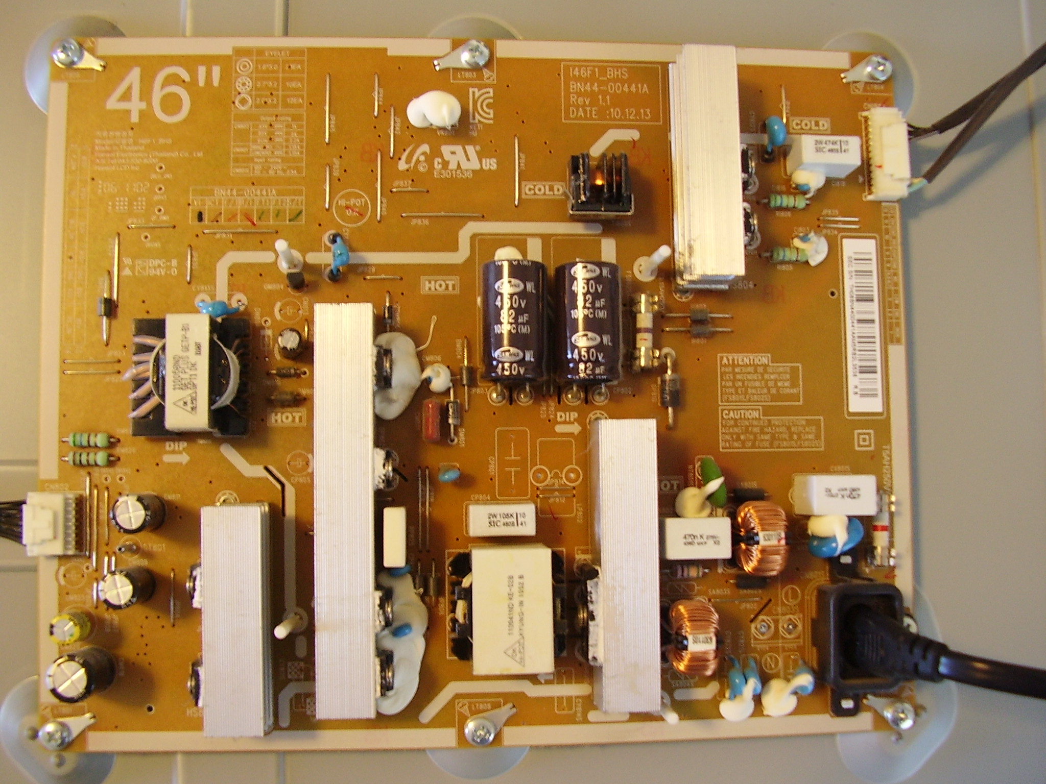

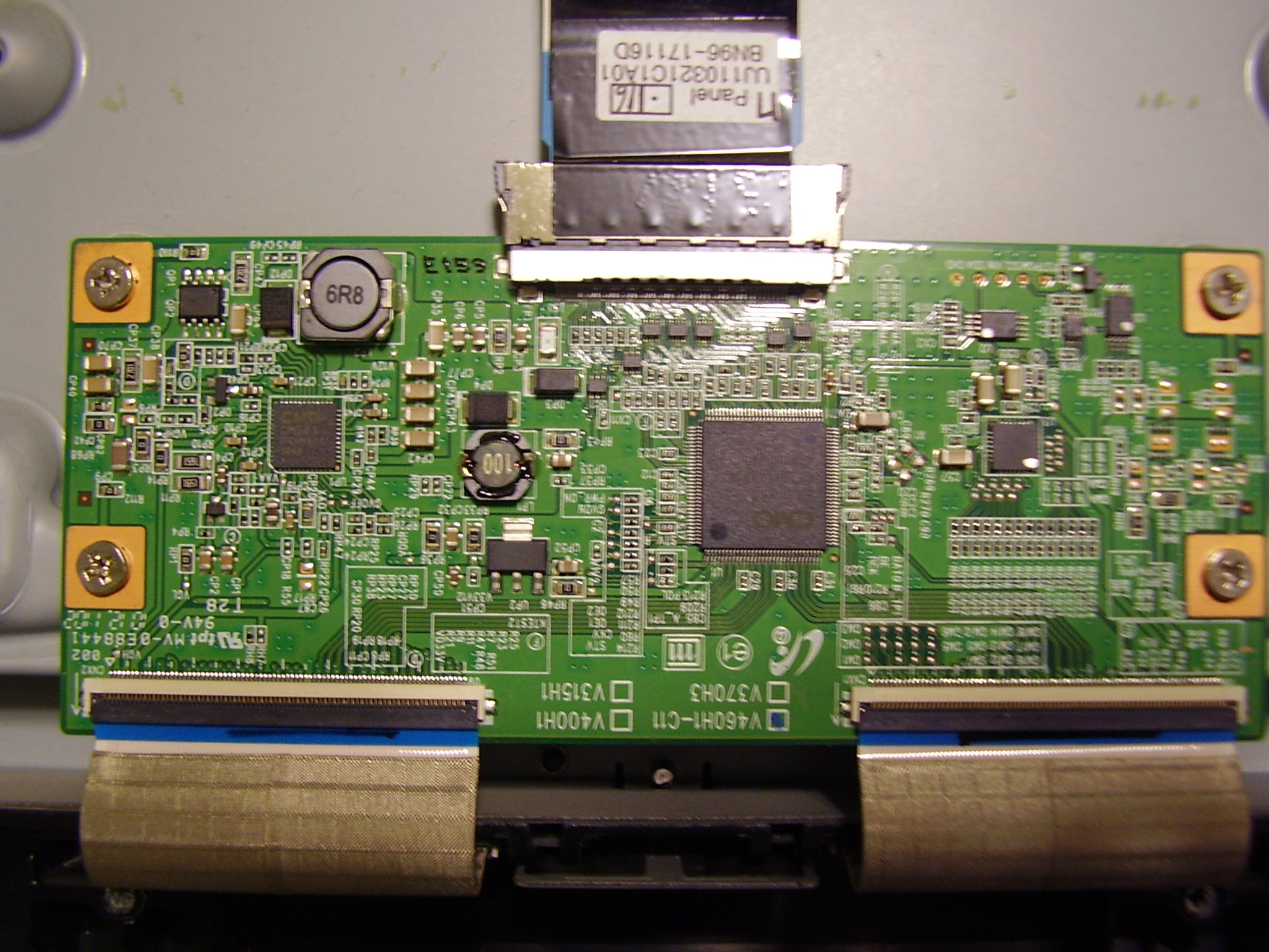

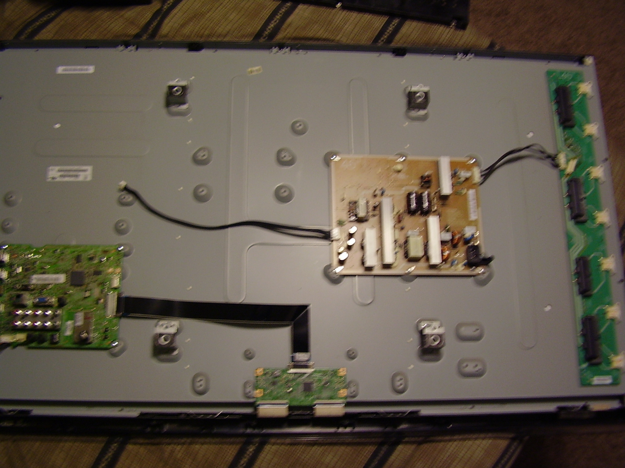

    I have sound and backlights but no image so I replaced the t-con board from ShopJimmy but the problem is the same. All voltages are checking out good, 13v,5v and 3.3v are there and the 12 volts on the t-con board is there. I have heard Samsung had some bad panels but I can't imagine it just stops working. When I power the tv on the red power light will flash 5 times then I can see a flash in the lower right of the screen, backlights will come on and sound will come on but no images. Unfortunately I do not have the remote for this tv.

    What happen if you have the ribbon cables between the LCD panel and the T-CON board connected one at a time?
      Re: Samsung LN46D550K1FXZA No Image
      No change at all

        Nest thing to do is to verify if the main board is sending the signals through the LVDS cables to the T-CON or not but you will need the scope to do that.

          Budm, i replaced the main board as well with one from shopjimmy and no change.

            Maybe i should test the cable itself.

              On the P_DIM I get 2.05v , is that sufficient voltage?

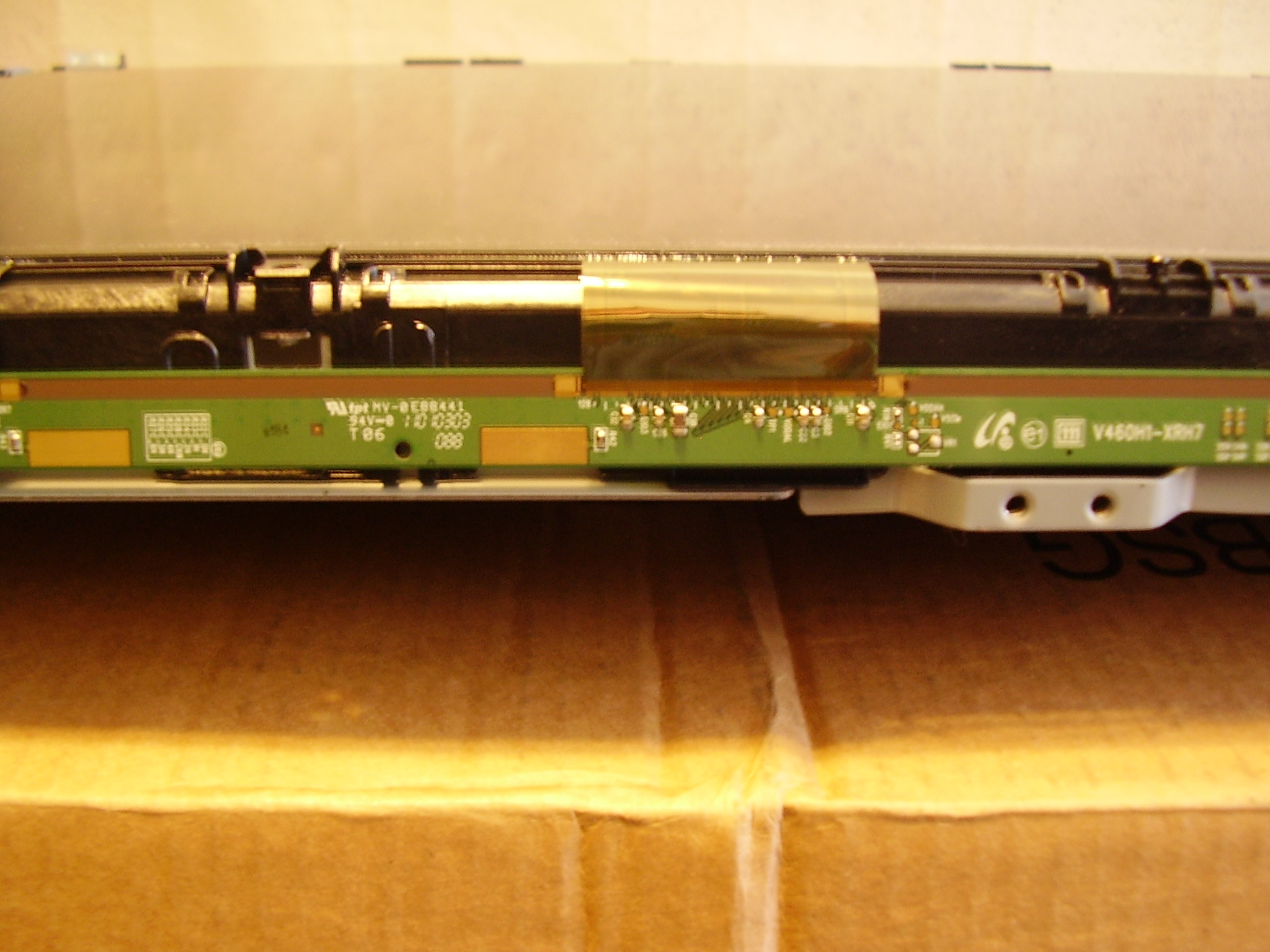

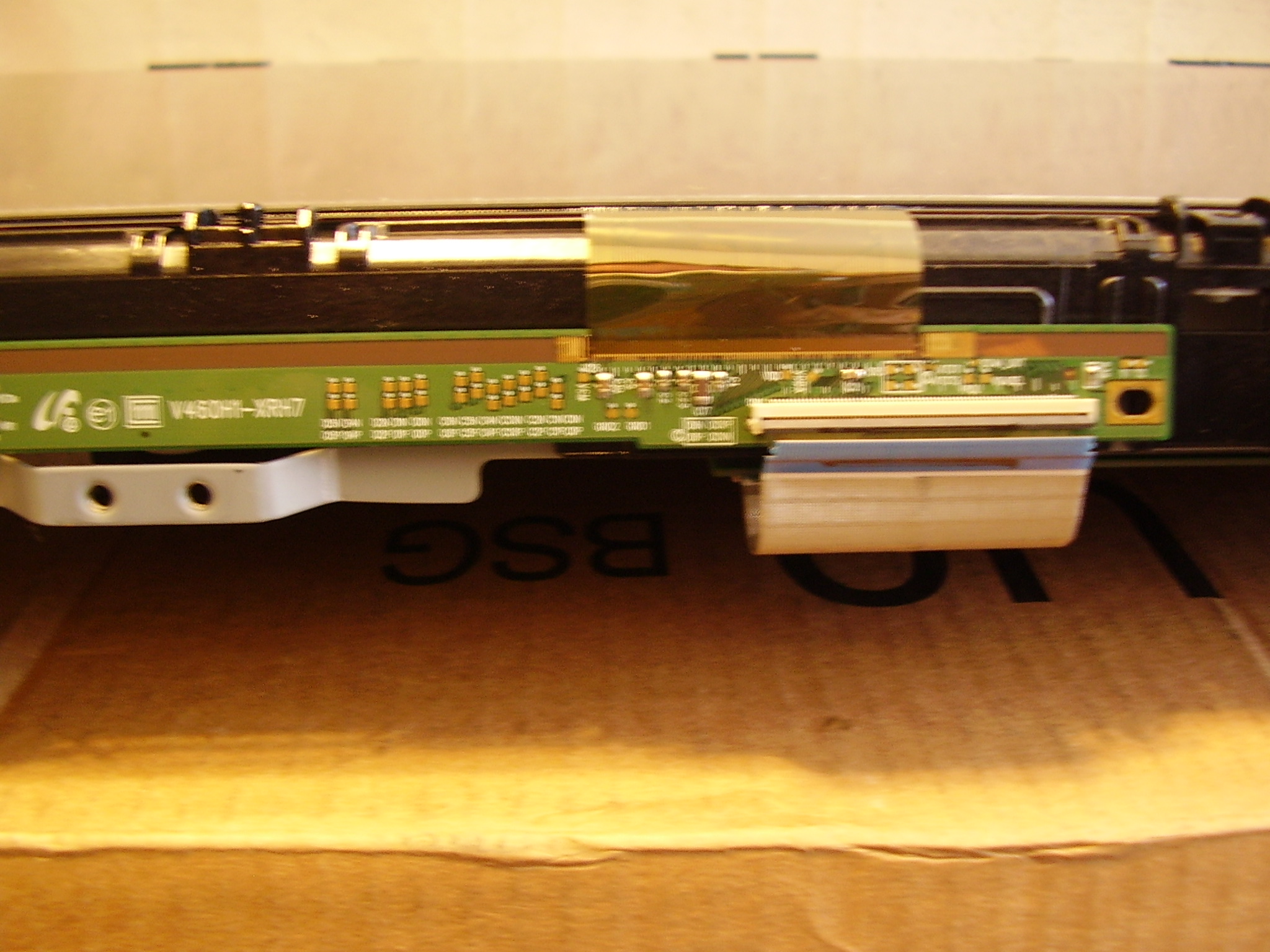

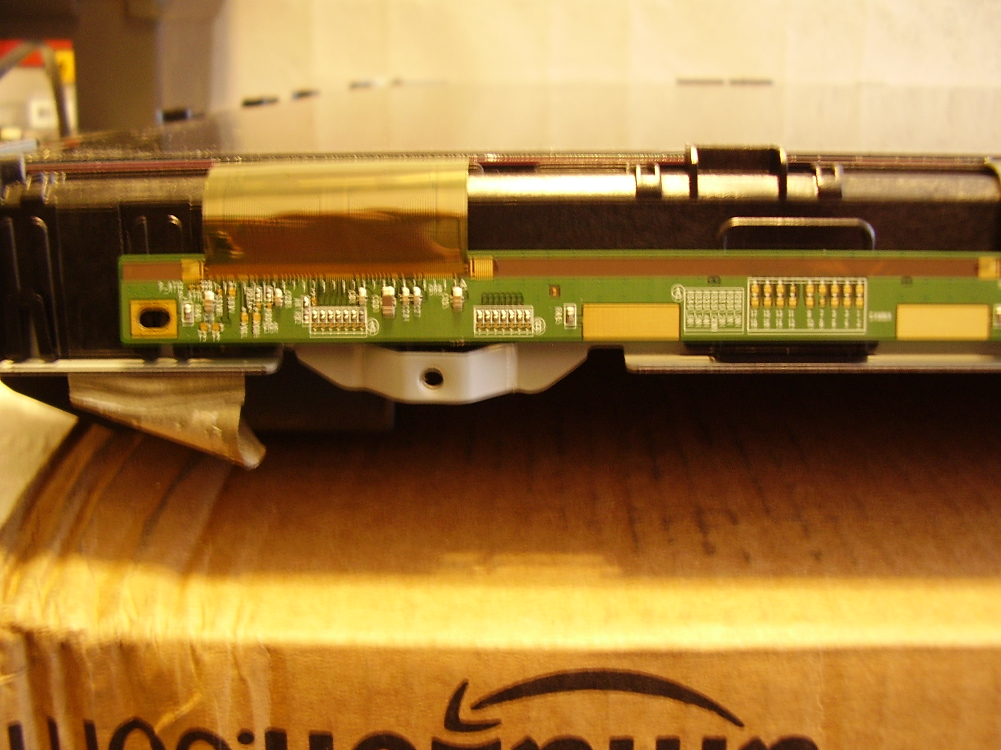

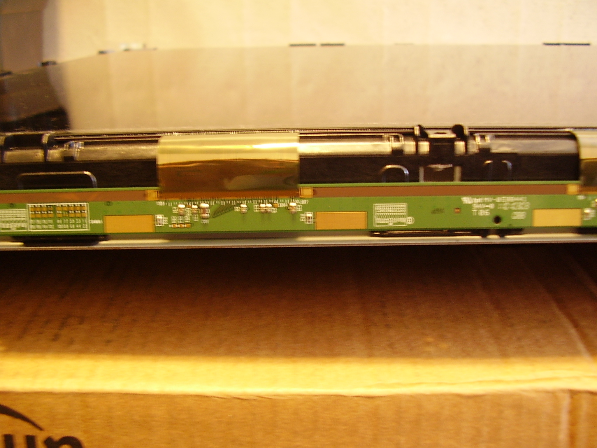

                go down to the LCD and there are DUMY left and right side they are Fuse, check them and post here
                  I don't see any fuse on those boards,

                    That is the Backlights dimming control signal.
                    I doubt that you will find SMD fuses of those tab bonding boards, it is not one of those LCD panel with integrated T-CON panel type.
                      picture 1 on the top right over the hole !!! ist DUMMY?
