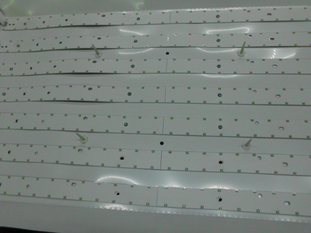

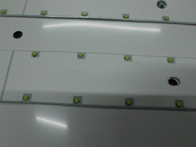

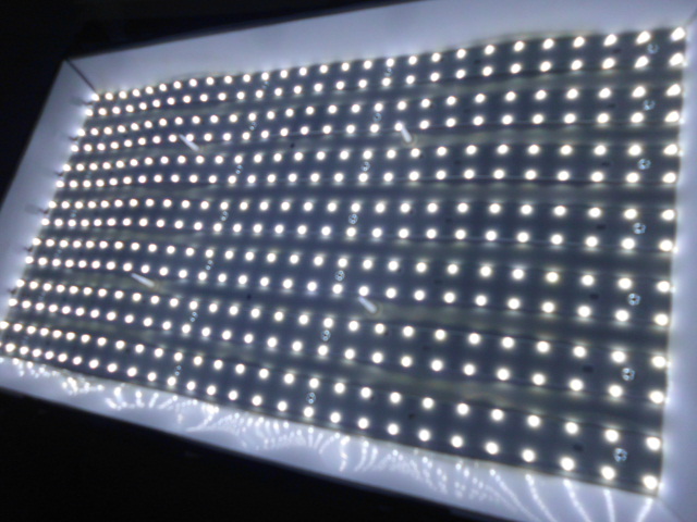

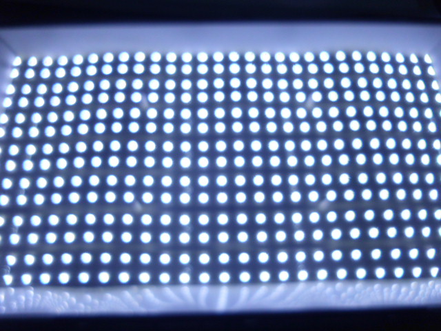

    Just dismantled this cheap 32 inch logik TV which had a smashed screen, I think they were for sale before Christmas for £129 and guess what could this be the LED backlight problem solved ?
    The LED s are low power ones and seem to be in parallel as the supply is 24v , have no difuser on the front, easily replaceable individually and screwed down not glued.

    Interesting. The smaller LEDs do fail more often though, but if the set doesn't shut down if one fails that's not a bad compromise. Just hope that they don't start flickering or flashing, they sometimes do that when they go bad.
