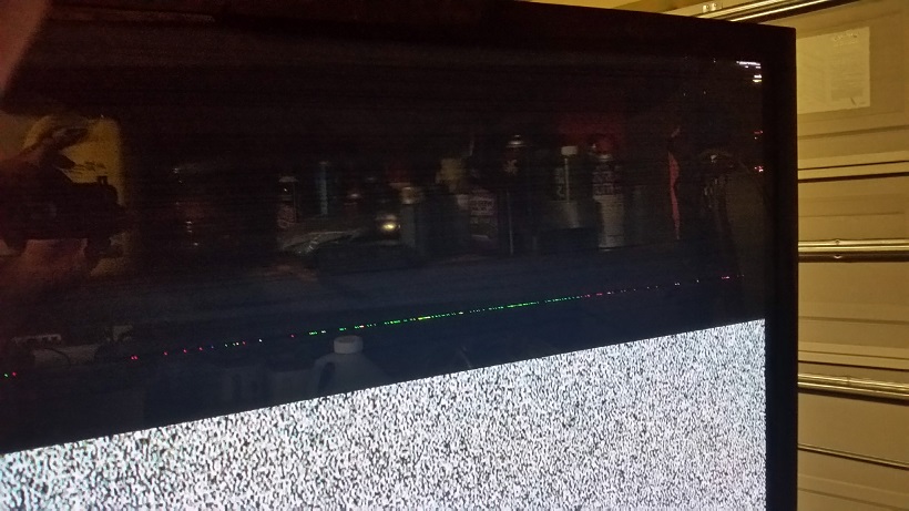

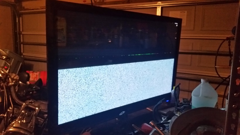

    This TV was given to me a few months ago and I just started messing with it. I am thinking it could be the buffers but I figured ide ask the community 1st. Any thoughts?

        Check the upper buffer for a short. make sure the cable between the lower and upper buffer is secured properly.
          Re: Any ideas
          Y buffer which could have damaged Y main
