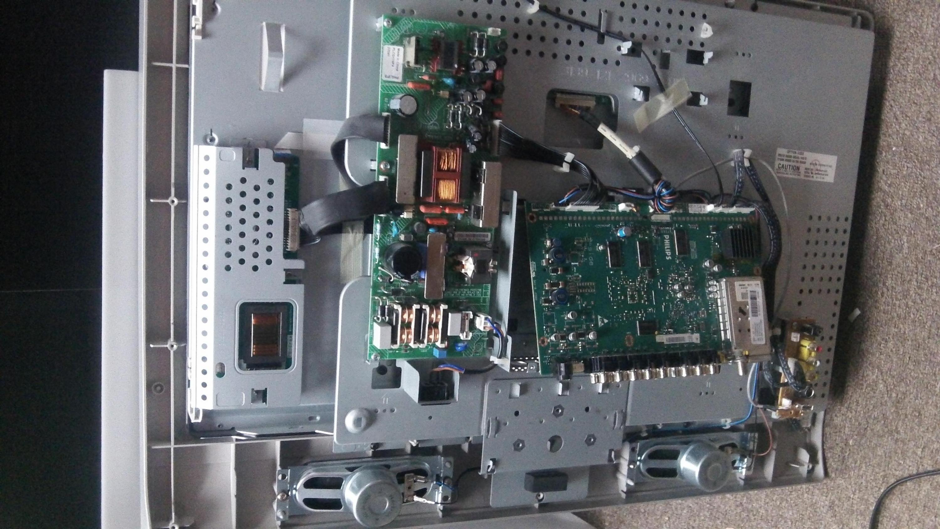

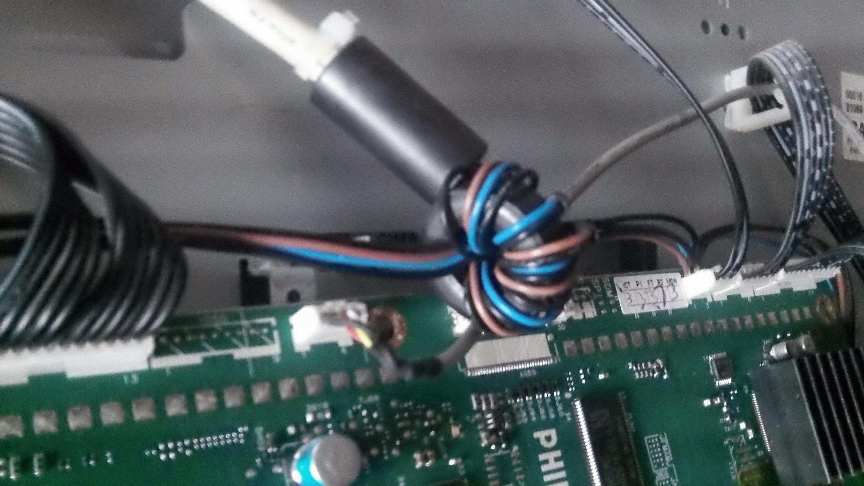

I am inspecting a TV that was donated to me, and trying to find faults on it before I decide to put the TV to use. All capacitors look good.
The donor claimed the TV shut off on him when watching it, but the TV works fine for me.
There are a couple suspect areas of the TV.

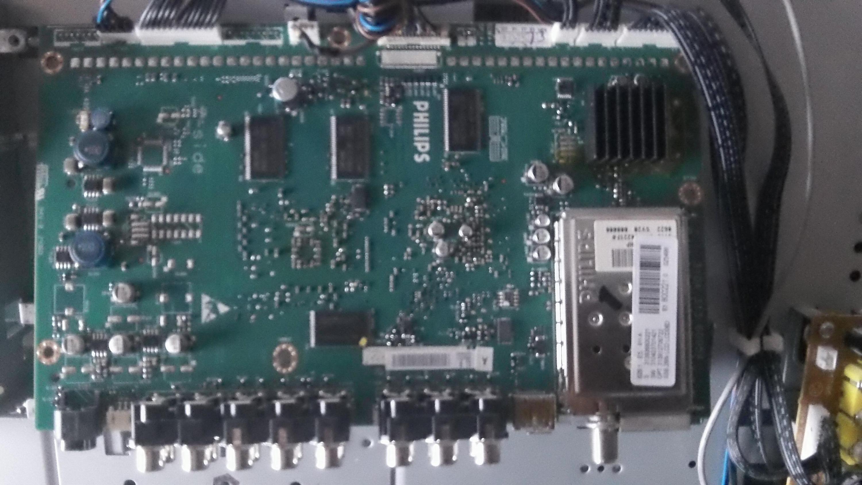

Mainboard - has Rectangle chip above the tuner that runs so hot, you can barely place a finger on it. I AM going to put a small Heatsink on this chip.

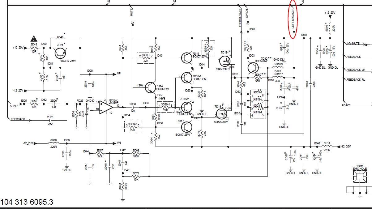

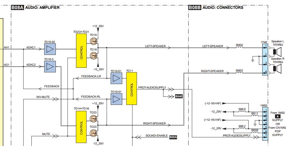

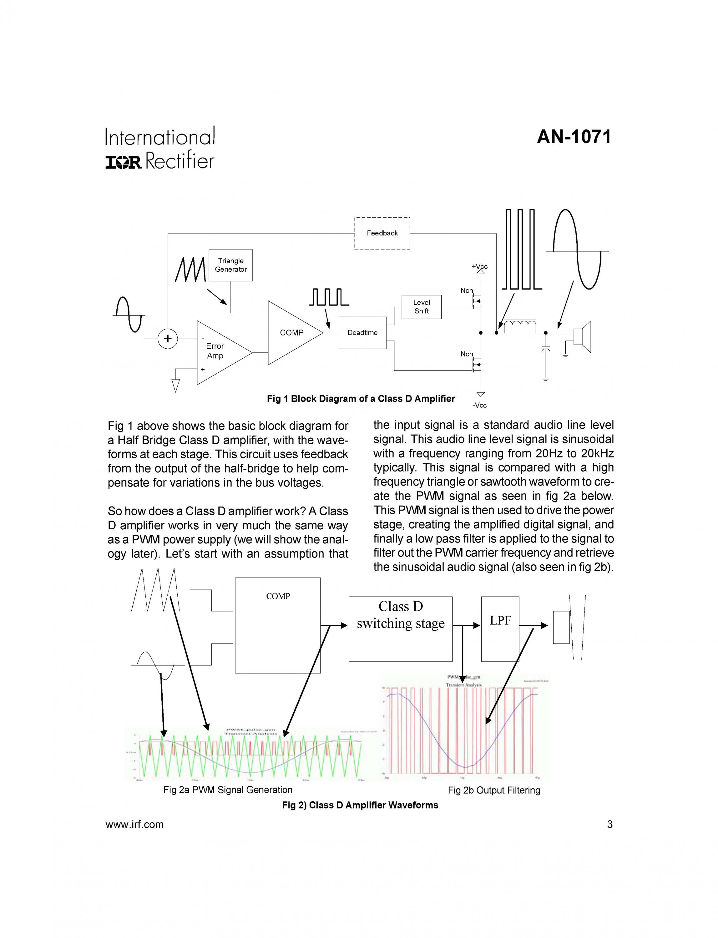

Speakers - They run WARM when they are plugged in! You can put your hand on the speaker magnets and they are warm. When I unplug the speakers inside the TV, the magnets get cool again. I KNOW this is not from heat conducted from inside the TV, the heat is being produced in the speaker coils, which has me very alarmed. I suspect CLASS D carrier wave is poorly filtered and going into speakers. I am tempted to add a ferrite bead or inductor to the speaker wires. Maybe a small capacitor across the speaker.
I have to ask, is the speakers getting warm a sign of the Class D amplifier going bad? Is this just a normal manufacturing "flaw" with this TV?
