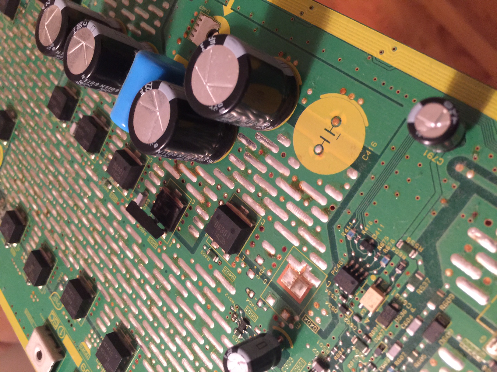

    So I got the 7 blinks after a loud pop on my TV. I did some searching on the internet and got here. Upon inspection of the back of the TV I could visibly see that the SC board had a blown piece. Not sure what it is but it is a small black square and it looks like it has two pieces and they blew and are separated. Ordered a new SC board from Shop Jimmy but when I installed the board I still get the 7 blinks. I did more digging and found the attached guide. I started on slide 50 to check the VSUS, VDA and P15V. When I have my multimeter set to 2K and the reading comes back at 1.00 for all three checks, I believe I am okay there right?

    would be interesting to see some images of the old SC and the part that blew up.

        Ok, so here is the picture of the blown piece on the board. Seems like there are other areas close buy that are burned as well. I will report back with additional details as soon as I finish testing.

            IF you find a low resistance it'll be the IGBT's and other parts of the board. The IGBT's are the black square items--Like the one with the top blown off on your nos.1 board....
            Unfortunately--The Panasonic SC boards in these later year sets can do a lot of damage to themselves when they fail. Its not unknown for up to 40 odd devices are faulty....
