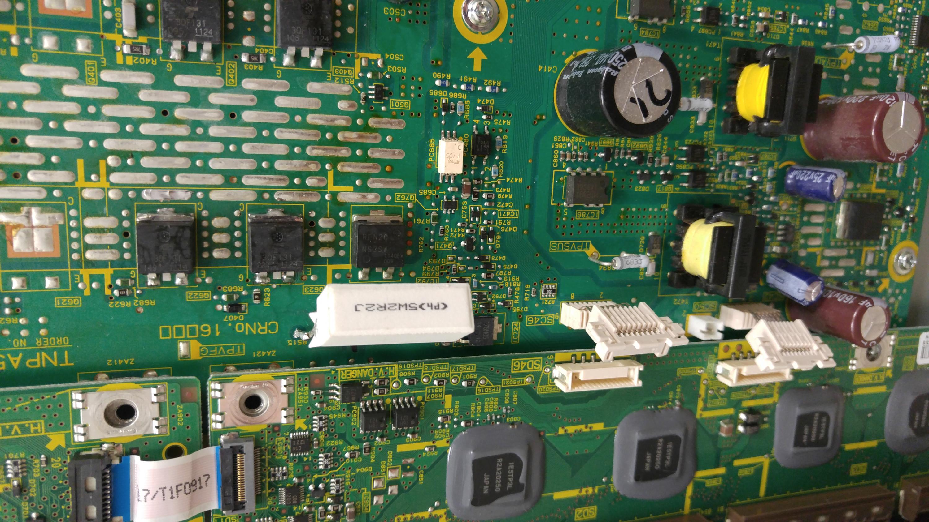

                Ok please check picture below and let me know if you think that would be safe to fire up without the buffers and recheck voltages on those pads.
                Thanks TW2005
                  Re: Panasonic TH-P50U30A 7 blinks
                  Thanks TW2005
                  should be, looks like a 2.2 ohm resistor
                    Ok fired her up and 7 blink error code with buffers. I couldn't find the connector to plug into SC50. Ill have to do that test at a later time. About to close the shop. The SC seems to be operational now at least all components I replaced are still holding, there are not shorts on the vs line, so this has to be a buffer issue unless there is something else going on with the SC that I am not seeing.
                    I guess remind me really quick, one lead on the VFG plate/screw and then measure the connectors from SC to SS and SD.
                    I will also report back voltages to VFG plates with sc 50 shorted.
                      Quick test would be continuity between Vfg plates and slide along the output pins, shorts and it's bad.
                      Otherwise I have the pinouts and resistances I got already posted here.
                      A small alligator clip if half the nose is placed in SC50 and the other across the plastic casing usually works for clamping SC50
                          Ok so with the SC50 connector shorted, I get 219vdc for incoming VS voltage, and 124 volts on the VFG plates. sc41 pin 8 and 6 were 15 volts pin 2 was 119v
                          SC42 pin 1 and 2 were 15 v and pin 6 was 119vdc
                          I am about 99% sure that the SC is all good to go and that the issue is just in one of the buffers, but I don't get any shorts on the pins of the buffers excepts for pin 1 of sc41 but I assume that is normal since pin 1 has the 124 v going through it.
                          This is what I get with the SU41 in circuit
                          Pin 8 starts at 20 mega ohms goes down to .5M and then goes back up to 2.6m and goes down again. Just repeats from there. Did that test 3 times with exact same result.
                          Pin 6 started at 5m then went down to 1m then jumped to 12k
                          Pin 2 I got a solid 2.4k
                          SU41 out of circuit
                          pin 8 is 32m
                          pin 6 is O.L
                          pin 2 is 116k
                          SD 42 in circuit
                          1 3m and keeps going down untill you hit .2m then repeats
                          2.same they are shorted on VSC
                          6. 2.4k
                          SD 42 out of circuit
                          pin 1 26m
                          pin 2 ol
                          pin 6 110k
                          also is it ok for me to take one of these out of circuit and turn the set on with the other connected?
