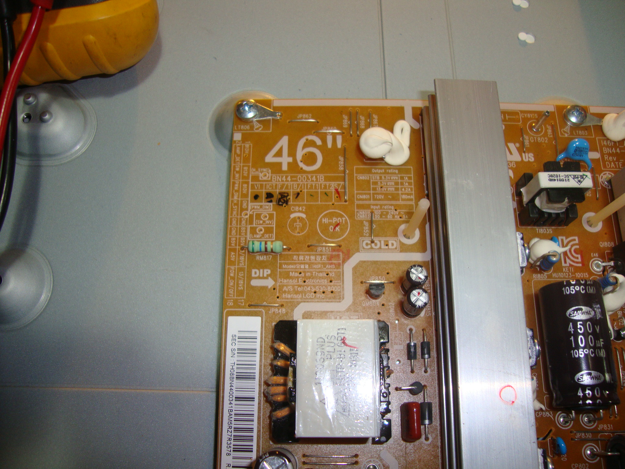

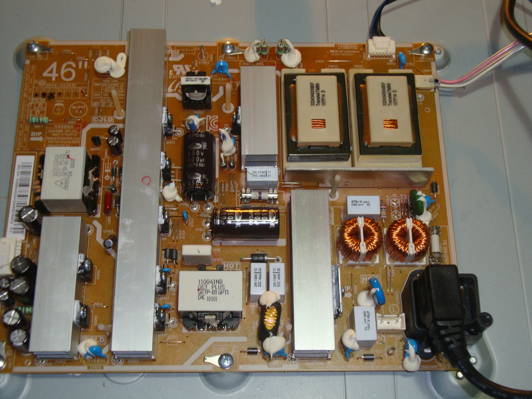

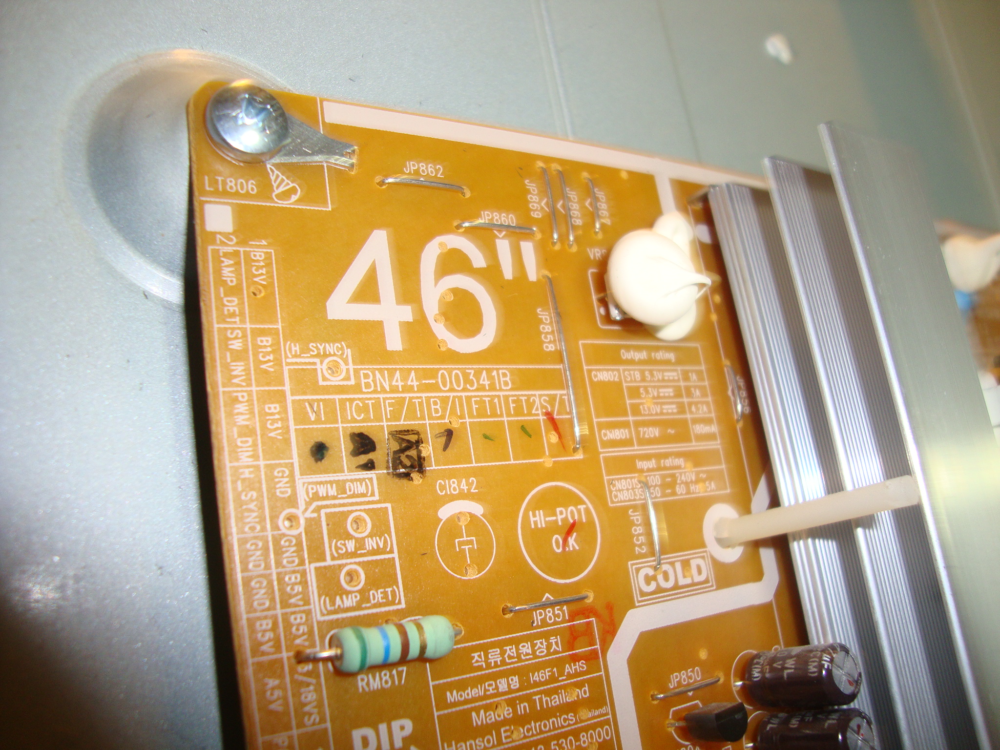

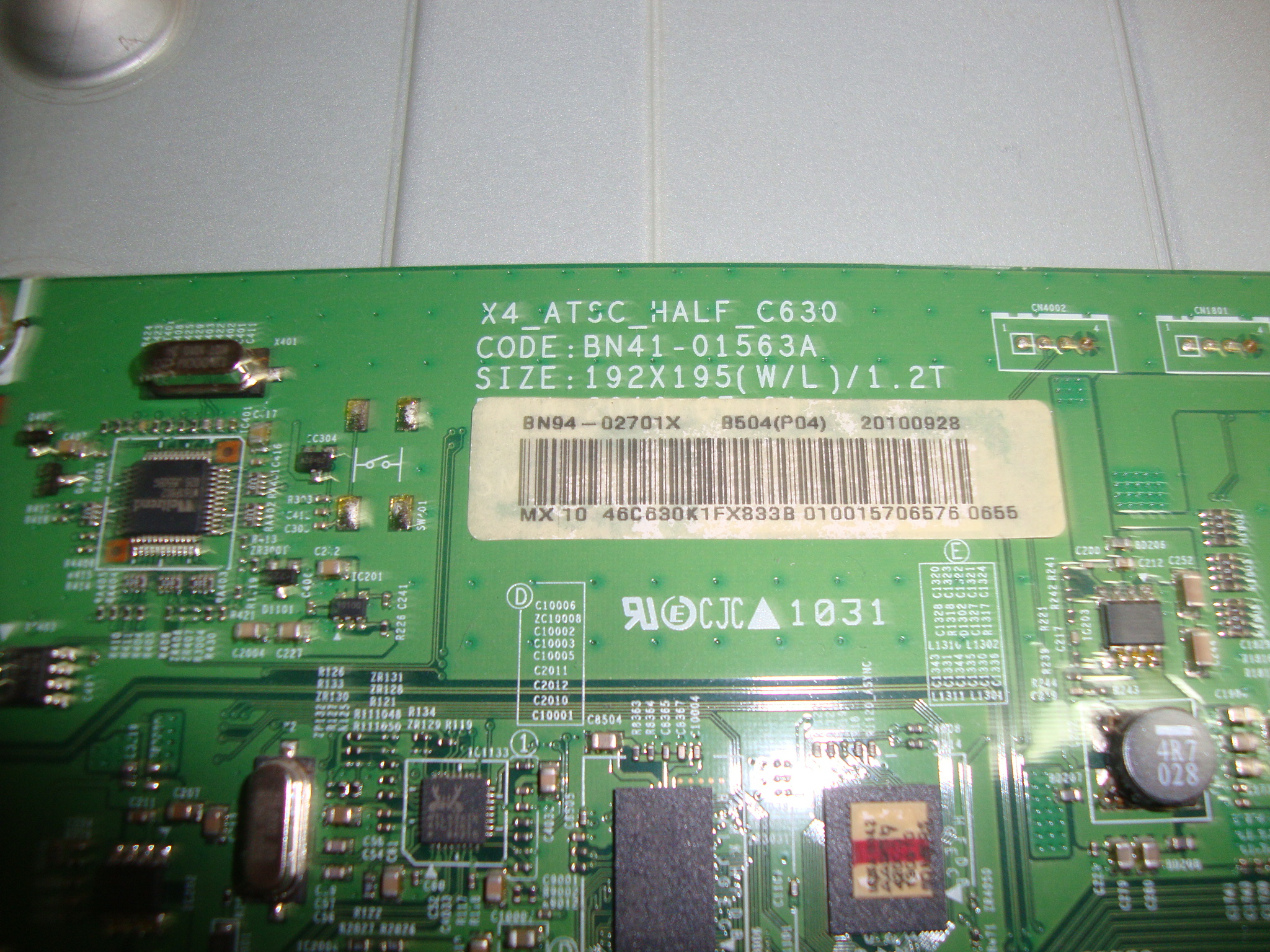

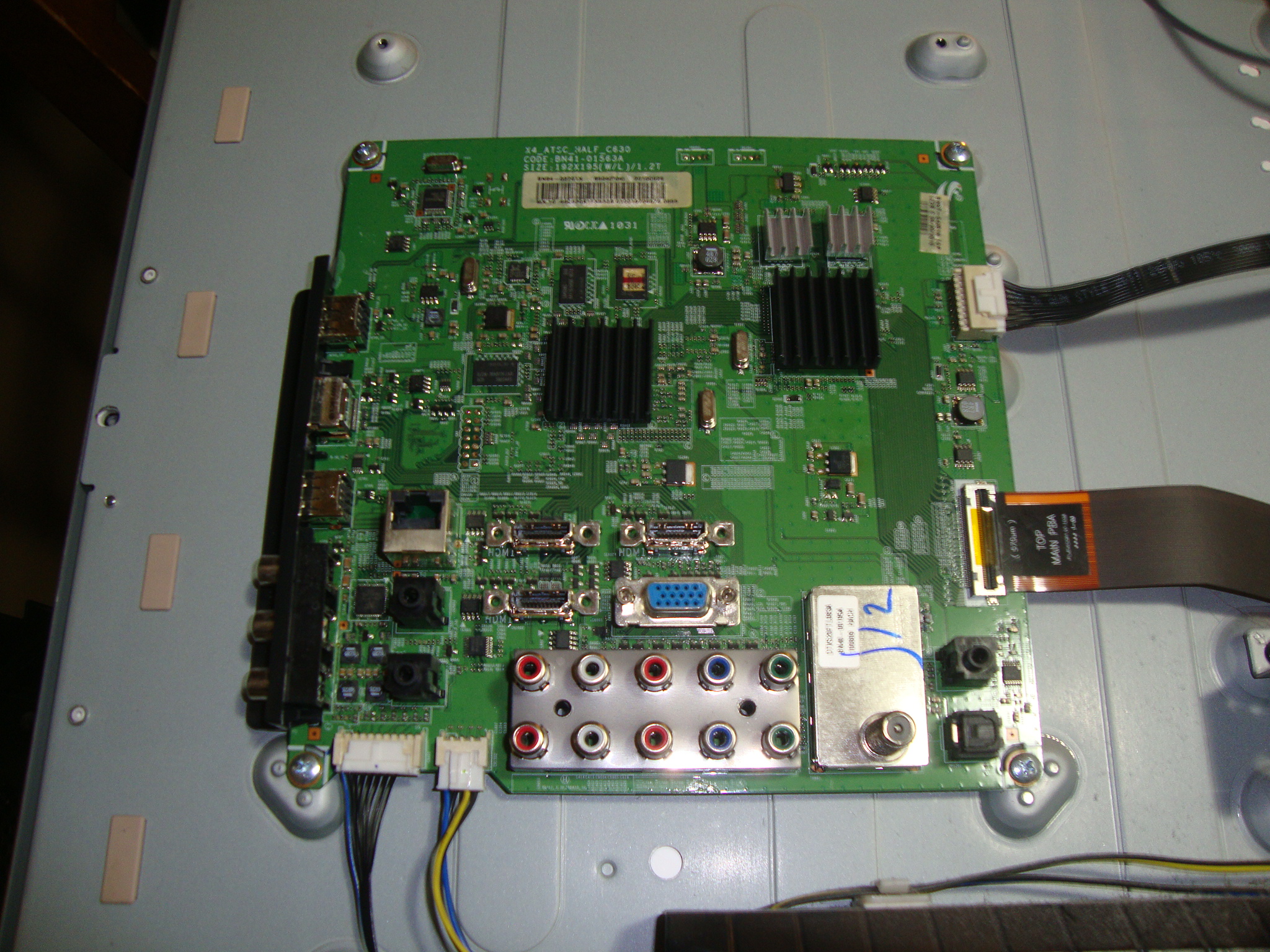

I have a Samsung LN48C630K1F LCD TV with no video. When the unit is plugged in the AC (120 VAC North America) the red power LED blinks 5 time and the Samsung tune is heard from the speaker and the red LED is off. If I use the remote to turn on the unit on the red LED comes on solid and another Samsung tune is heard, if I then switch it off and the led is off and the Samsung tune is heard again.

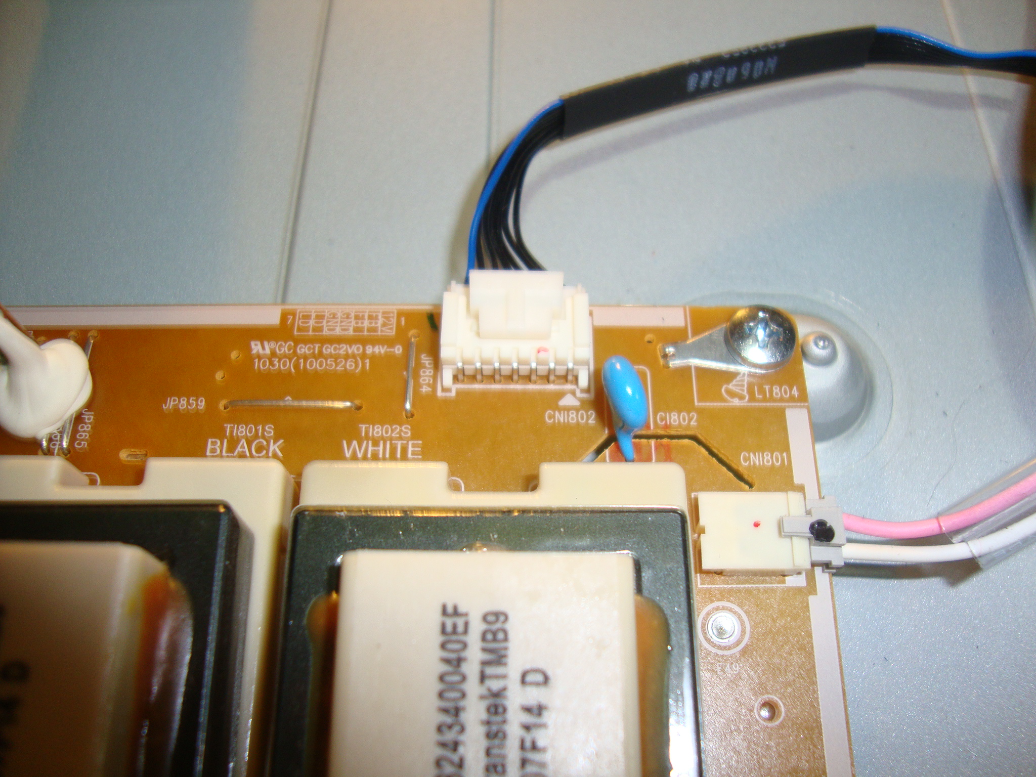

I remove the back and there are no apparent bad cap. I measured the voltage at CN1802 (PSU) and I get the following DC voltages in
Standby mode from right to left (see pic 2506)
pin 1-2 = 8.89
pin 3-6 = 0
pin 7 = 12.17
in on mode
all pins 0 V

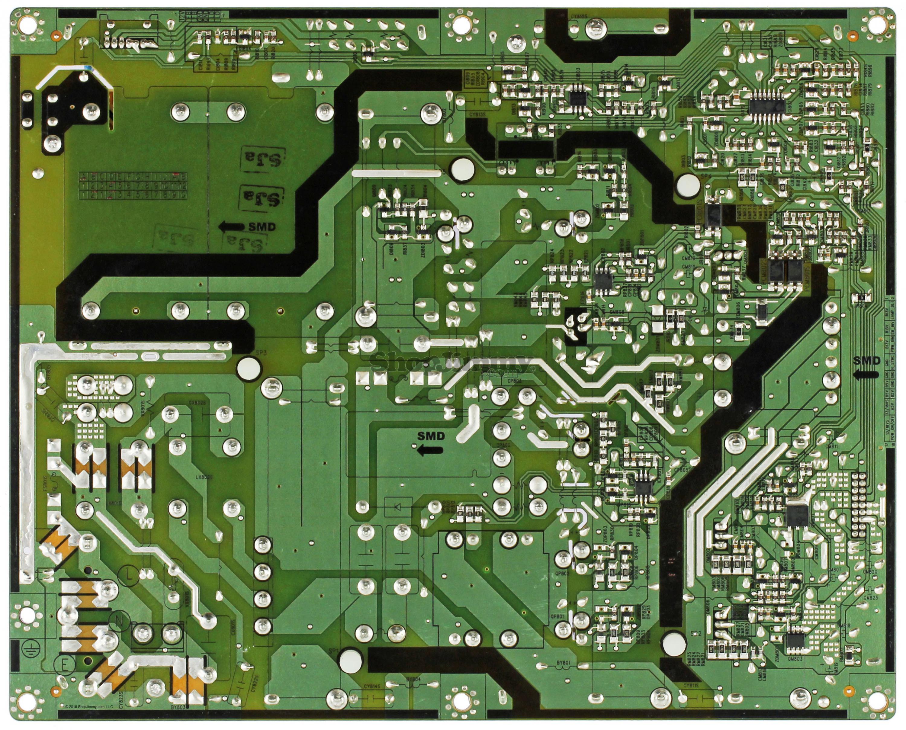

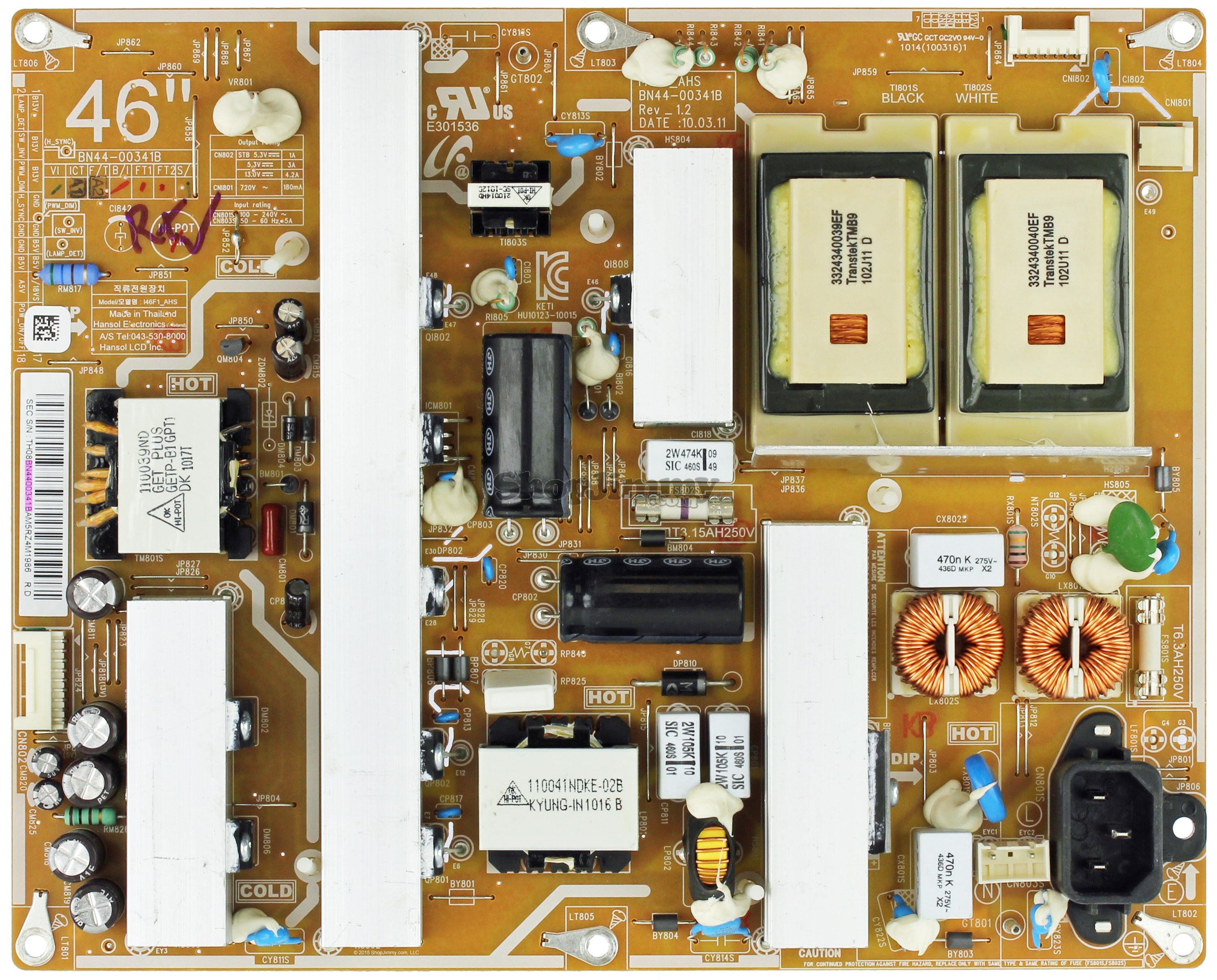

The boards are PSU BN44-00341B and video BN41-01563A. I have attached pics. I will check back from work tomorrow.
