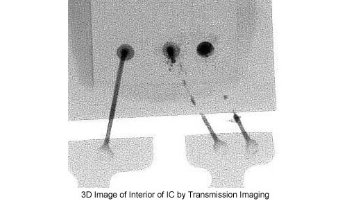

          • lookimback
            • Aug 2013
            • 1489
            Re: Using x-rays for IC inspection. Think these portable dental units are good enough
            This is what I'd be hoping for.
            ------------signature starts here------------
              Originally posted by lookimback
              It does require film, but for about $1000 more, I could get a digital imaging system so I wouldn't need the film and developing equipment then. I definitely wouldn't do this outside of a lead lined cabinet. What about the likelihood of identifying a defective IC? Wouldn't I be able to see if the bond wires or other internal circuitry was damaged?
              Bond wires - probably - depending on the resolution. Failure of bond wires is usually seen when there are holes in the package. If you ever see a burn in a corner of an IC, that's a bond wire that's evaporated under high current.
              As for the IC itself I think you may have difficulty determining if a failure exists except for obvious failures that would typically show themselves on the external packaging.
              Remember this device is designed to image people. So I am not sure you will get the resolution you are looking for. And you can buy a lot of other tools for $1,500. I'm not convinced myself that it will be useful. My two pence...
