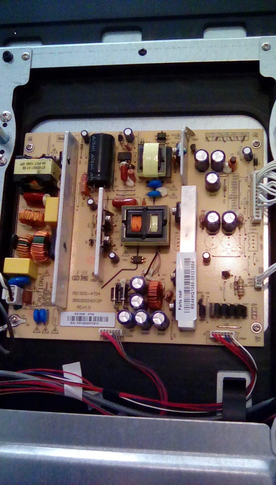

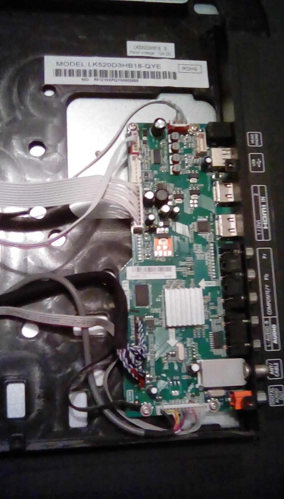

    I have an rca LED LCD TV that won't turn on. When you plug it in, the red light comes on. When you hit the power button on the remote or on the side of the TV, the light goes out and nothing happens. I read about another similar problem on here but it was slightly different in the voltage readings. On the main capacitor I have 167 dc with it off (red light on) and 396 with it turned on. Voltages on con2 are all showing what they should be according to the markings next to it when its on. There's no bad caps showing. Tried unplugging the con5&6 connectors one at a time to see if there is a short in the LEDs but nothing happens. Could it be a bad power supply? Or do I have a bad main board? Don't know where else to look. Can someone help me out? What else to look for? I'll post pics of the boards below

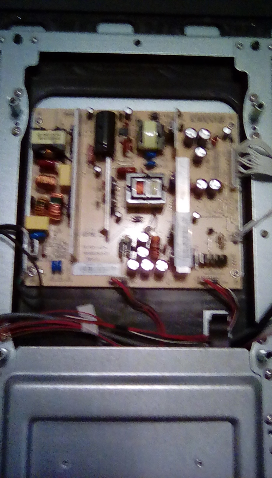

    Re: RCA Model # LED52B45RQ not turning on
    Posting pictures of the back of your tv showing the boards with clear pictures may help you more with fixing your problem
      Hmmm. I posted 3 of them. Let me try again.
        Better picture of the board.
          Probably corrupt firmware. Type in your model the frimware into google.
                I checked the voltage s and everything is within specs. It seems as though the main board isn't turning on. They sell a new replacement eeprom for the board for $15 but it says that if I don't have a blue light when I hit the power button then the eeprom might not be the problem, but something else on the board. Opinions? Or other tests/bypasses to verify it's the main board?
                    OK.I bought a new eeprom for the main board. Television turns on now but the screen is upside down. I made sure that the number one pin was at the arrow on the board. Anyone know how to fix this??
                            Could we see a pic of the T-CON Bd?...There're 2 things you can try...(1). Switch the TV to Factory/Service Mode and see if there is a way to invert/flip the screen or (2). Remove/replace the position of resistors on the T-CON Bd to 'hard' repair the issue.
