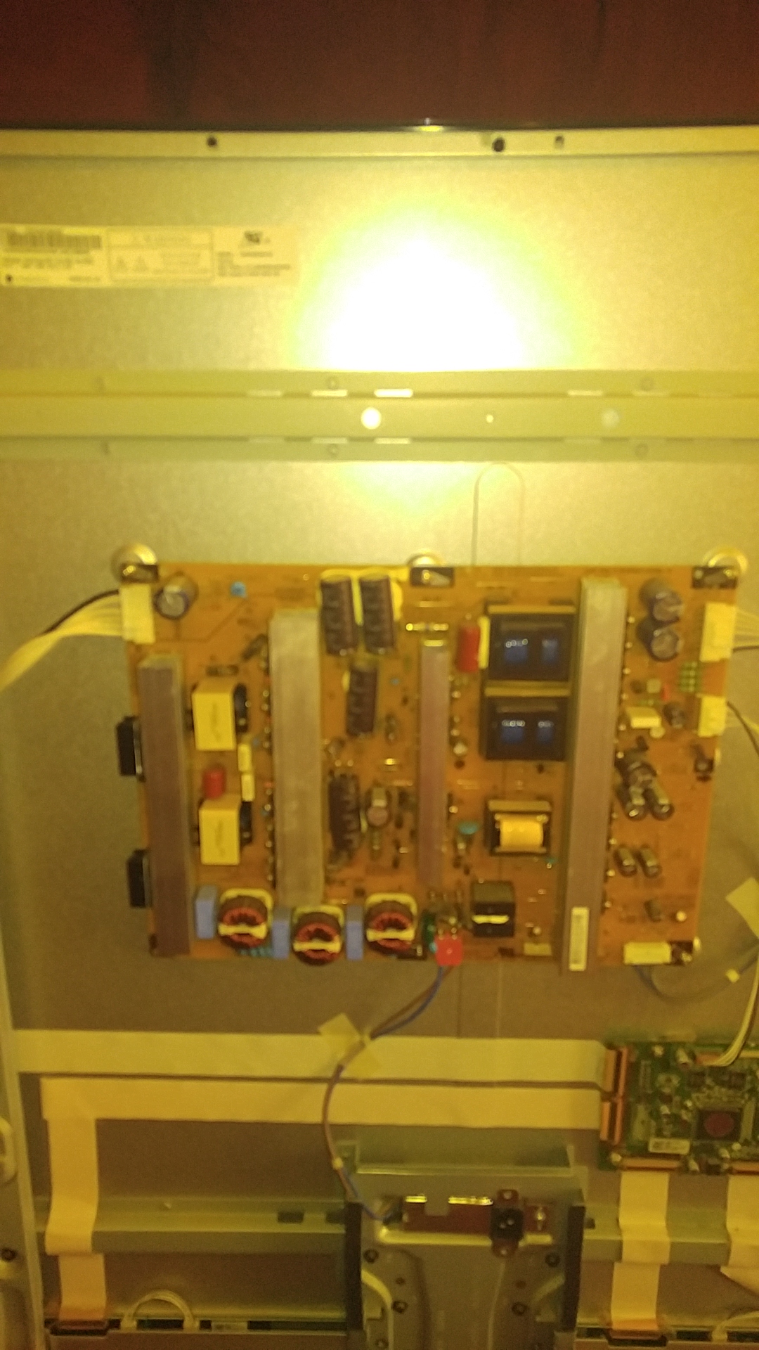

    I am stumped, this television started turning itself off after about 20 minutes. I suspect something is overheating though I can't seem to find where. I can turn it back on but then it will shut down again. The caps appear normal no blistering or leakage. I suspect that the issue I am having maybe on the y or z sus board but have no idea what to check or measure. There are some pots on each board y/z but i haven't messed with them.
    Anyone that may be able to help I appreciate it it greatly,
    Thanks in advance

    Re: LG 60PZ750-UG Powers Off
    pictures?

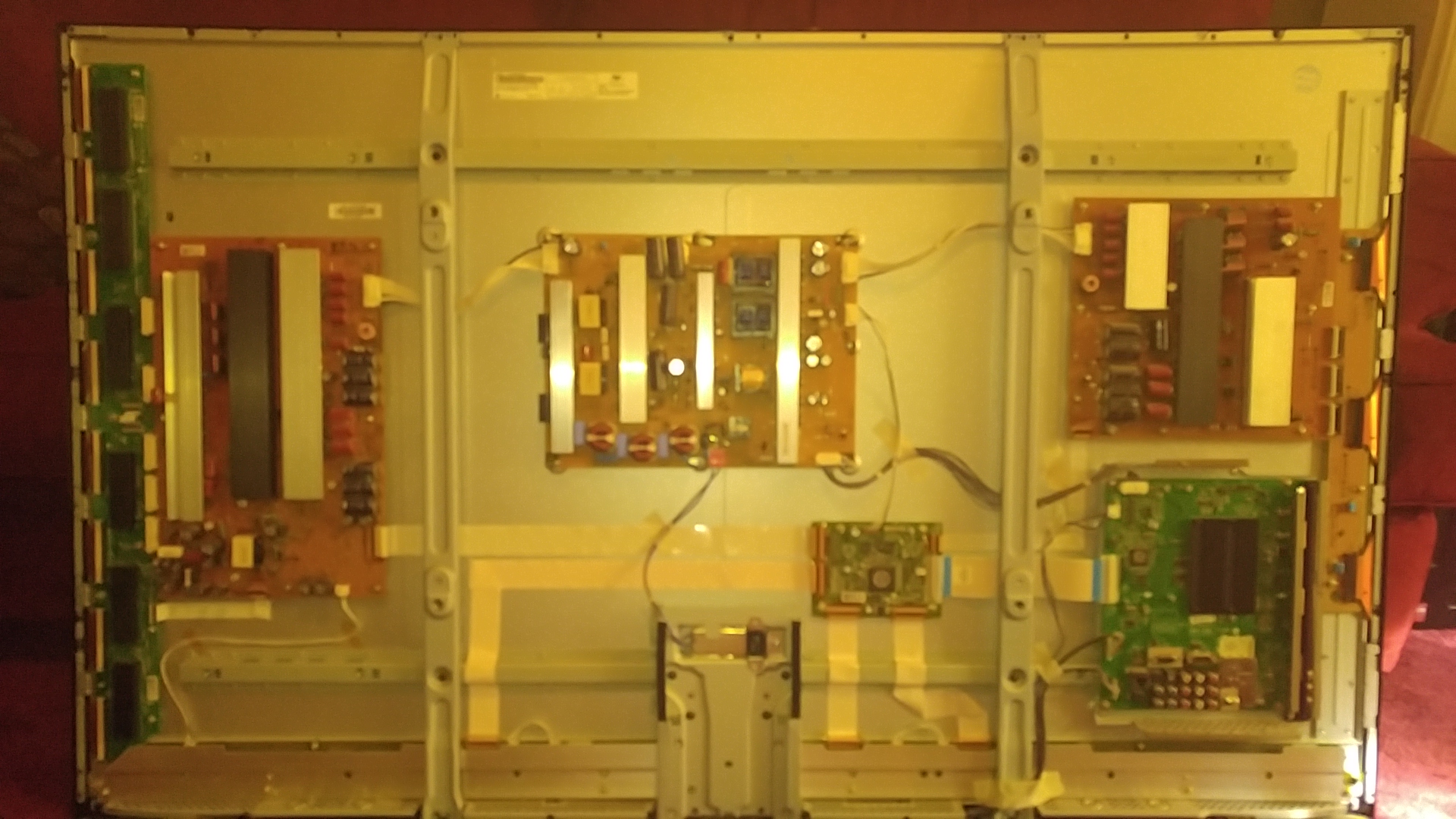

    • cgpastirik
      • Dec 2015
      • 13
      Pictures attached.
      If more detail is needed let me know, Thanks
      • Hamie
        • Apr 2014
        • 1383
        Read post #12 in this thread.
        https://www.badcaps.net/forum/showthread.php?t=50808
        Do the test pattern jumper on your model the board should be the same as it's pretty much the same tv.
        Run test patterns, let us know if the fault still occurs.

          Thanks for the help, it ran the test patterns for about 10 - 15 minutes and then shut off
          • Hamie
            • Apr 2014
            • 1383
            Ok to completely rule out the mainboard
            Disconnect the cable that connected the power supply to the mainboard and with a piece of wire connect 5vstby to RL-ON
            Like this:
            Now plug in the tv, the tv will start automatically and start to cycle through test patterns.
            Does the fault still occur?
            • cgpastirik
              • Dec 2015
              • 13
              30+ minutes without shutting down. I will let it continue. If this turns out to be on the mainboard, is it a simple component R&R?
              • Hamie
                • Apr 2014
                • 1383
                Just let it run.
                Need to be absolutely positive.
                Possibly cracked solder under the CPU, Or corrupt data EEPROM.
                The mainboard sends the signal RL-ON to the power supply. If it stops sending then the tv will shut down.
                • cgpastirik
                  • Dec 2015
                  • 13
                  Thanks Hamie, well it has been running the test pattern overnight without issue. I await your next step.

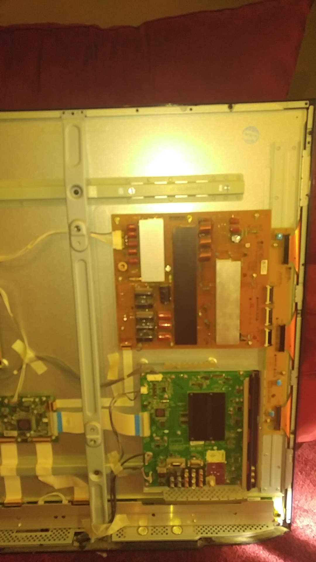

                                not to rain on anyone's parade, but after going through the schematic, this is beginning to look more like a YSUS issue. .
                                If any one is familiar with an adjustment, replacement or other please chime in. I will update as I figure out more.
                                Also I located a Service manual for this model with very nice schematics. PDF format should anyone need it.
                                Experience: 20+ year Electrical Engineering Technician
                                  If the set ran overnight with the test patterns on it's not the Y-sus or other boards, as the test patterns are pretty much a full on stress test...
                                  There is a very small chance the power board is causing this if the low voltage rails are not well regulated, check if they are stable while the set runs.
                                  Also try the heating idea starting around CPUs - not impossible you got a bad board

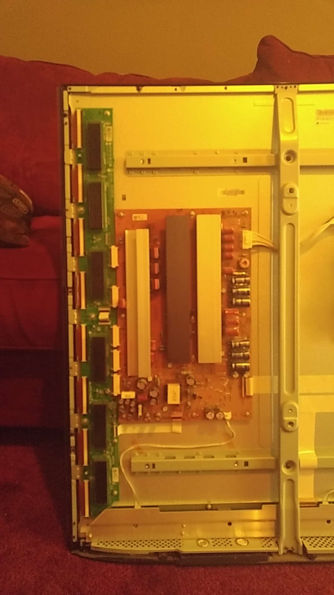

                                    Thanks Tom, I will have to work that out tomorrow, I will let you know. And yes I agree now having gone in feet first with this think, I have ruled out the YSUS contrary to my last post.....
                                    What role does the ZSUS play in this puzzle?
