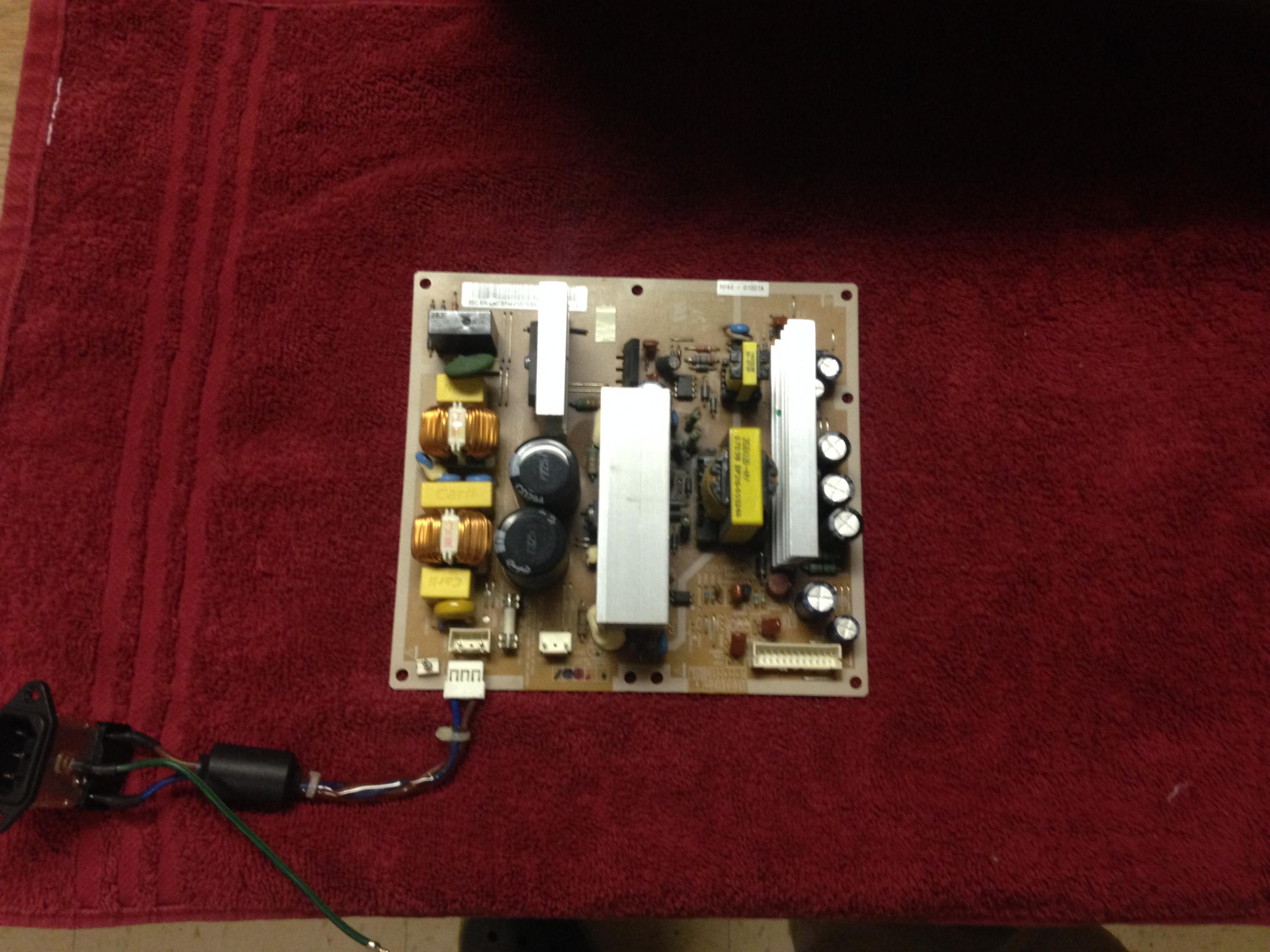

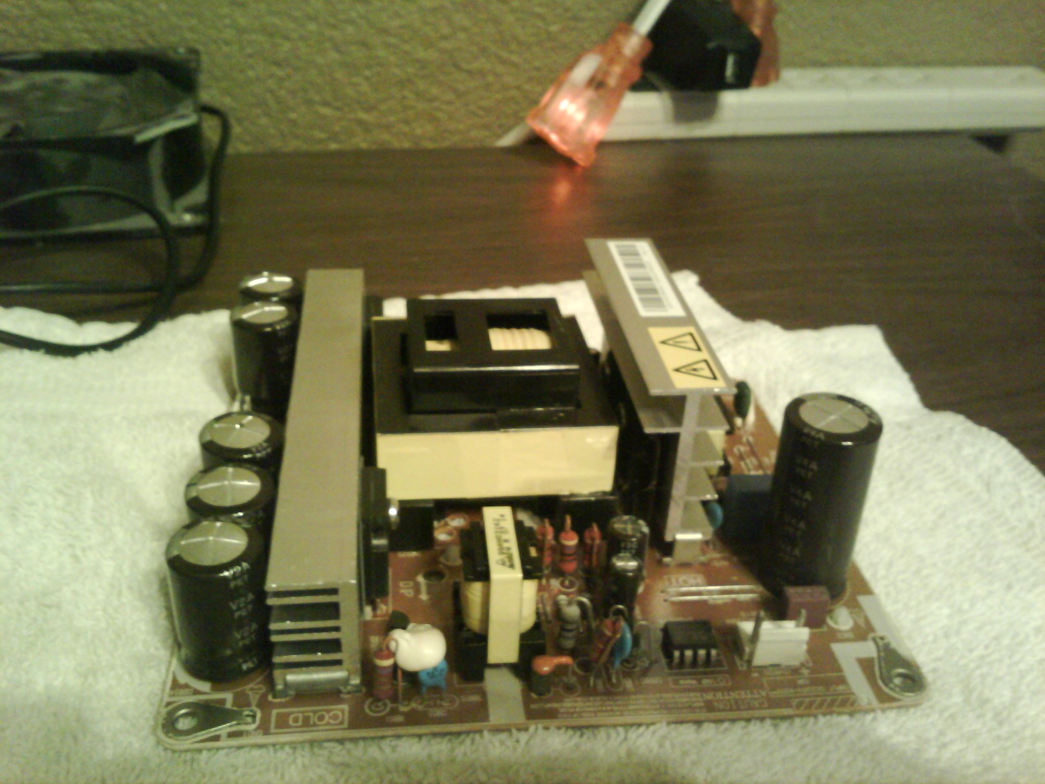

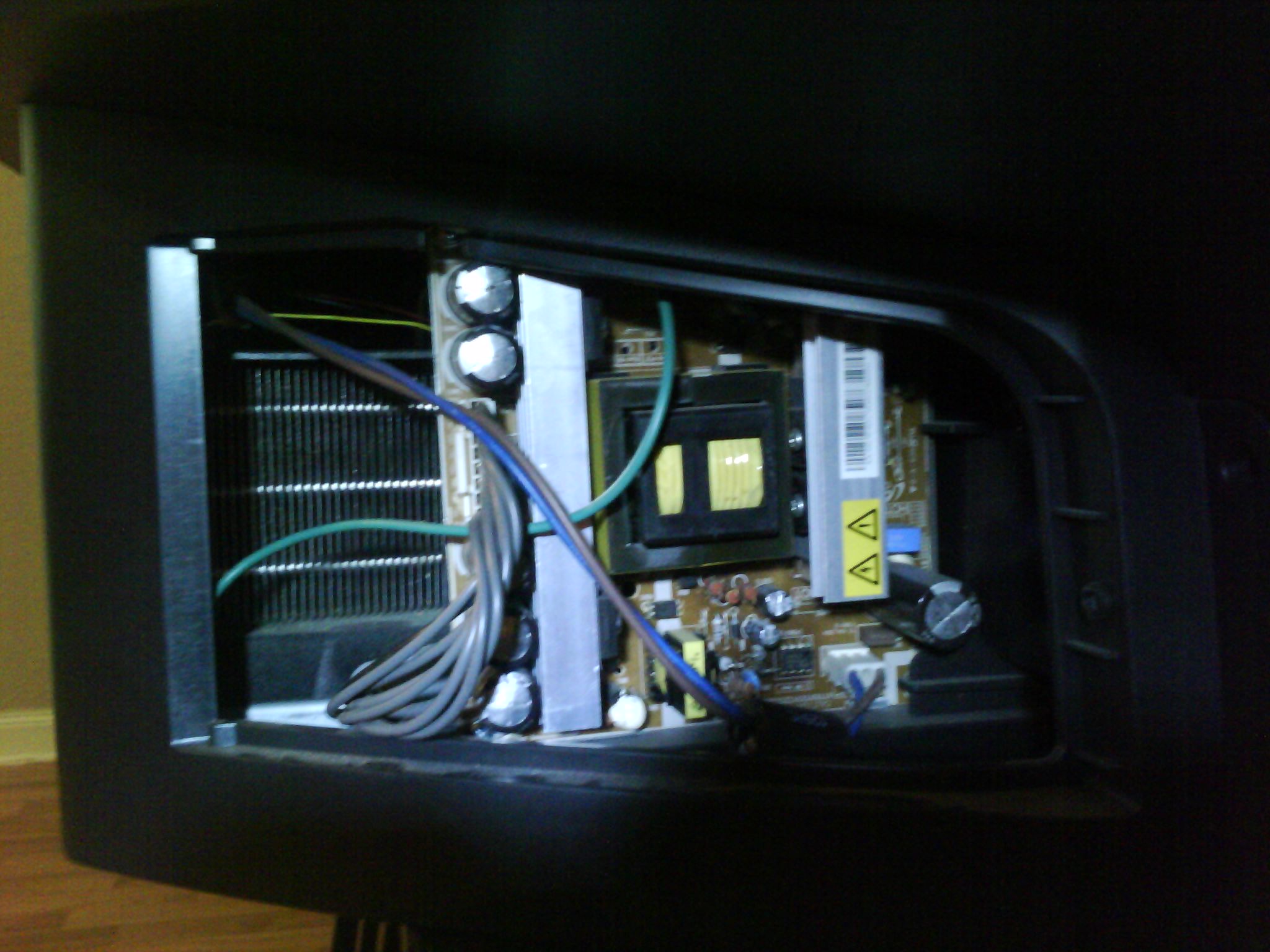

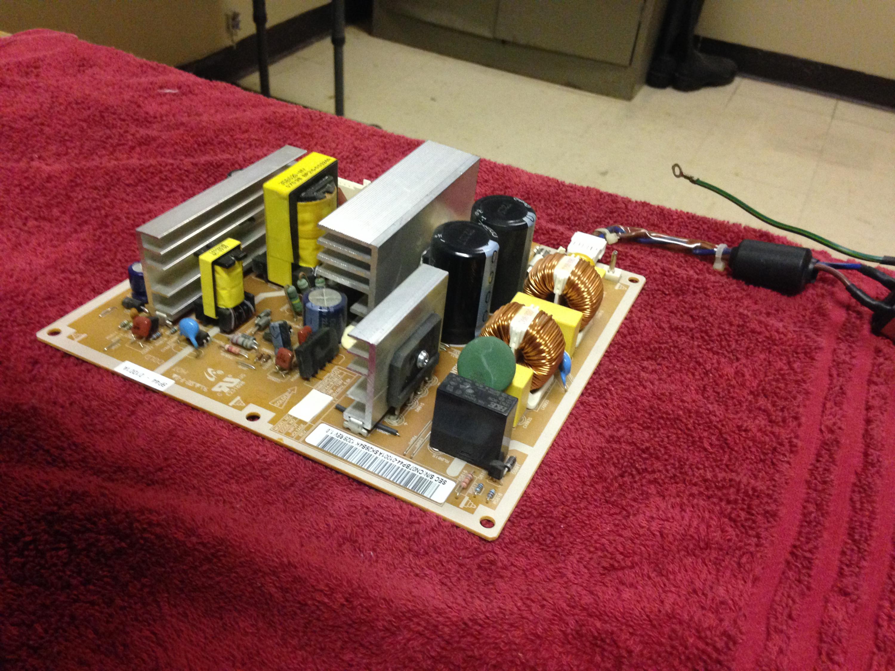

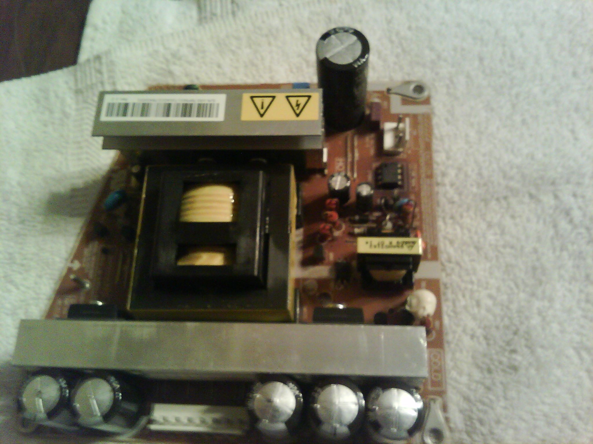

    First let me just say hello to all and glad I found this site. Also I Searched posts and threads with no luck on this TV. This Is a TV someone was going to throw away in 2013 and I now have it. When I got it TV would power up and cycle several times sometimes locking up having to be un plugged and other times would go back in standby mode. I changed the five bulging caps on the LED power supply board. TV would then come on but would take 2-5 tries always going back in standby mode. Then it got worse and would take sometimes more than 10 times but always going back to stand by mode with red light. So the TV hardly ever got shut off and the red phlat led light went out and I changed that out. Took many tries but came back on and watched it over a year again hardly ever turning off cause it would take so long to turn on. Now the TV will not come on. The sound comes and goes while it goes thru the cycle trying to start up but goes back to stand by mode with red light. While cycling the green light , led, blinks 27 times with a long pause 14th time with green light staying lit then finishing out the 27 blinks followed by a minute or two of nothing then back to standby with red light. Suspecting the big caps were bad I heated them with hair dryer and TV started right up first try faster than ever has. I ordered the repair kit of 9 caps from shop jimmy and installed them on psb. The psb has 11. Did not get the two middle caps by silver heat sink and the two replacement big caps are 200v 470uf not the 200v 560uf shop jimmy said would be fine. I really thought this would fix it but doing same thing. It will still come on blowing hot air with hair dryer towards/on big caps but now it does not stay on as long. Sometimes it distorts and picture freezes up and sometimes goes back blank/black. Sound works good until it shuts itself off back to standby mode. Once I changed channels while picture was distorted with crazy lines and had sound from channel I changed to but frozen pic from previous channel. It is hooked up thru AV receiver. Im wondering if the two middle caps that I didn't get or replace could be it just getting heat from dryer when I thought I was heating big caps or maybe even something heating up on digital/analog board directly under it. Im going to try to include some pics of both boards and the Pic of TV.

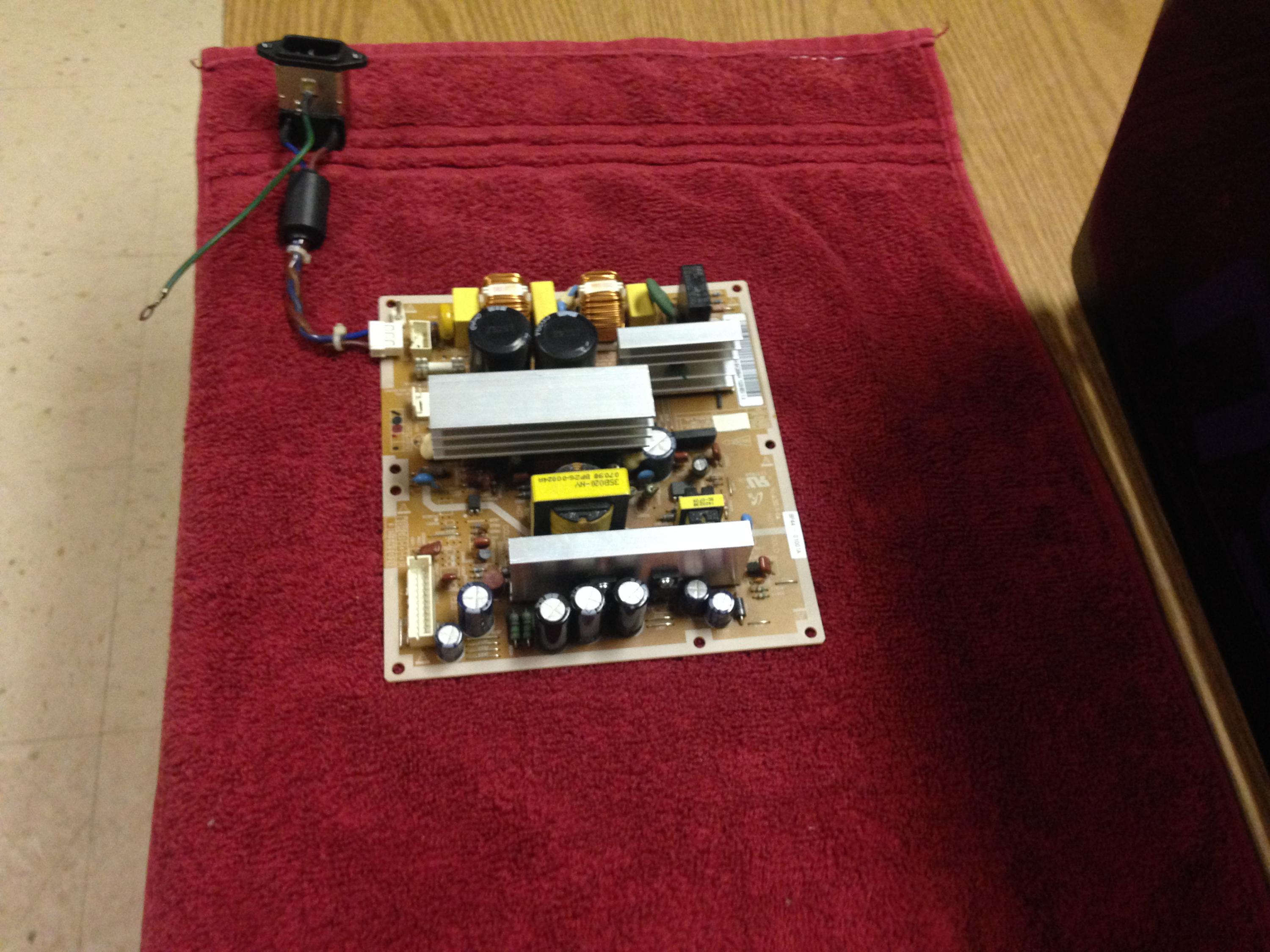

    in the 3rd pic was the first led psb I replaced caps on but not the one by itself or the two little ones only the 5 in a row which got me over a year of working tv
    in the 8th pick is main psb I changed 9 of the 11 caps shop jimmy sent in kit that did not include the two in middle of board by silver heat sink
