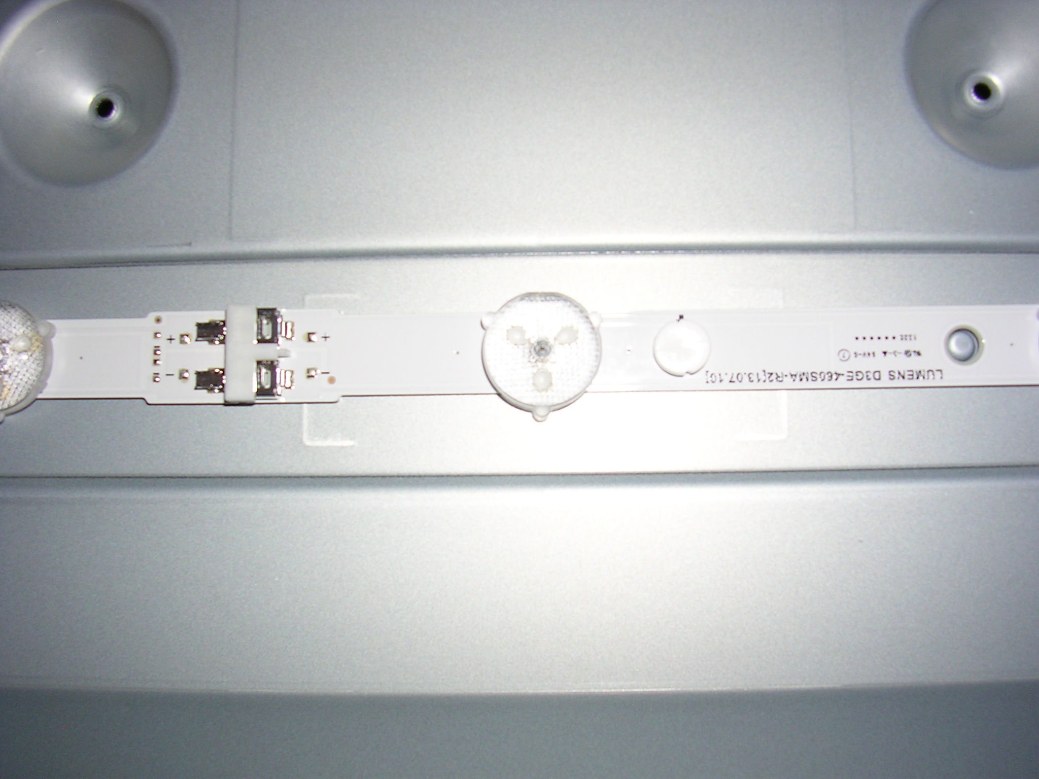

    Alright it looks like they are soldered together.....
    https://www.shopjimmy.com/catalogsea.../?q=un46eh5000
    https://www.shopjimmy.com/samsungltj...face-board.htm
    So these LED strips for sale with the interface panel are for the same model TV, but for a different Panel then mine. The mounting looks the same, the LED count and spacing looks the same, and the LED interface board has the same part number and connector is also the same.
    My questions is do you think this might work?

            K, I figured out on how to take em off. I Spoke to SJ, they can neither confirm nor deny if it will work or not. I guess I'll just have to give it a shot. The only difference I can see in the LED strips is that the one they have is made by Samsung and the one in my TV by Lumens.

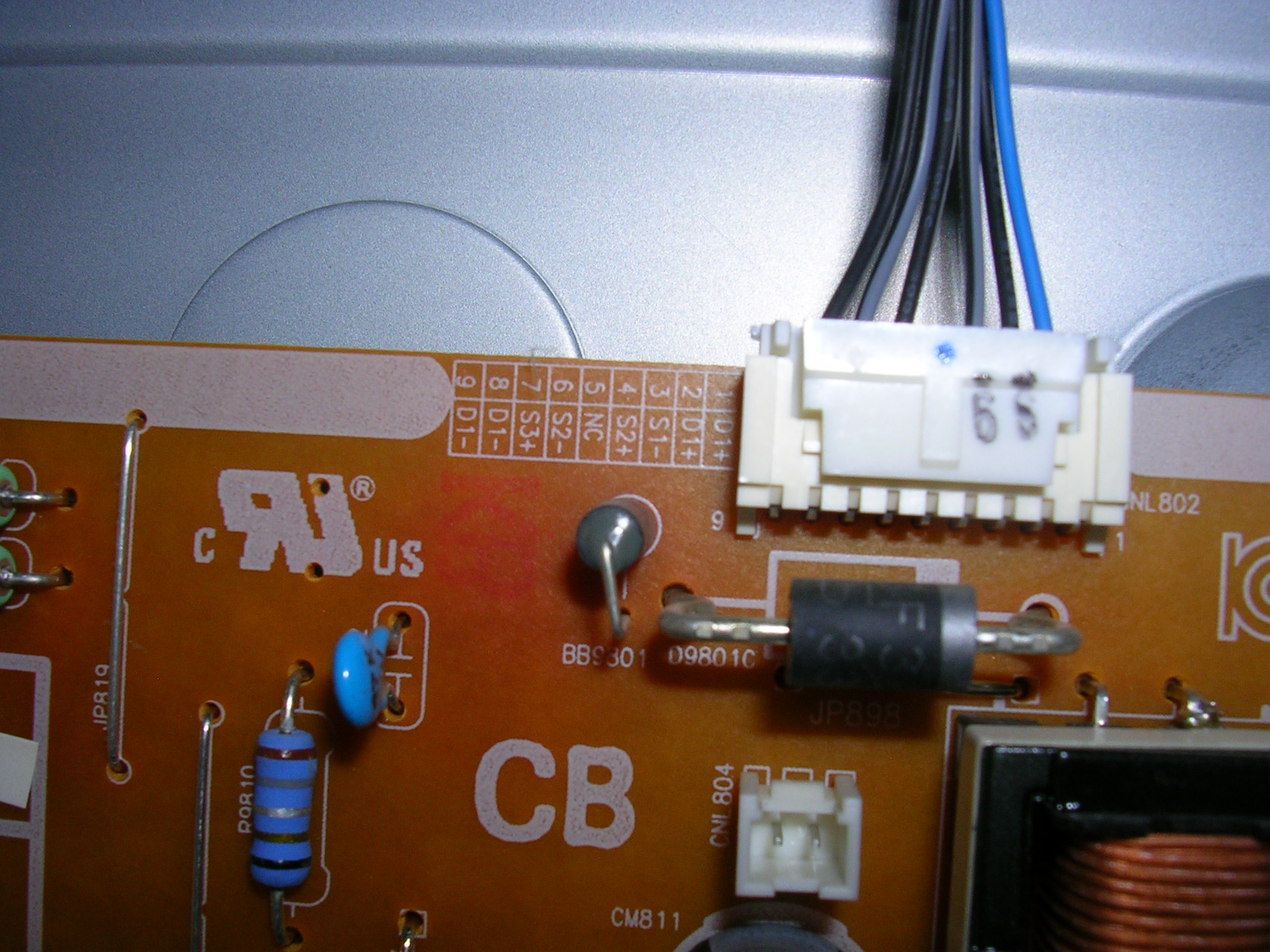

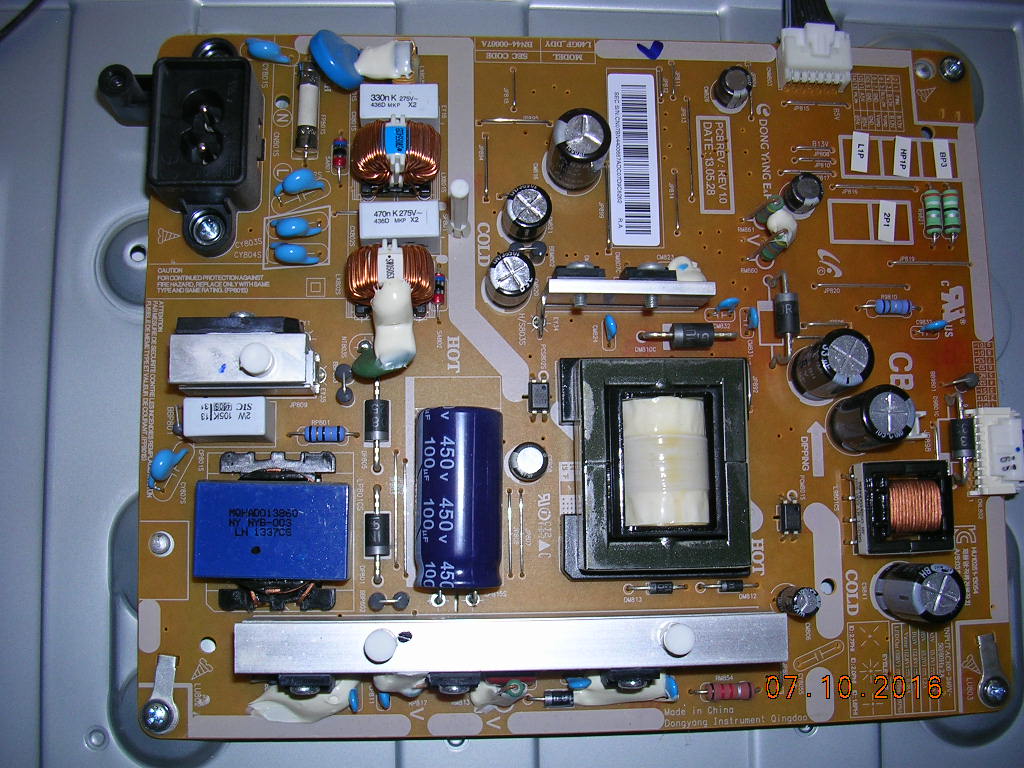

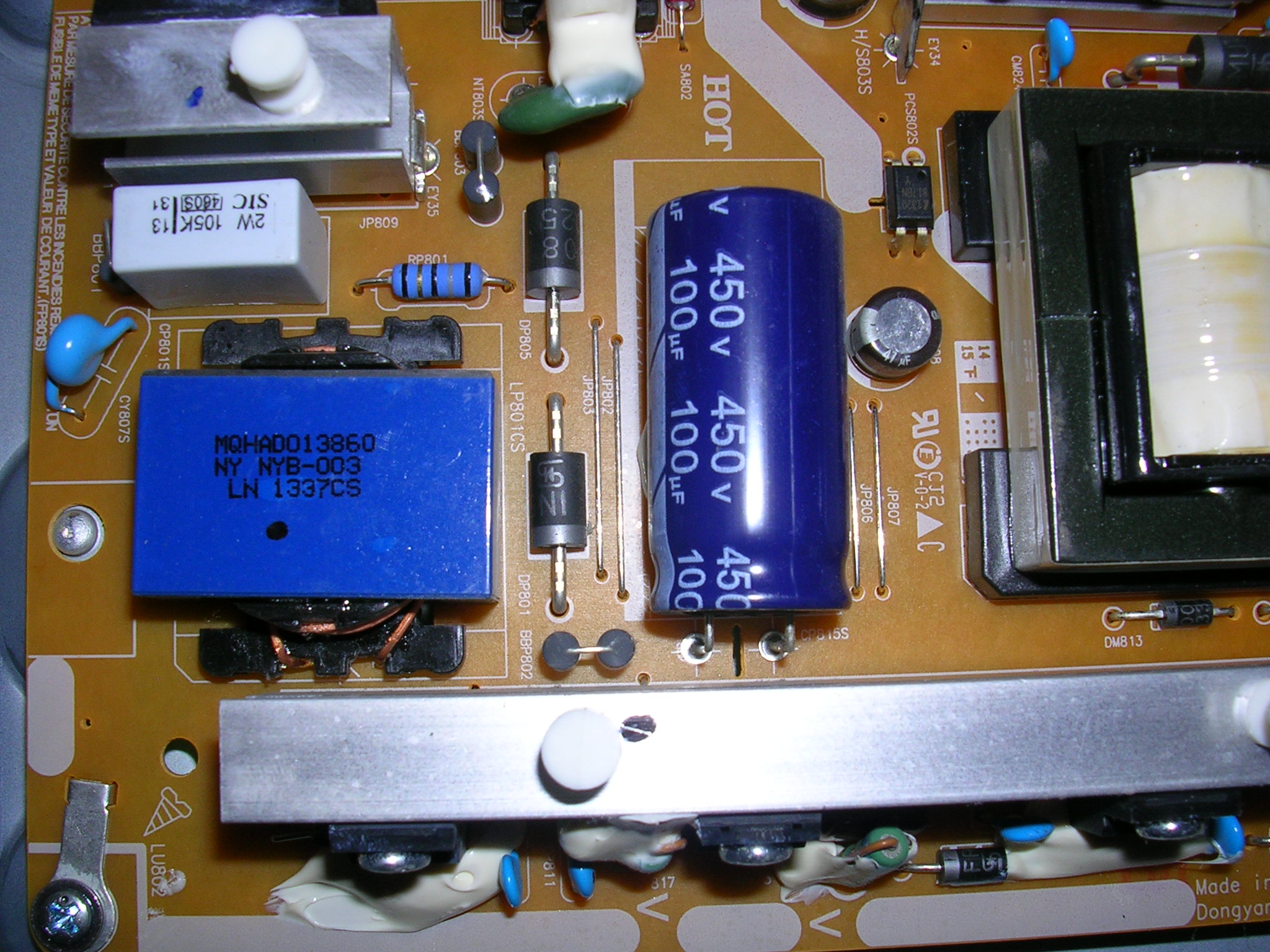

                    Re: Samsung UN46EH5000, No Backlight

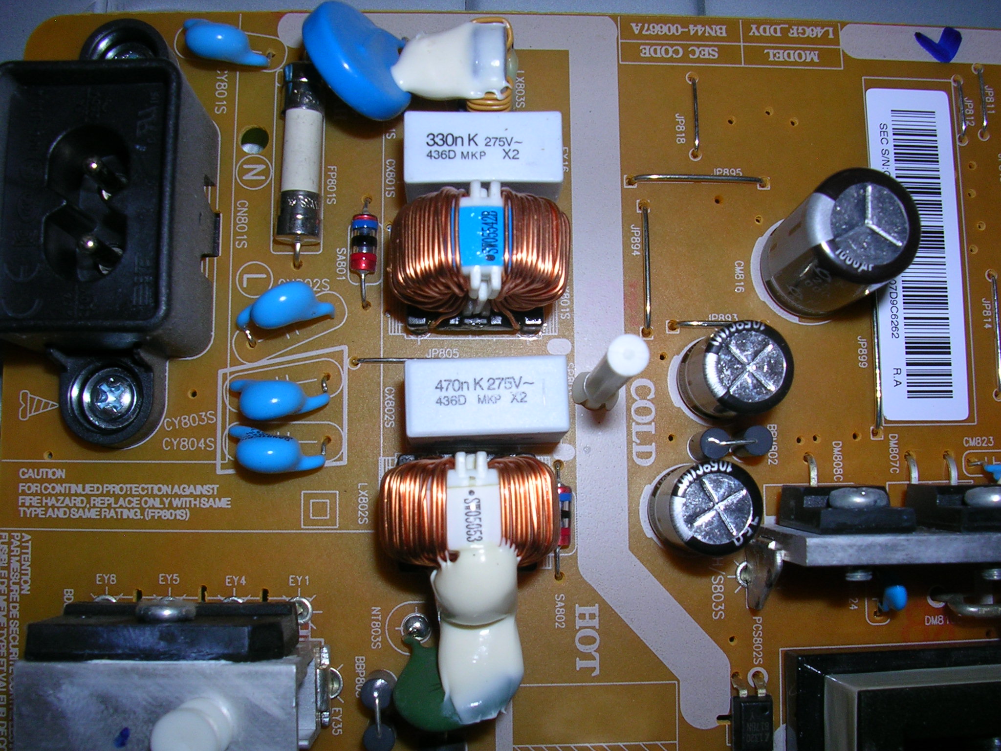

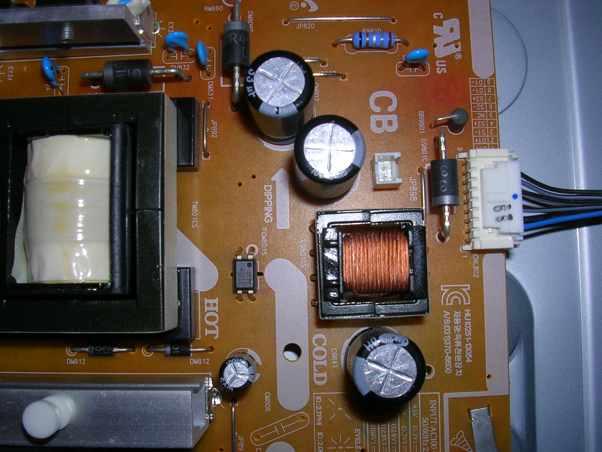

                    I've got the same model TV, with the same problem. I tested the 450V cap, and got 392VDC plugged in, 12VDC unplugged. The D1+ pin on CNL802 tested at 225VDC after 3 seconds of plugging in. Am I looking at the same failure in the LED strips?

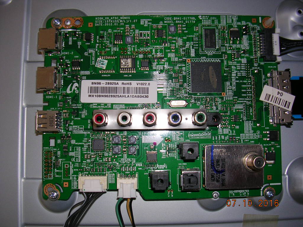

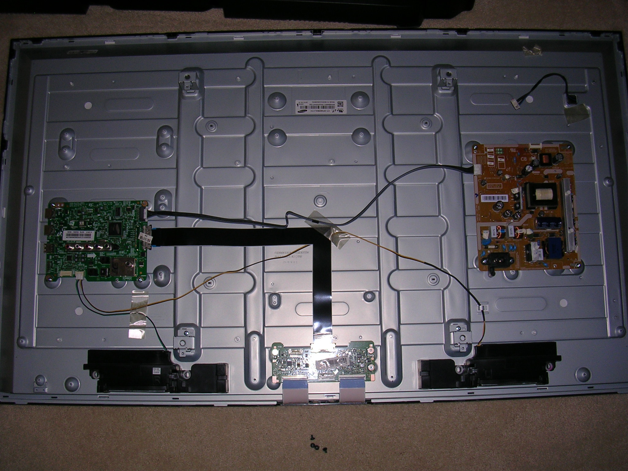

                      Here's some photos. BTW, my model is UN46EH5000F-XZA, version UD03.
                        Can you see a display with a flashlight? If so, then you probably have a bad LED also.
                          #32
                          Yes, you have open circuit in the LED strips.
                                  So, how do I test the LEDs? I tried putting two AAA in series, and testing at the two holes on either side of each LED, but that didn't work. I assume those small holes are there for just that purpose, correct?
                                    Find yourself something metallic that will slide under the lens and contact the side of the LED. Straight pins will sometimes work, but sometimes I have to use pieces of 28 gauge wirewrap wire. Stiffer items are better for a beginner. Two batteries usually will work - most LEDs are only of the 3V variety. Once you have built your LED tester, determine which of the four ways your LEDs are attached, then start testing, one at a time.
                                    Sometimes you can look directly down at the LED through the lens and see discoloration from a burned out LED. If you can find one of these, then slip a thin screwdriver under the lens and pop if off. You can then figure which way to test the rest.
