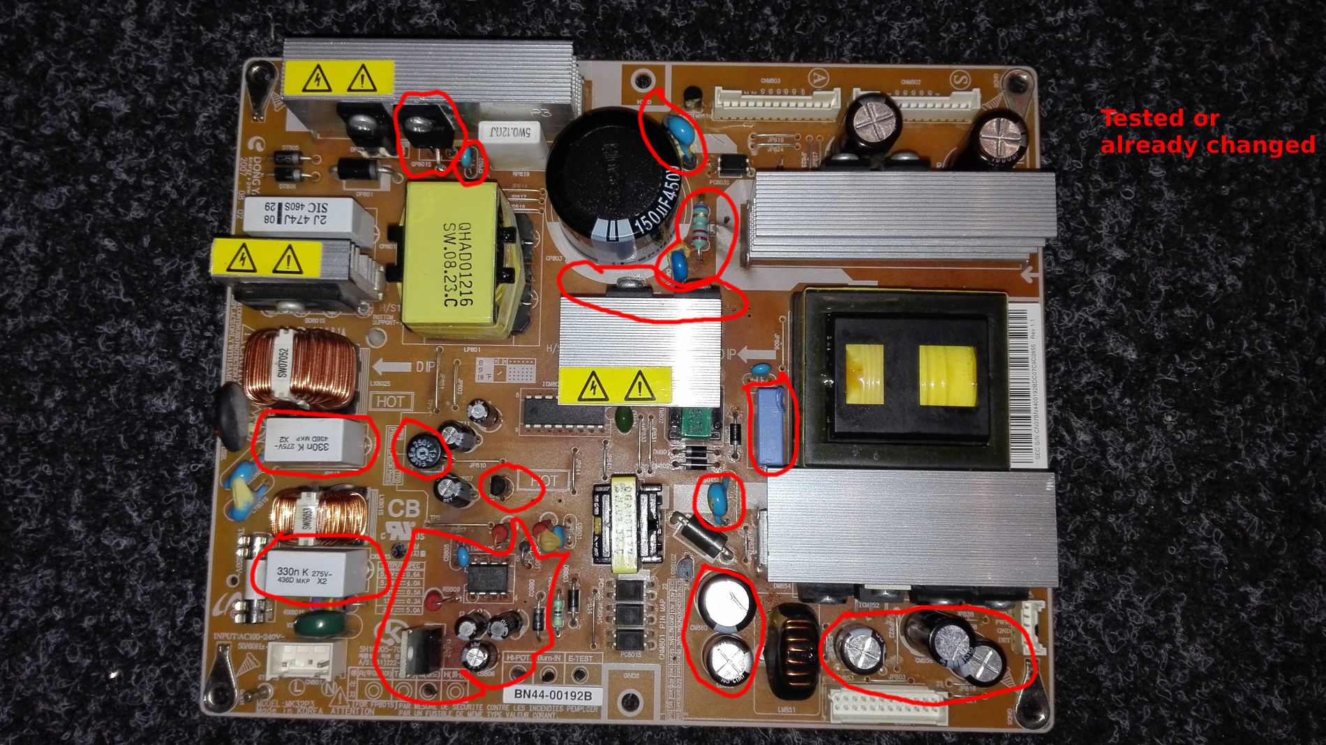

    I have a samsung LE32A336. I am sure that a repaired whole PSU, because I tested all voltages on their nominal current. Everything's fine, until I connect main board, then StandBy supply (5.2V) started oscillation between 5,2V and 0 (it is a reason why red led blinking). I think, it is because on the mother board is shortcut, but I cannot find where. I changed all elites, but does not help. I am thinking about corrupted EEPROM, but it cannot shortcut supply, am I right? BTW, when I connect resistor between StB supply and ON/OFF pin on PSU, TV works fine, but it is not good way . Any suggestion please? Main board is: BN94-02117.

    That problem sounds rather odd, if the TV works OK when manually starting the PSU.
    What do you measure on the 5.2v rail voltage when you do that?
    Can you post photos of your boards etc?

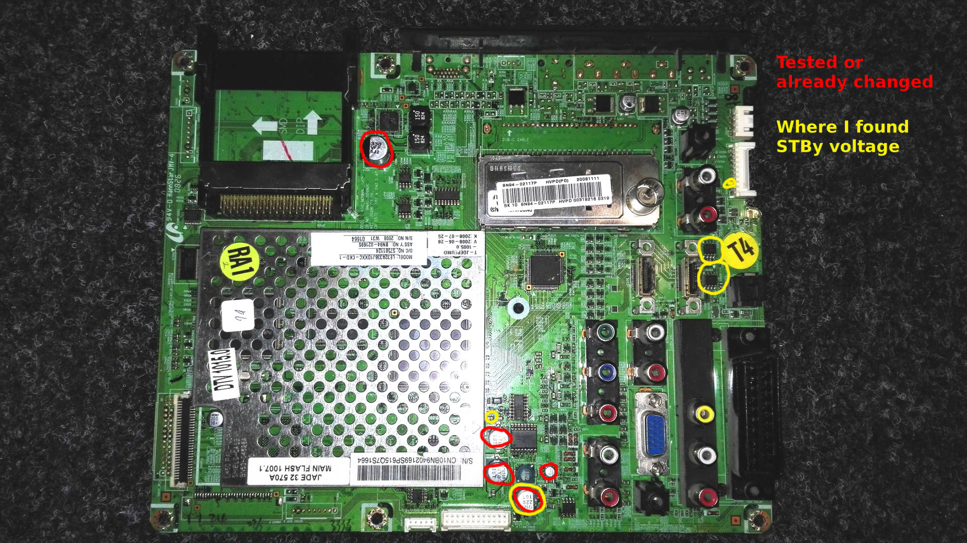

      What resistance do get get when measure between GND and the STBY pin of the main board?
      How much current did you pull on the stby power pin? 0.5A, 1A?

        new information is, that TV is down even if I manually start PSU, so there must be something dead on CPU board and I cannot measure stby voltage while CPU brd is connected. I attached pictures.
        Resistance between GND and STBY on main board is more than 1M (some capacitors charging and resistance is going higher and higher).
        I tested STBy pwr on 0,6A it should be nominal because it is written on board.
          Re: Samsung LE32A336 red light blinking
          The overload of the STBY power supply can be at the output side of the Voltage regulators ICs. I would start checking the resistance between the two legs of the filter/bypass caps to see any one of them shows really low resistance.

            I tested all elit caps and some ceramical but without succes. I also remove them and test externally for capacity, everything looks fine. On the output of one LDO (is still on the board) I measured resistance 300ohm, but I dont know if it is bad or not. Any other idea please? Am lost .

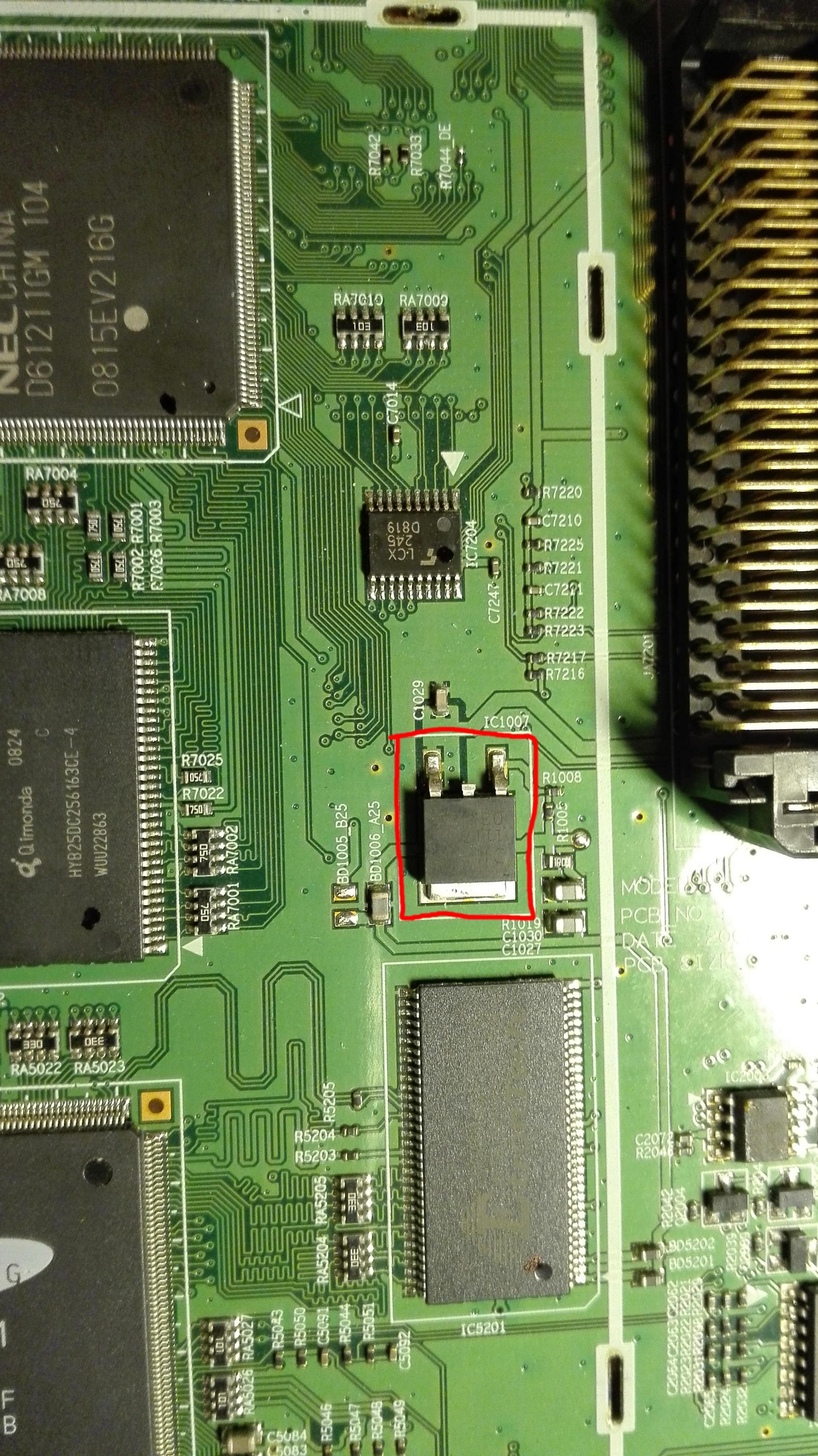

              It's a little hard to say. at 5v or 3.3v or so, 300 ohms does not present much of a load - only a few milliamps. And if the rail is powering a large ASIC\CPU etc then a low resistance is not an unusual thing - but, it could be indicative of a leaky component on that rail too, which only breaks down when the full operating voltage is applied.
              Can you identify all the LDOs or other regulators which run directly off the 5v2 STBY rail? - and can you show close-up photos of the board area for each one?

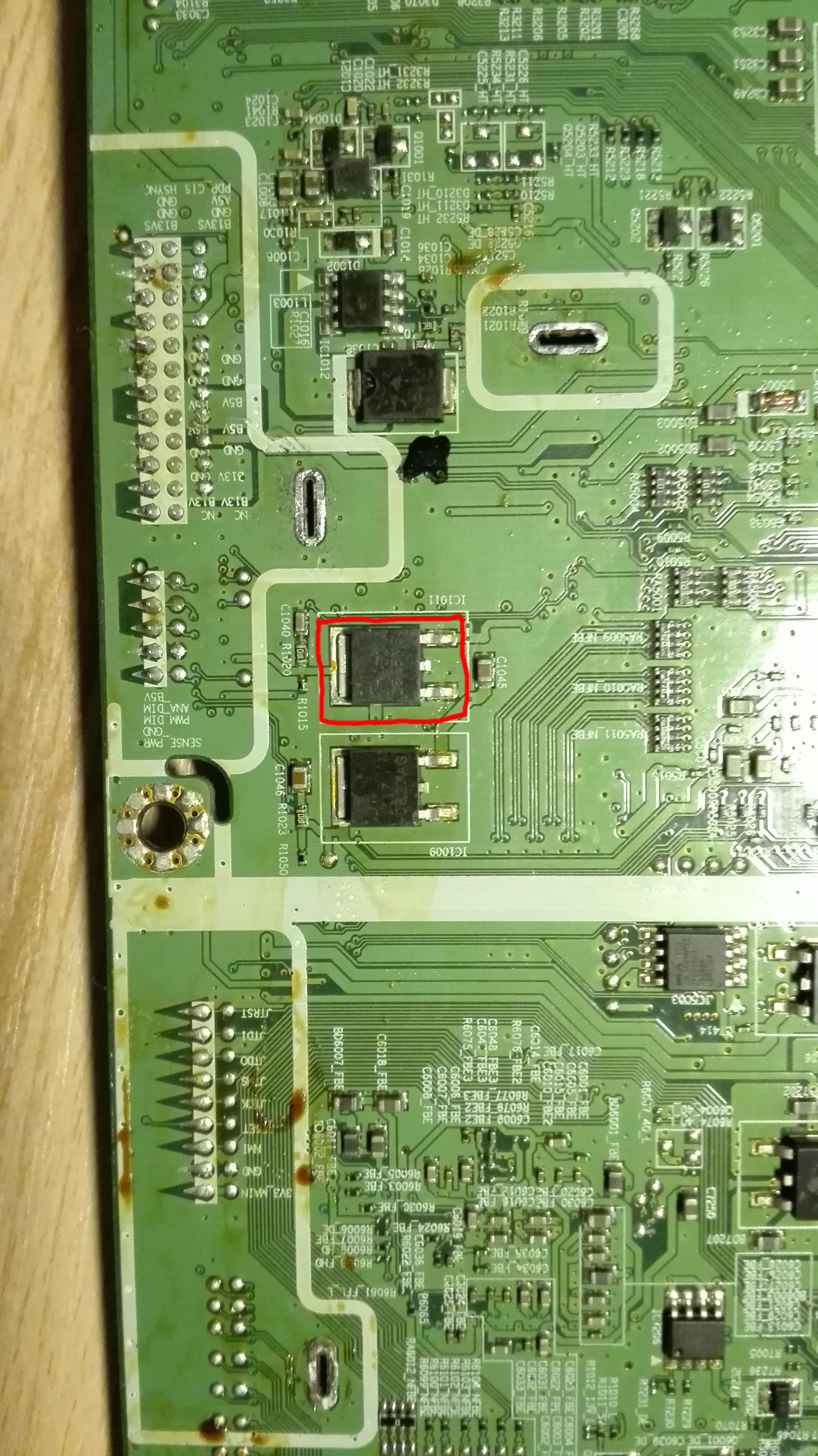

                I found two LDOs directly on 5V2 rail, one is under the shiled, it is a reason, why I am late, it is not easy to pull shield off. Look at pictures please.
                  You are seeing the resistance of the resistor network for setting the LDO output Voltage.
