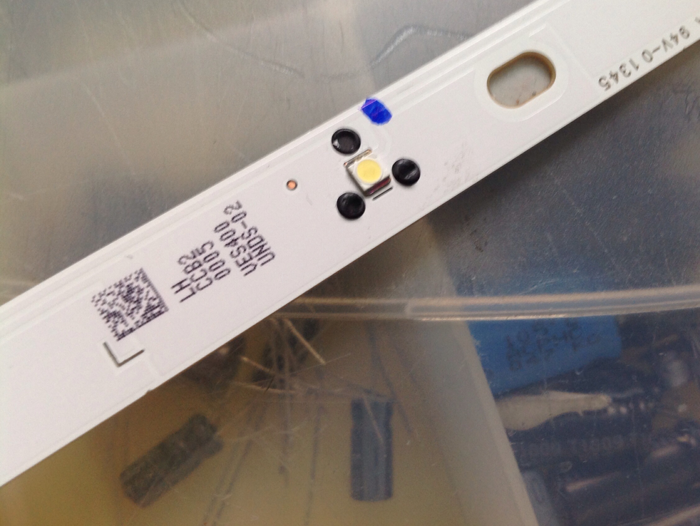

        Does this look bodged to you as well ? Also I know the optic and reflector isnt in place but heres an example of an Led that I recently replaced on a Toshiba Led tv.

          Is it a new LED? No, has it come off another board? Yes, has the LED been heated three times ? Yes, is all this heat good for the LED ? No, A new strip is a new strip not a s/hand one, you can say what you like about how good you are with a hot air gun , you can not tell me its as good a job as a new replacement strip and one that apart from your own use in your own set, not a customers set you have been given for repair and are being paid for. End of Flocko
            Not end of mate ! How are you sure the strips you buy are new ? Thanks for the compliment on the soldering as well. I just think that you are getting abrasive because you made a fool of your self saying its a bodge job when actually its just as reliable as your method. I can see you are set in your ways. Any thing else to say ?
