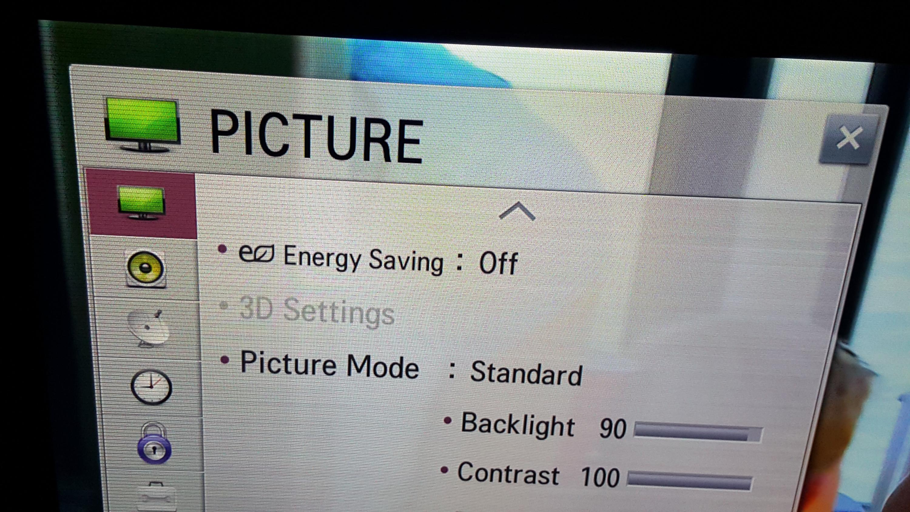

    Im having horizontal lines top to bottom on the left side about 1/4 of the screen. They are not black lines though any chance its not the display and one of the boards. Ill get pictures up tonight after work if needed. Thanks in advance

    If you look hard you can see the lines on the grey menu and above whats causing this?

      Dunno... try the usual: squeezing and twisting of the frame (tab bond), or touch each tab bond individually, reseat the cables on the tcon. Not much you can do after that. Besides writing it off as a bad panel.
