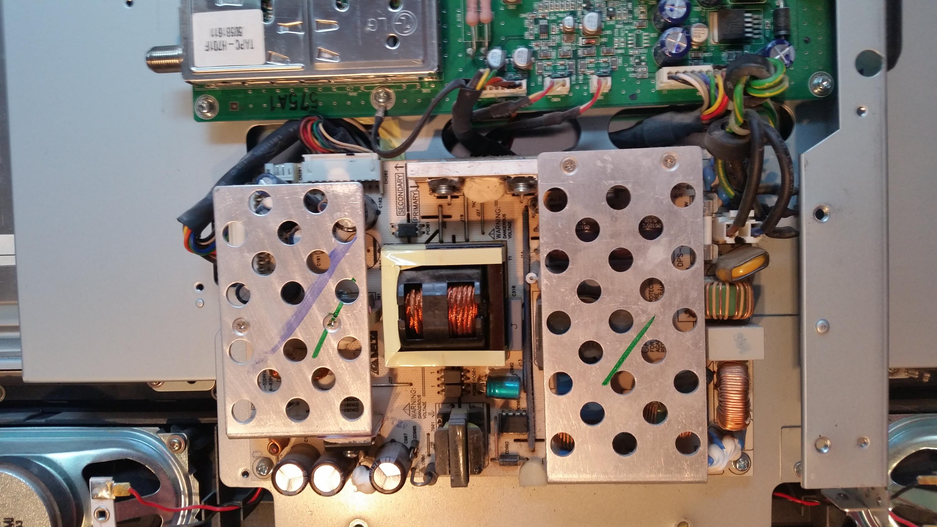

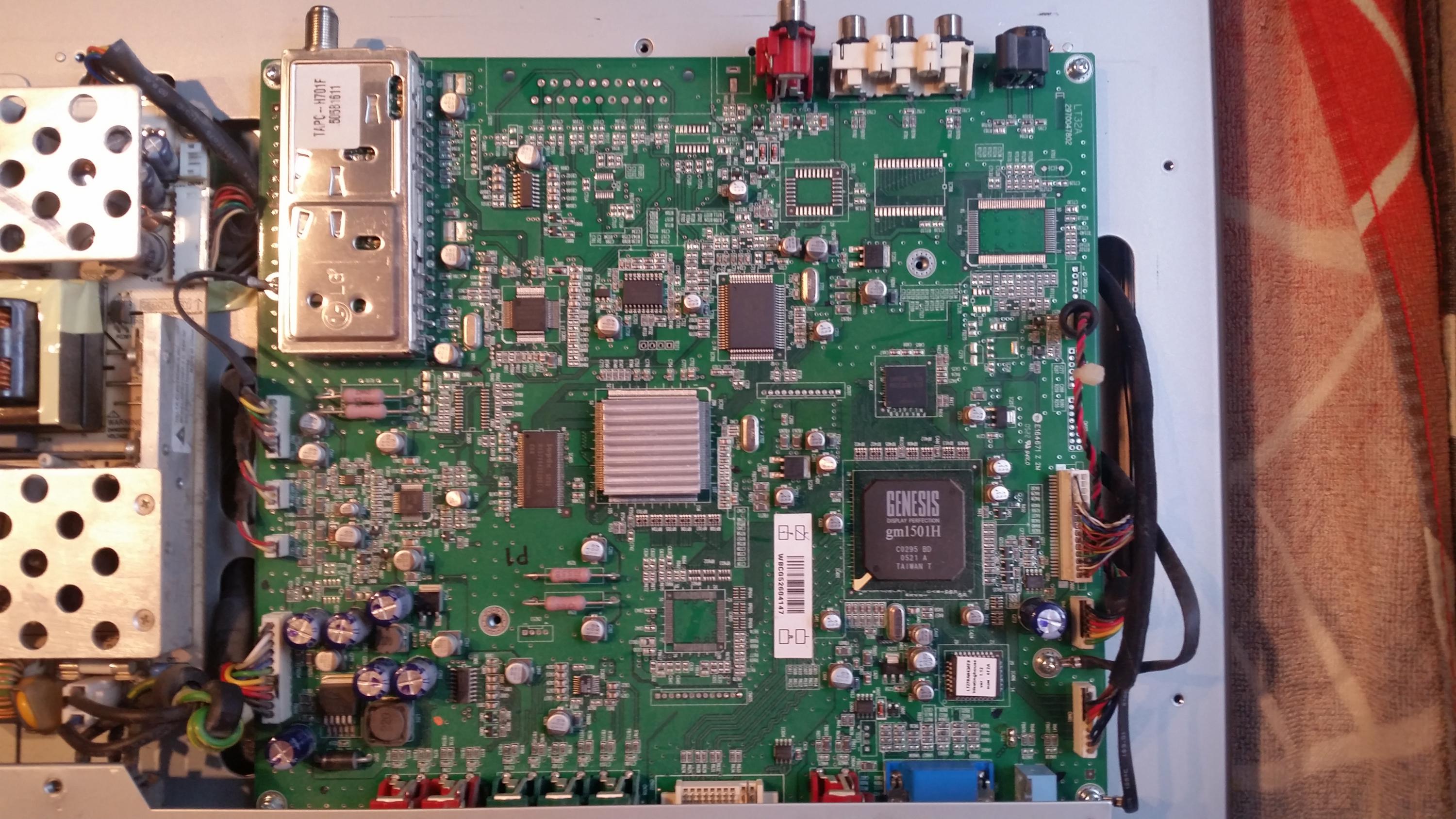

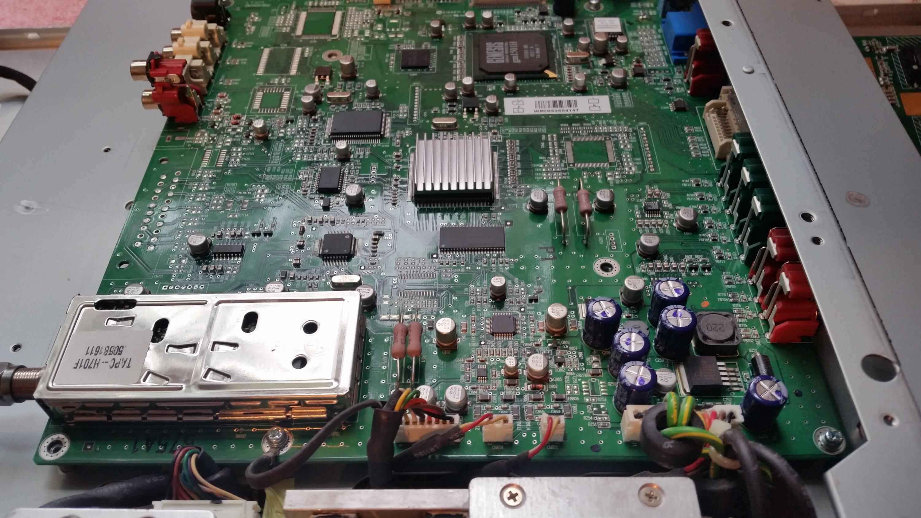

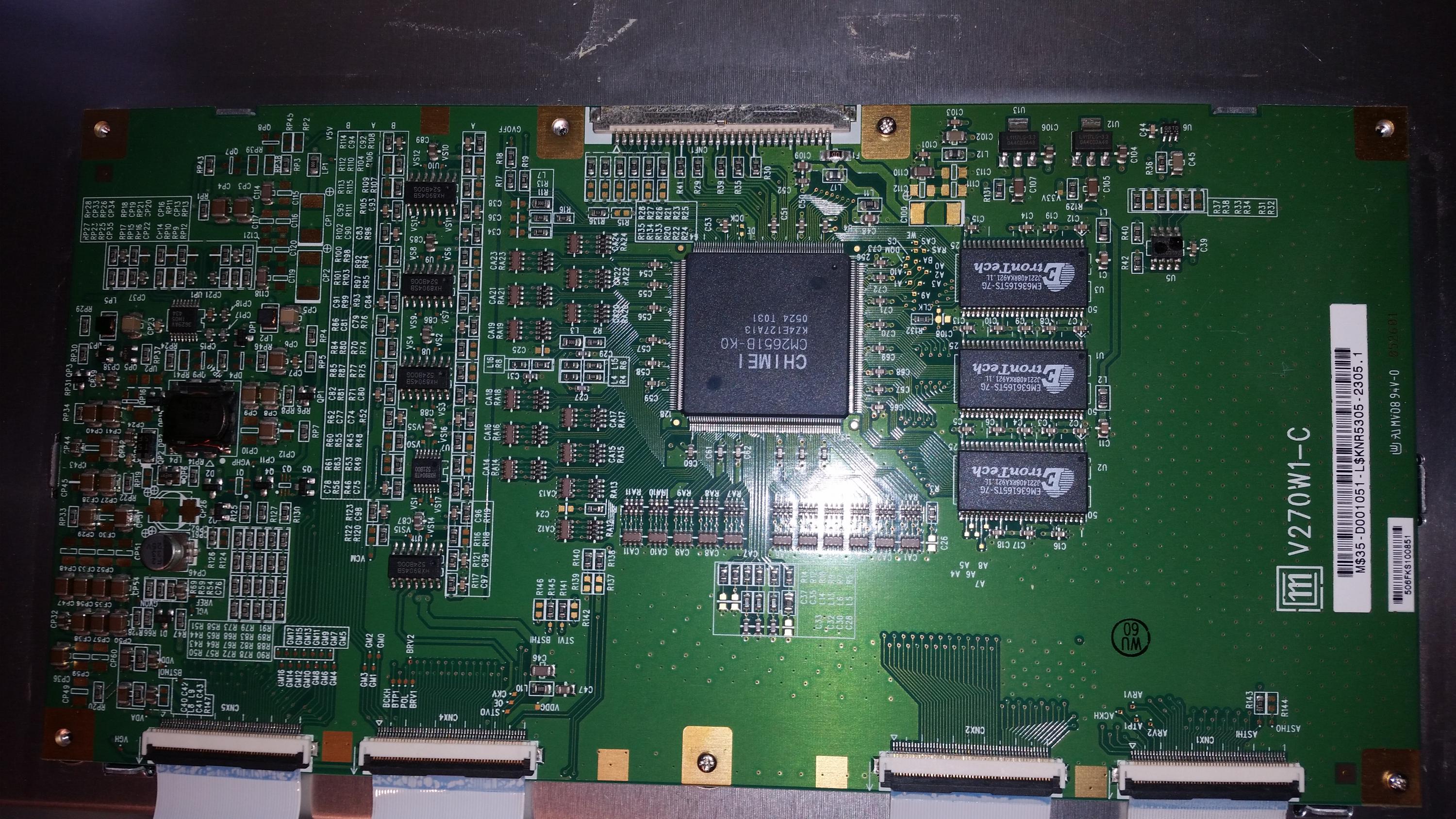

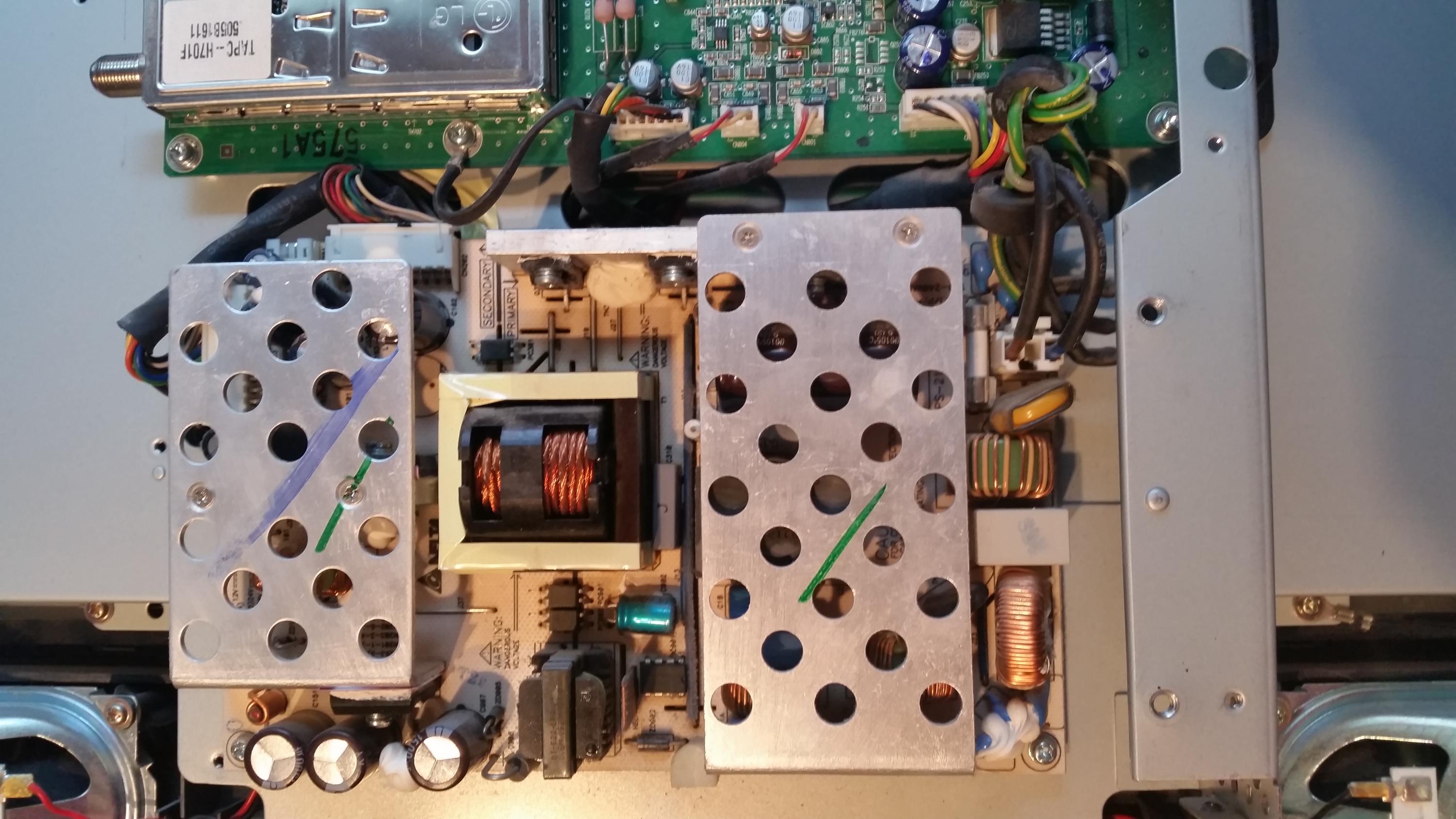

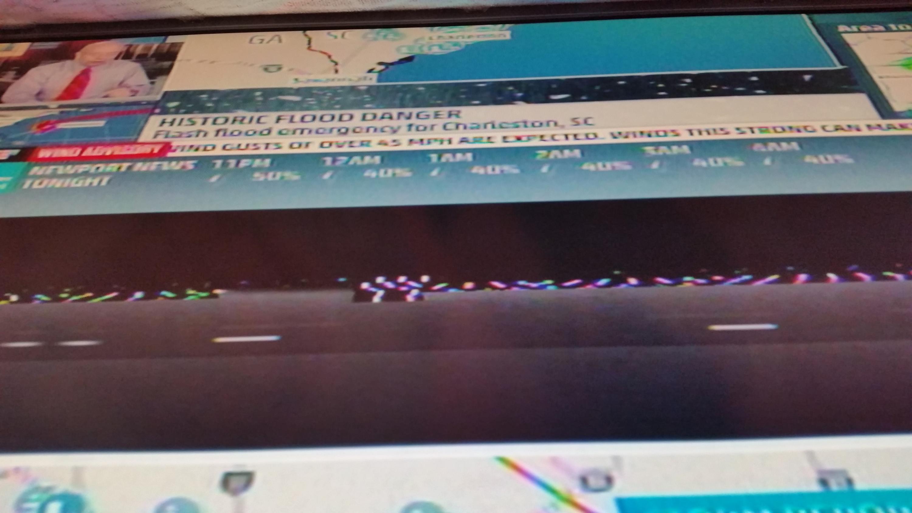

    WestingHouse LTV-27W2 Rolling Image

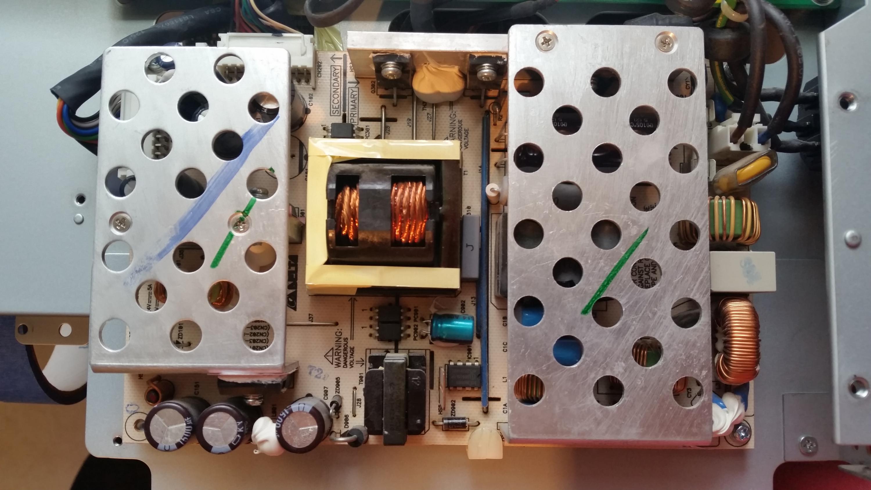

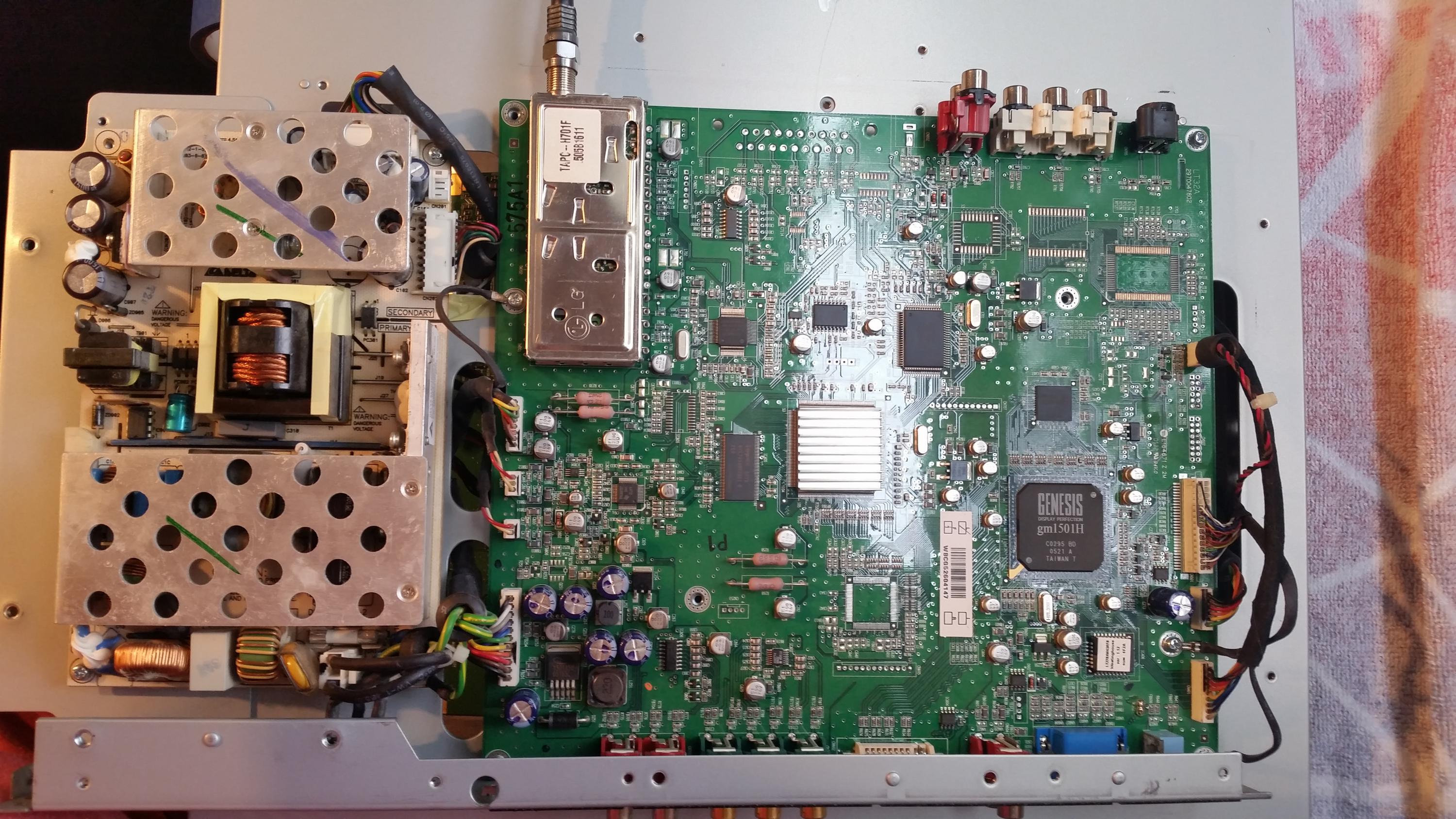

    I have this Westing house LTV-27W2 LCD tv that started rolling the image vertically. I have checked all connections to T-Con just to ensure it was not a lose connection and used a heat to try to find anything simple. All the capacitors are Original, but wanted some input where to start on this. Saved it almost 2 years ago to date when it had no back lights, fixed with a transformer on the inverter board. I have attached pictures .

    Okay Here is the Fix
    Found a T-con for 11.00 and tried it with same result. So what I did next was what I should have done first was to plug up into a different auxiliary inputs to see the if picture still rolled . So I did on the PC input and no picture roll , clear as can be. Same on the other Auxiliary ports . Replaced the caps and same thing , so I didn't know how to test TV tuner and found a board from Shop Jimmy for 26.00 and instead. fixed the problem. I am pretty fugal wish I could fix the tuner that I think is bad on the old board.
