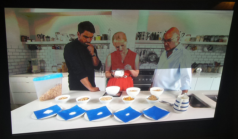

    I was recently given a Panasonic TH-50PX70B with a slight fault.
    After a while the top half of the screen starts flickering and sometimes goes black.
    After some googling I've seen that it might be the 'upper y buffer board' or the SU board however I havent been able to confirm that the part numbers I've found might be these boards
    What I've found are:
    TNPA4188 + TNPA4189 buffer boards
    TNPA4169 1 C1 TXNC11HMTB
    TNPA4170 1 C2 TCNC21HMTB
    TNPA4189 1 SD TXNSD1HMTB
    Can anyone tell me which of these might fix the problem please? (Picture of issue attached)

    TNPA4188 is the SU board (upper buffer)

      It's an intermittent problem. Could it just be a cable seating issue?
      Is there anything I should be aware of if replacing the board? (other than allowing the tv to discharge overnight)

        you could try reseating any cables from the sc to the su but it looks most like a faulty SU.

          OK, that's my first task for tomorrow. Failing that I'll order the SU board.
          Will let you know how I get on.

            Reseated the ribbon cables but the fault persists so I'll order the board.
            Will update the thread when it's replaced.
