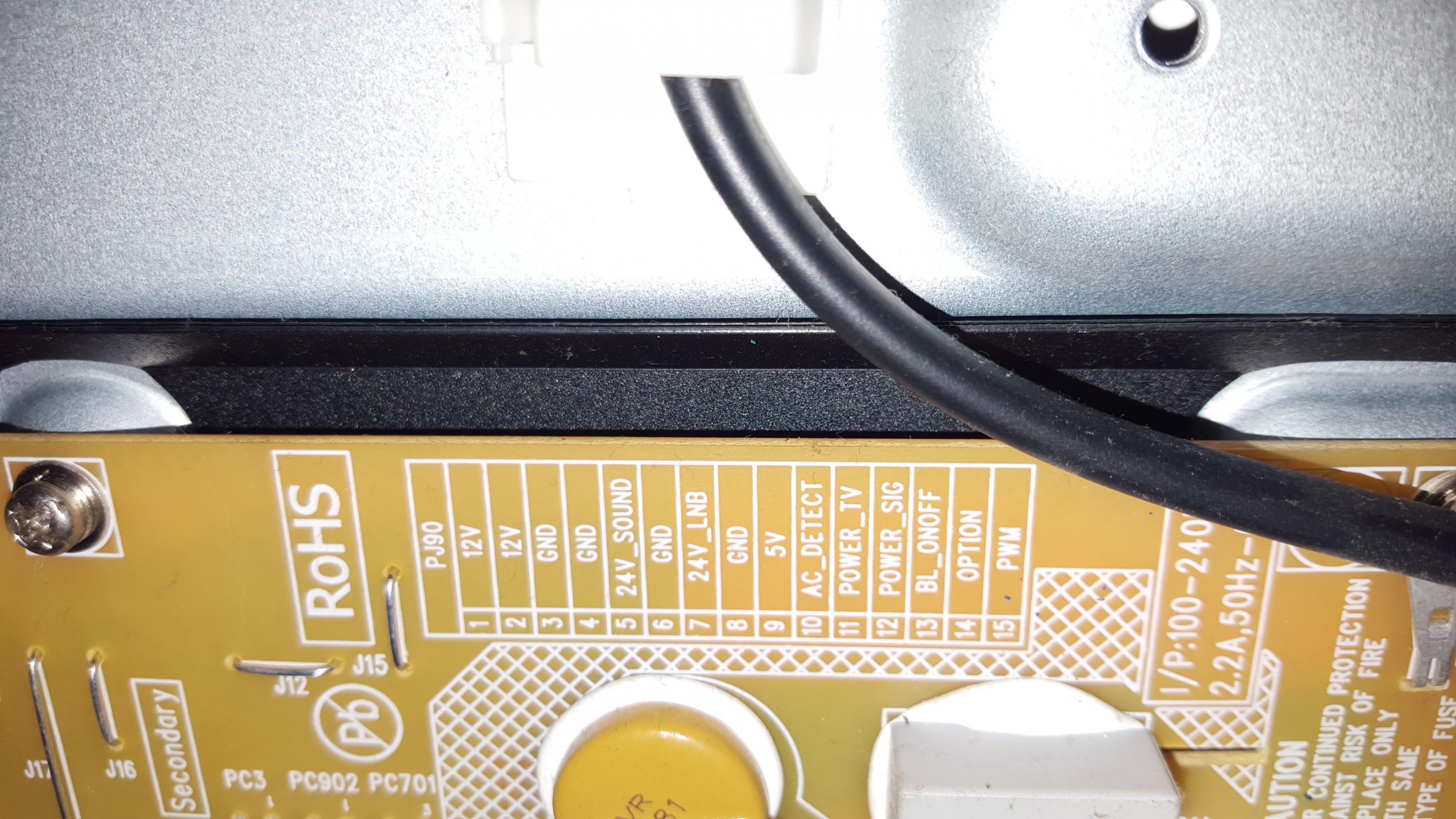

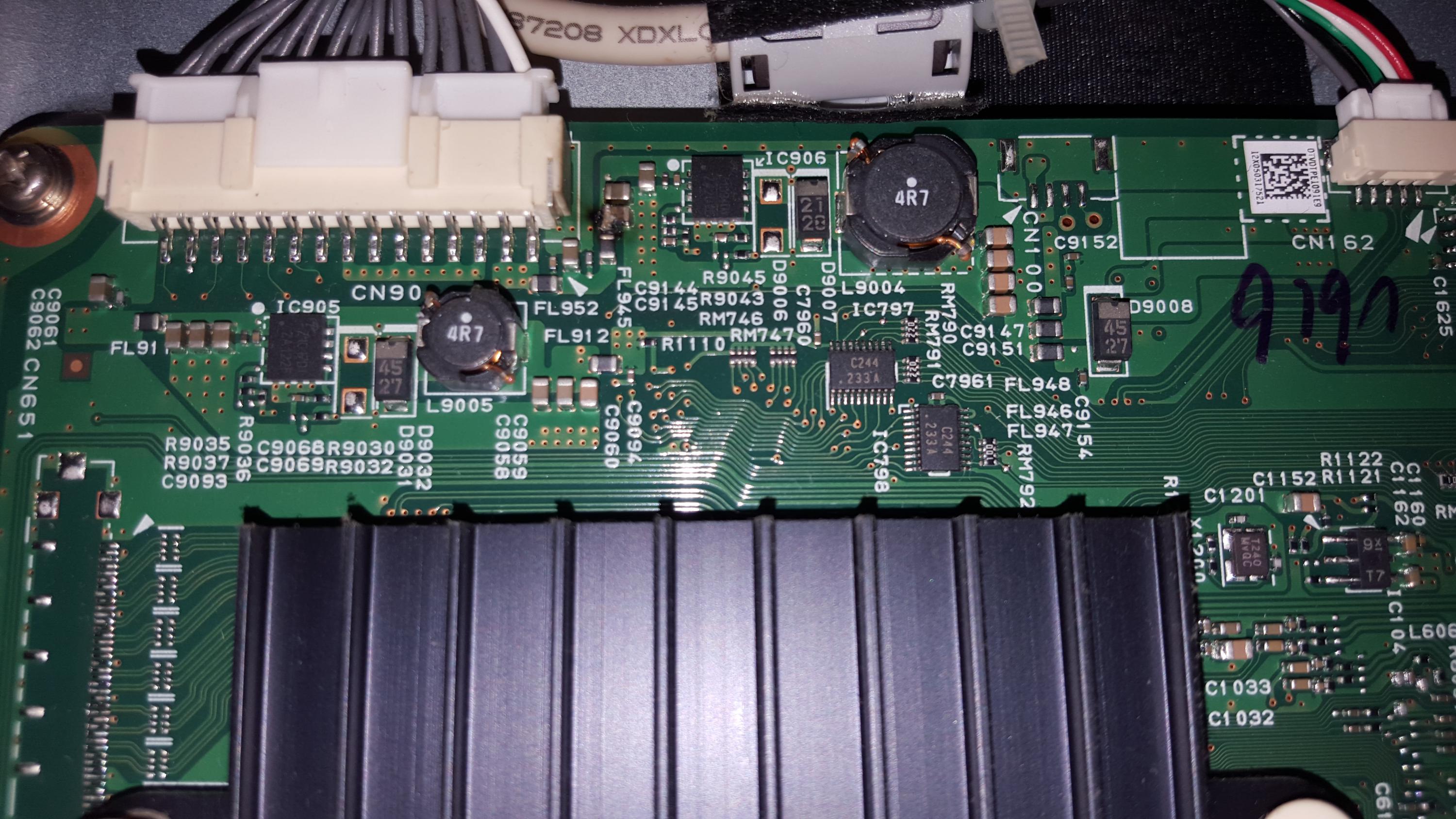

    picked up this tv tonight all voltages are good except for i cant get no reading on the legend on the Psu x2 12 volts and i have also noticed on the main board that a capacitor is burnt out would anyone know what rating this should be ?

    Those three caps are connected in parallel, you can remove the bad out and verify that the Ferrite beads FL952, FL945 did not go open circuit when that filter cap shorted out. It should still work with just one filter cap for now. You should take DCV reading on the good so we can tell what the Voltage rating for the replacement cap will be.

      Probably the same as the one right next to it. You could remove both and measure the good one.

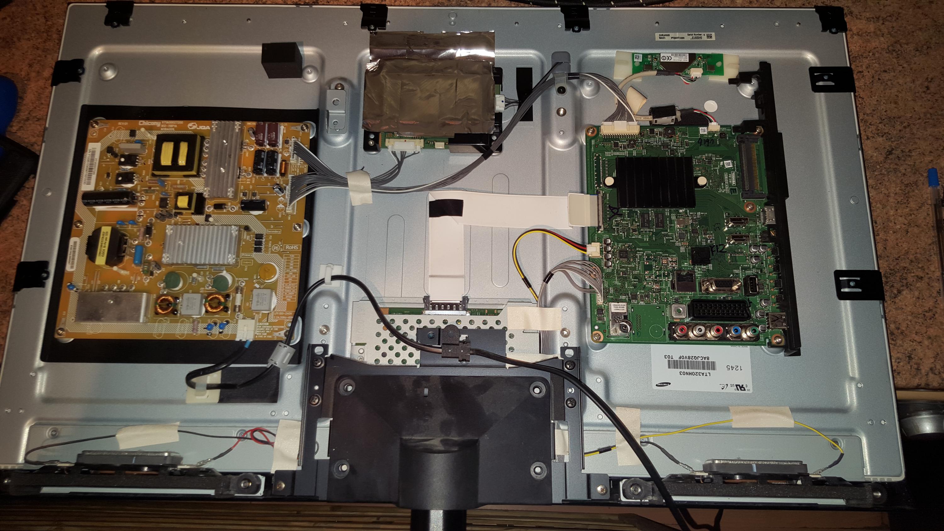

        Right been looking for a board for ages still nothing so im proberly going to strip this tv
        but can someone point me to how i can force the psu to check its working fine
