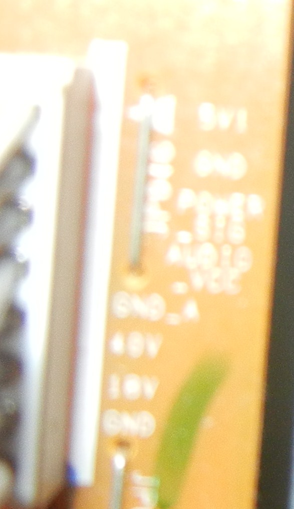

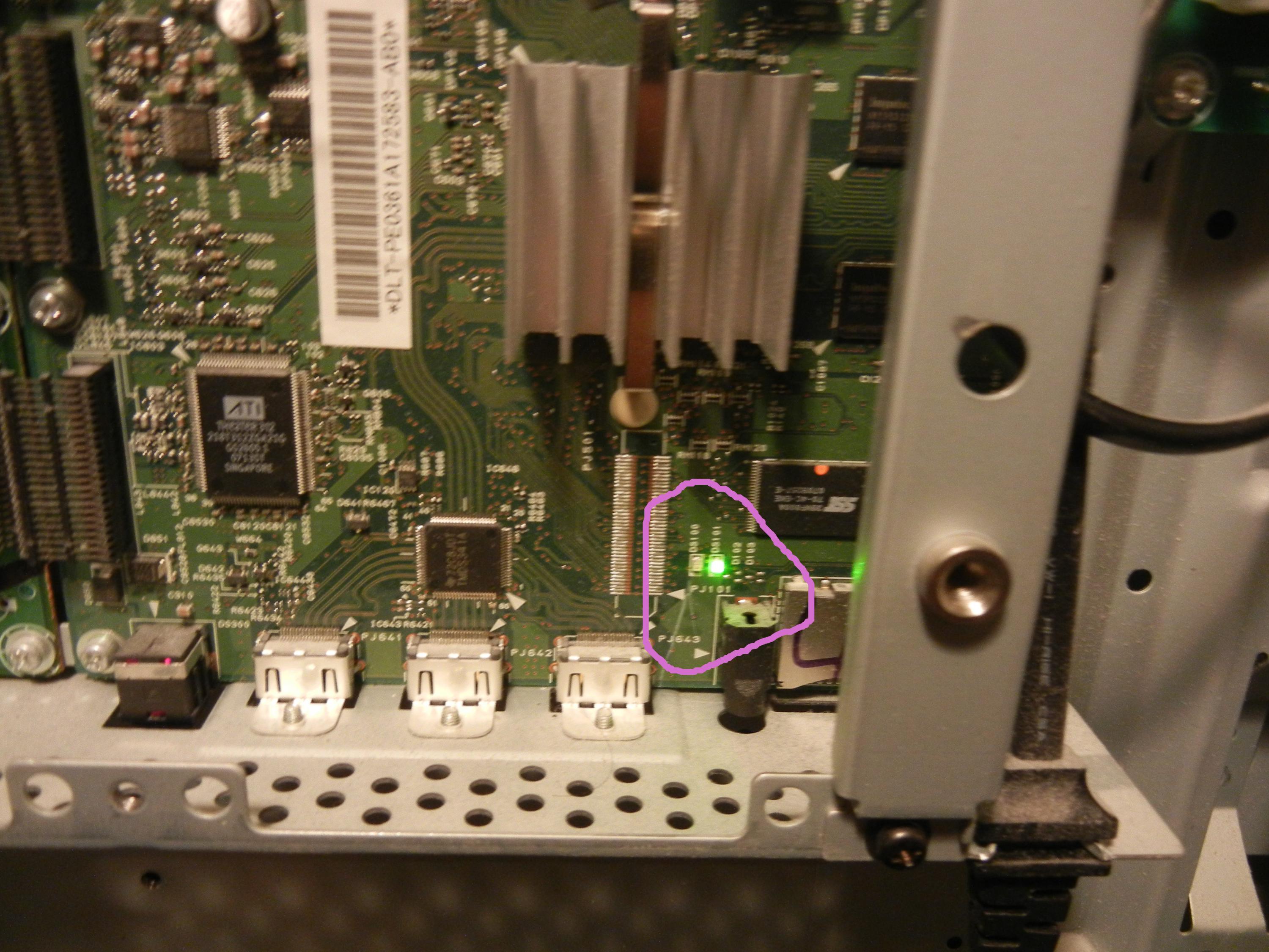

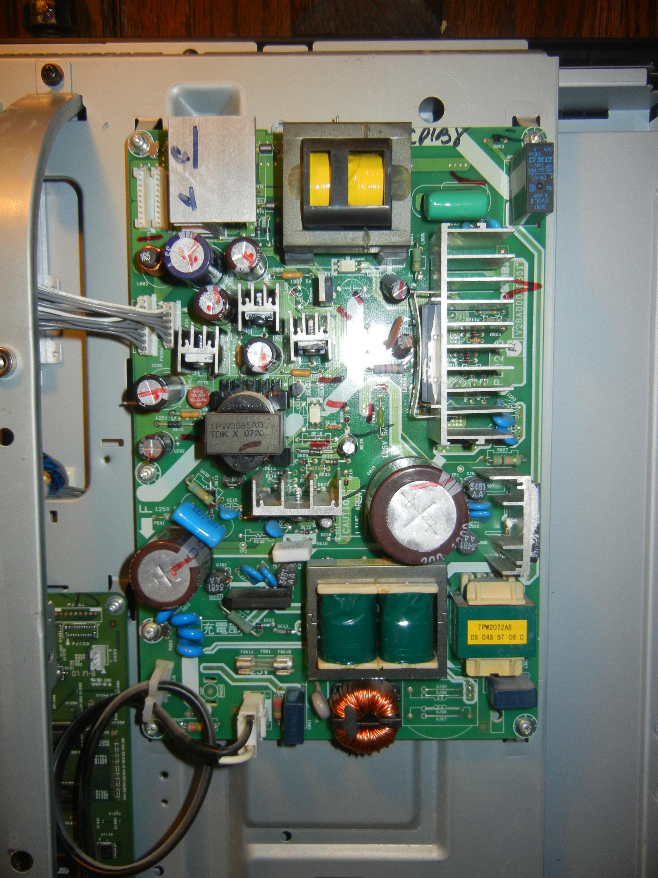

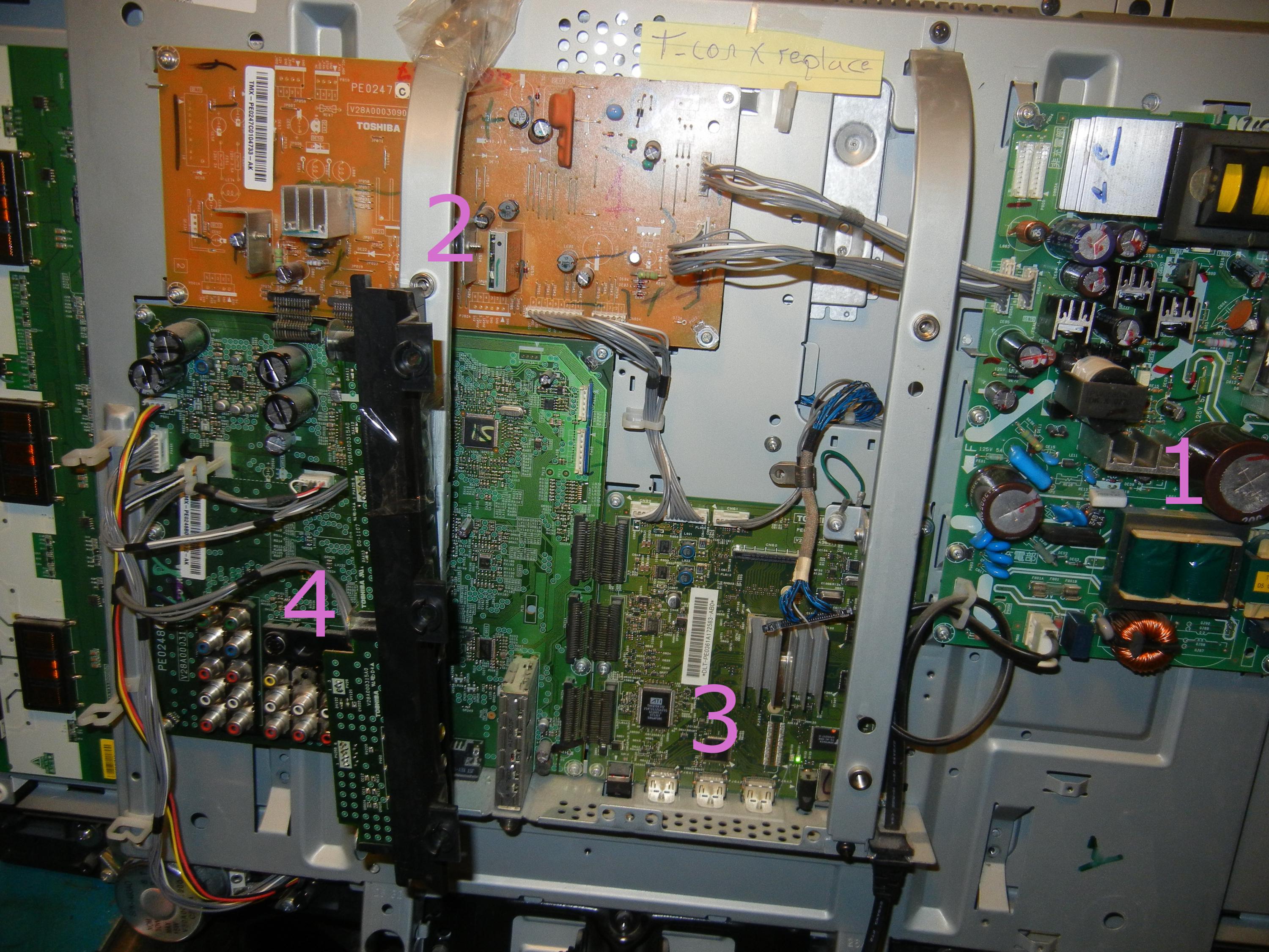

    I have this TV and I cant find out what the problem may be. The power botton works, the stand by light and voltage are ok, I checked the lamps and transformers on the inverter board and they are also ok. On the first photo I show 4 boards, 1 is the power board, all caps seem ok, voltages coming out of it are all ok except for one, I have OL on the pin that should read 40v, the rest are all ok, I tried to take a photo but that close it did not work. I also disconnect the t-con board and it did not do anything, still a black screen. On photo 4 it shows there is a steady light on the bottom of board 3. The voltages coming out of board 2 to board 3 are also ok, if that voltage from 1 to 2 is wrong how can I have normal voltages coming out of 2 to 3? Is that possible?
    Thanks for your help guys.
