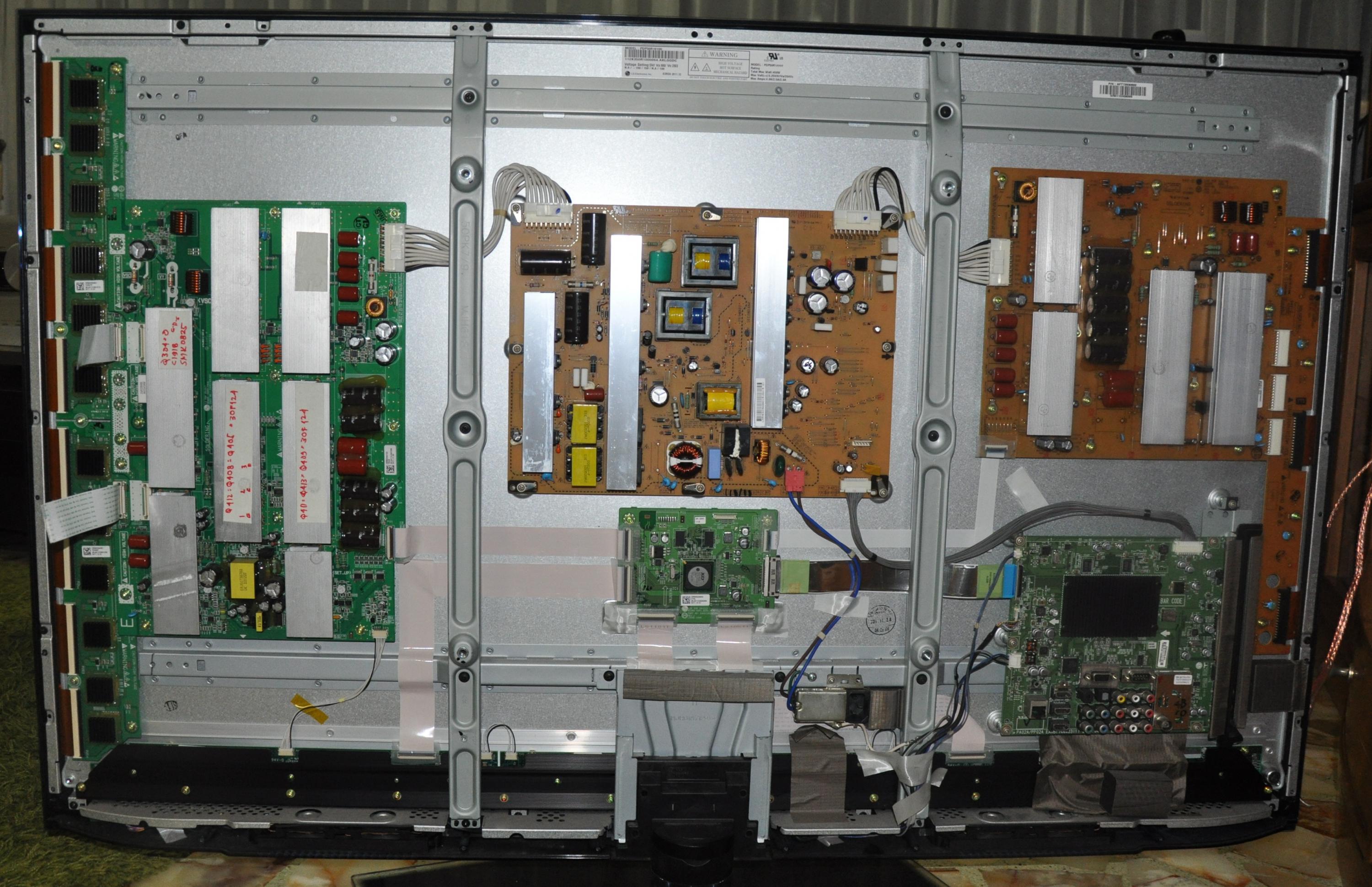

    Hi All,
    Please advise me on how to proceed on this repair.
    LG 50PK950-TA plasma TV with Audio - But no Video/picture/display, with Power. Can increase/decrease the volume. No brightness seen even in a dark room.

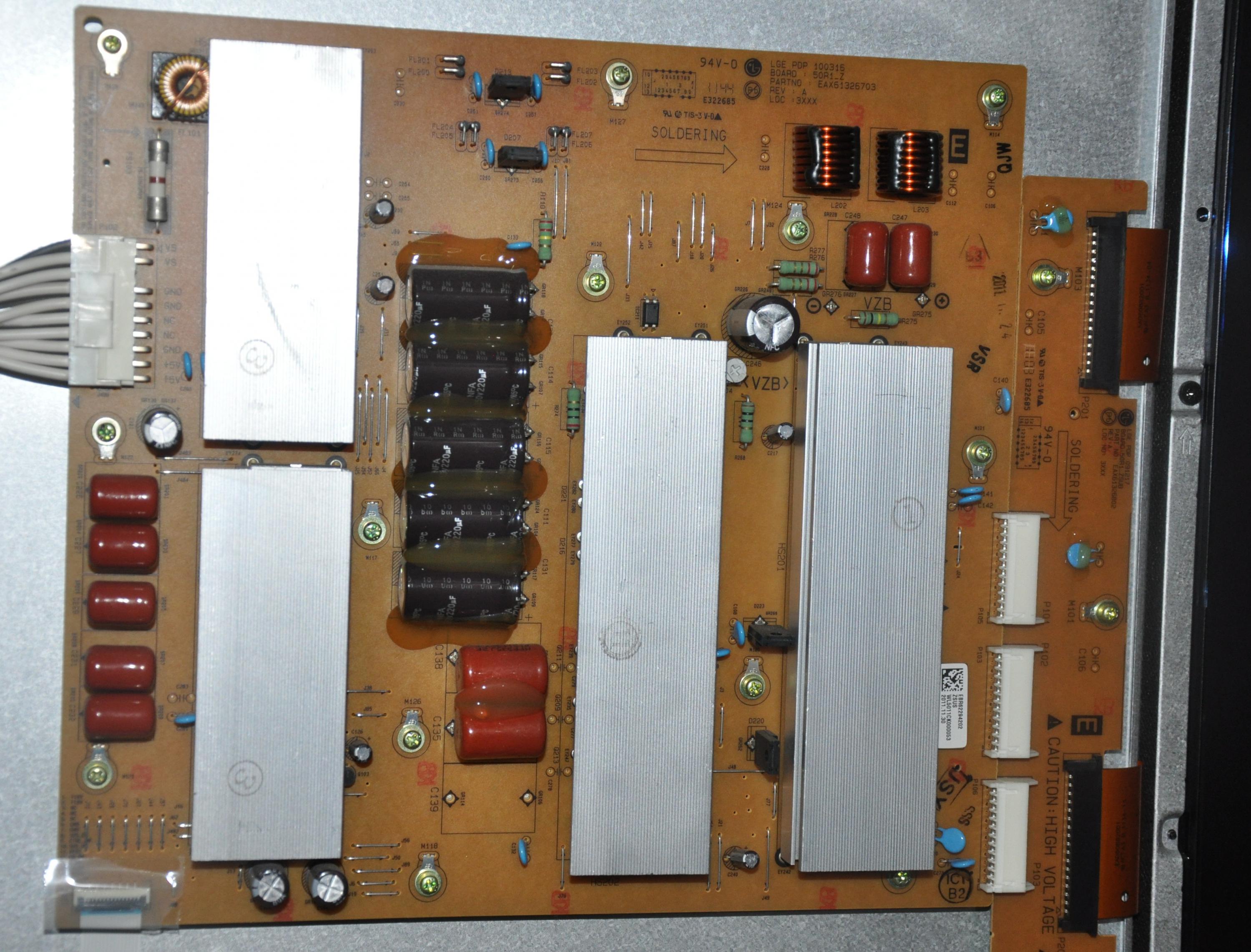

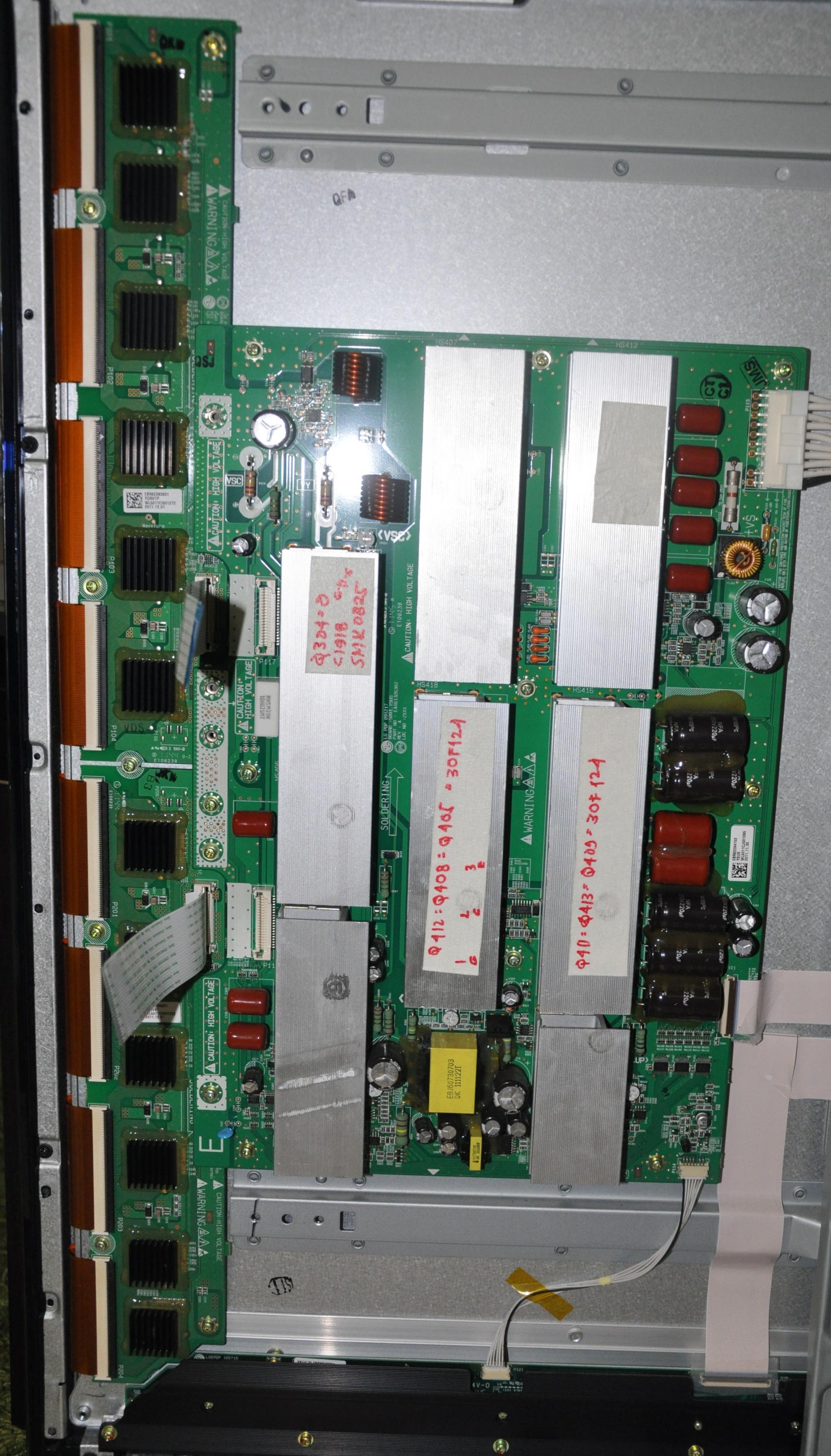

    I concentrated in the Y-Sustain board as the VSC and –VY readings are abnormal (and this is the common cause for ni video symptoms as per readinds) though I haven't found any faulty big resistors, no blown FUSE, no swollen capacitors, no bad transistors/FETs. Tried to resolder the possible cold soldered connections but still the same. I need more ime to check those surface mounted parts.
    Is this a confirmed Y-Sustain board problem? Any hint on repairing this Y-sustain board?

      I message the guy who has the spare boards if i can buy his Y-sus board, and yes - he even asked me to take his card and test first before buying. After the Y-sus board replacement - my TV is now working. Thanks to bro SandTang !!!

        TV still running fine. I am eager to repair my faulty Y-sus board as my spare, Anybody have some pointers on what is wrong on this Y-sus board? anything that i need to check further? No faulty big resistors, no blown FUSE, no swollen capacitors, no bad transistors/FETs ( i even removed the FETS from the board to test properly. Tried to resolder the possible cold soldered connections but still the same.
        Any input will be highly appreciated... Thanks in advance...
