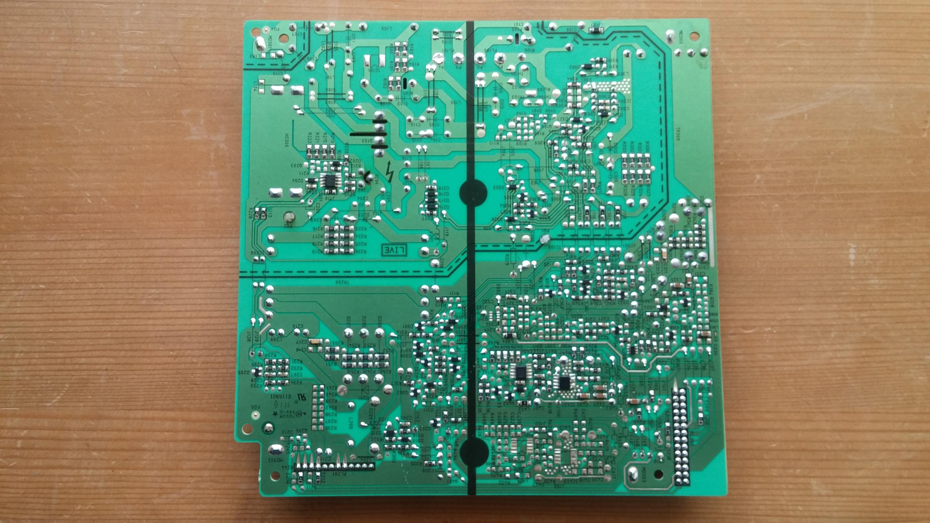

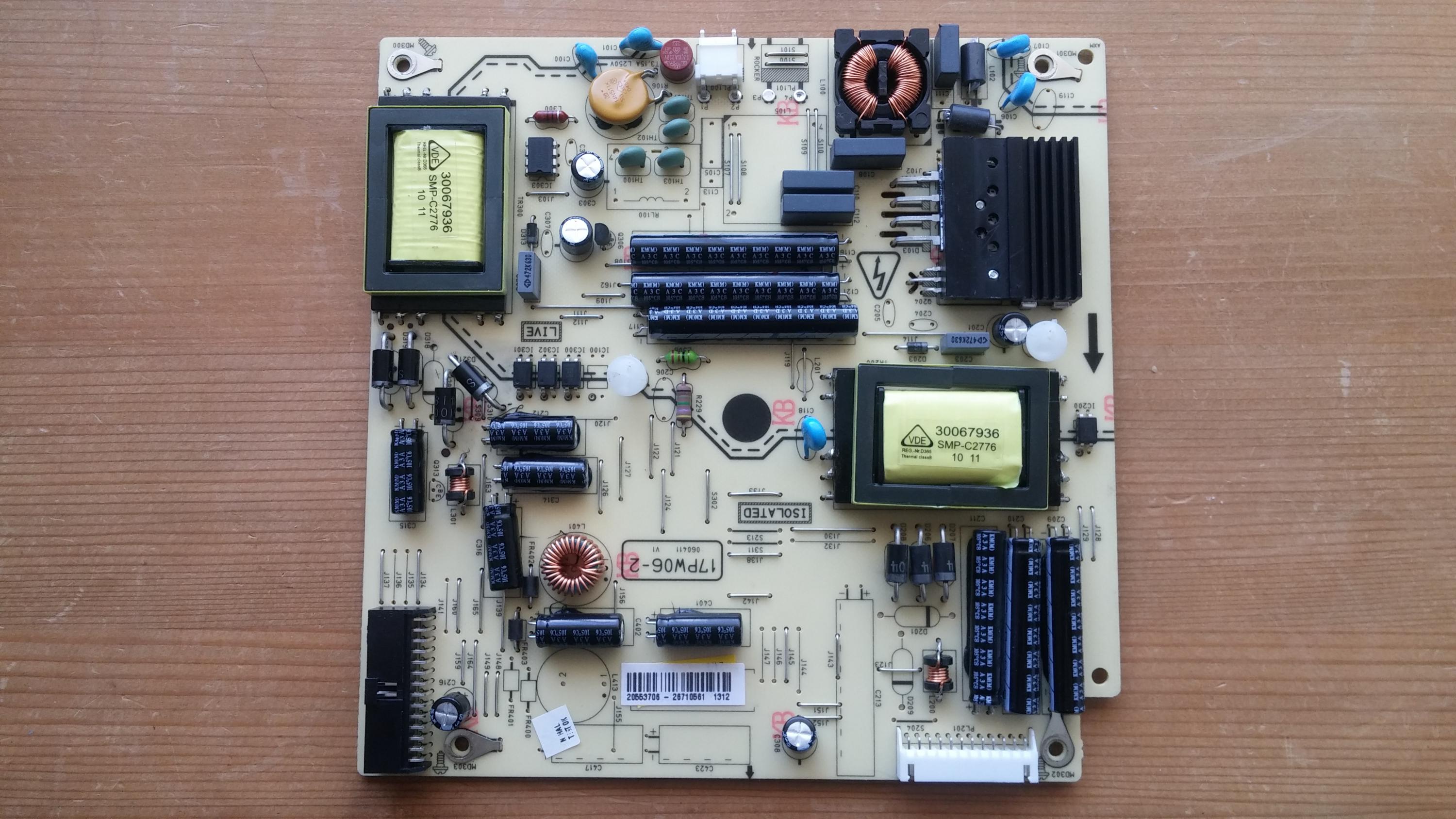

      We need good clear pictures of top and bottom side of YOUR board.

        Hi, just attached some photos hope they come out good enough.
          Re: Toshiba LCD PSU slow tick, not turn on...
          So the ticking sound is coming from the transformer TR300 (top left of the picture 1)? and you also replace those 4 rectifier diodes D318, 319, 321, XX by that transformer, correct?
