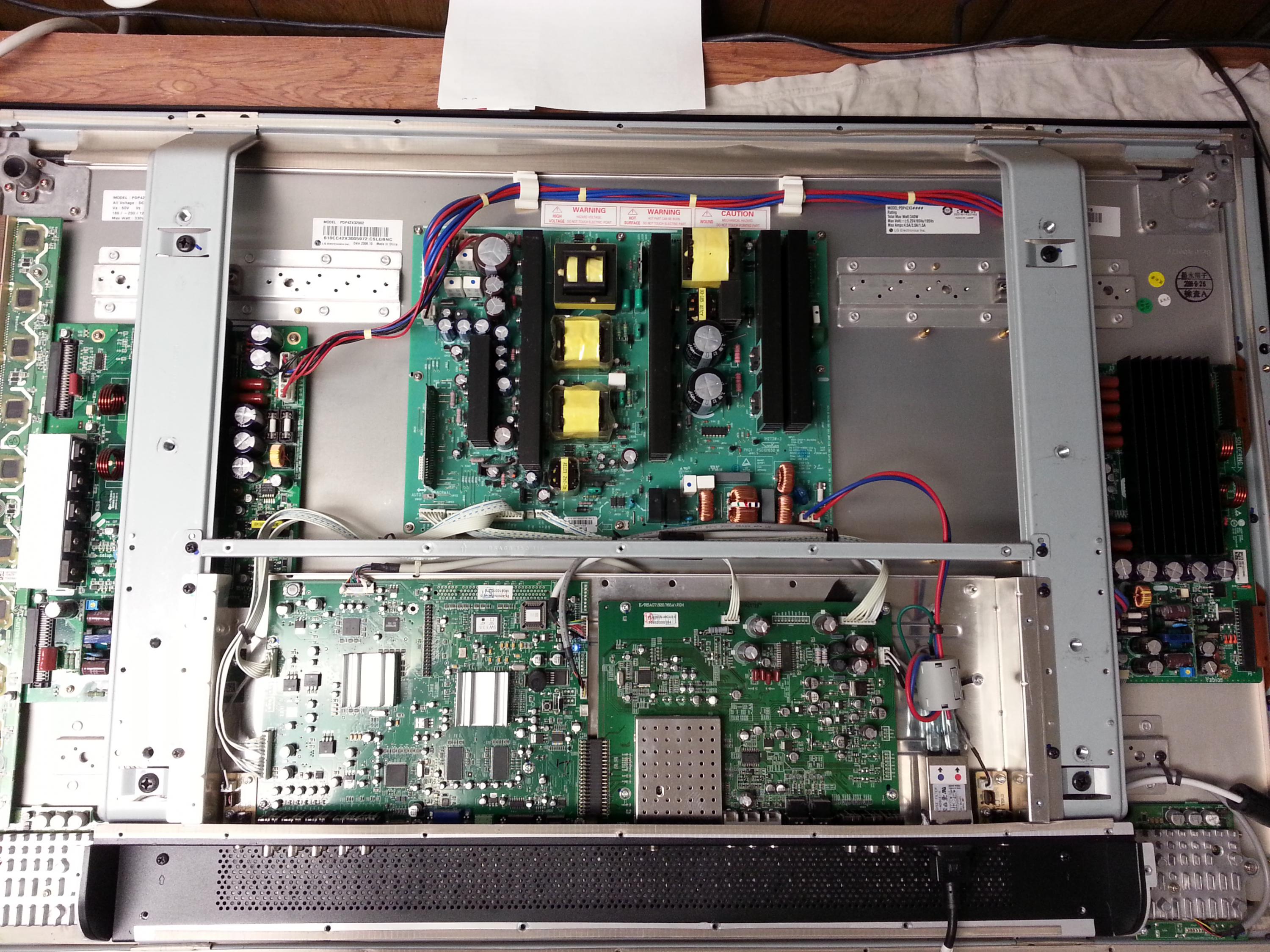

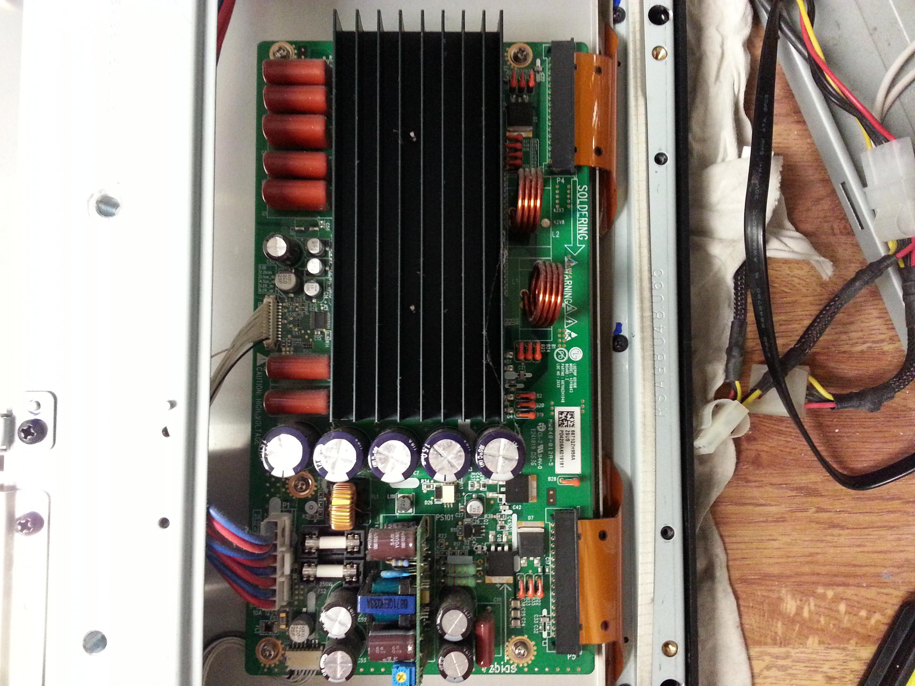

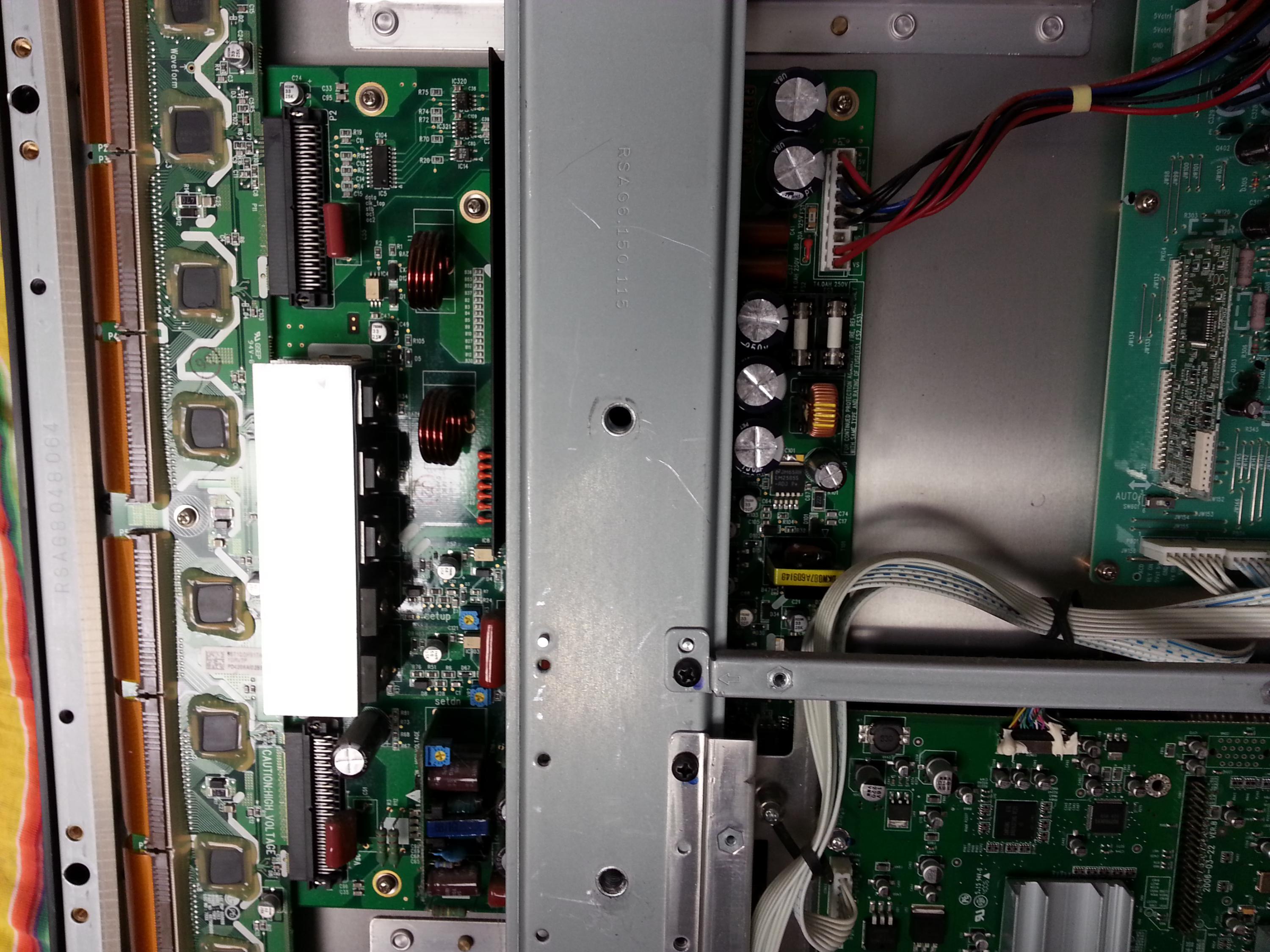

    I'm working on this HP PL4260N 42" Plasma that powers on normally but does not display anything on the screen. Everything has passed my preliminary visual inspection, but the fuse on the left on the Y Sustain board is blown (although the one on the right is still intact).
    We are seeing 186 for the Vs voltage and 60 for the Va off the power supply. -Vy on the Y Sustain is holding at around 3.6. I was unable to locate VSCAN (possibly underneath the metal bracket which I have not removed yet) and VZB is a bit in the air; I found a test point called "Vzbias" on the Z sustain, but that does not measure any voltage.
    Any ideas as to what to troubleshoot next to figure out what's going on with this?

    Fixed!... but no sound
    As suspected, the Y Sustain was indeed the issue. The set fired up right away upon replacement of the board, but all is still not well as I'm not getting any sound out of the speakers (I did not test the sound before the repair). I made sure to plug them in all the way and doublechecked the connections on the mainboards, but I'm still not hearing anything.
