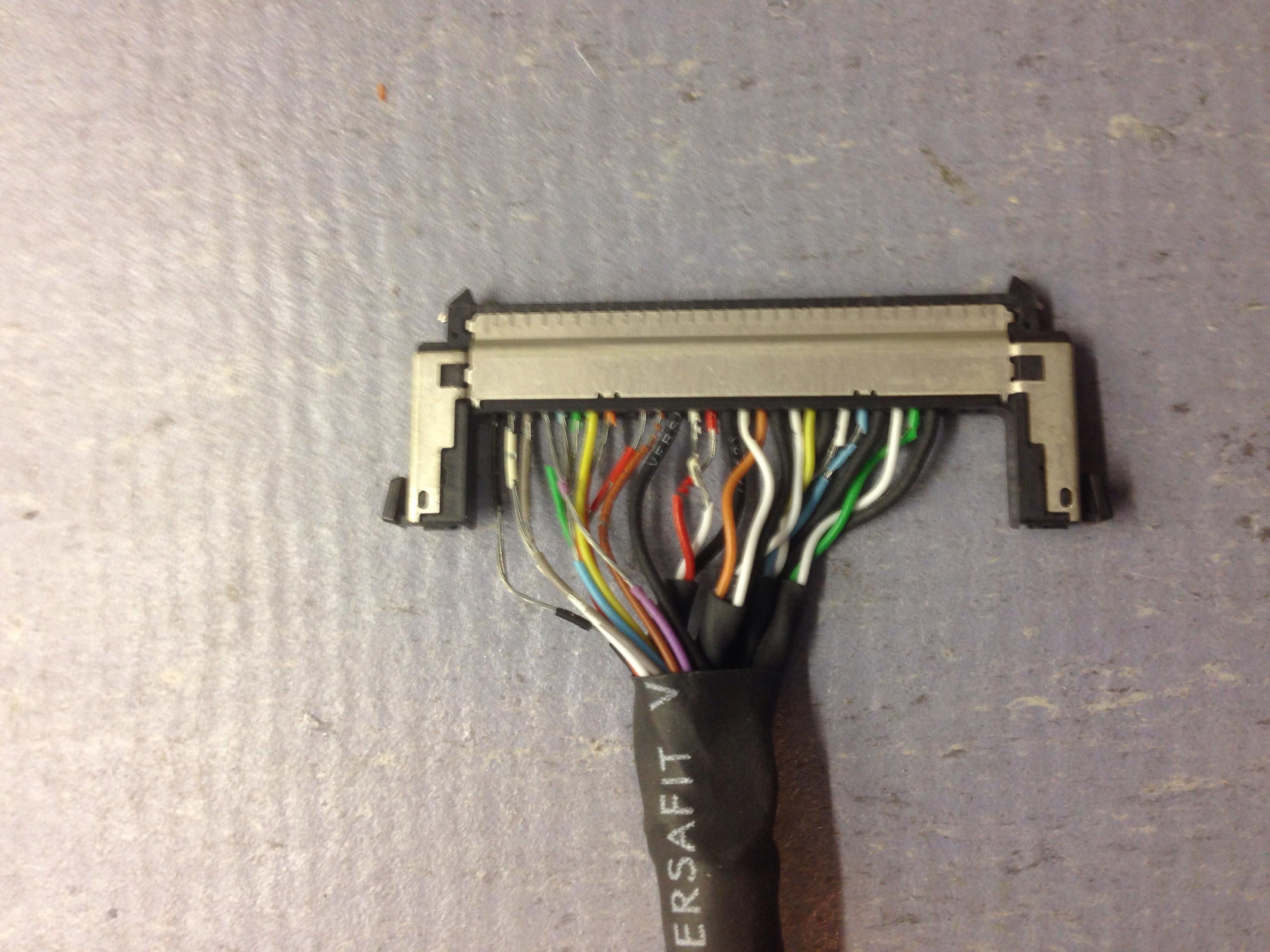

SONY BRAVIA KDL-32U2000 no picture
  • rtstorm
    • Feb 2012
    • 971
    • Croatia
    Re: SONY BRAVIA KDL-32U2000 no picture
    I found reason why fuse is blown. Wire of cable is rusy and it touched GND.
    ...the quieter you become the more you are able to hear...
